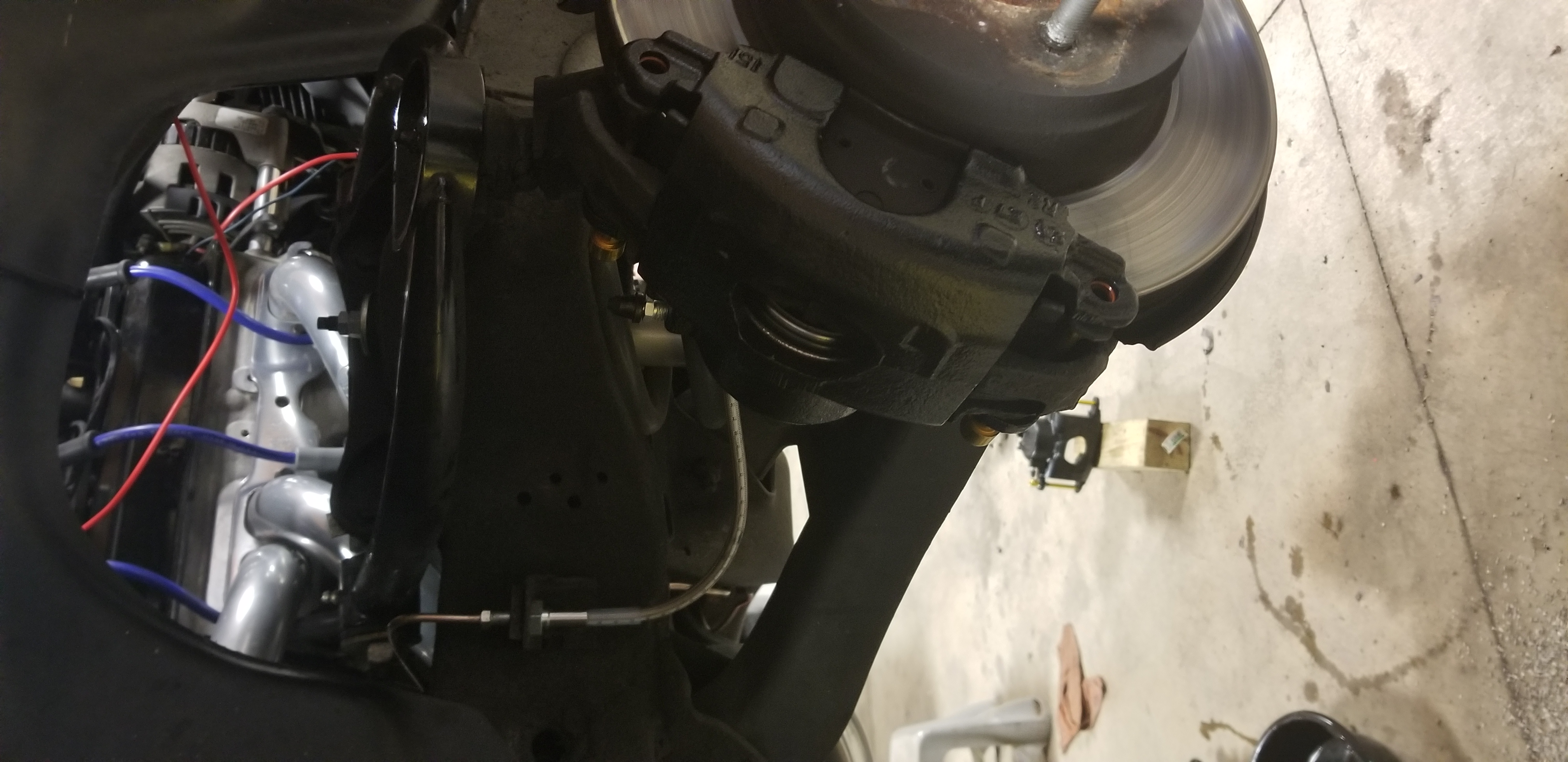

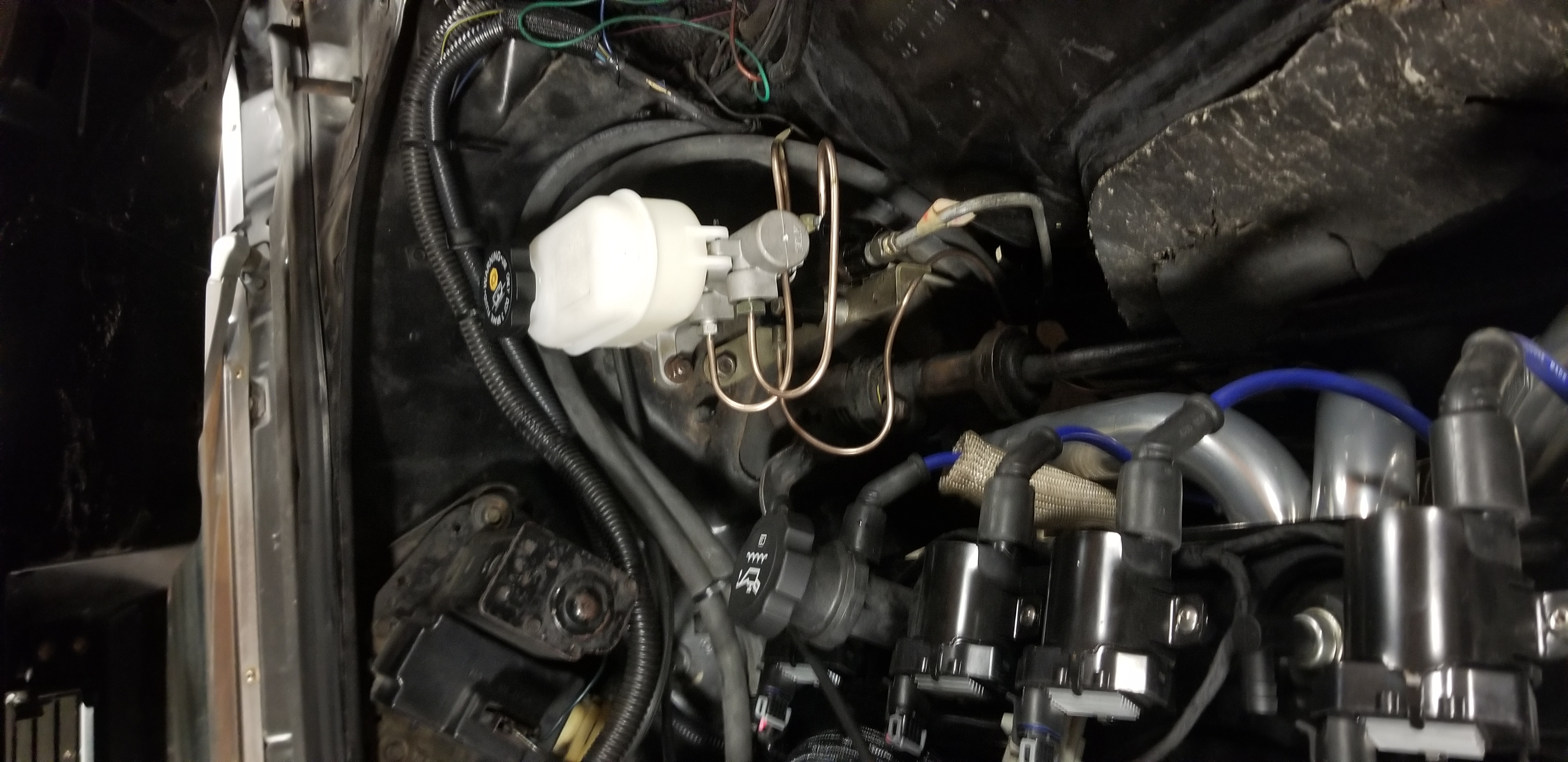

After the last bleeding attempt failed miserably, I did what any good mechanic would do -- just replace all the parts! The line going to RF has had a splice (compression fitting) for decades and the internet tells me im doomed to have such a thing. The calipers are now 20+ yrs old. So I replaced the RF line, replaced the rubber flex lines with Russell stainless braided, and purchased new calipers from Napa. Pads and rotors still look good, but I'm tempted to call up Mike @ Carbotech for some new pads.
Unfortunately, by the time I got everything done last night, my helper had already gone to bed. I sent my Dad a txt this morning, maybe he can stop by and help me bleed them. If they work, I think I could take it to the track tonight.

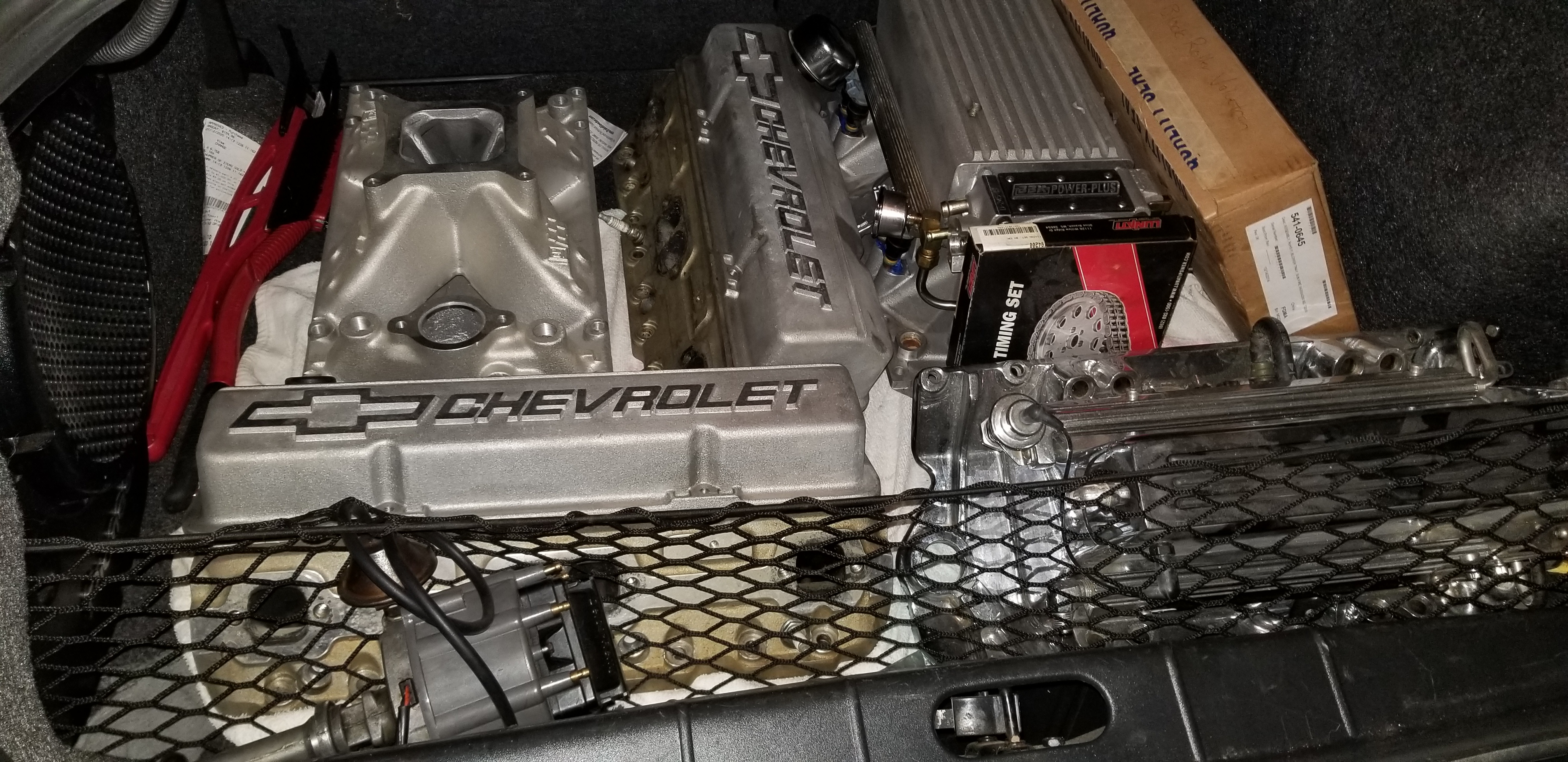

But, on Saturday I embarked on a most noble journey to Parsons Hi-Performance in Dayton, OH after a couple phone calls with Bruce Parsons. This is the guy that put Tony's 383 together. I took my Edelbrock E-Tec 200 heads and other misc parts down to Bruce and put down a deposit to put together an all-forged, roller, 406 housed in a Dart SHP block. I took him a couple of my EFI intakes, and he will actually dyno it on EFI when it's together. Delivery is not expected until some time in the spring, so more details will be in the 2021 thread, but it should be pretty strong!!
