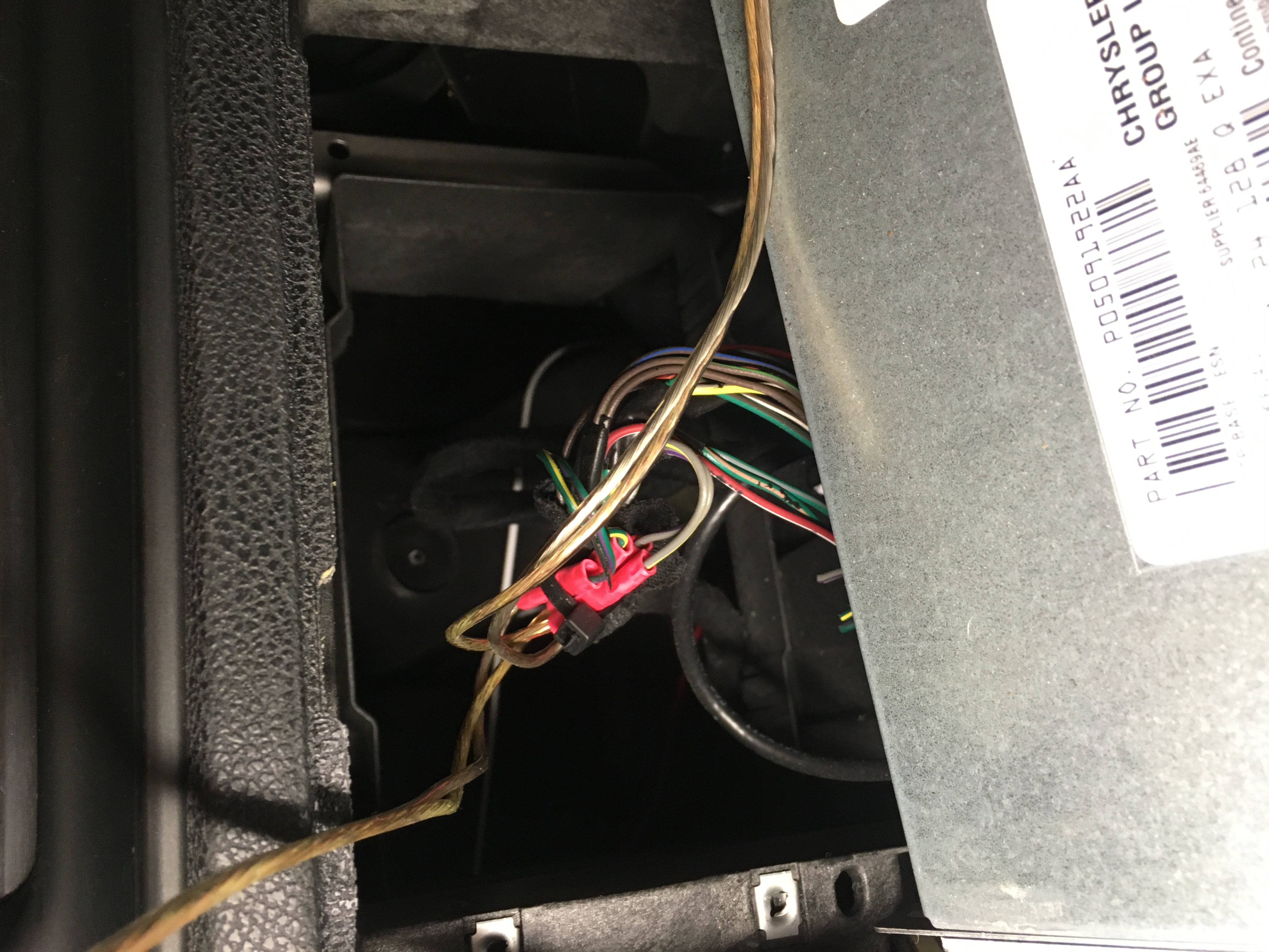

Used the cig lighter plug to finish the wiring and then install all the console parts except the lid.

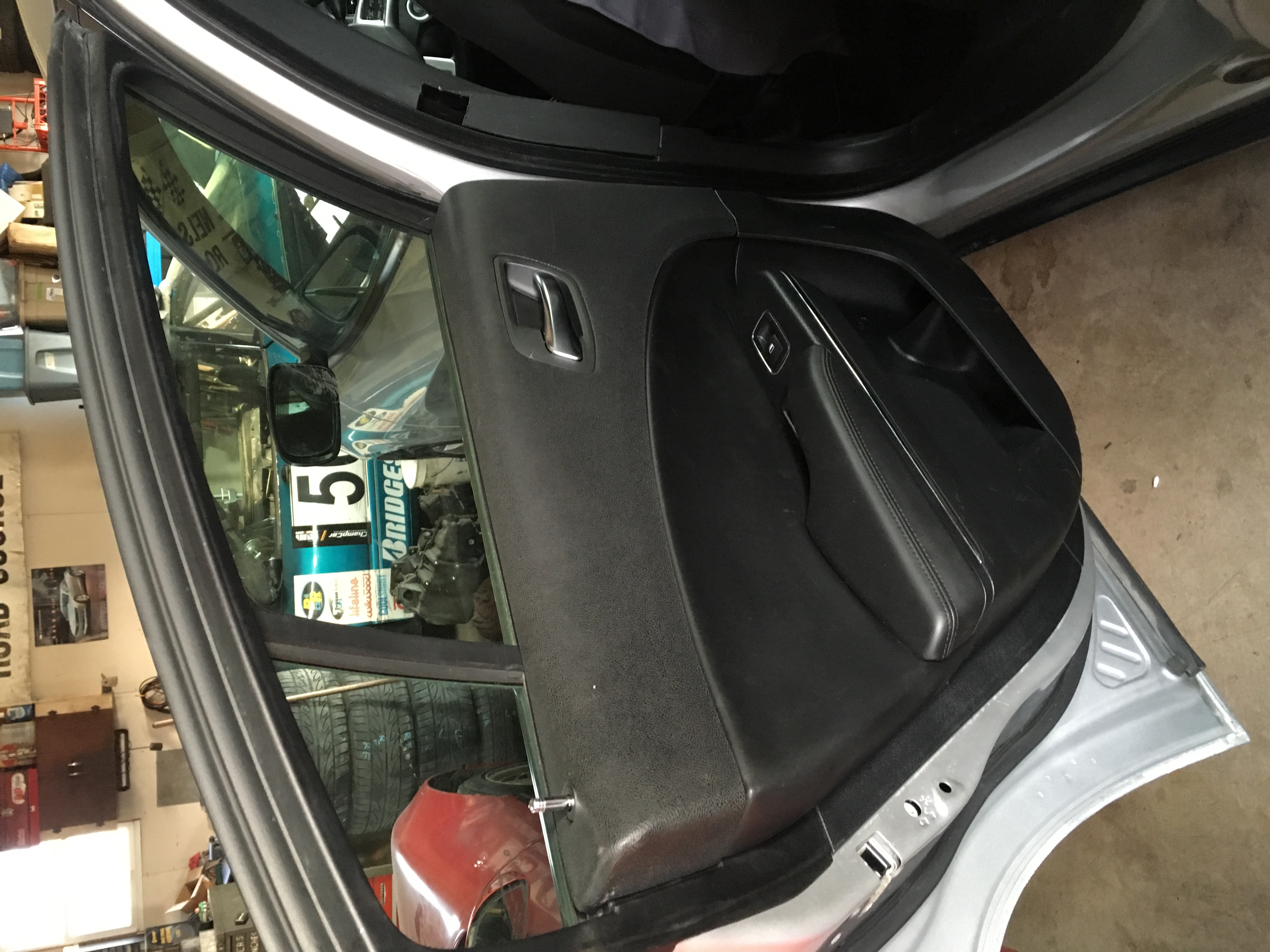

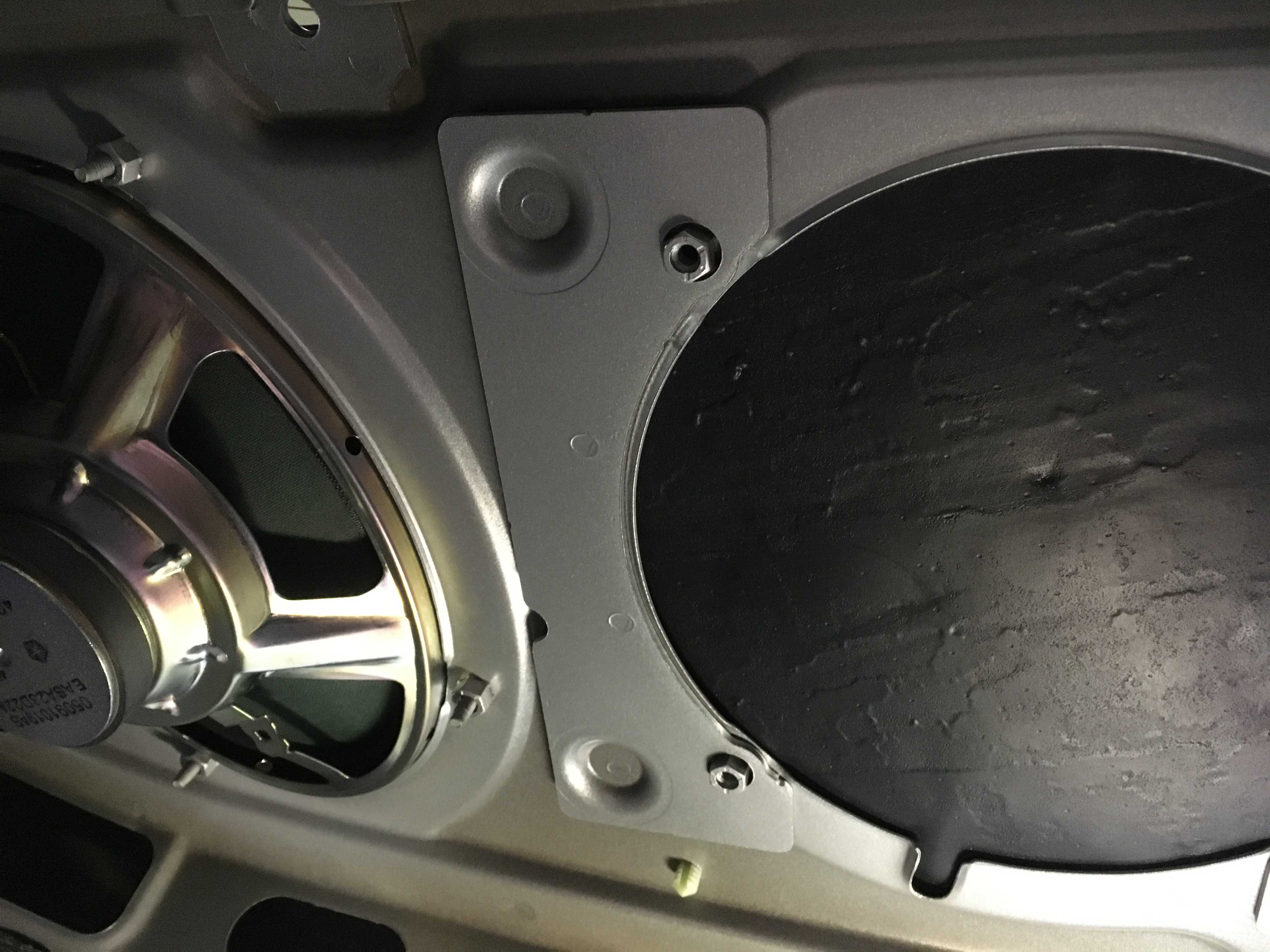

On Tuesday I removed the rear door interior panels, reattached the front speaker wires to the radio (police run their radios through front speakers), and removed an air duct control motor that was failing. Now I have it I have the part I can get a replacement.

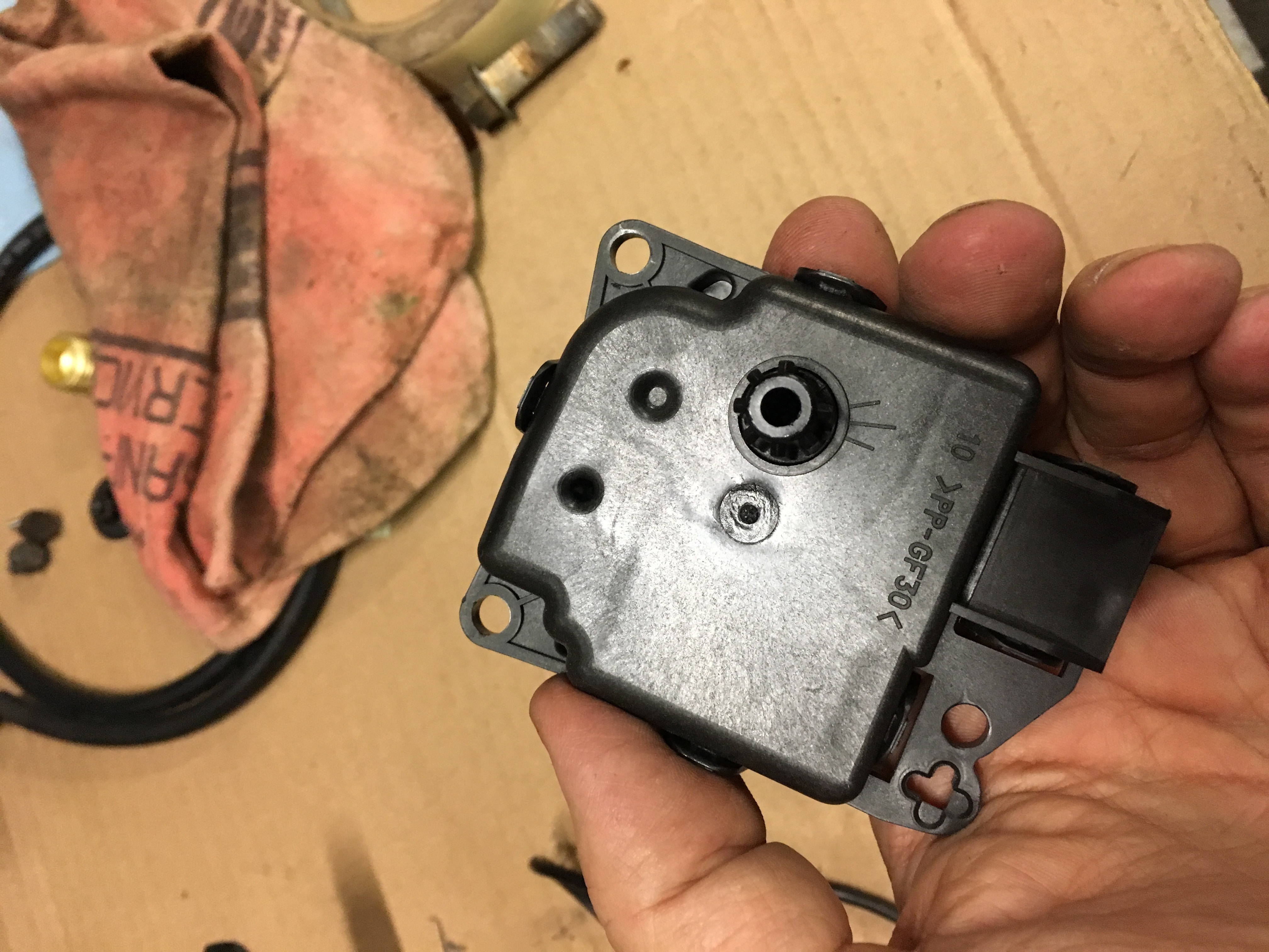

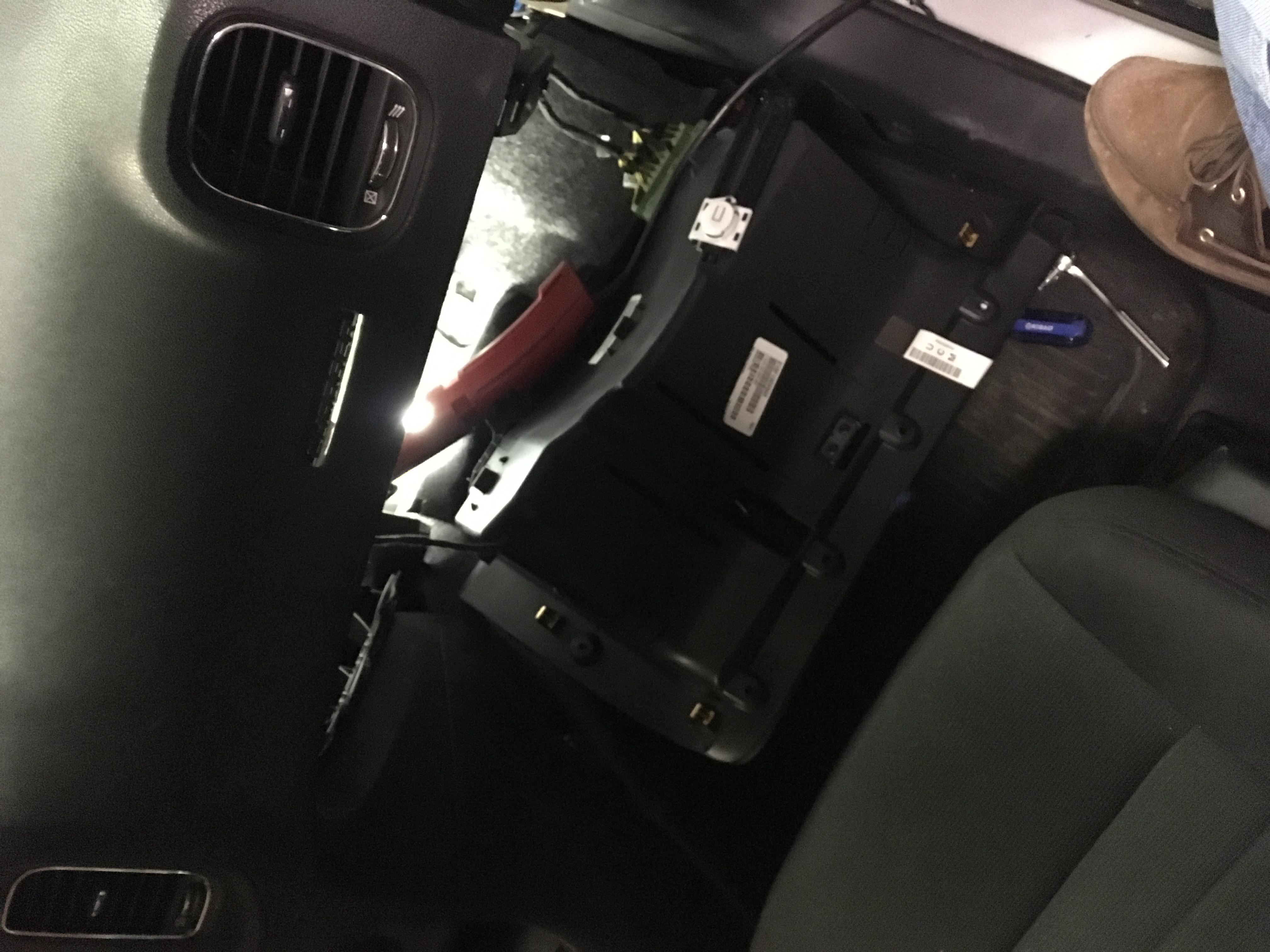

Air duct motor installed and put glove box back in

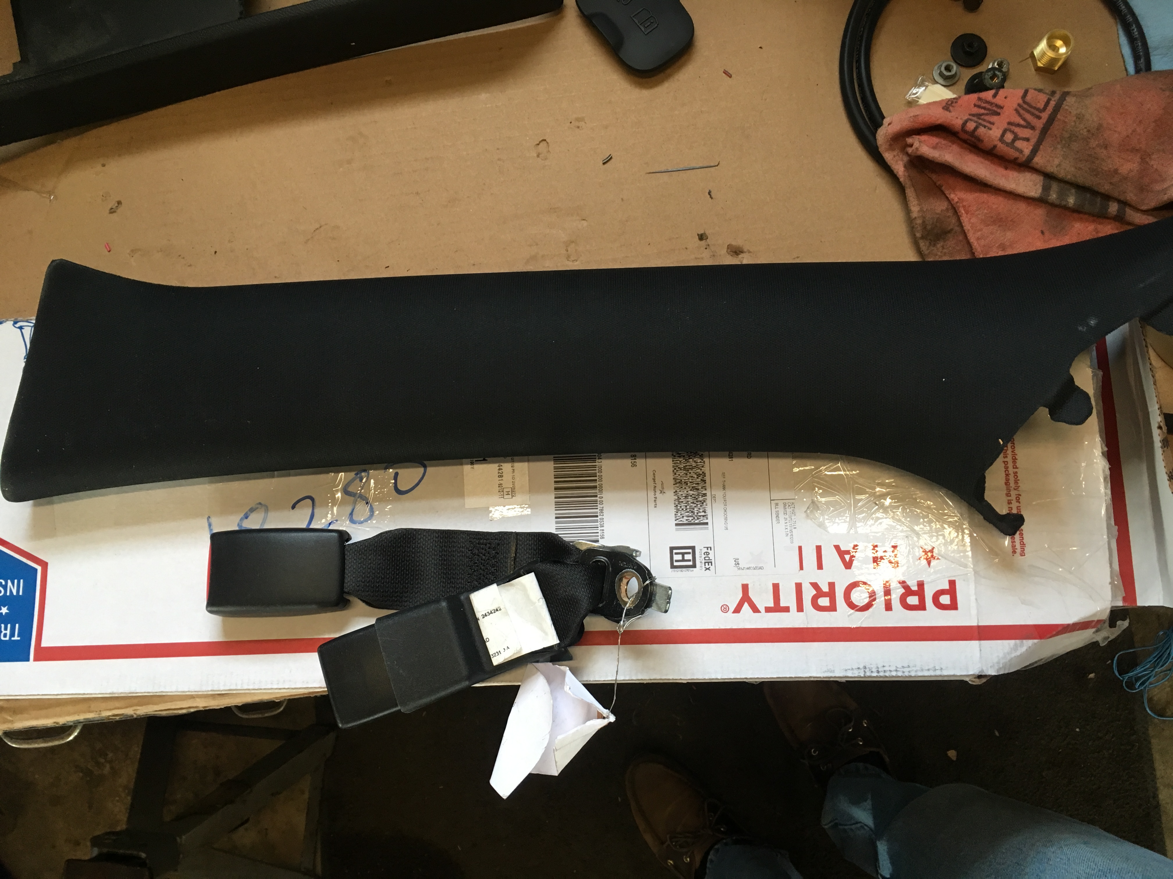

Installed replacement A pillar interior trim

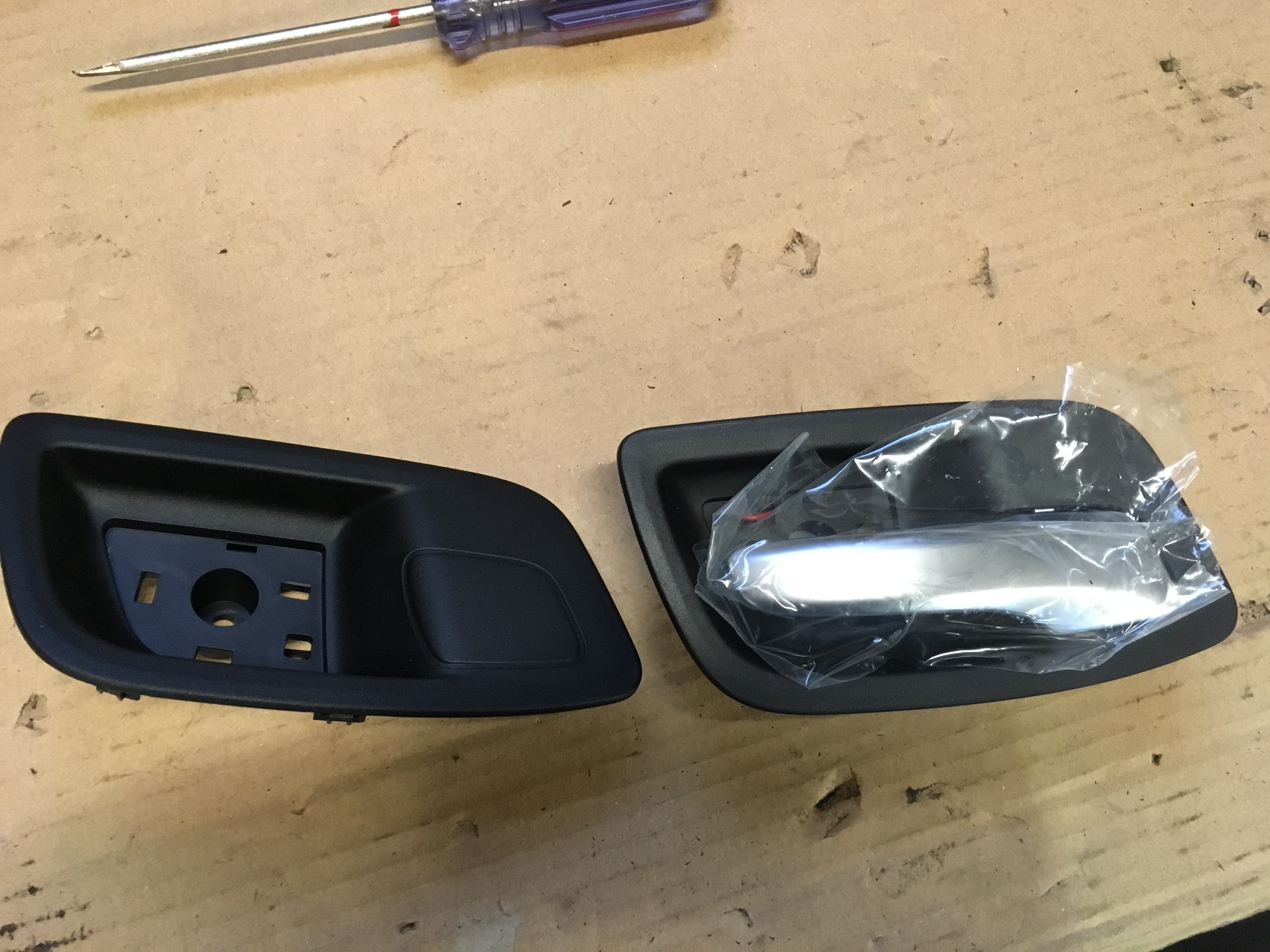

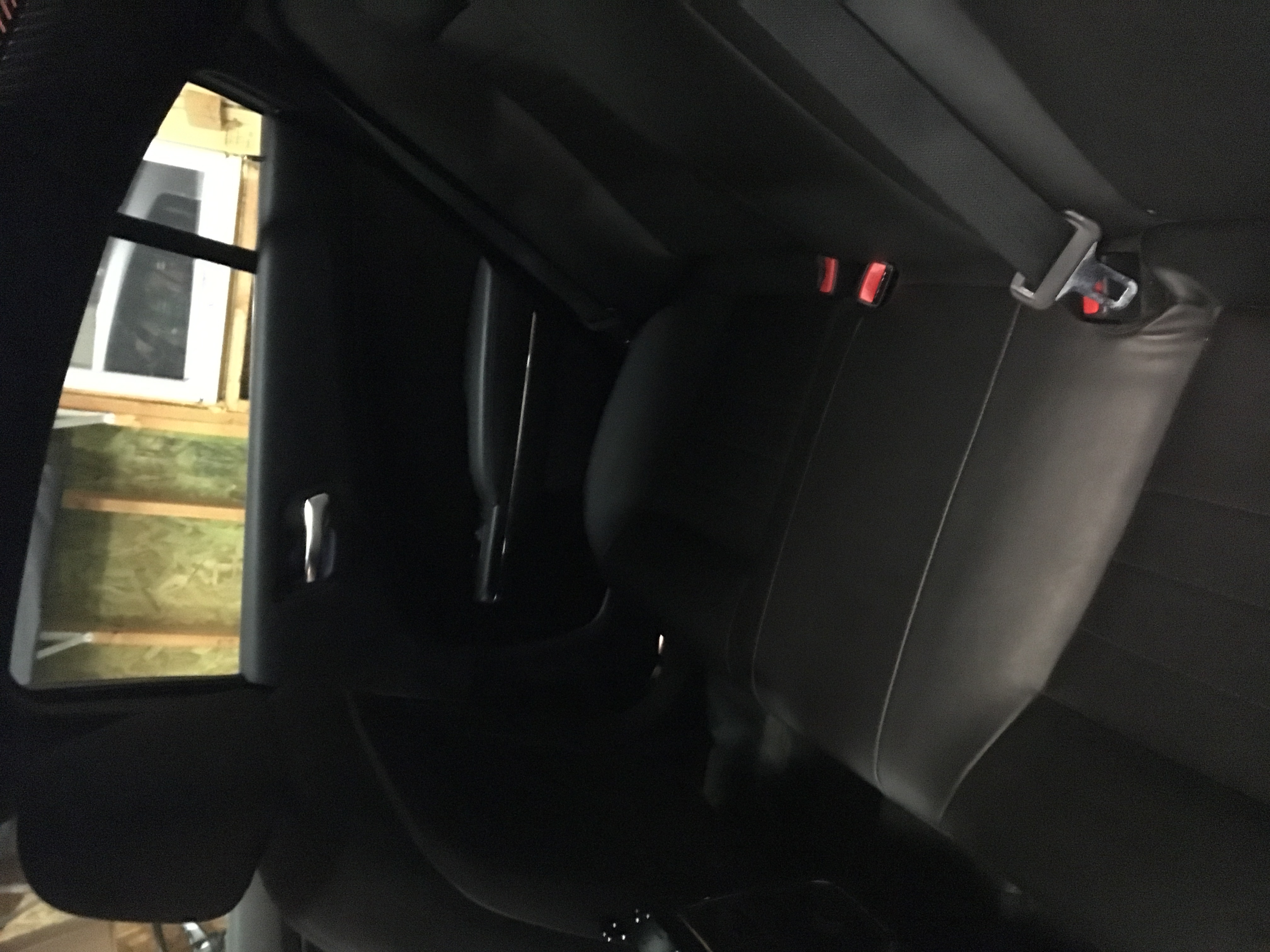

Finished up the rear doors installing handles, cable, window switch button, manual door lock rods

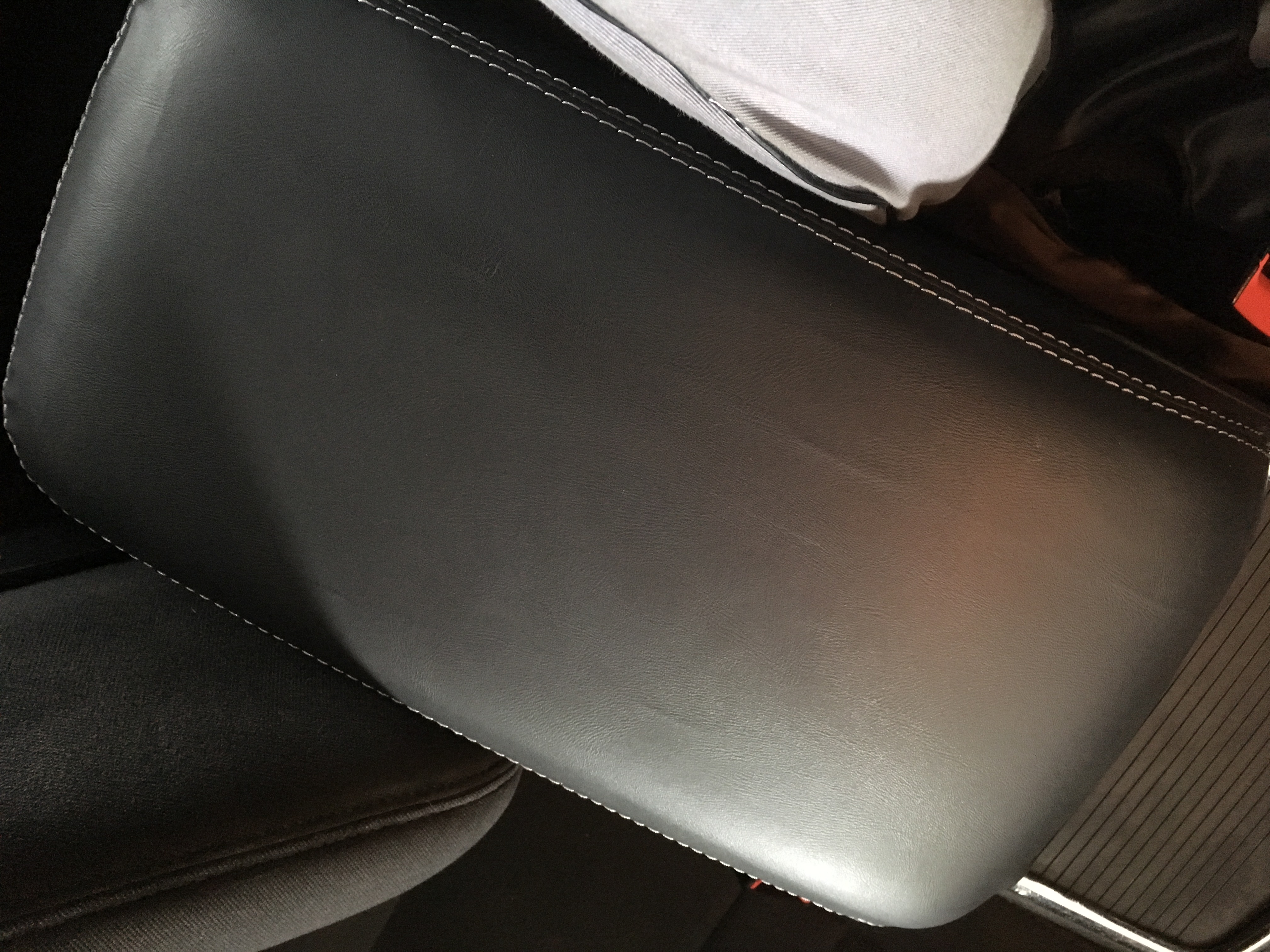

Recovered the center console lid

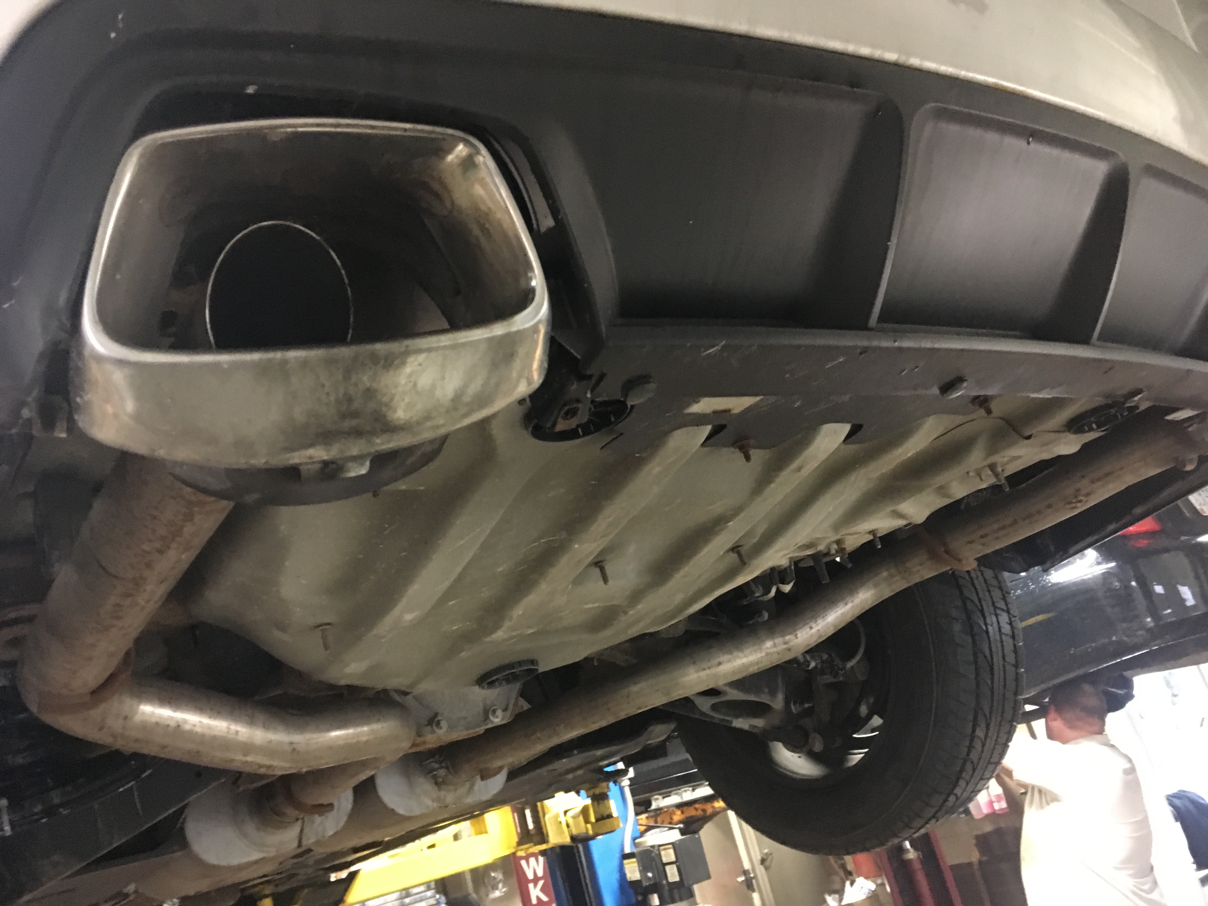

Installed the Flowmaster exhaust

It is definitely louder, sounds really good at WOT, and is reasonably quiet at idle and cruising speeds.
In ECO mode just before the transition to 8-cylinder mode there is considerable vibration and the sound there is not that great. At idle at traffic lights it sounds like a truck.
I don't like the front band clamps (maybe 4" long but thin) and I think there may be a slight leak. I bought some different clamps (maybe 3/4" wide like the OE clamps) and will install them first chance.

Today I made some adjustments to the exhaust. I did replace the front band clamps, but also slid the whole cat back system forward about 1/2". Also noticed the pipes were rubbing on one of the support braces. I loosened several of the band clamps and jacked up the exhaust then retightened. For insurance I put a couple washers between the brace and car to lower it.
Still have one band clamp that is not clamping well the nut is bound up. Going to get a few spares then try to fix that, but the vibrations are gone its a much better ride now. It's only a little bit louder than the stock setup - at least from the inside.

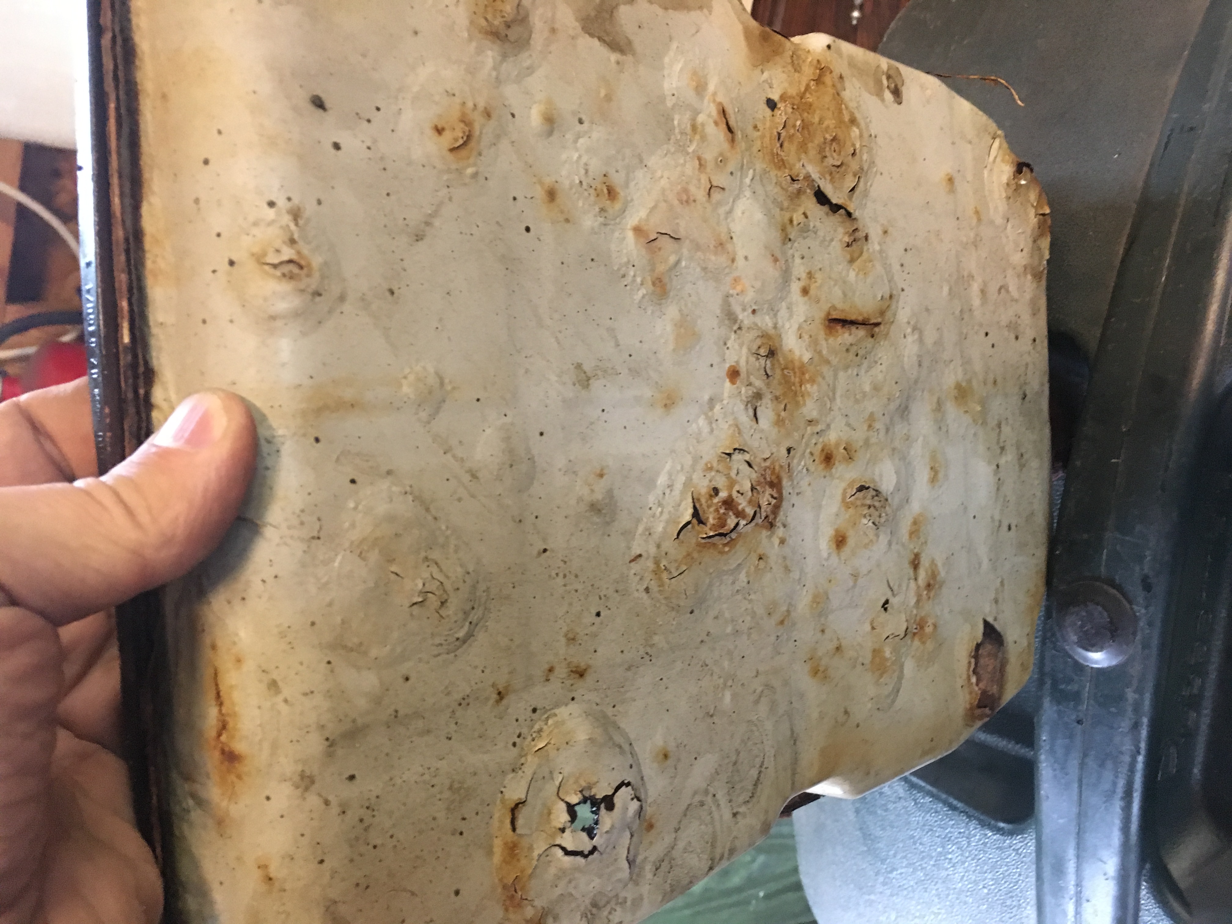

Acquired transmission pan, fluid and filter. Pan was rusted to paper thin and was not saveable

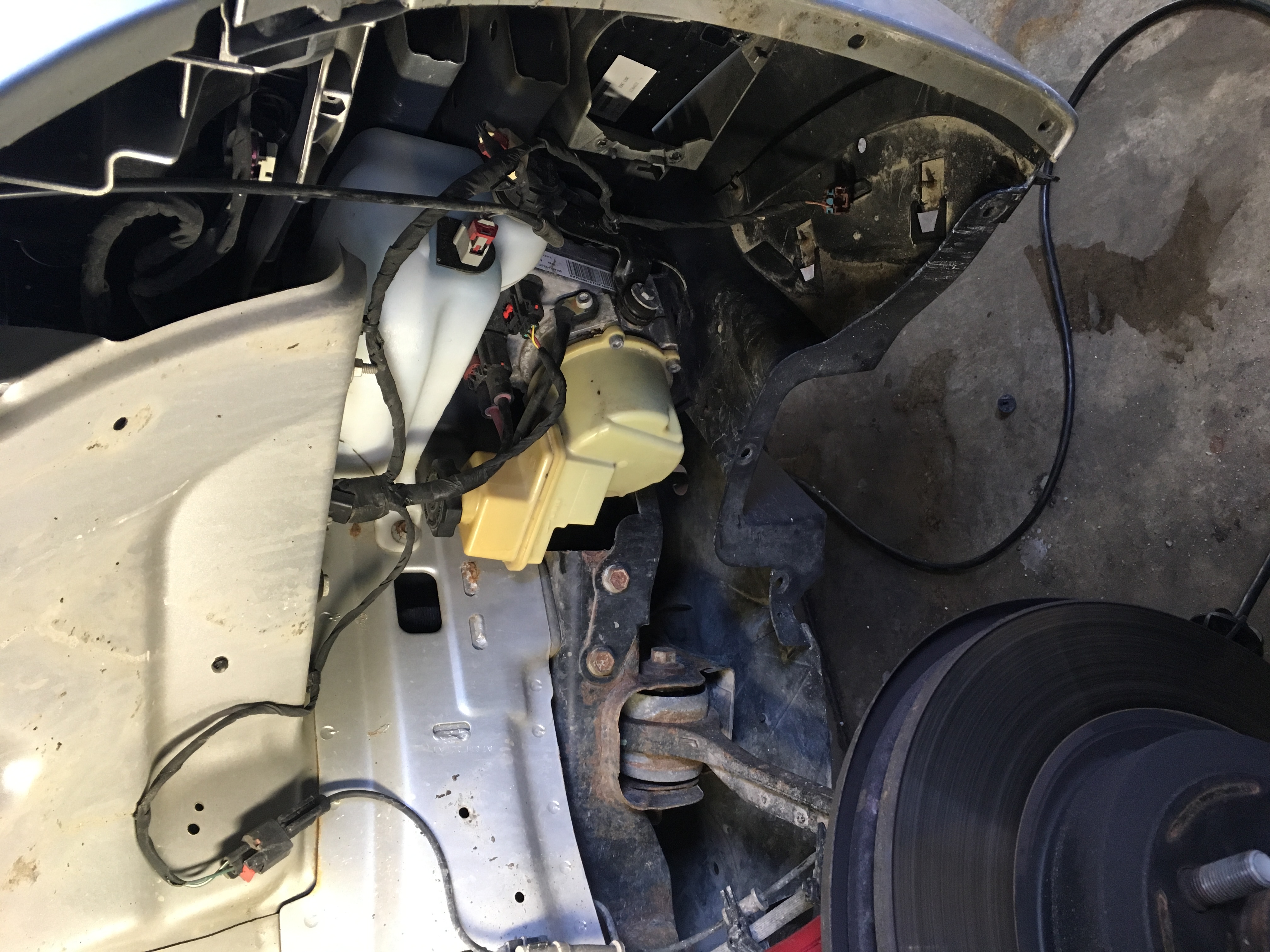

The Charger has hydro electric steering and the reservoir is in the RF wheel well behind the inner fender. Today I changed the fluid to address a problem with low speed left turns: https://youtu.be/QbxVpkm8j8U

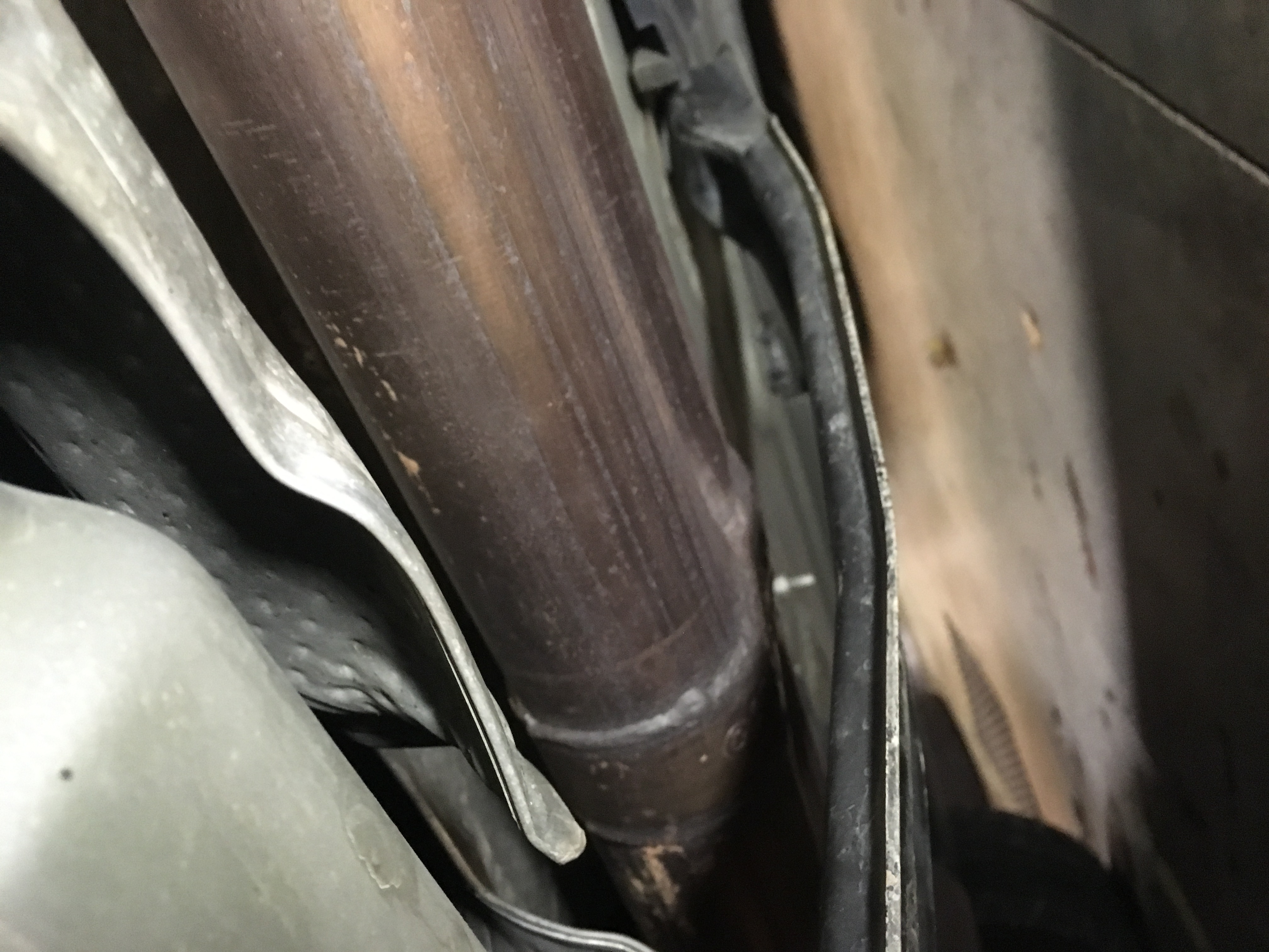

As it turns out, my efforts to raise the center of the exhaust failed and all the rattles were due to the pipe hitting one support brace under the car. I had already put some washers in to lower it but that was not enough. I resolved this by bending the center of the bracket down to give more clearance. It is not any lower than the other low points under the car so it should be good.
On the LR, last weekend I discovered the exhaust frame (looks like exhaust tip but is attached to the bumper not the exhaust) was rubbing the exhaust pipe, due to some damage to one of its mooring positions. I ended up using a stainless steel zip tie to put it in place, and that appears to be holding just fine, so will leave as is for now.

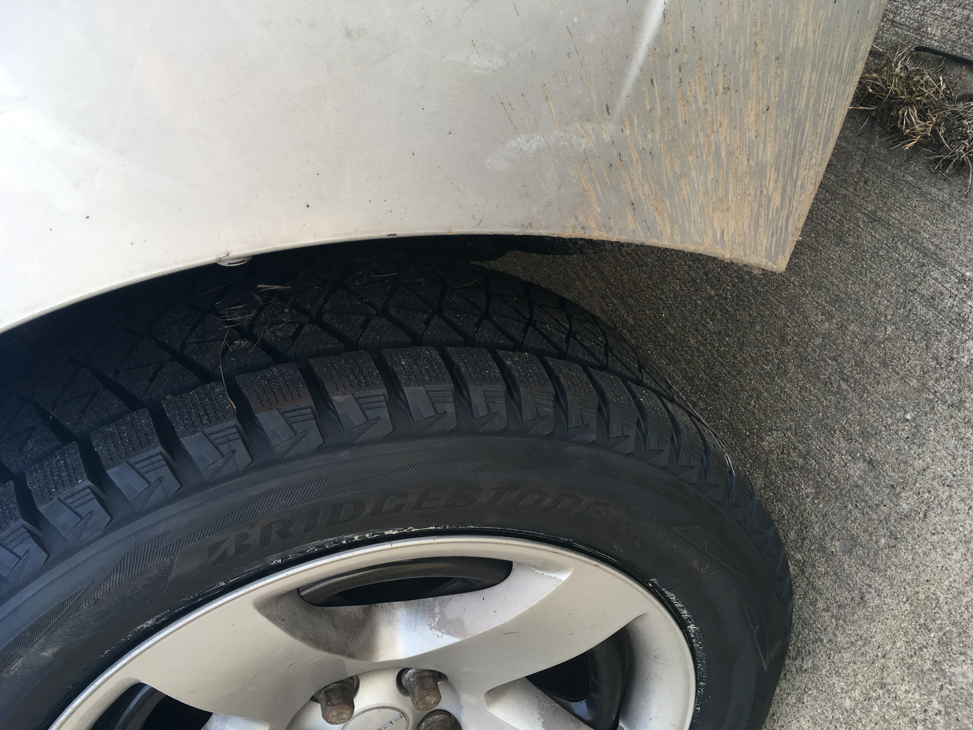

Charger got snow tires installed last weekend.

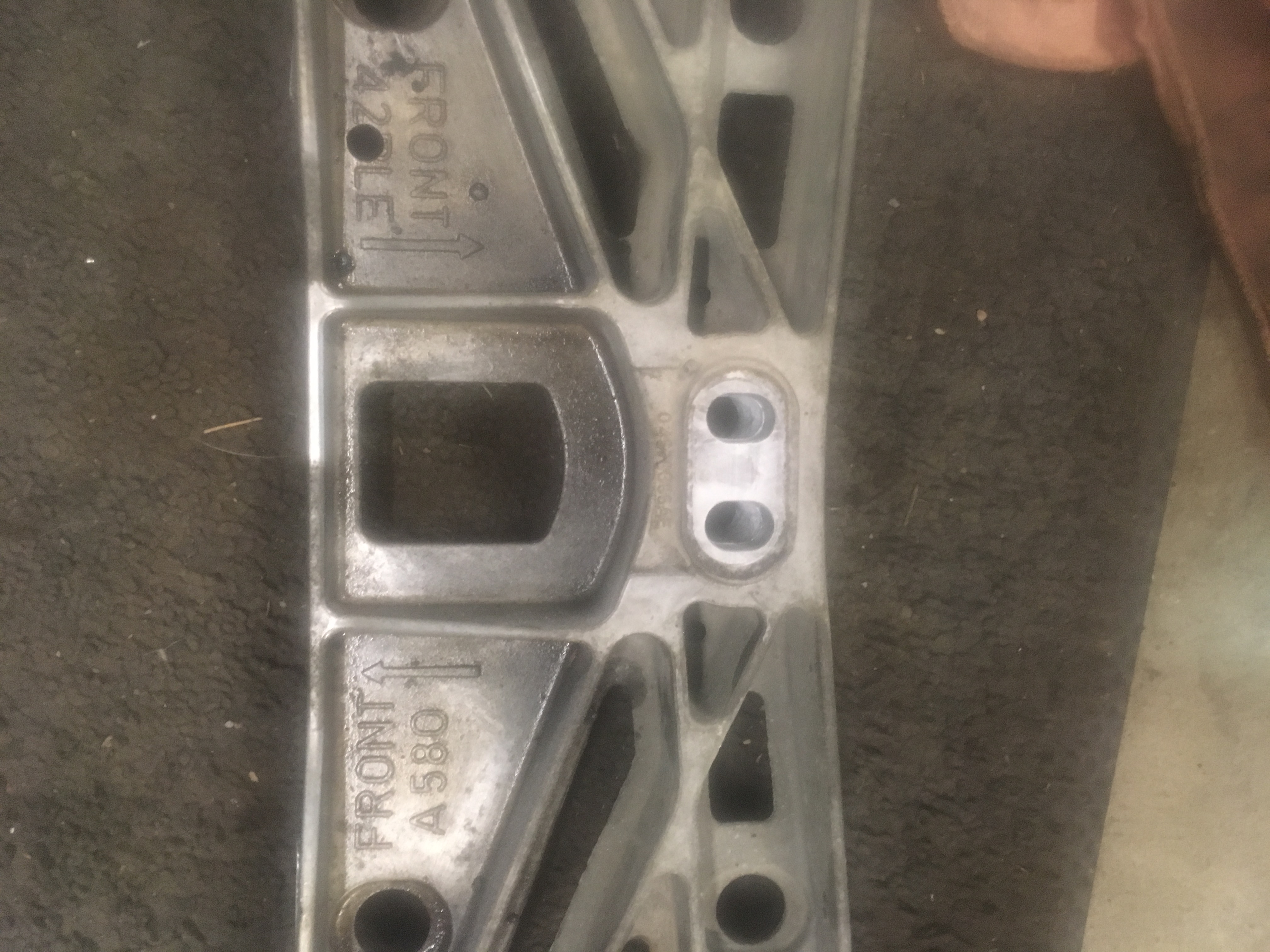

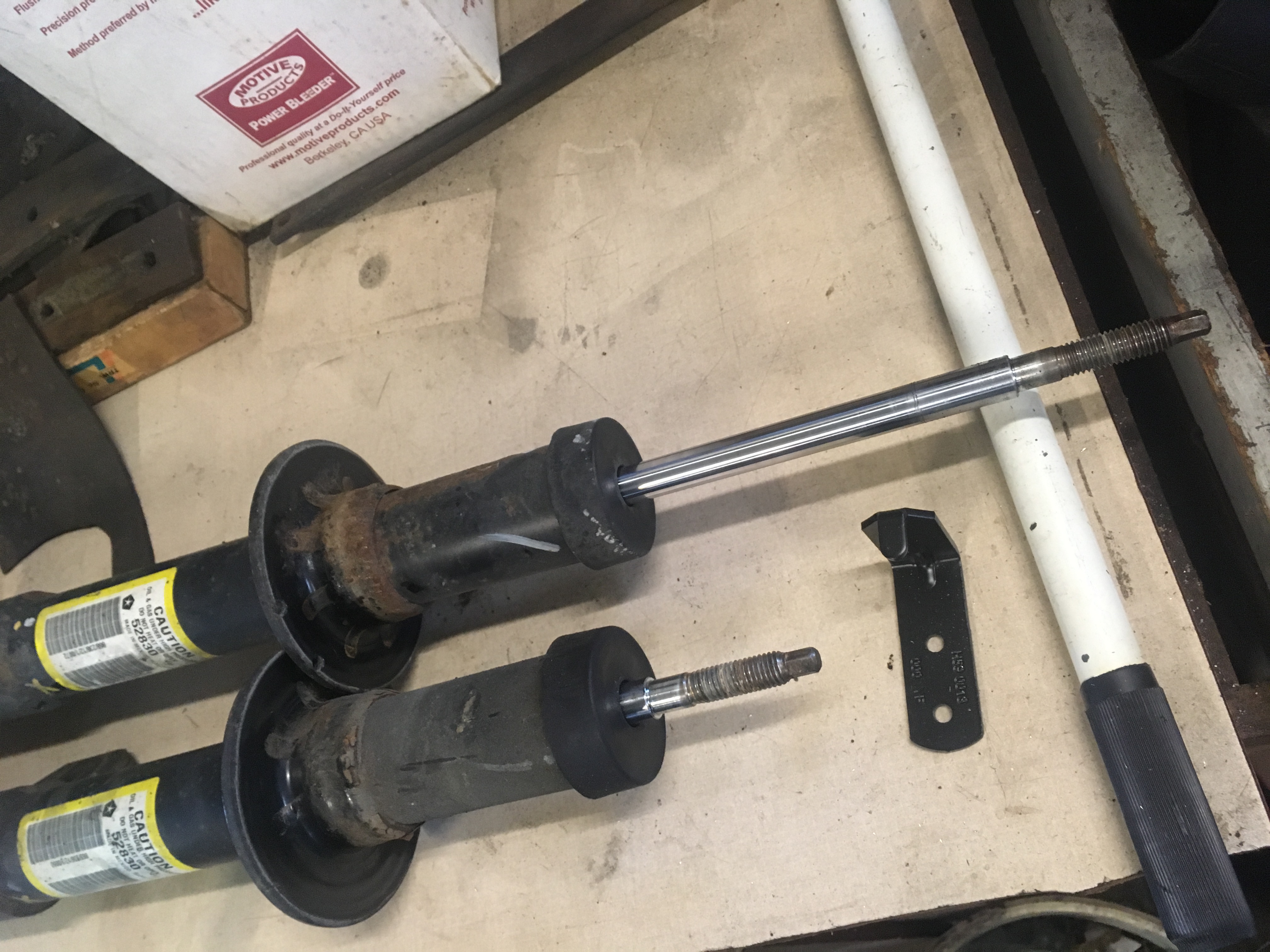

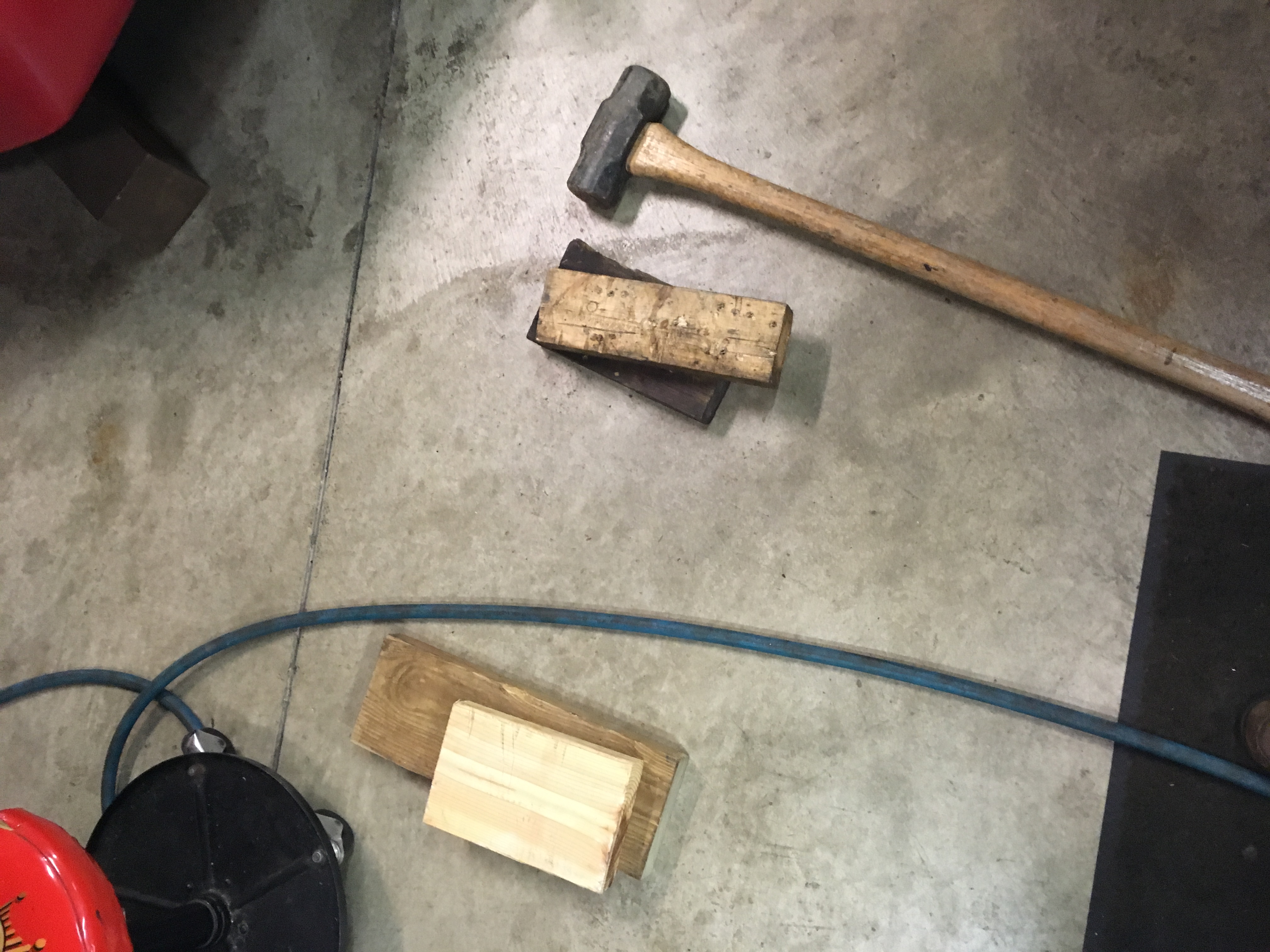

From the first track day: While I'm uploading pics, this one tells the story of the front struts I replaced:
Before that it went to the road course at Nelson Ledges for two track days. Air was cold but it was dry.
During the 11/2 event we got a lap timer in the car. Rachel ran 1:24.9 with a top speed of 111 mph. I believe this is Rachel's personal best. I ran 1:22 and change with a top speed of 119 mph. This car is fast in straight line! It behaved well in the corners but the physics of 225 wide tires and 4300 lbs of car limit lap times. Brakes were fantastic.
