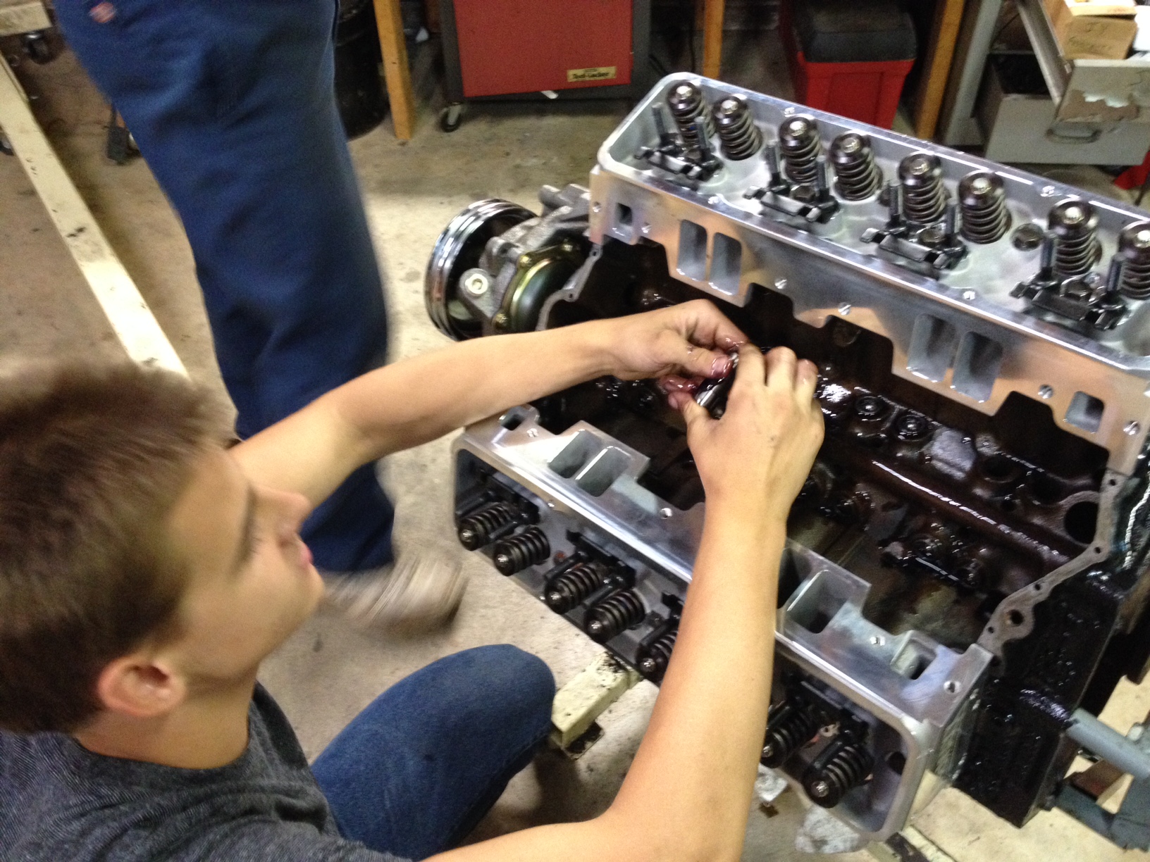

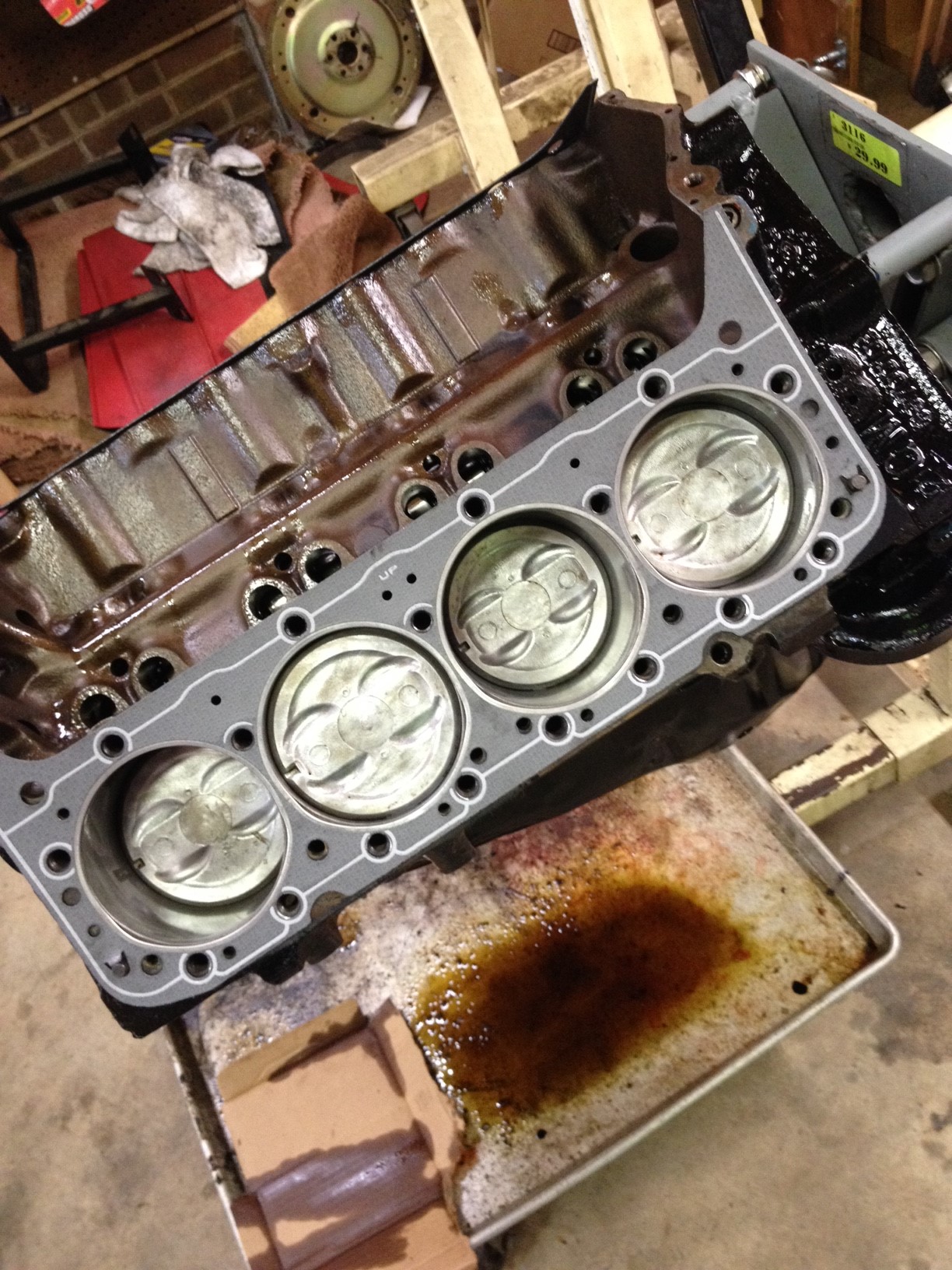

Great day today so Maverick worked on the engine alone.
He checked ring fit on the cylinders. Although the top, second, and oil rings all have different allowable ranges for the gaps, they all are OK at .018". So, all that's required is to check that every ring has at least .018". All OK so far.
Installed rings on all the pistons.

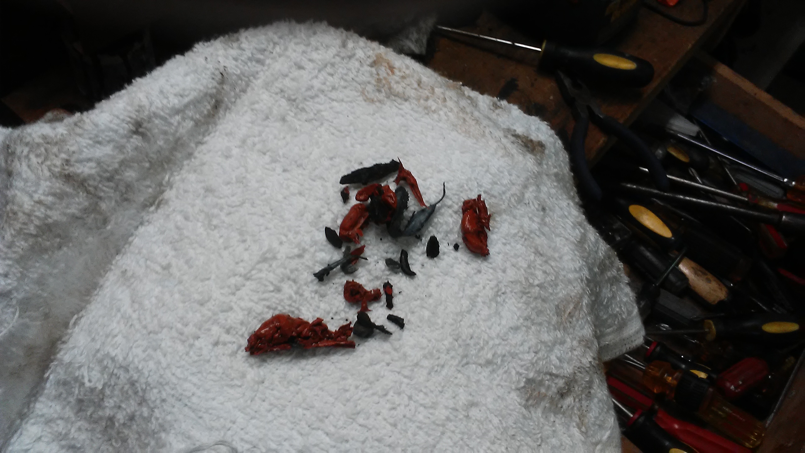

Oil Pump Screen Debris
While inspecting the oil pump this junk, mostly sealer, was found in the screen.
A newbie must have been working on this "Professional" rebuild.
Re: SBC 350 + Test Stand
WXO has a better explanation for the big gobs of sealer on the oil pickup. Someone had attempted to seal the oil pan with excess amounts of sealer. I like that better than thinking the pro rebuilder did it.

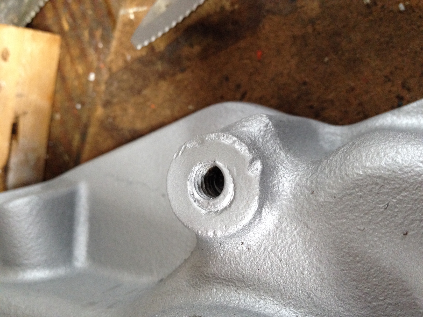

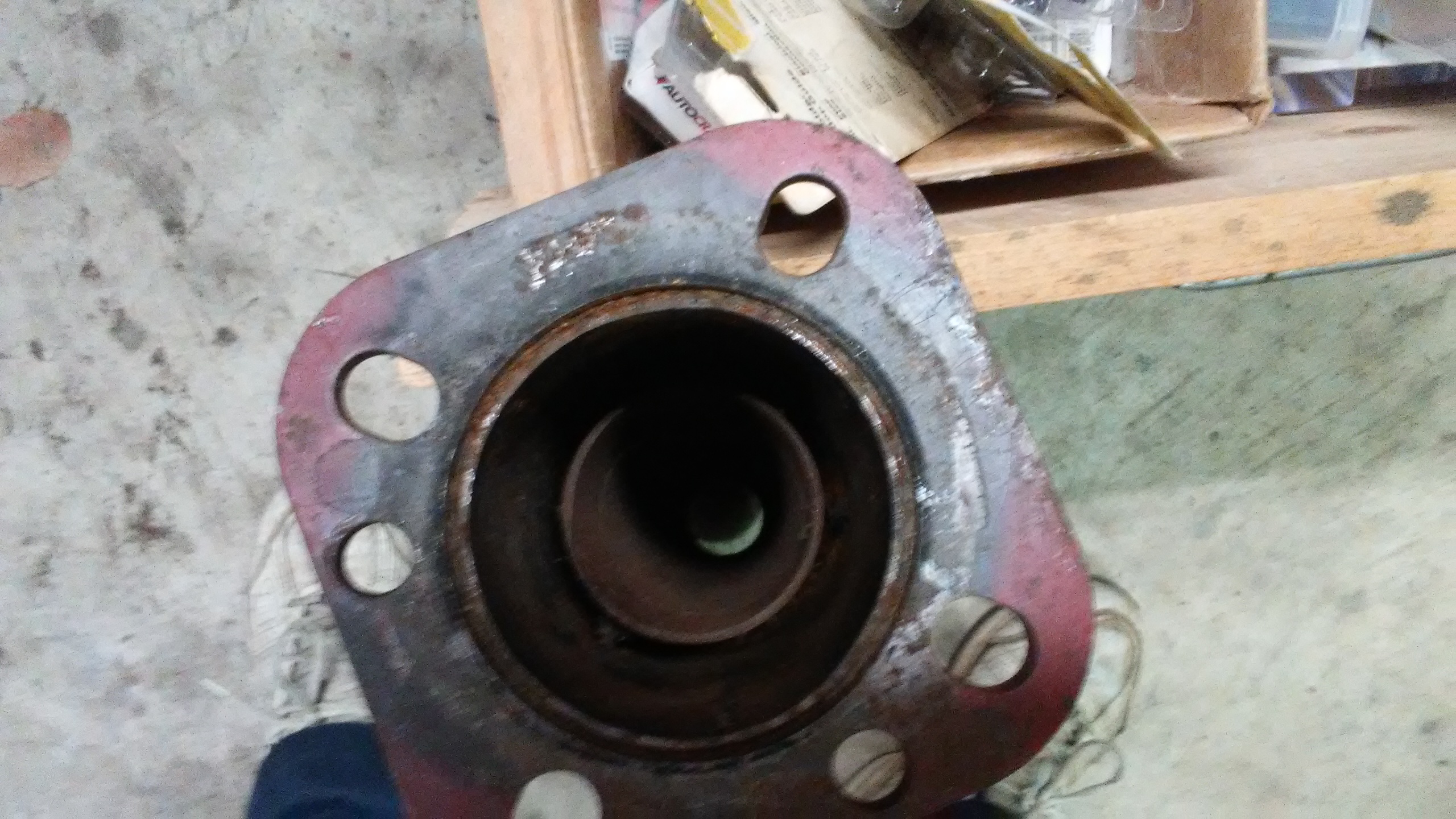

I cleaned and painted the intake yesterday. I also rinsed off the carb with carb cleaner. Here's what it looks like now...
Looking a little closer, I found a broken off bolt in a boss on the front of the intake. Someone had drilled and tapped it to a smaller size. If I remember correctly, this is the boss that is used to attach on side of the alternator mount.

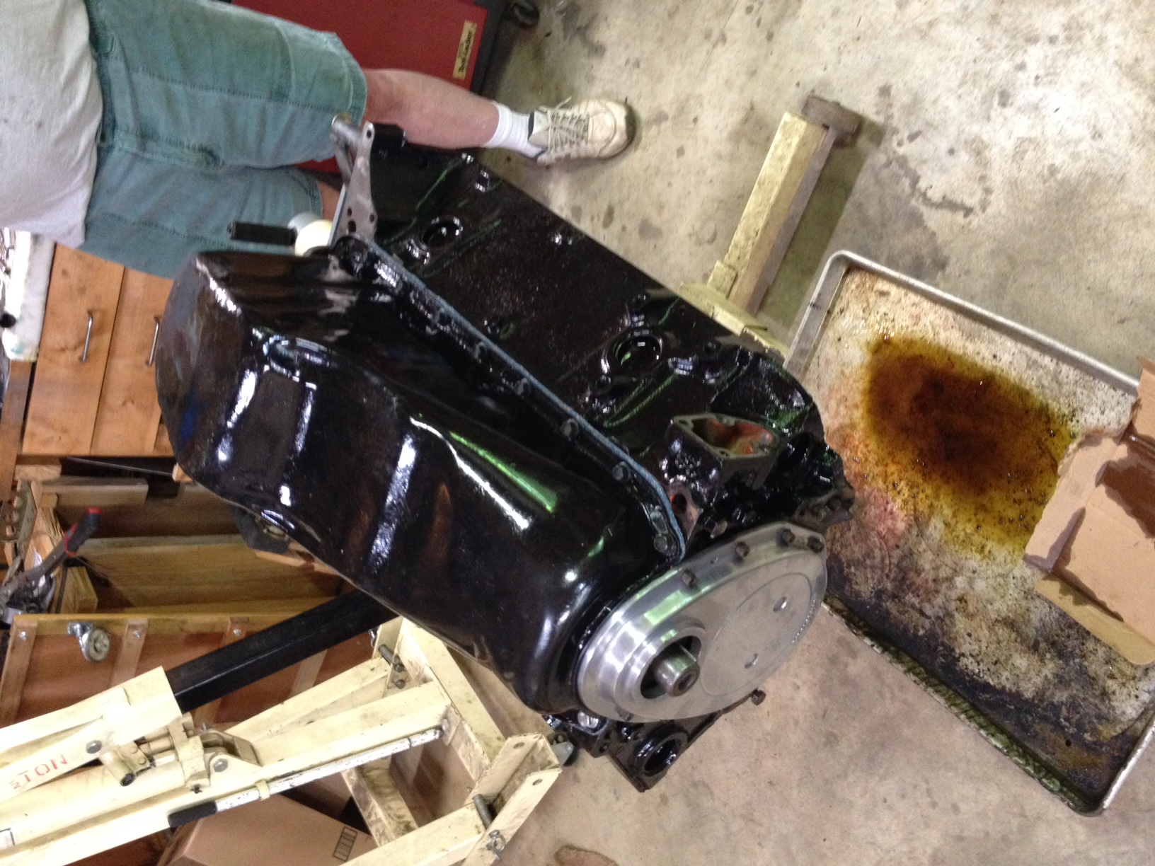

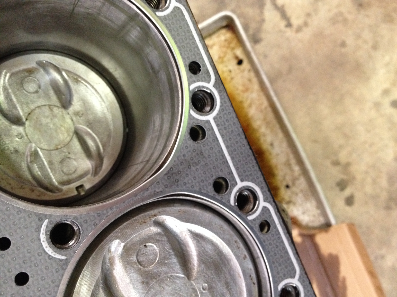

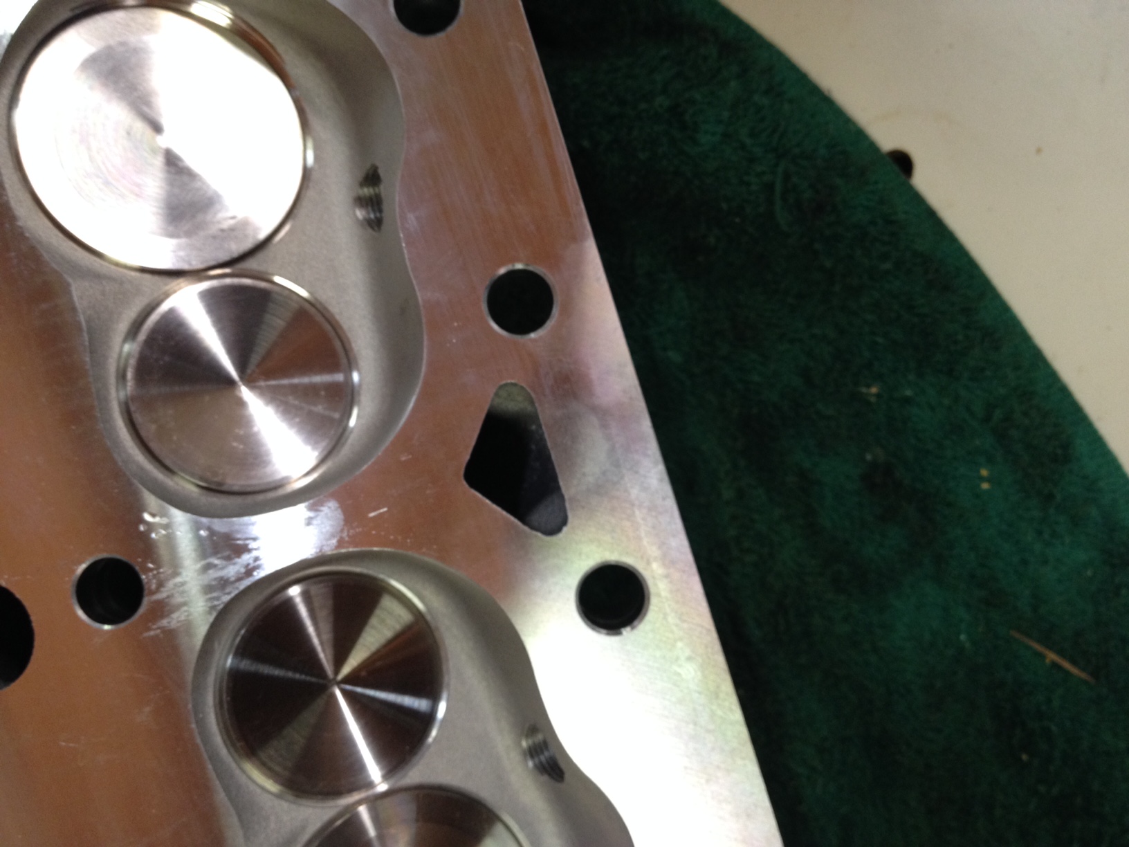

We had a good day yesterday. Nice weather and some good progress. We finished installing the rods/pistons in the block, torqued the rod bearings, installed the oil pump, adjusted the pickup for depth in the pan, and bolted on the pan. Engine is right-side-up and ready for the top end.

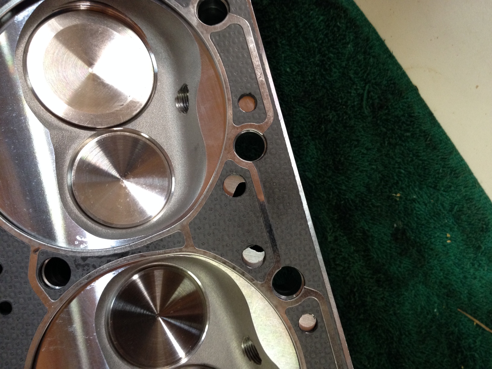

We did run into an issue with the Promaxx heads. The block has a pair of 1/4" water holes at the center bottom edges. The block holes match the gaskets perfectly but do NOT match the triangular holes in the heads.
We believe there's plenty of material so we could gasket-match the heads, opening up the triangular openings to uncover the water holes but don't wan't to void the heads warrantee. Alternatively, we could modify the gaskets and block holes to fit with the heads. However, the sizes of those water passages are no doubt engineered to get appropriate flow everywhere. If we expand those holes will we be disrupting flows in other areas?
I called Summit tech support and sent them pictures showing the issue. Summit referred me to Promaxx and gave me their number. Called them, emailed the pictures, and I'm waiting for a call back.

Promaxx called back but the rep, Chad, was better able to handle sales than head design questions. However, he was helpful and did go off to investigate and emailed and called back. Turns out, there are specific head gaskets that Promaxx recommends for those heads: FelPro 1003 (4.166" bore) and FelPro 1004 (4.100" bore). Chad said a holes mismatch question came up before on some Ford heads and the answer was the holes were purposely designed for proper coolant flow for the aluminum heads.
The only thing that MIGHT make that seem reasonable is the SINGLE holes in that area between cyl 1 & 3 and 5 and 7. MAYBE two full holes aren't required required between 3 & 5???
The head gaskets that came with the Summit gasket set weren't labelled for manufacturer. We chose the Felpro 1004 but it looks like they are being discontinued. WXO found them on RockAuto, listed as "Discontinued" for about half what they were listed at on other sites.
Below is a picture of that gasket from Summit.
https://www.summitracing.com/parts/fel- ... -_-fel-pro
They have 3 bigger holes in the area in question. We'll see how they match the block and heads and decide they're OK or maybe do a little filing.

As a last resort, read the instructions ...
The instructions for the FelPro head gaskets cleared up the mystery of the coolant holes.
We need to drill holes in the block.

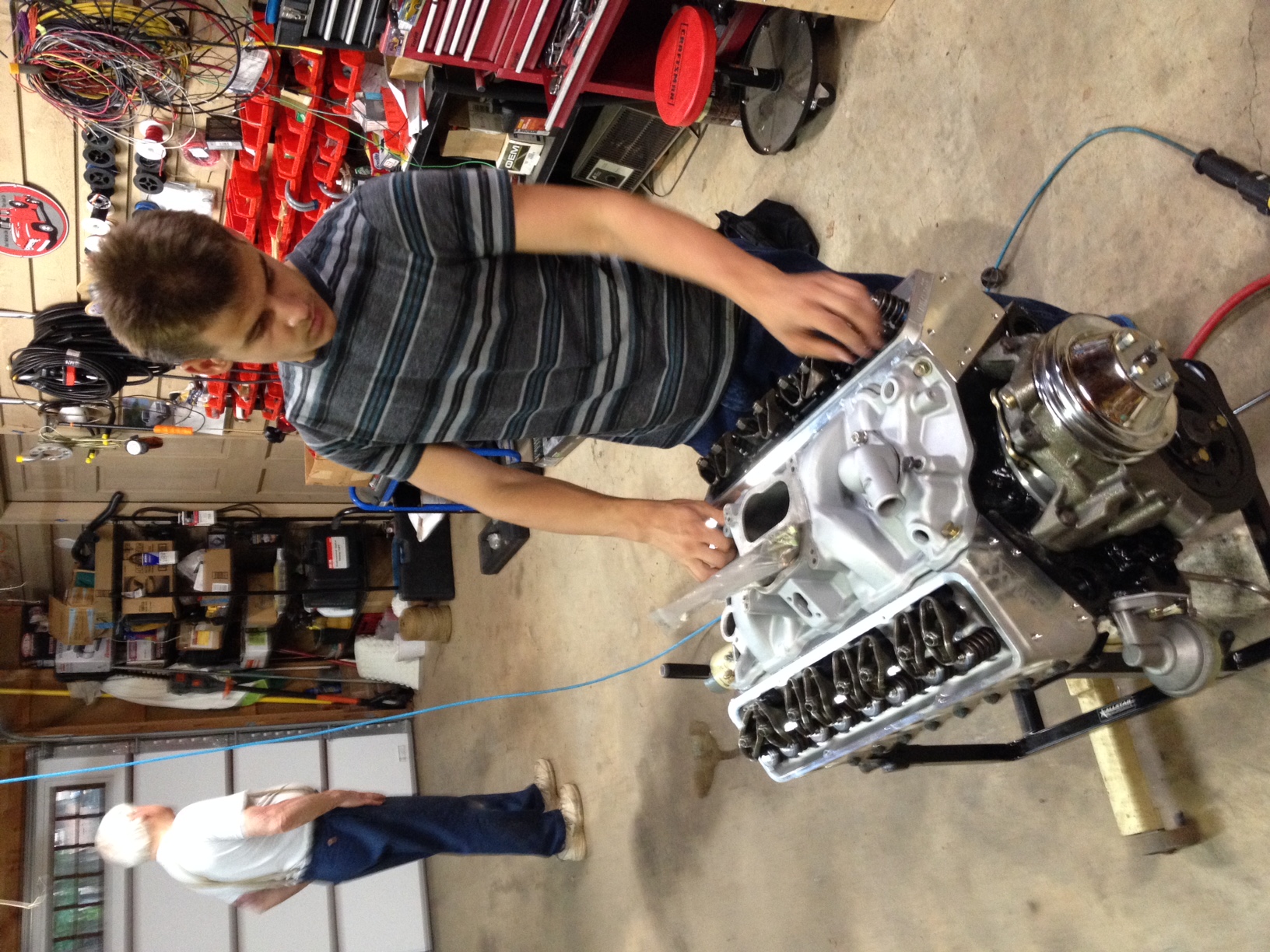

WXO, my grand-nephew Carter, and I worked on the engine two half days, yesterday and today. Checked the timing pointer and found TDC on the balancer at 2* BTDC on the timing marks. WXO will order an adjustable timing pointer for the 8" balancer.
The heads and intake manifold are installed. These heads require longer push rods than the 7 3/4" that came in the 350. The instructions for the heads say "7.900 are required but be sure to measure". I pulled out my 8" adjustable push rod from the Lincoln 521 build but, obviously, it was just a bit too long. Carter suggested removing the lock nut and,
, it was then just a bit longer than 7.9. We marked the wear area on the rocker arm with a Sharpie, installed the rocker arm, rotated the engine thru 2 valve lifts, removed the rocker and found marks from the valve stem going from one edge of the wear area to the other. WXO will find some pushrods of the length we need.
WXO also found a flexplate at rock auto for $22 shipped. That arrived today. Found some ARP 12-point flexplate bolts in my stash so that can go on anytime.
We installed the water pump and fuel pump. It's looking like an engine. I put up a post on the local Classic Chevy Club email list requesting parts and got a response from a member who has a "private junk yard" and has some headers, mufflers, an alternator and brackets for us. Hope to pick them up in the next few days. Only thing I can think of that we're missing now is a crank pulley.
It was fun having Carter to keep us straight, make good suggestions and turn wrenches. He also found two metal chips (no idea how they got there) on top of two lifters.
That would have been big problem had we set the valve lash and run the engine with those chips there.
After we were done, I took Carter for a ride in the Lincoln. The AC needs a charge so the windows were down. We enjoyed the sweet sound of the pipes and the sweet smell of tire smoke.

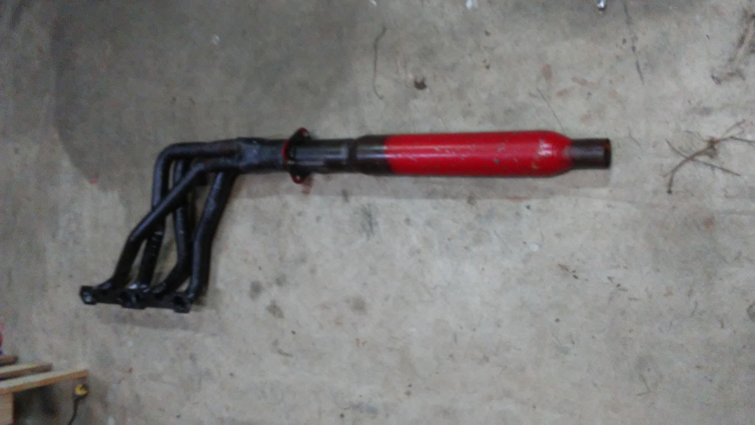

One Header Ready for Paint
Got one header de-rusted and treated with OSPHO.
The Cherry Bombs with the header flanges seem perfect to me but we'll need to quiet them down to keep peace in the neighborhood. They're built with a perforated, approx 2", tube straight from the inlet to the the outlet.
Some exhaust goes straight thru the perforated pipe to the outlet and some goes outside the pipe, thru the fiberglass and thru the perforations into the tube and out. We'll use freeze plugs as caps to force more exhaust thru the fiberglass and perforations.
We'll drill increasingly large holes in the caps till we think we have a balance of back pressure vs noise. Should work, we think.
The headers will be painted black. Wish we had some Cherry Bomb red for the mufflers.

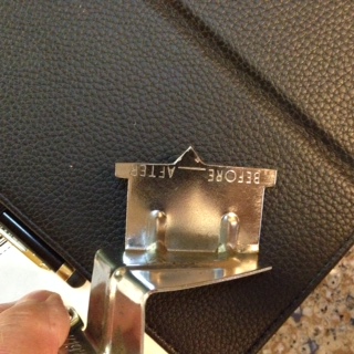

WXO took the timing pointer, which covers the entire rim of the balance, home to shorten it. I ordered timing tape and two oil caps, also supposed to arrive Friday.

I have the same issue with the aftermarket balancer/timing pointer I put on the Blazer. It's a degreed balancer, and I can't read the numbers because of the pointer. Very annoying. I ended up making a couple marks on the face of the balancer at a couple key positions. I'm curious to see how Walt shortens the timing tab.Maverick wrote: WXO took the timing pointer, which covers the entire rim of the balance, home to shorten it. I ordered timing tape and two oil caps, also supposed to arrive Friday.
Since we installed a timing tape, we didn't need the degree markings on the tab. So I just used a cut-off wheel to remove about a quarter inch of the outer part of the timing tab leaving just a pointer at TDC. As it turns out, I should have removed a bit more to allow us to see more of the timing tape, but this will do for now.
Before the heads went on, TDC was determined to be at 2* BTDC on the timing tab. WXO put the point at 2* BTDC so it now indicates correctly.
