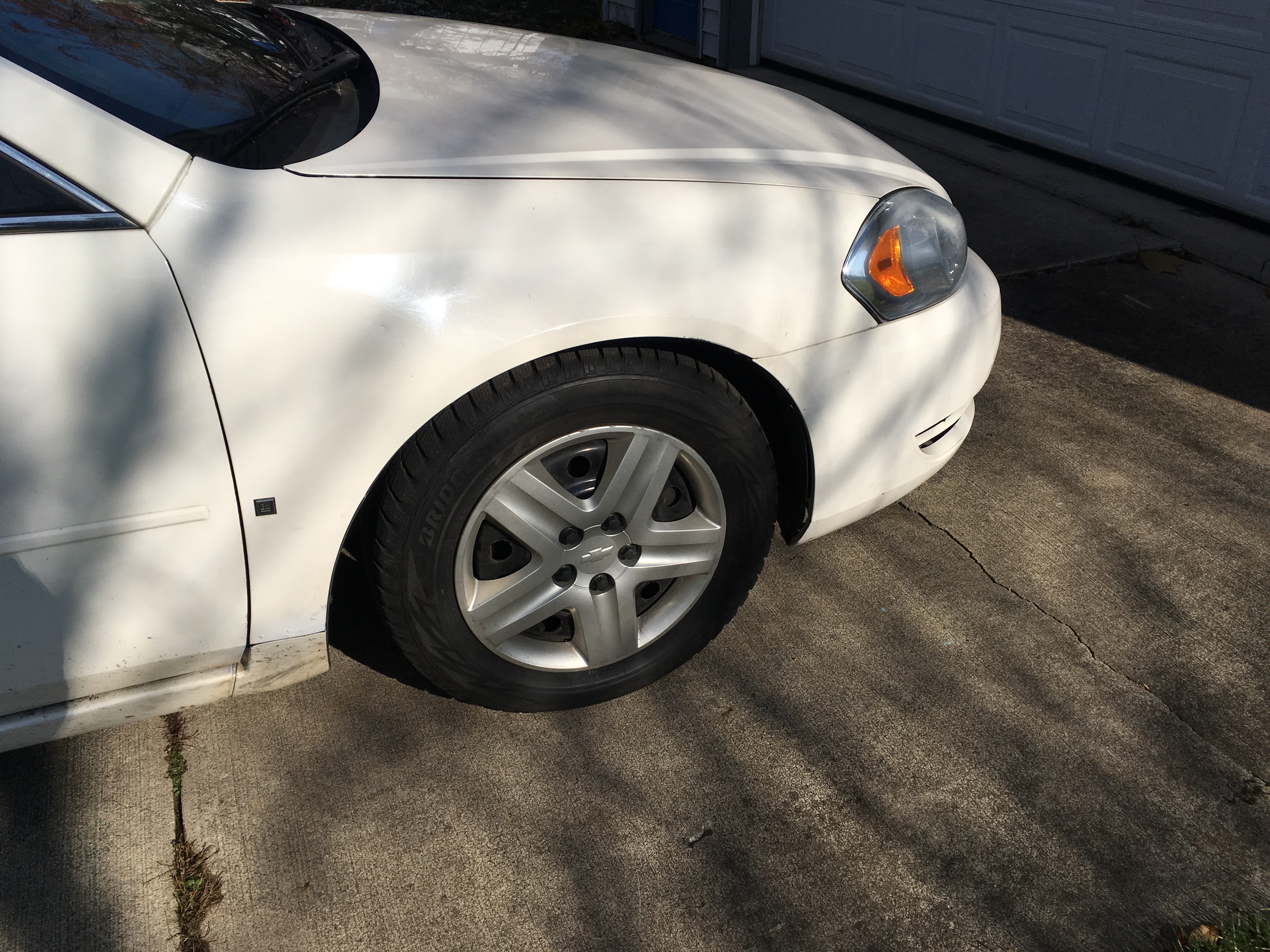

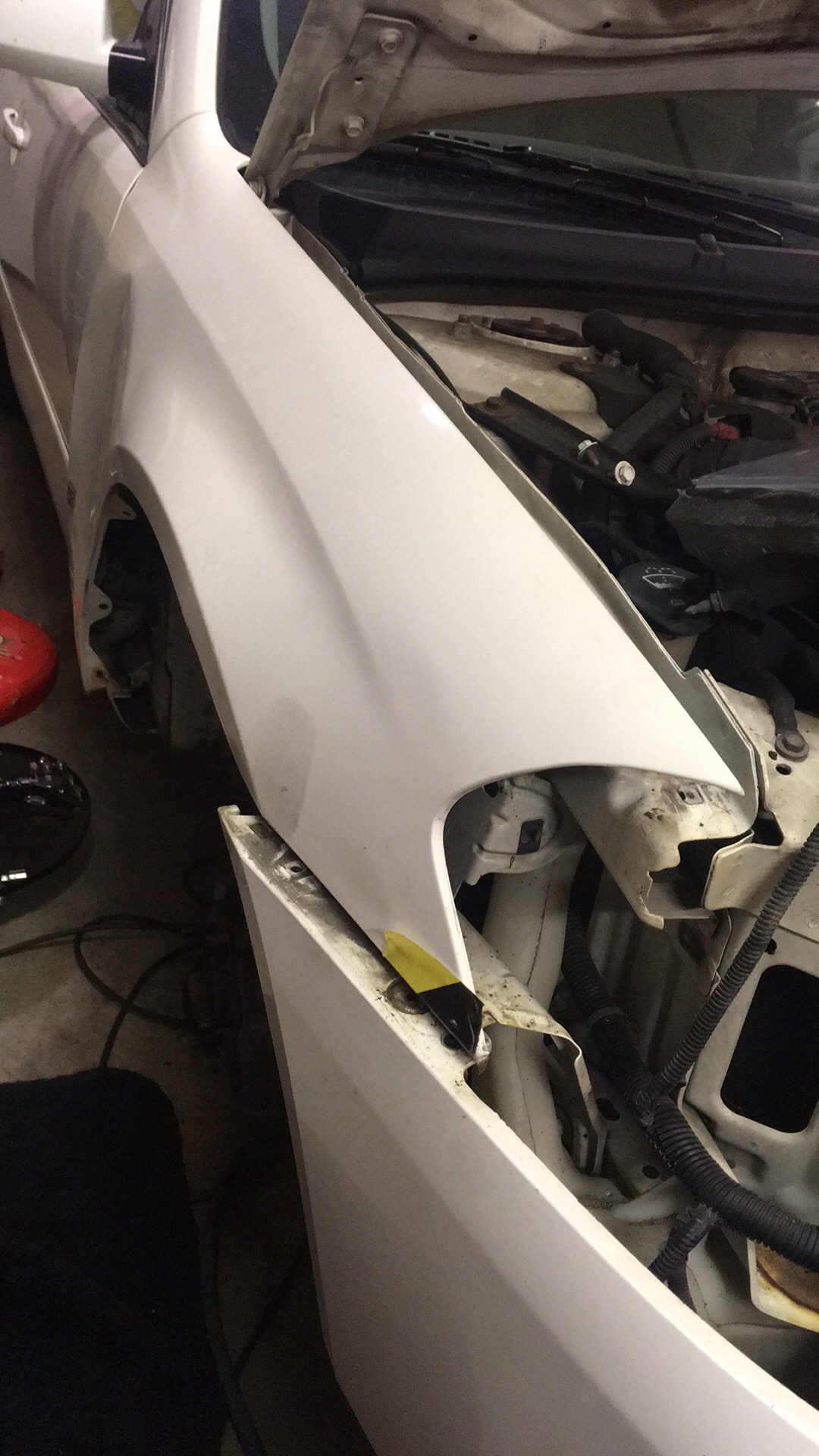

So this weekend I got to some prep. Both front inner fenders were missing so I installed them. The RF fender was damaged from the 2016 Nelson Ledges track day. It was rusty and the impact separated it at the rust. After several trips to pull a part with no white fenders I decided to fix this one. Took it off the car and attached a bottom section from a damaged fender I kept from the SS.
Also took the aftermarket wing off the back and put on the snow tires.
The windshield washer bottle was leaking but I think that was because the bumper cover was rubbing on the fluid level sensor - since it is press fit it must have been enough to make it leak.

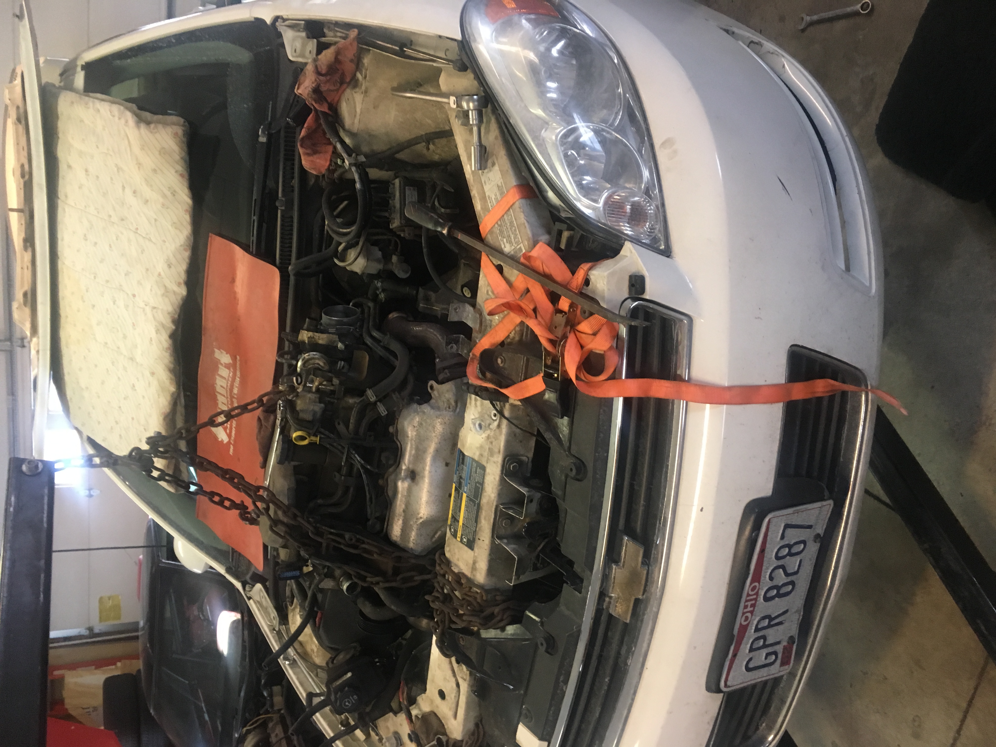

There are at least seven engine codes causing check engine light to be on with the 3.9 ECU and engine with the 3.5 wiring harness. Might just go back to 3.5 ECU - still deciding.

Out with the 3.9 and wounded transmission and in with the 3.5 and it’s functional transmission

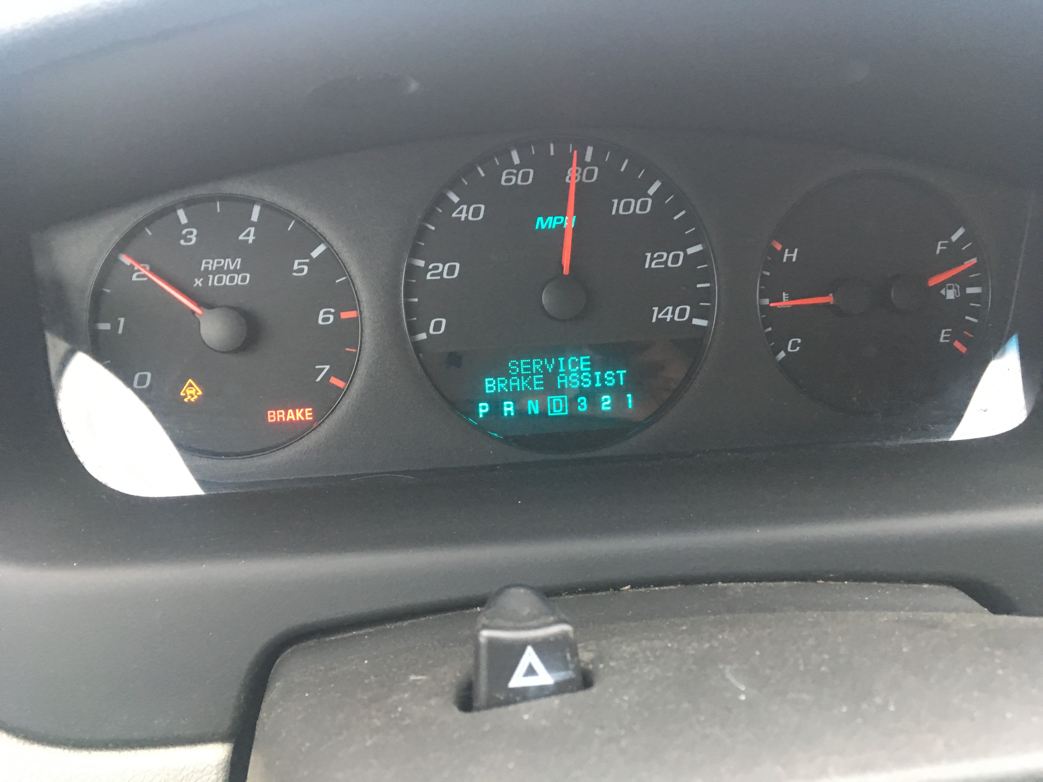

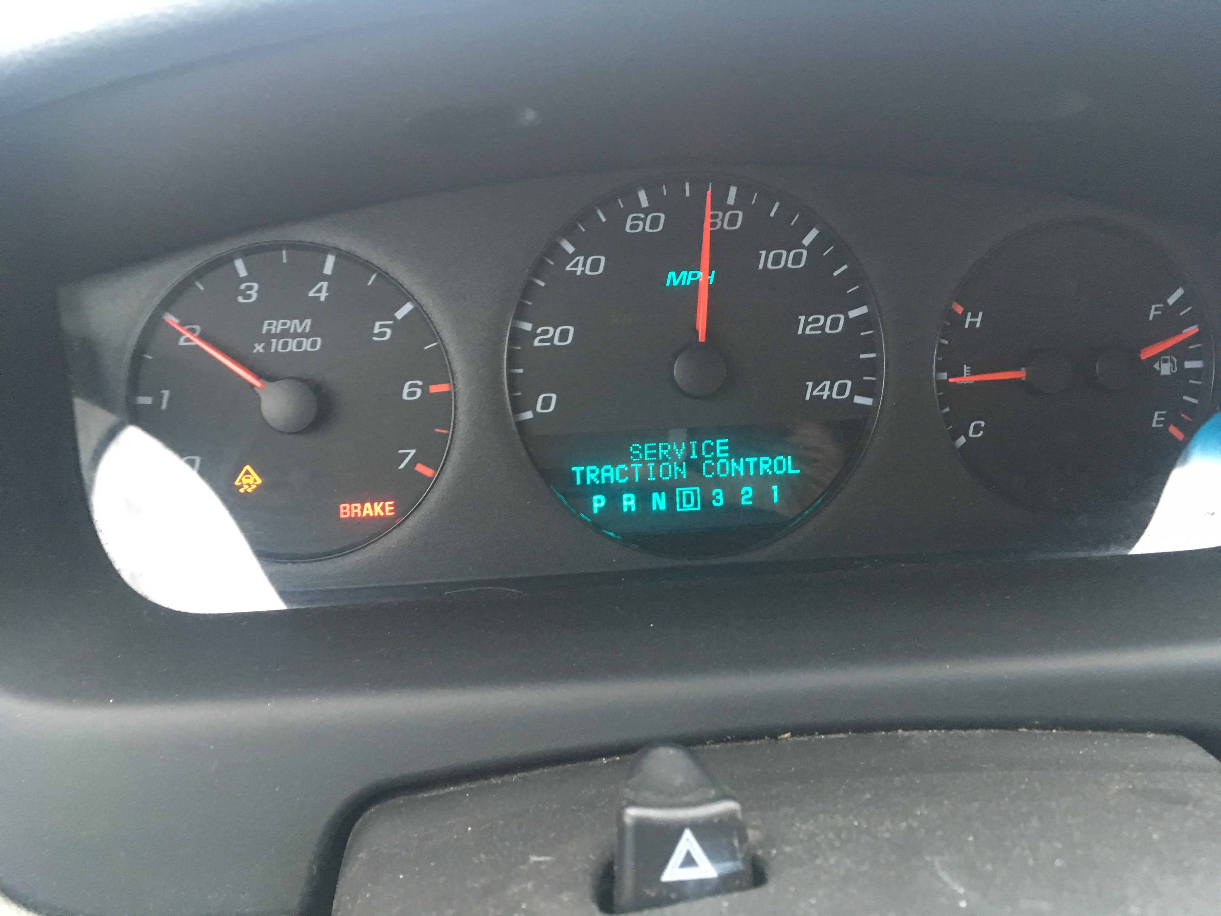

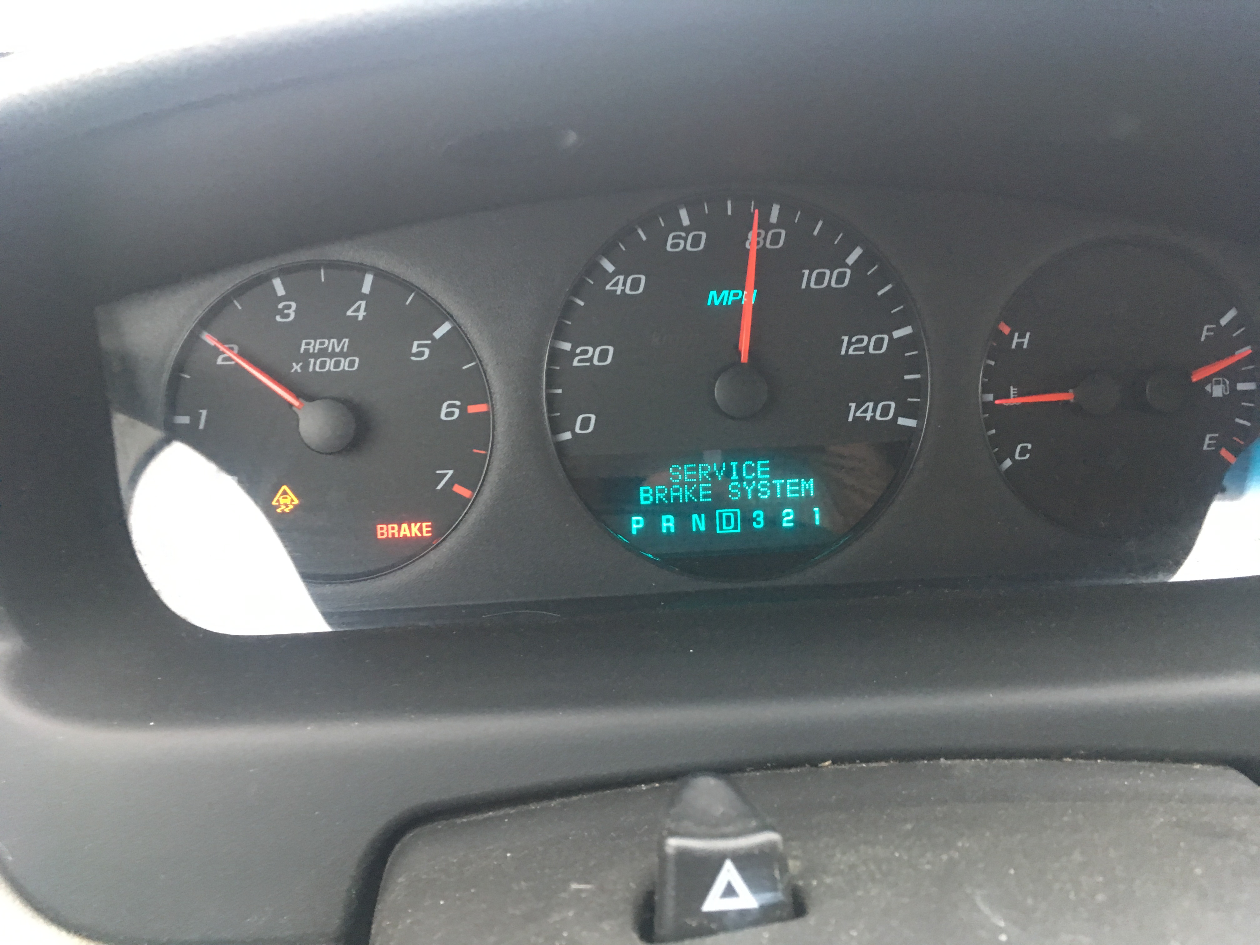

One nagging problem left to solve. At random intervals the red brake light and the traction control light on the dash come on. The display flashes out three messages - see pics. I have been working to resolve this for some time. I tried cleaning the grounds, I tried replacing the electronic brake control module, but the problem persists. I tried systematically disconnecting the ground wires so I know which ones are associated with the dash red brake light coming on. I replaced the connection on those wires to the block.
I don't think this is a common problem. I looked up the codes on the internet and found nothing related to Impala.
I would suspect an ABS sensor in the wheel but I have never seen the brake light on in the dash associated with that before.
Ugh there is more work to do to figure this out.

My 2000 Regal had weird traction control lights at random intervals. One time, there
was a ground wire by the right front on the frame. It was corroded and once cleaned,
cured the problem. The other time it freaked out, I had a wheel bearing that was bad,
and that made the lights on the dash go out. Somehow, the abs stuff ran through the
bearing and must've shorted out. Not certain this will help you, but I lived it.

One other symptom. When it is wet outside the lights stay out. GM did u notice anything like that?

As I recall, mine was opposite of that when the bearing was bad. It was good when
it was dry, but acted up in the wet. The frame ground issue happened out of the
blue.

So after sitting out all day in the wet and driving in the rain last Saturday the symptom appeared. Debunked that anomaly.

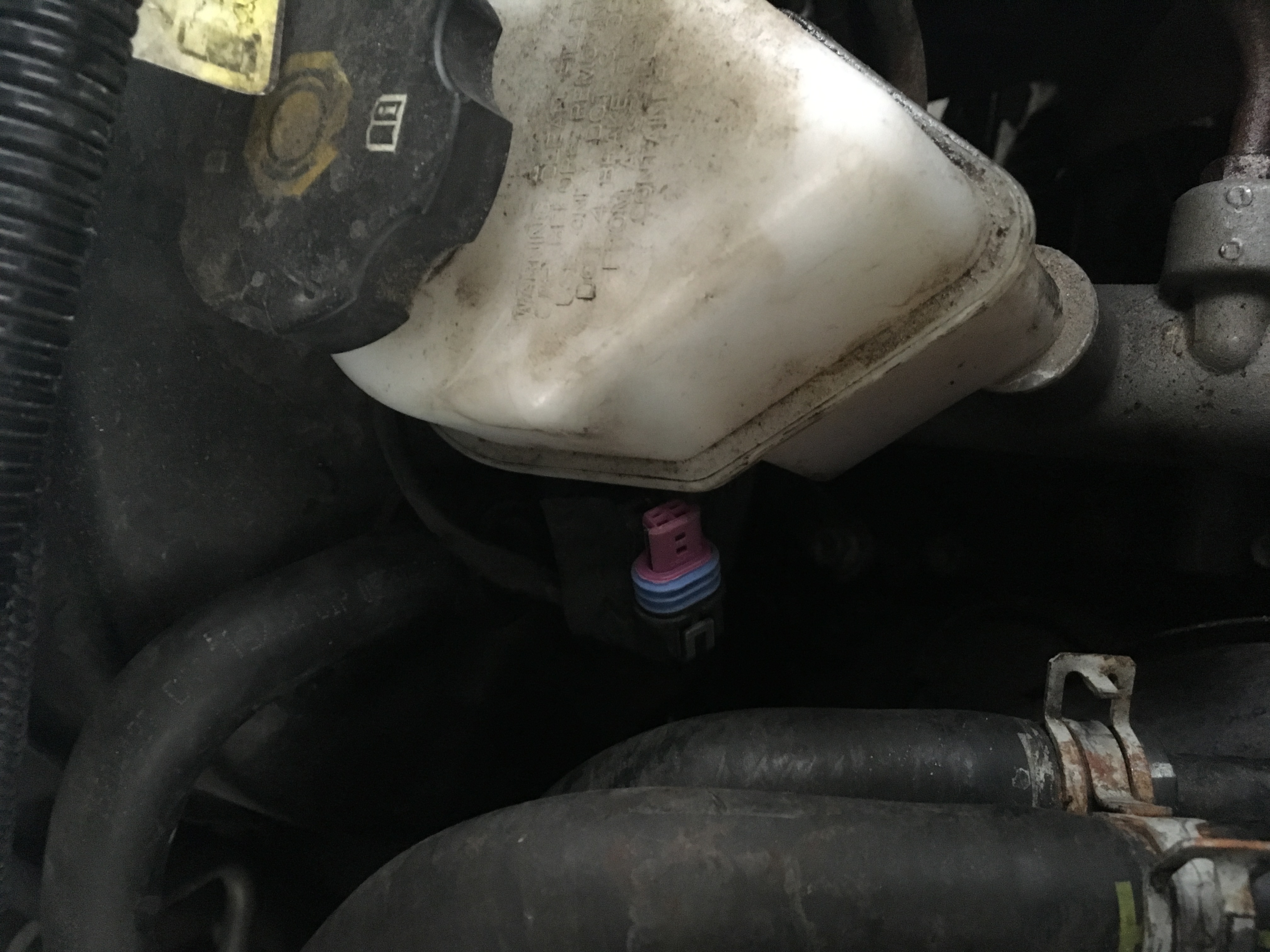

Going back through pictures I realized I had replaced the master cylinder in this car and made me wonder if there was any issue with the low fluid sensor. Today shortly after work the lights came on which prompted me to disconnect the sensor. To my surprise the light did not come on immediately. It stayed out the trip home. I had checked the fluid level a few weeks back but I am going to check it again.
I'll need a few days to know if this is the issue.

Just unplug the sensor and everything is fine!
Re: 06 Impala - Mostmint #37
The light has stayed out since unplugging the sensor. I ordered a replacement sensor I will install that this weekend.
I plugged the sensor back in on Thursday. It was odd but the sensor seemed loose in the reservoir. Light has remained out.
