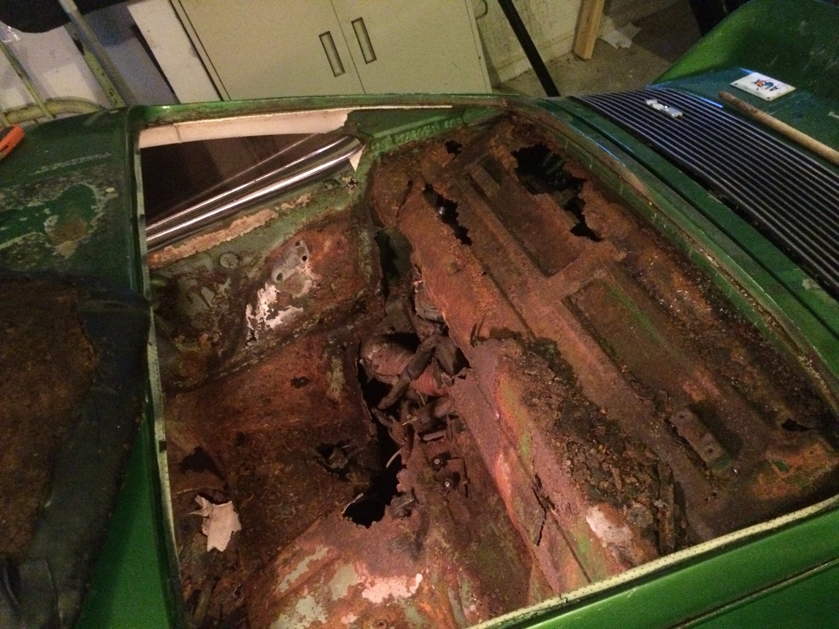

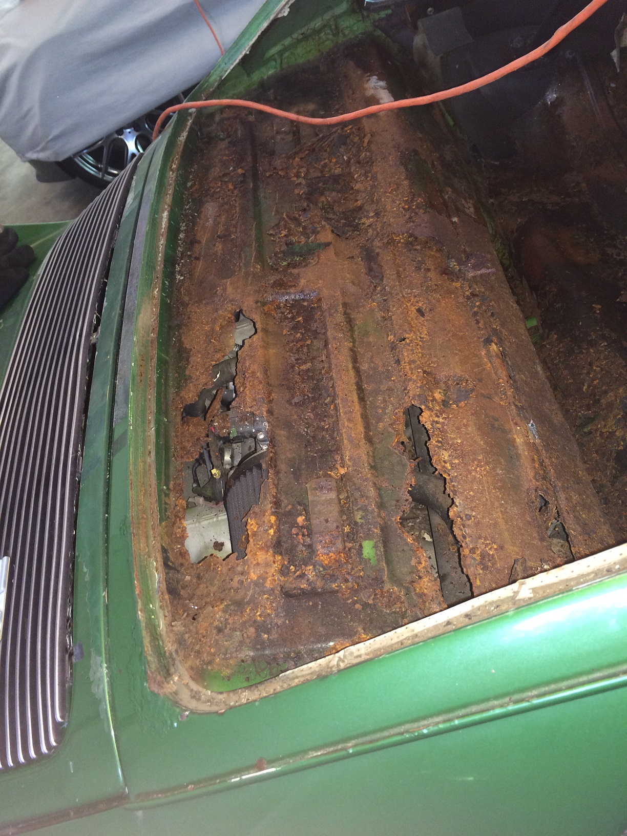

I found a BUNCH of rust under the rear package tray from where the rear window leaked. BAD.

I replaced that piece in the '68 Beetle I restored with a flat piece of 10 gauge steel. If you don't have a MIG welder (or a good buddy with one
) you could put it in place with steel pop rivets and then get someone to weld it. Or, if its going to be a driver, just rivet it every inch and apply seam sealer. No one will ever know. That's how I did the floors in the Beetle. I figured if they build air planes with rivets it should be good for a car. Don't think I'd use panel adhesive there since its a fire wall.

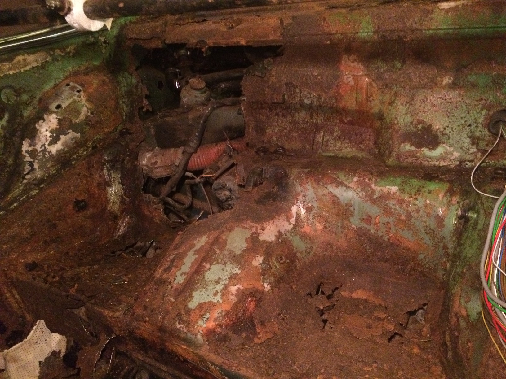

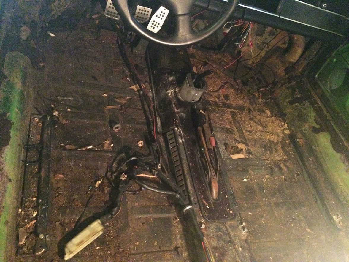

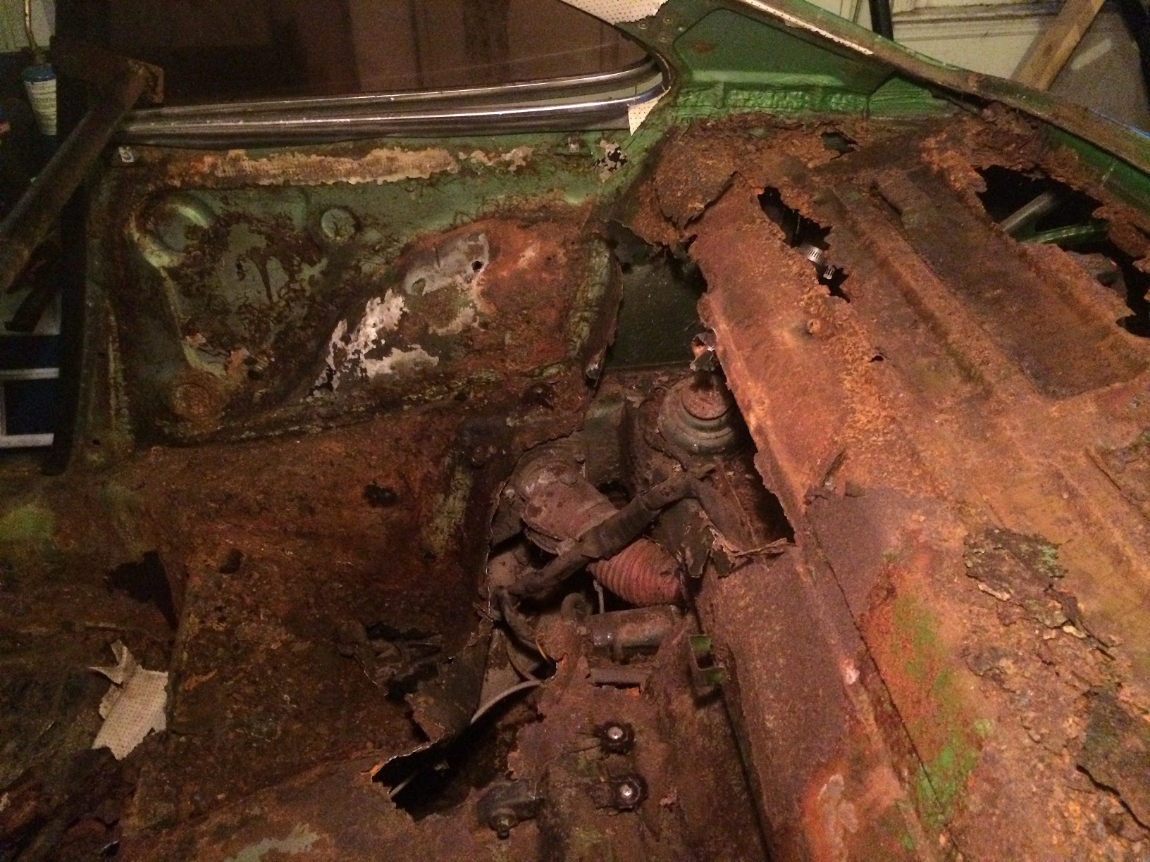

So today after work I removed the last of the roll bar, the rear seats and the carpet/sound deadening.............Guess what.............This is what happens when you let the carpet get wet and then let the car sit for 10 years. You can OBVIOUSLY see EVERYWHERE there was sound deadening and carpet, just look for the rust line..............

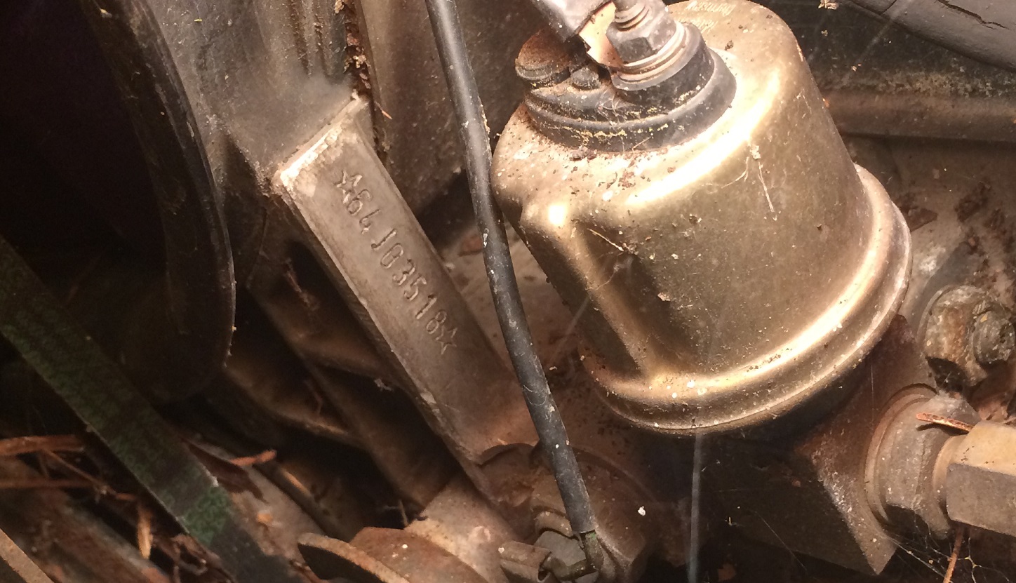

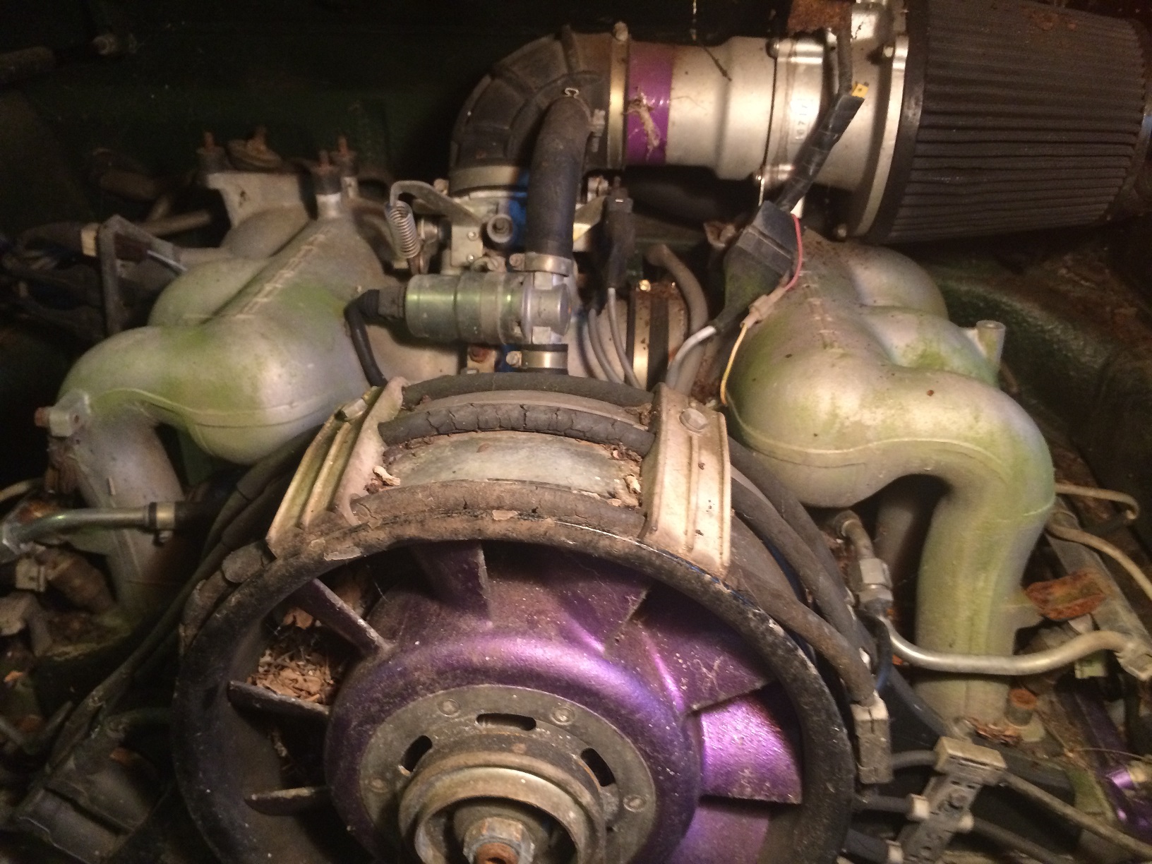

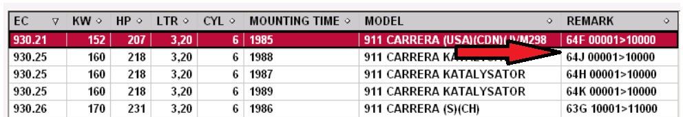

ON THE GOOD SIDE. I think I have confirmed that the engine in the car is a 218 hp 3.2litre from a 1988 Carrera.

Even though it looks terrible under that window, it looks pretty clean in the engine area as far as rusty parts are concerned.
