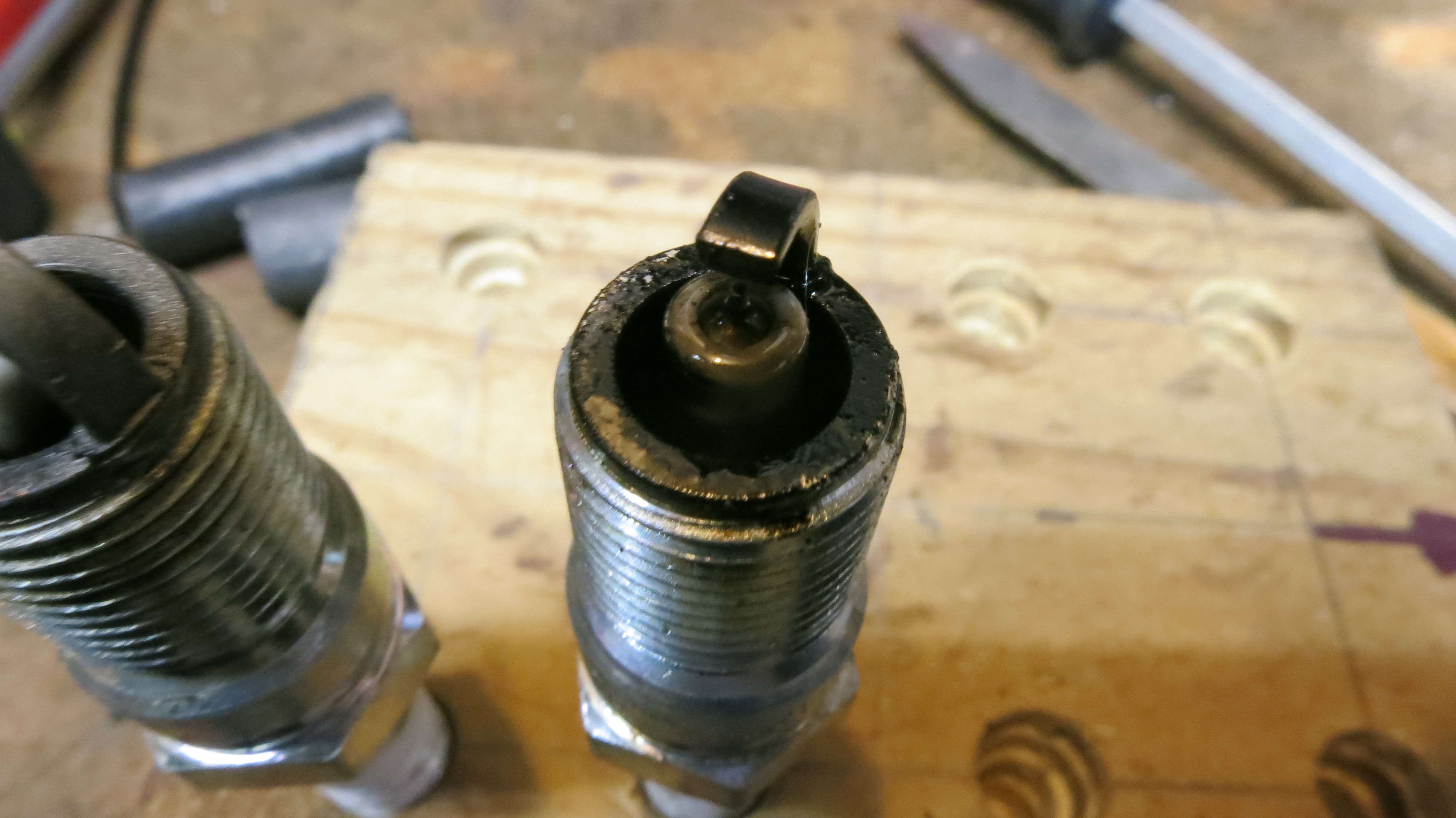

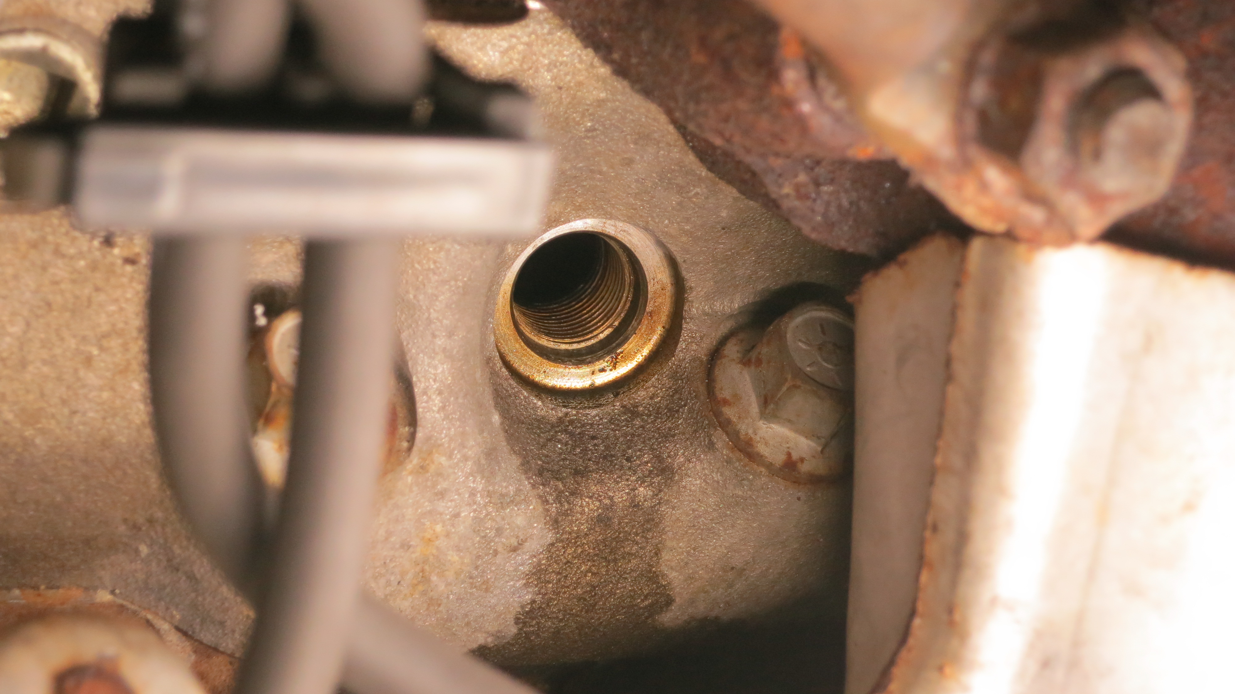

I spent this afternoon gathering more info on this cylinder flooding problem. I removed all the spark plugs starting with the most difficult, #8 (pass side rear). They were all wet to some extent, but #6 was obviously the cylinder with the problem. Number 1 was the last one I removed. You can see in the photos that it is still wet. The gas had evaporated from the others. On the drivers side where I could see the plug hole for #3, I snapped a picture showing the evidence of the fuel running out when I removed the plug. Since they all came out wet to some extent, I think this was the case for all the plugs.
#6 just after I removed it.From the passenger side#3 hole When I put the car on jack stands to change the oil, I noticed a big 2ft pool of gas on the floor. I looked at the dipstick and it was waaaaaay over full. I drained over 8 quarts out of it! The specs call for 4.5 quarts for a fill, so I had about 3.5 quarts of gas in the oil pan.
I need to understand why all the cylinders had gas in them if the flooding was in cylinder #6. Looking for evidence of why this happened, I plan to remove the fuel filter, cut it open and look for debris that may have caused #6 injector to stick open.
