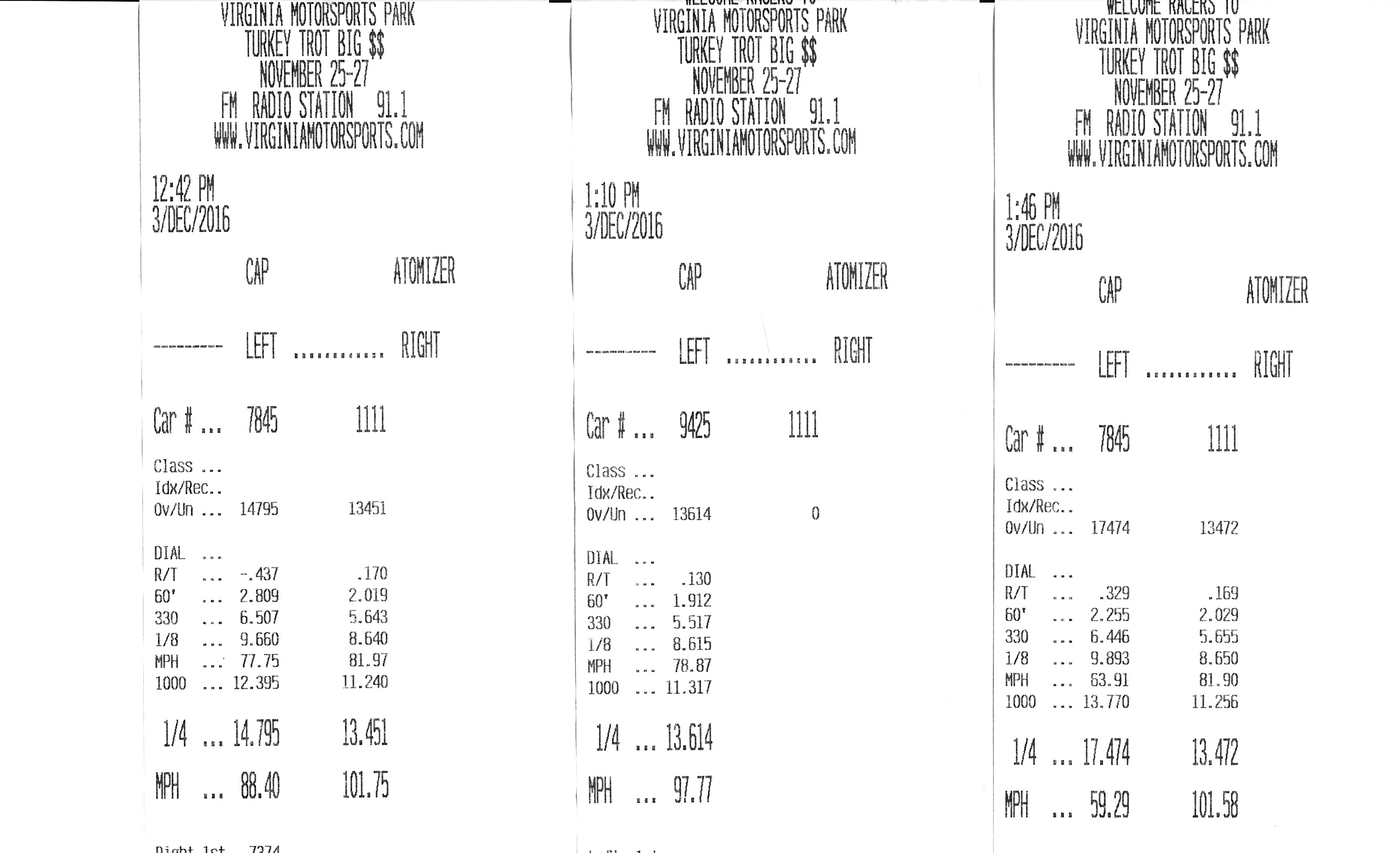

When our trip to Rockingham Dragway was cancelled, Maverick, Jim Hall and I took a trip on Saturday Dec 3rd to Virginia Motorsports Park for some 1/4 mile racing. Most of this trip will be documented in Maverick's project thread for his '78 Lincoln Continental Coupe. It was a chilly 47 degree, sunny day and the cars were running well. An accident and subsequent cleanup delayed our start, so we were able to get only three runs in. Maverick and I were kind of pathetic at the starting line. First run, he screwed up. Second run, I messed up. Third run he hit some water on the track at the starting line and spun his tires. We never did get a good head to head run. From the time slips, though, we were running really close. I wish we both could have had good runs at the same time. Anyway, regardless, we had a great time. We were both pleased with our times for the day.

I like VMP's time slip. As you begin to go there more often, those starting line clinkers will disappear.

WXO, if you look at your best, run 1, and my only good run, run 2, I'm with you to the 1/8 mile but you get me in the top end. I thought my brick might have the advantage over your SUV in the top end but not so. Aerodynamics is obviously more than frontal cross section.
I'm looking for a secondary metering block with power valve to get the WOT AFR into the 12s rather than 13s. As we said, we'll try again in the Spring.

I forgot to mention that I was running drag radials this time. A couple of years ago I bought a set of stock TBSS wheels with a well used Nitto drag radials on them. I decided that it was time to bolt them on for yesterday's trip to VMP. I arbitrarily set them to 18 psi and went racing. What a difference from street tires! They just hook up and go. I don't have to be concerned about peddling the truck out of the hole. It's just one more variable that I don't have to worry about. I was leaving at about 1200 rpm. I wonder if there is anything to gain by increasing the rpm. I'll have to experiment when we go back in the spring.

A lot of people have different theories on the best way to launch for good ETs. On a car that I know will hook, I ALWAYS come out as far into the converter as I can get. To me it gets the most consistent launches and I think your TB would be no exception with the drag radials on it. That's a big tire and you don't have a crazy loose torque converter, so I think it will just stick and get. 18psi is a good number for the lower profile drag radials. That's where I run them on my S10 (255-50-16) and they hook pretty well all things considered. When I had my 275-60-15s on my Trans Am I ran them at 15psi because of the bigger sidewall.
For most drag radials they claim that you should do a small burnout to get just a little heat in them and clean them off, and pull up to stage. The exception is the Mickey Thompson's. I had those and they needed lots of smoke to get them to hook. Of course, they don't last very long...

I think, with drag radials and holding it at 2,200 rpms ( if it'll let you ) you
have at least a tenth of a second coming to you.
