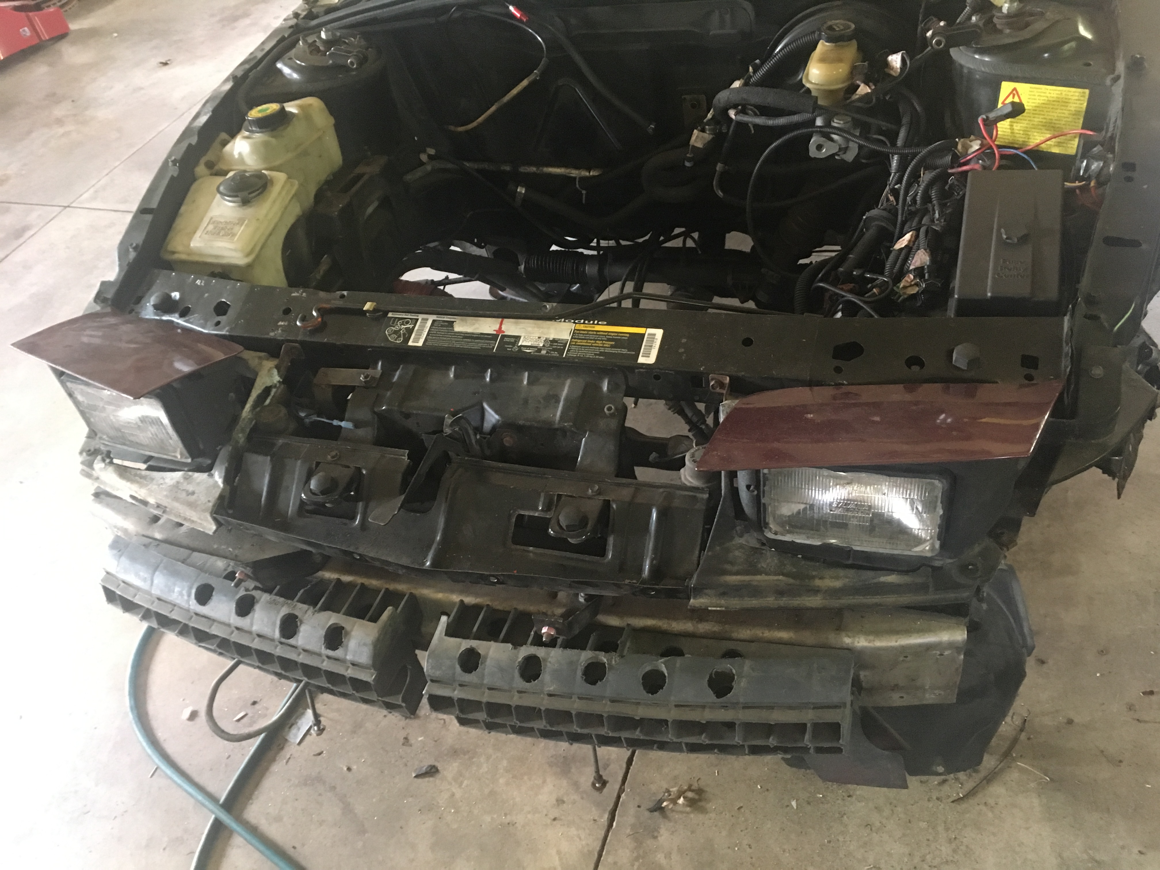

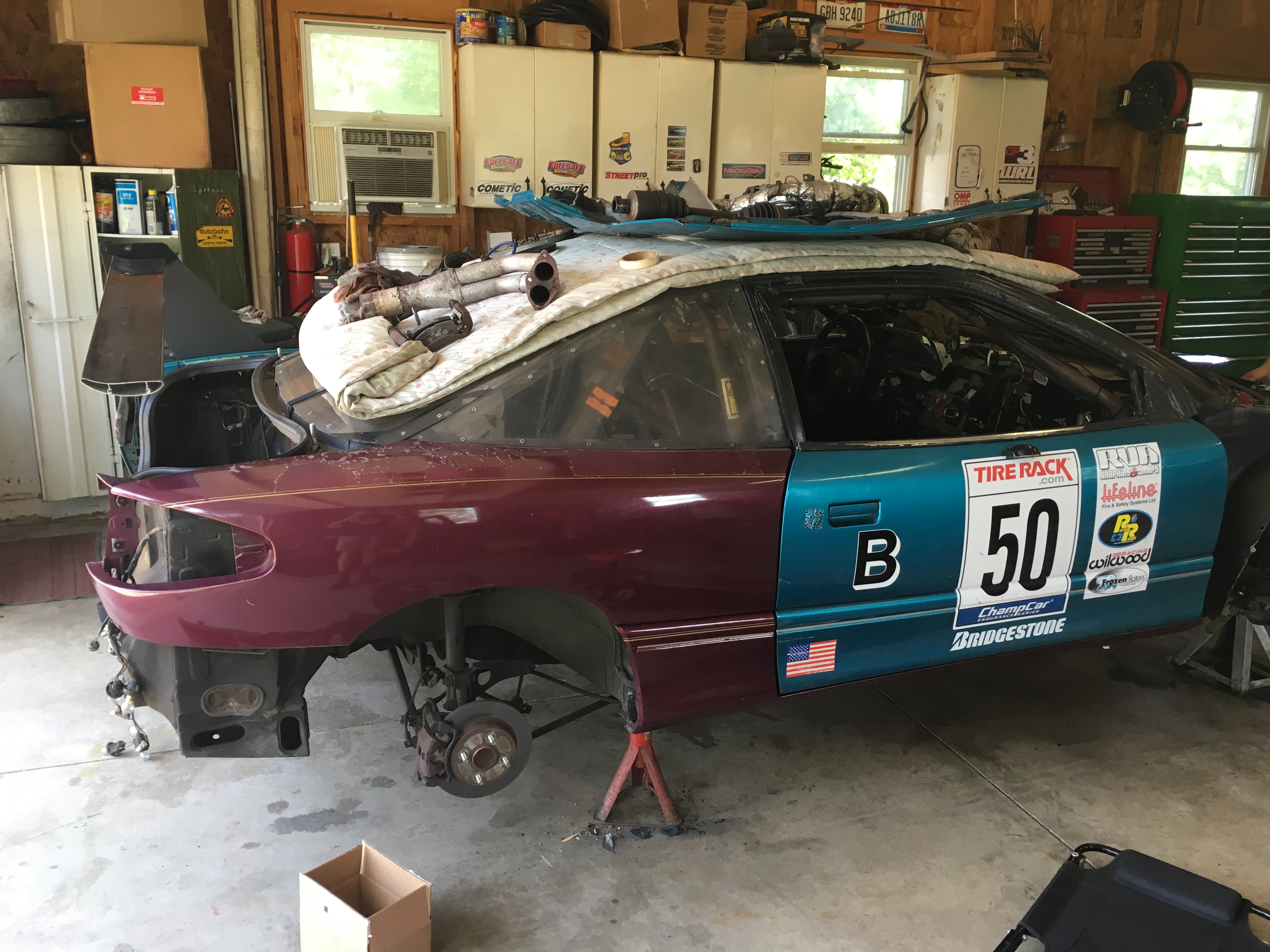

Pics are after the right rear has been largely fixed and the replacement panels fit well. Both headlight frames were broken so we put replacements on the car

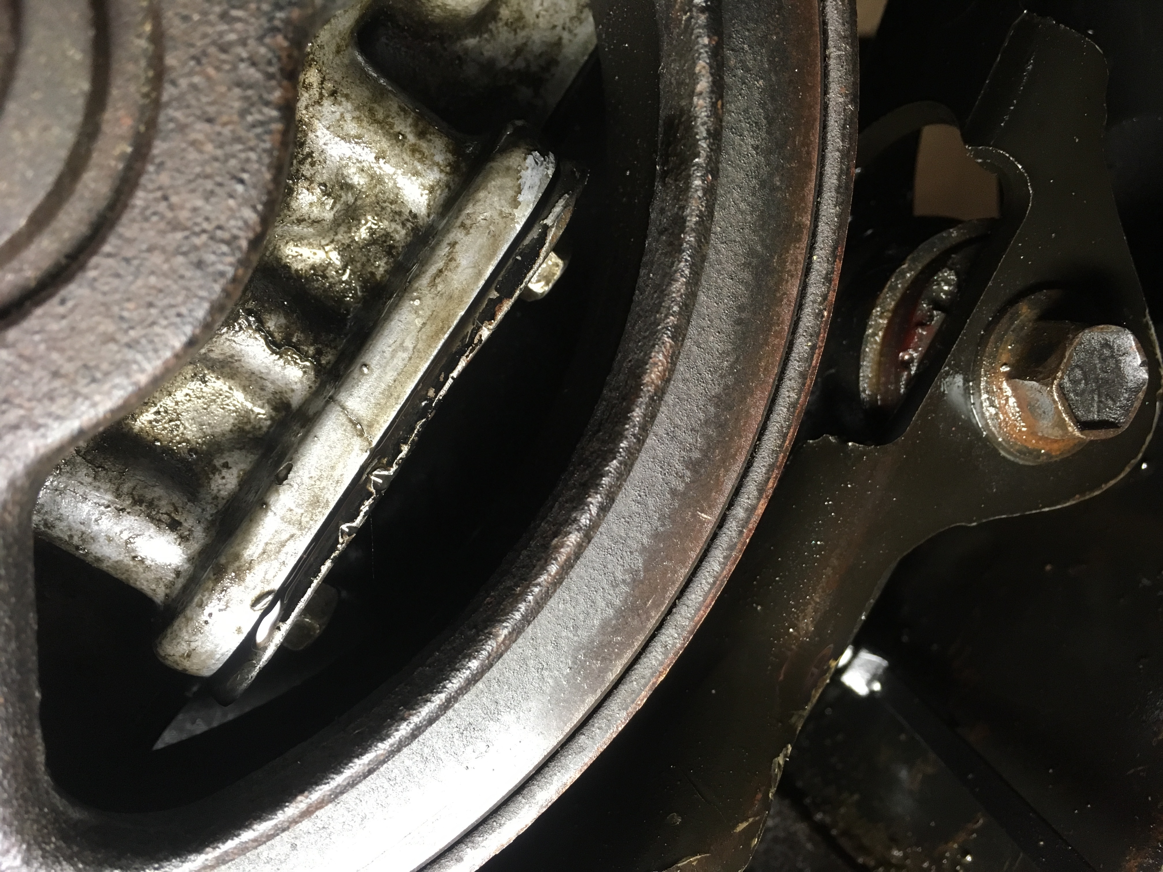

Car got back together and put on track last Saturday. Uncovered a crack in the timing chain cover. Contemplating options - either pull it all apart and change the cover or weld it back together, or go with JB Weld

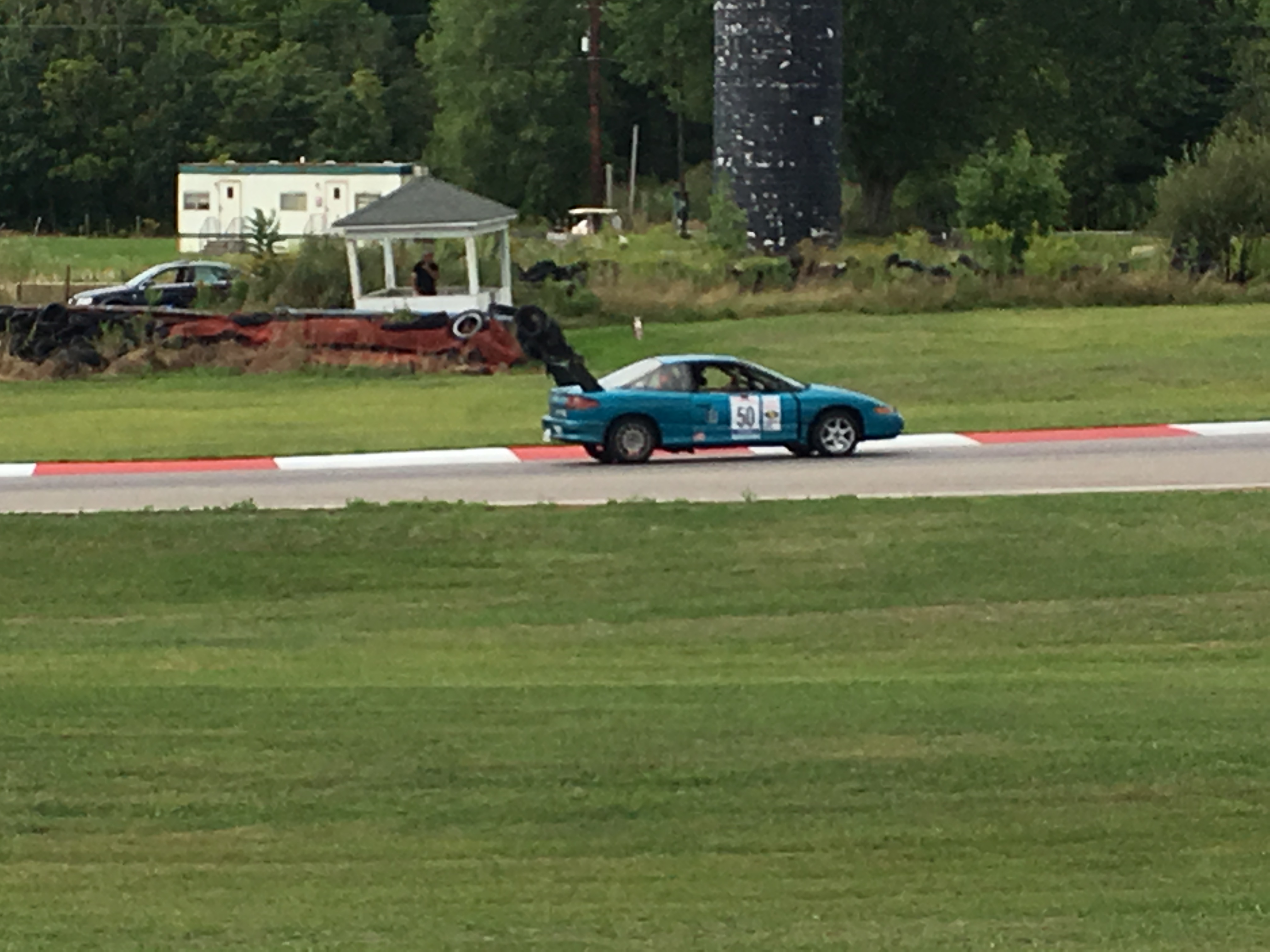

Track Day was a fun activity, several lapping sessions.
'Smoke joined 32V and the MintOne to party at Nelson Ledges.
We did run four different sets of tires on the front 6 laps at a time,
collecting secret data after each pit stop. Don't touch the removed lug nuts!
Discovered that oil leak.
Not quite sure why, but it was great fun!

So far I have repaired the RF headlight headlight frame, RF fender and replaced the RF sidemarker. Also changed out the RF rotor and reattached the brake duct where it had separated.
