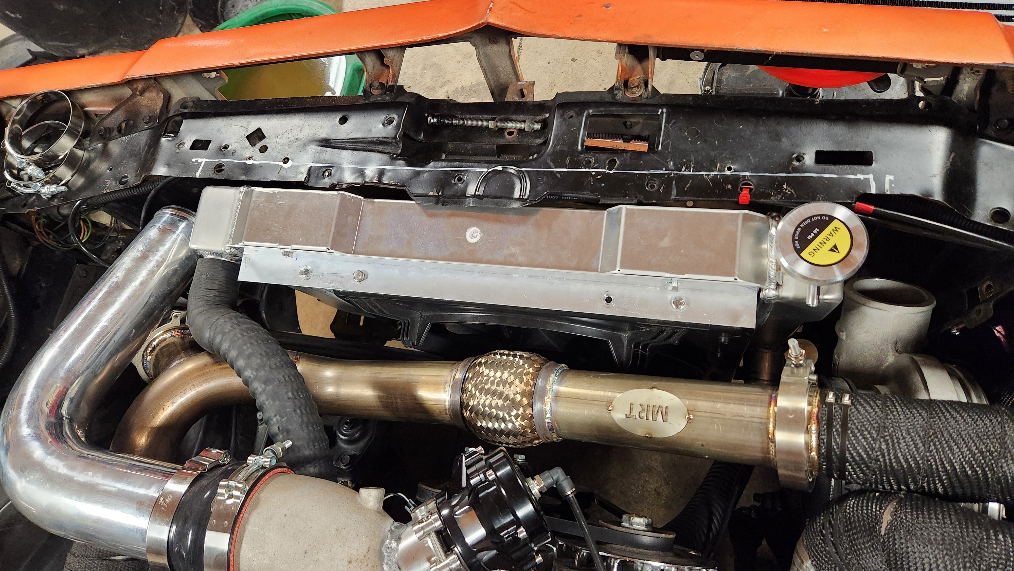

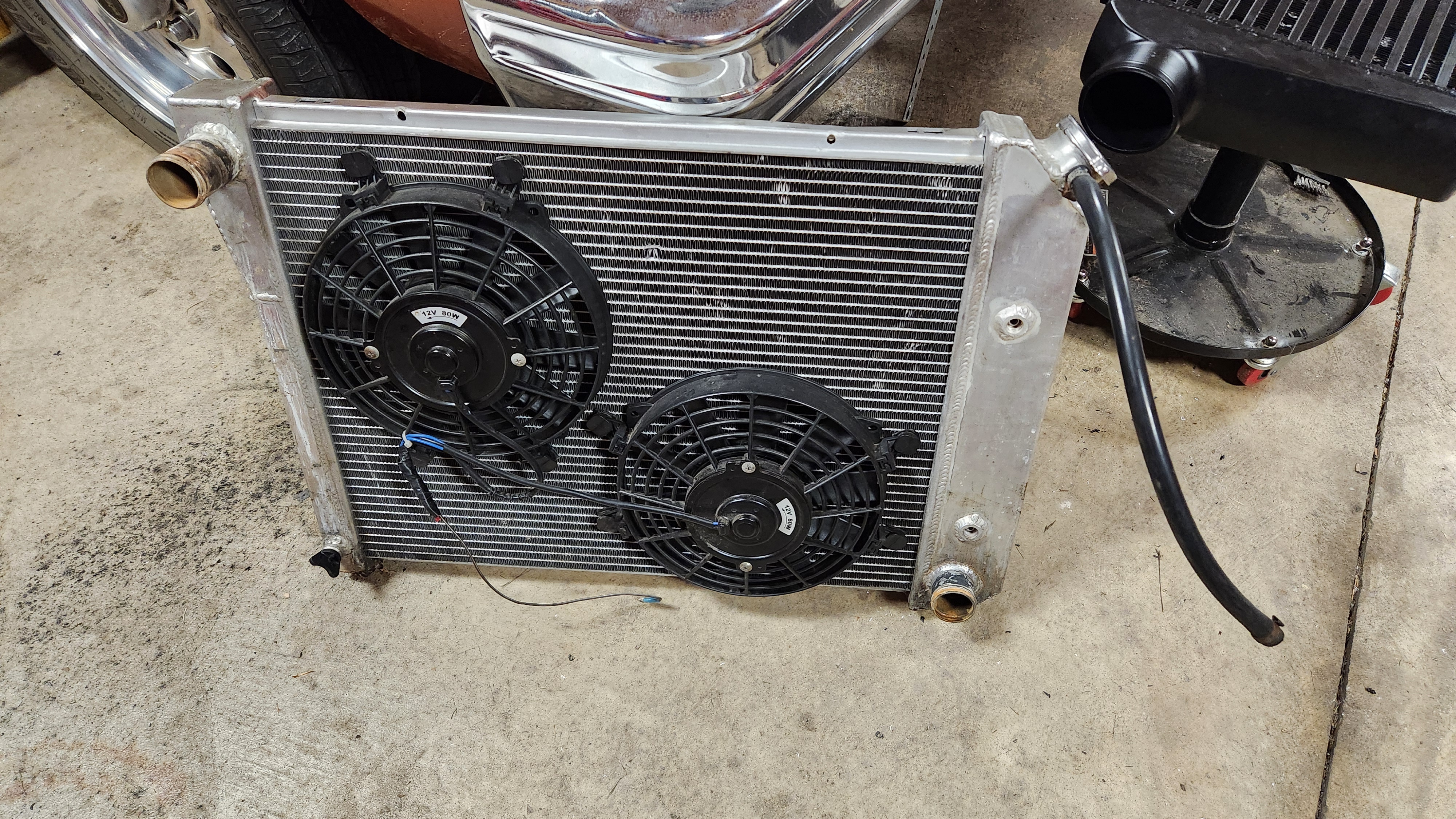

This weekend I started tackling the new radiator + fan install. The old radiator +2fans that came with the car were just not up to the task. Even when was at Dragway 42, it got up to 200 and was a pain to cool. I have limited room to work with, so I got a Proform radiator with the same height/width, but an extra row/core. I'm also using a factory GM fan from inventory that I believe will move much more air.
The big problem with this is that I need to move the intercooler forward, and not even that much, maybe 2-3" There's room to do it, but there will be cutting on the core support to make everything fit better. I also had to re-do the mounts that support the intercooler from the bottom. Paul was able to weld a couple bolts together to make those. I ordered some new silicone 90* elbows with longer legs, they should be here in a day or two.

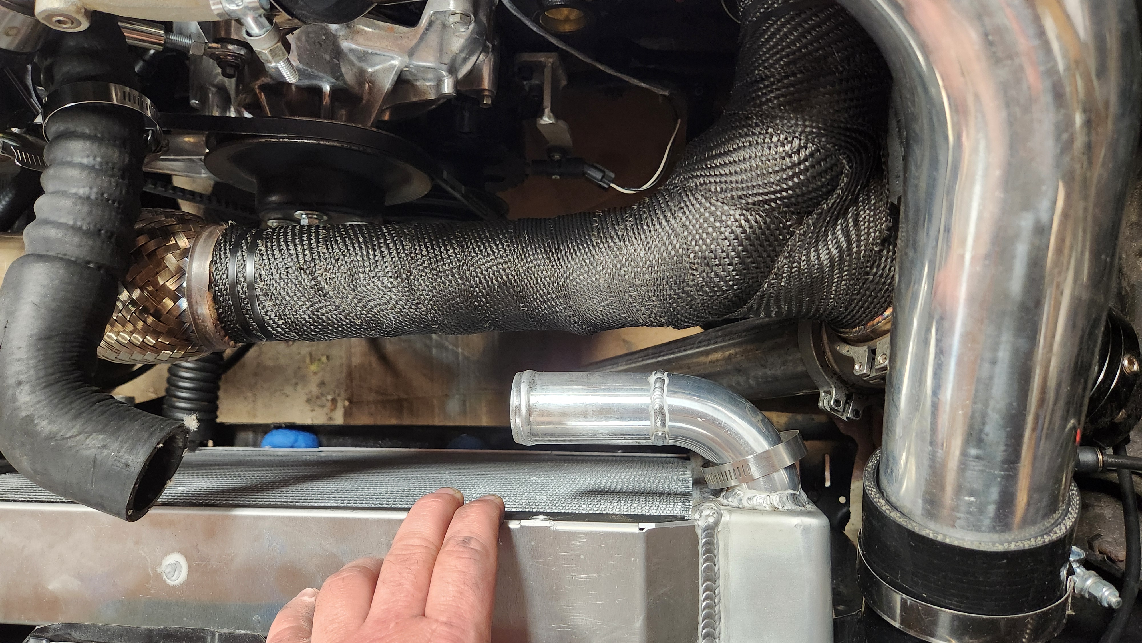

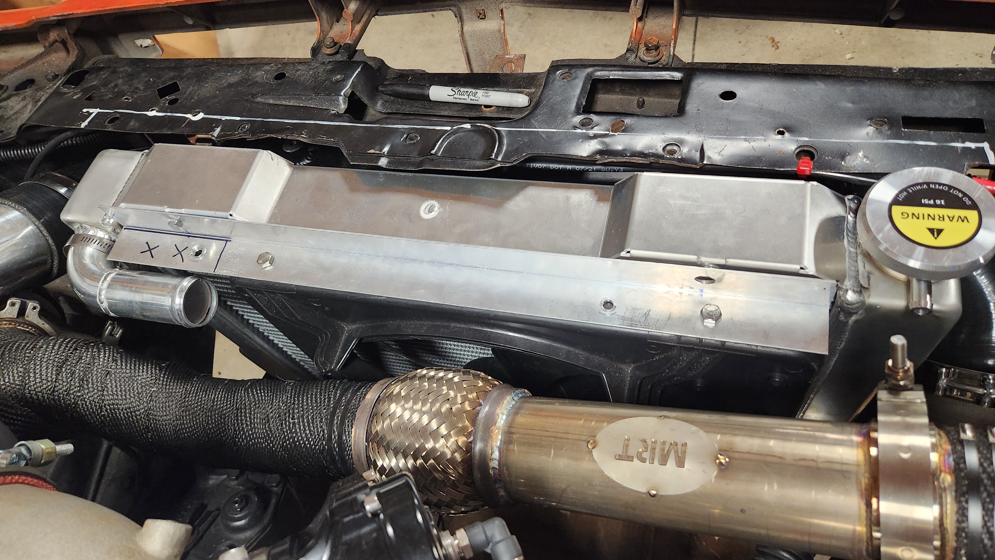

I got my new radiator modified by Steve McBride.. I think this will work better. I need to find a different hose. Worst case, I might have to have Steve shorten it up a bit, though.

That looks pretty slick. I'm sure there's a ready made hose for that scenario.

The plan is to just use a flex hose, similar to what was on there, minus the molded 90* end. It should just make a nice arc from the thermostat housing, like Mr. T's mohawk.

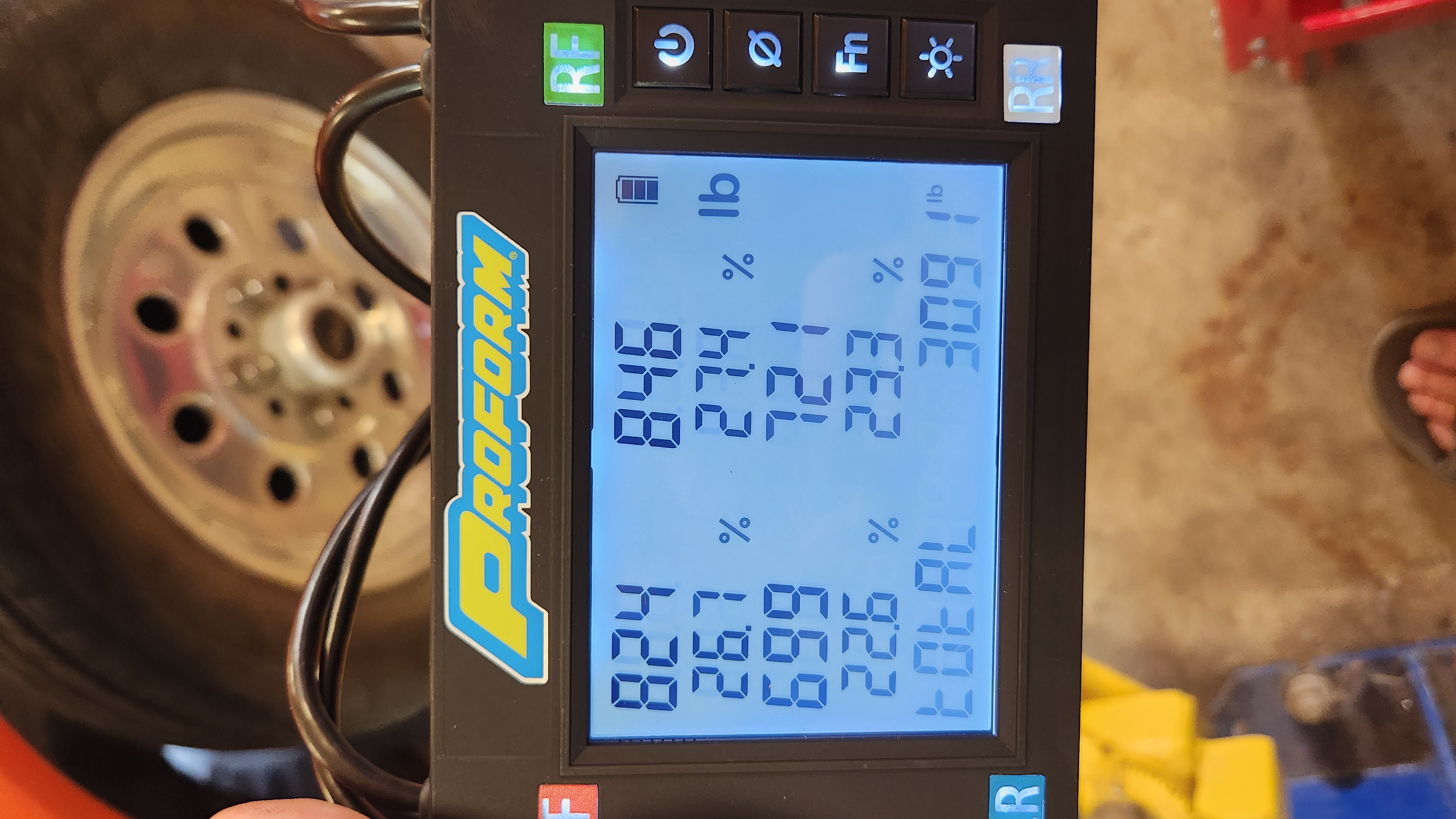

Went to breakfast this morning with Paul and Kevin and decided to pick up the scales.
Brought them home and weighed the car..
