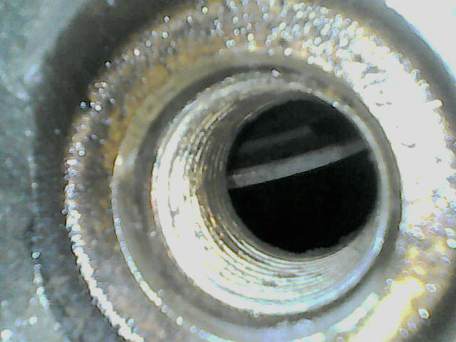

I would be surprised if, once I get this plug back in and tightened properly, the mysterious noise isn't gone. Before I put it back in, though, I plan to borrow Maverick's endoscope and take a peek inside that cylinder to see how things look. I'll post a picture if I can.
Here's a photo from the endoscope looking into the #8 spark plug hole.
I can't make out the detail of the threads, but they appear OK. There appears to be an open valve in view. I wasn't able to position the camera to get a better look at anything else.

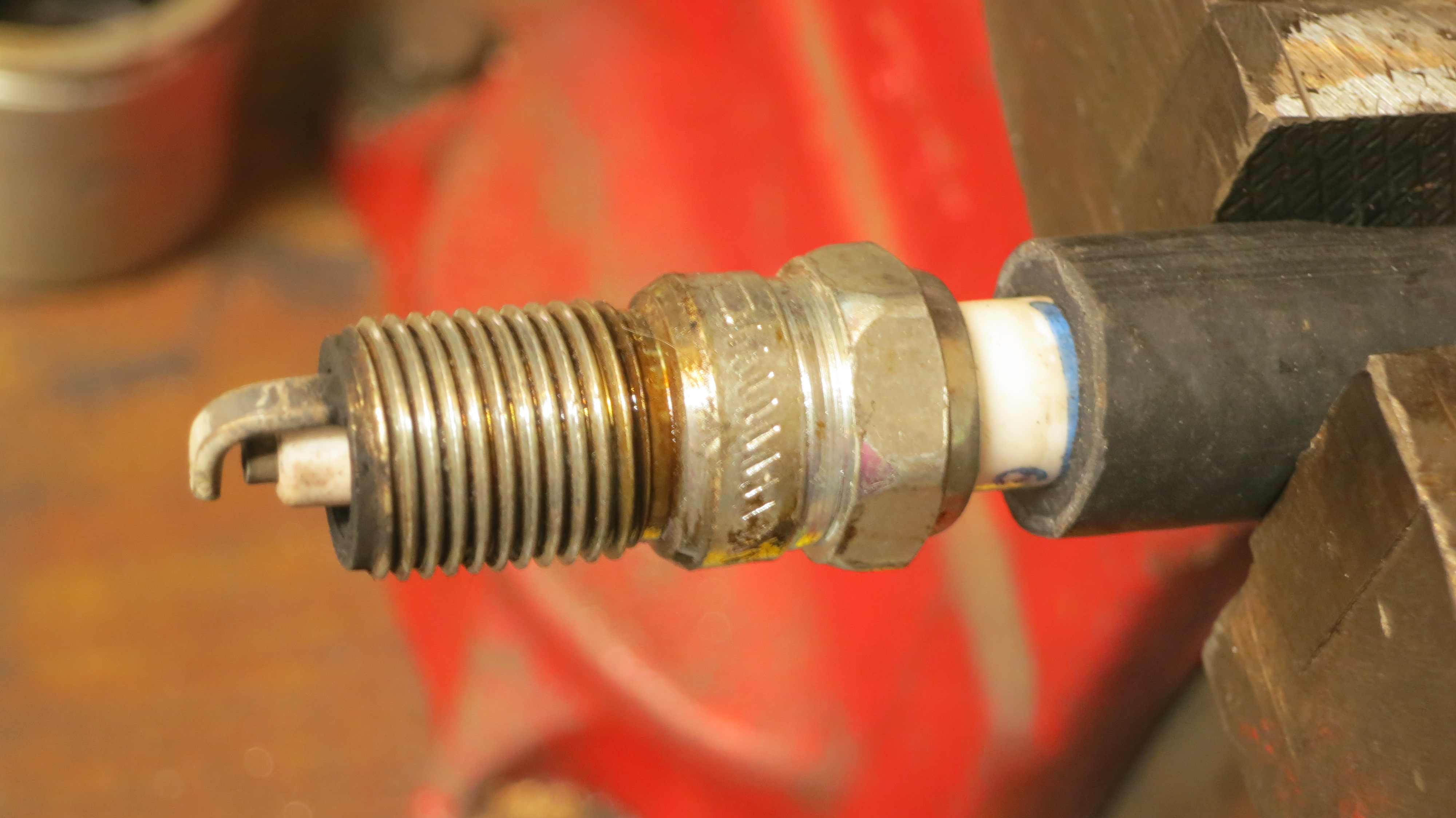

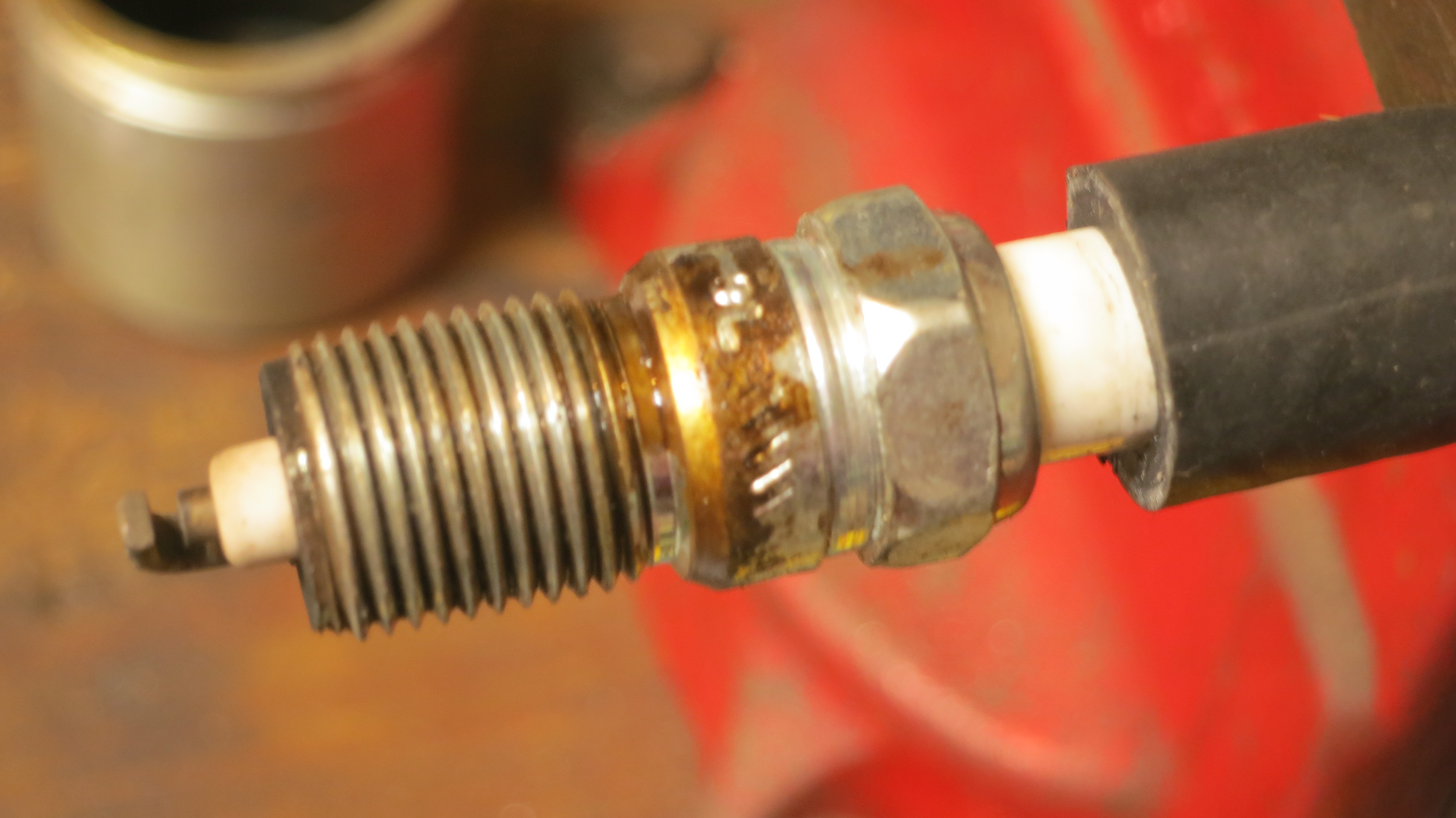

This update is about this plug, a new ACDELCO 6 that I removed from #8 cylinder. It was removed because, when I removed the injector connector from #8, the mysterious noise went away. From the picture you can see that there was significant leakage around most of the seating area. My first thought was that I had not tightened it sufficiently because of the difficulty getting access to it. This time I removed the metal bracket to which the 7 & 8 spark plug wire looms are attached. This gave me the ability to just get my hand down in there and touch the tip of the plug with my finger tips. Which turns out to be just enough.
I decided to clean up this plug and reinstall it in hopes of a quick solution to the mysterious noise. Maverick and I got the plug installed and we fired up the engine and nothing much had changed. The noise was still there and there was still a very small stumble just off idle. This time I was very confident I had installed the plug tightly enough, so I decided to remove it again to see what it looked like. I was surprised to see witness marks where it had contacted the seat, but not over the entire circumference of the seat. There was still a portion of the seat where it was still leaking. Now this had me scratching my head, so I got one of the old original plugs and cleaned it up and covered the seat with black magic marker to see what would happen if I install it. The answer is that there was no leaking. The whole seat had been cleaned off by contacting the head.
I believe the new AcDelco plug was defective in manufacturing where it had a seating surface that was not parallel to the head. The part of the defective seat closest to the head as it goes in, contacts the head first and just stops there, unable to rotate in any more at the tightening torque.
These plugs are called "ACDELCO 6" and are a replacement for the original plugs {ACDELCO 41-943}. And...I learned that ACDELCO now manufactures their plugs in China. After my experience with the considerable rust on the ACDELCO fuel pump hanger (made in China), I decided to order up some NGK's to replace all the plugs. Amazon promised them tomorrow. The beat goes on...

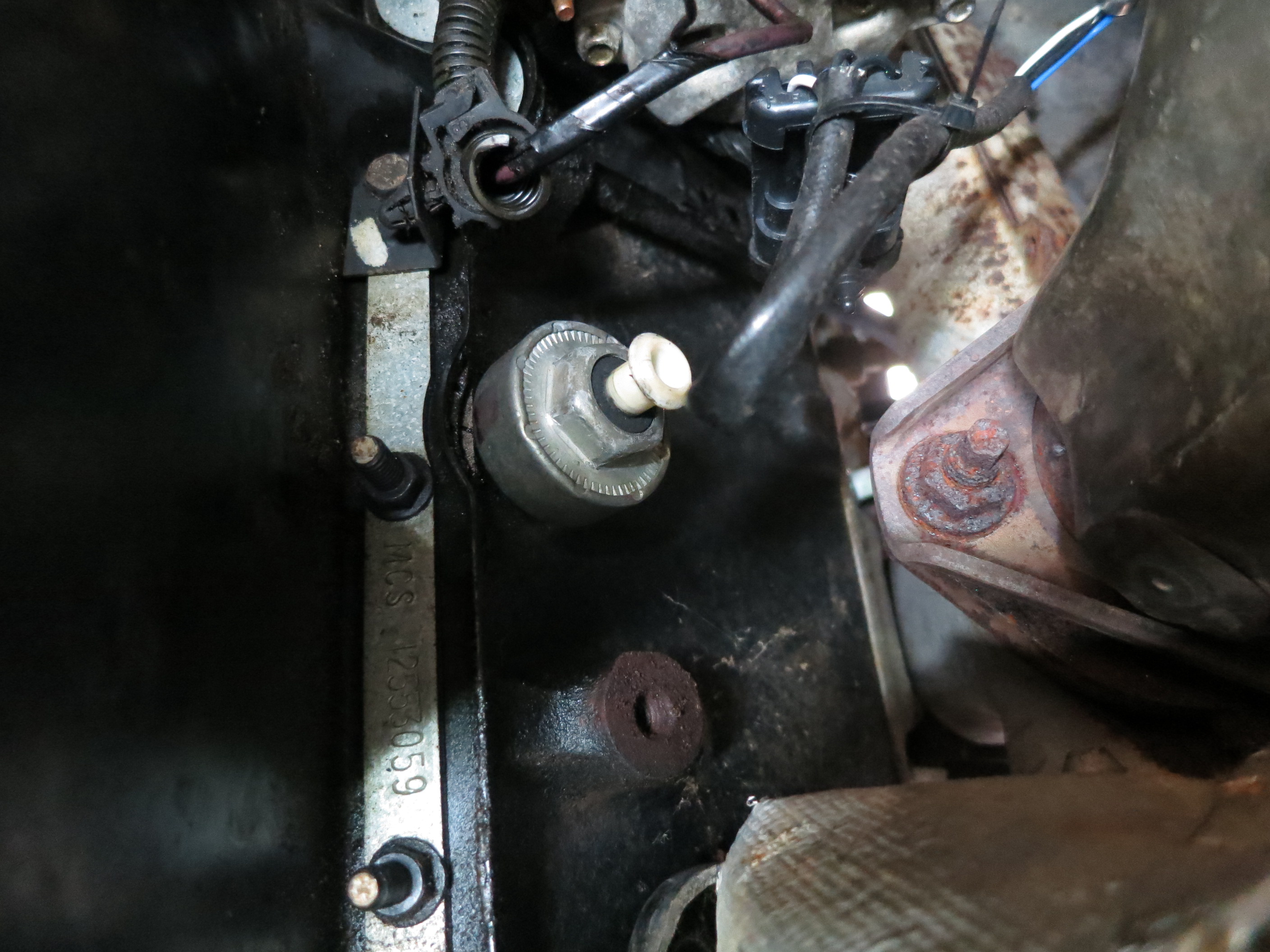

The cooling system sub-project touched several systems, so it was not all that straight forward. First to mention are the knock sensors. On this car they are the drain plugs for the block.
On the right side, the connector was partially broken and difficult to remove from the sensor. This will come into play later. To get to the knock sensors, one must first remove protective metal shields on each side, disconnect them and use a combination of a 7/8 socket, breaker bars and ratchets to unscrew them. Once you've done it once and have all the tools handy, it's not so bad. If you remember, I had added cooling system cleaner a month or so ago to help clean up the mess caused by someone mixing regular antifreeze with the DexCool (orange stuff). After draining the system for the first time, I replaced one rad hose and the engine temperature sensor which came with the car and was broken, but functional. Too bad the one I had ordered a month ago from Amazon was the wrong one. This started my relationship with NAPA (at Andy's suggestion). With the parts replaced, I started the flushing process. I drained, filled with water and ran the engine four times before it looked clear enough to move on, which took me several days with normal life interruptions.

Time to button it up and fill it with new DexCool. Installing the Knock Sensors, I noticed that the one of them had a wiggle in the center contact post where some of the surrounding plastic had broken. RATS! Back to NAPA again. I decided to do this right and get not only two new sensors, but the connectors as well. Another day goes by and now I have what I need to do the final fill. By now I'm quite adept at scooting on my back in and out from under this wonderful vehicle for 5 days in a row. I guess I shouldn't complain because it keeps me young and agile.
