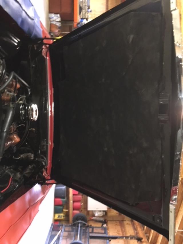

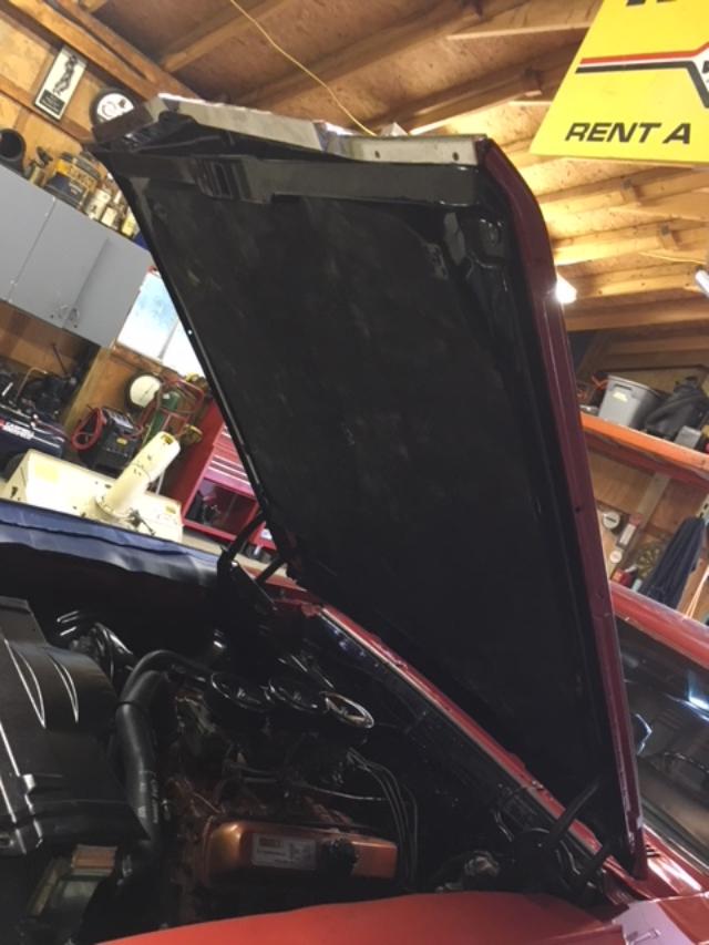

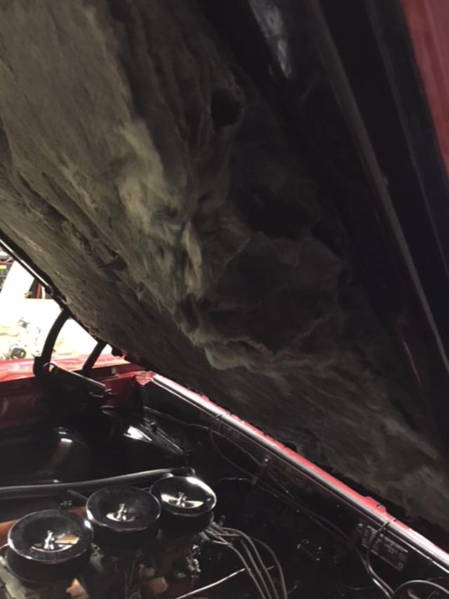

This project is one of those things that didn't effect the performance of the car, but just
drove me insane. The hood liner, for some reason, was separating on the driver's side. I had
tried everything to put it back together ( staples, duct tape, spray adhesive -- three times )
before I finally waved the flag and decided to put a new one on. Fred hooked me up with the
kit as a birthday gift. The kit was pretty easy to install, fit well, and unbeknownst to me, came
with the period correct clips. ( It also made me nuts that the wrong vintage clips were used in
the last install! ) In anticipation of doing the project, I bought a bag of 12 clips off of the internet.
( If anybody needs clips, DON'T BUY THEM, I have more than I can use now! ) I put the extra clips
in the parts storage bin. The whole project took about a half hour, and looks great. I also replaced
the trunk light bulb with the correct size bulb for the fixture -- the old one worked, but was the
wrong style bulb.

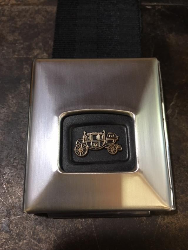

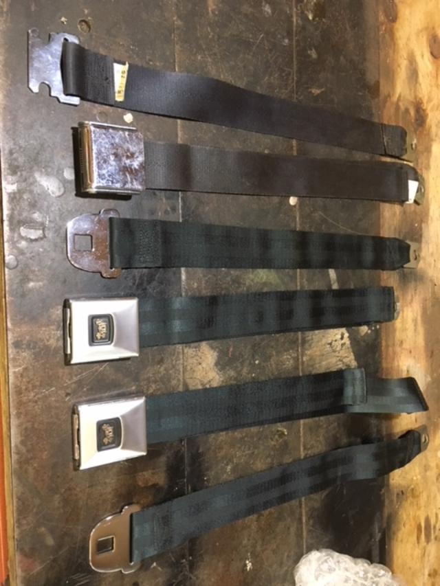

While searching out Oldsmobile parts that I really don't NEED ( but want ), I found a guy who had
a whole set of seatbelts for the 442. Keep in mind that you can get reproduction seatbelts for all
1966 Oldsmobile seatbelts, except for the kind that I have. ( These reproductions are about $100
for the rears ) Mine has the "carriage" button on it, and is ultra-special enough to be not reproduced.
Anyhow, I emailed the guy and asked him if he had just the rears. He did. He refurbs them and sells
them shipped to your door for $120. I took the leap of faith and PayPal'd him the $. I was getting a
bit nervous when they didn't show up in a week, but a quick phone call got them there the next day.
( He forgot to send them. ) They look perfect. I hated the old rears that came with the car. They
were date coded 1990, and they were after market belts. The project took about an hour to do,
which included cleaning the carriage emblem on the front seat belts as well.
