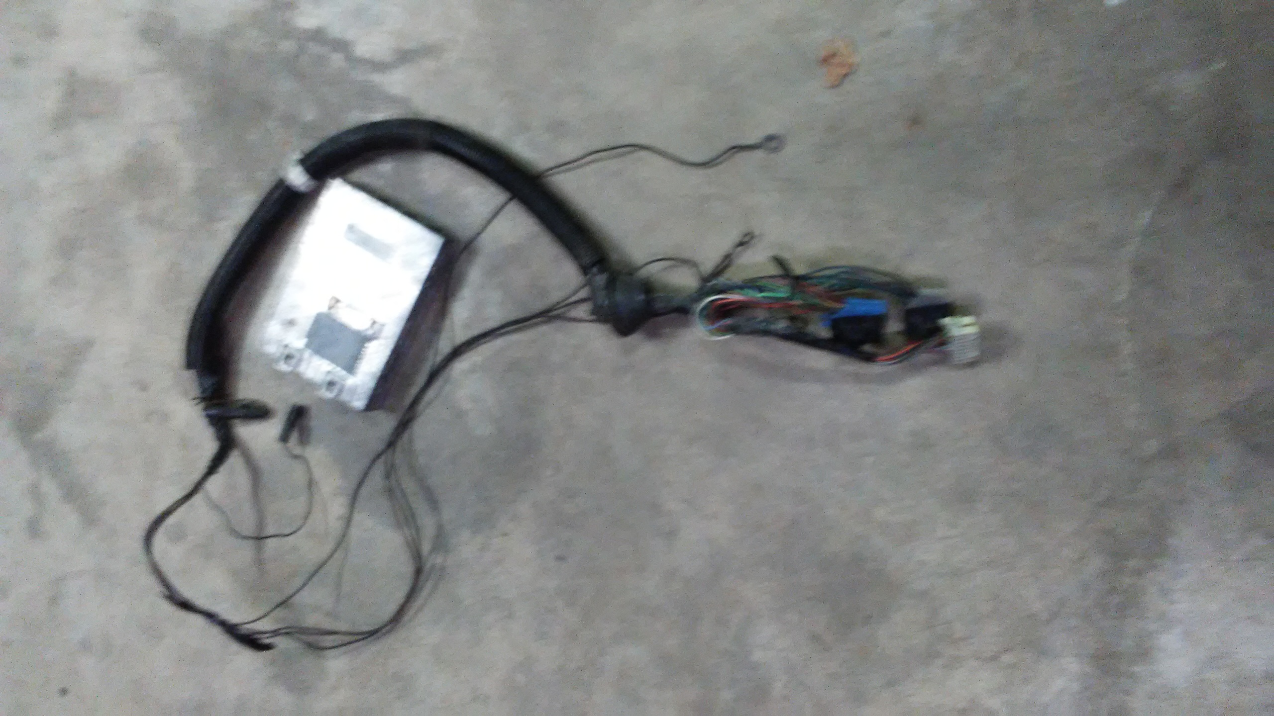

Got the computer and its engine compartment harness out. That eliminates some of the messy wiring in the engine compartment and everything that was working seems to be still working.

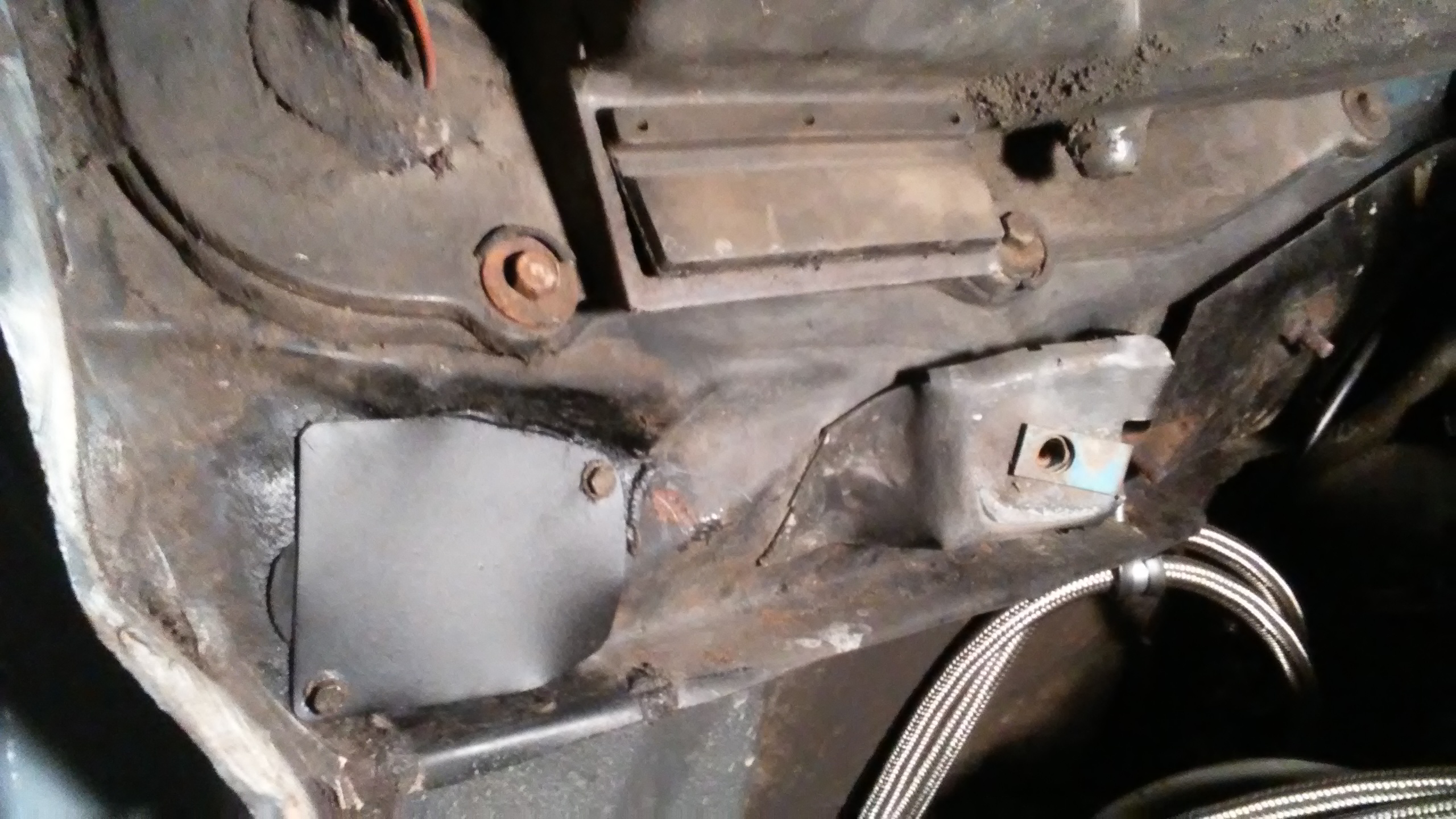

This is a picture of the firewall as viewed from under the passenger fender.
The new metal patch is where the computer wiring harness came thru the firewall. At the top center of the picture is a rectangular rubber flapper that apparently is an air check valve to let air out of the HVAC system into the engine compartment but not the other way. The flapper is deteriorated so it isn't normally closed and therefore not working.
Anyone know what that rubber thing is and what it's called? Didn't find anything about it in the Chevy shop manual. If I had a name for it I could look for a replacement.
If no replacement, would you seal it off or leave it as is? Don't like the idea of pulling air from the engine compartment into the cabin but I don't know if there would be some bad effect from sealing it. Haven't had a good idea for some make-shift replacement.

I would try to run the fan while under the car to see what happens with the flap. I would
also tape it closed and jam it open to see if air flow changes in the cabin. If you don't notice
much change, block it off. I can tell you from experience with the Vette that had a huge cam in
it.... engine compartment air in the cabin was not desirable.
Re: 1981 El Camino
Roger that, GM. Thanks.
If I could think of something with a flat piece of flexible rubber, like an inner tube, I could make a new flapper. Ideas, anyone?
Re: 1981 El Camino
The flapper is apparently the drain for the AC evaporator. No known replacements. I put a metal screw in the corner that was sticking up and put the inner fender back in. Think it will be OK.
