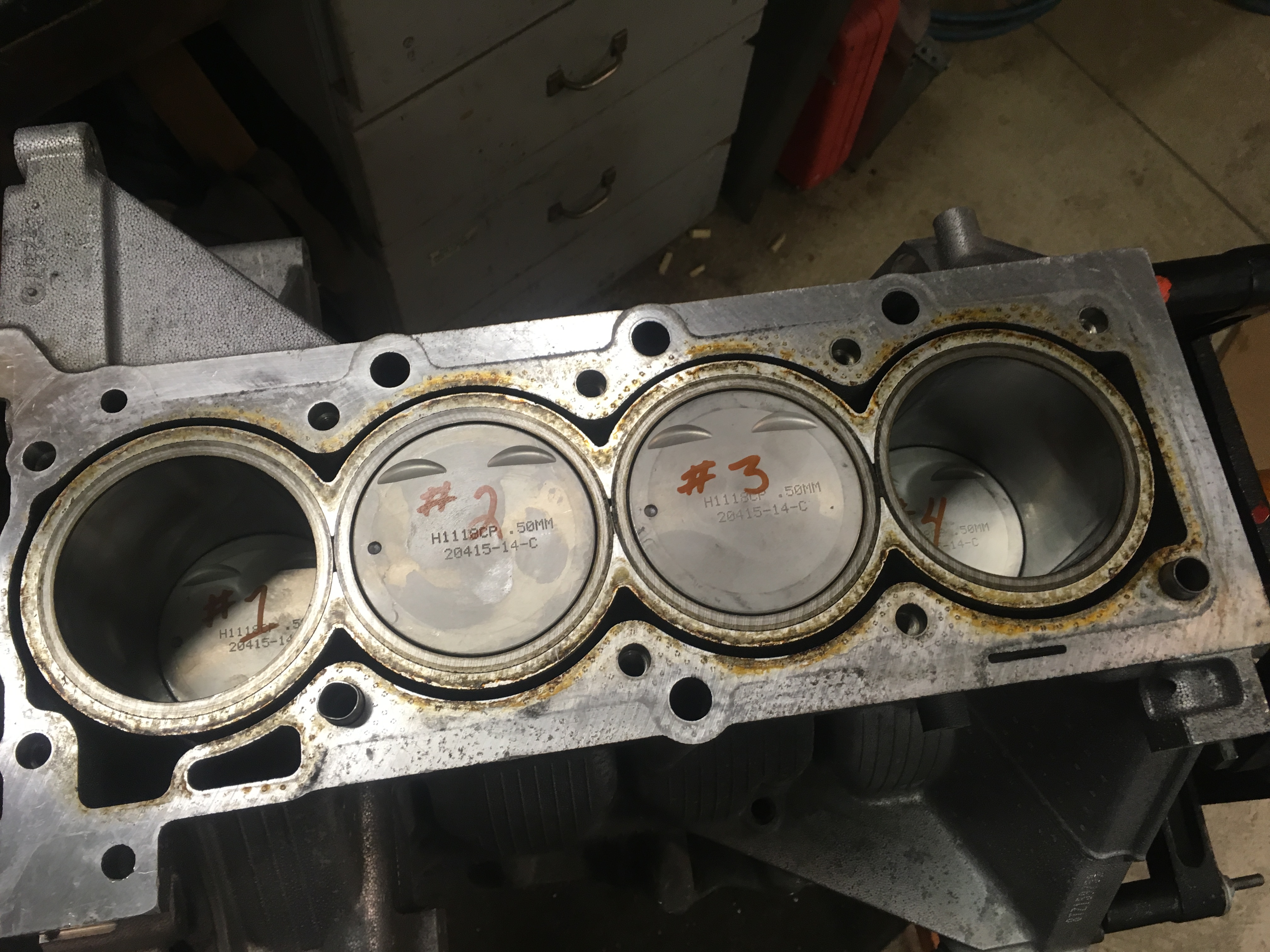

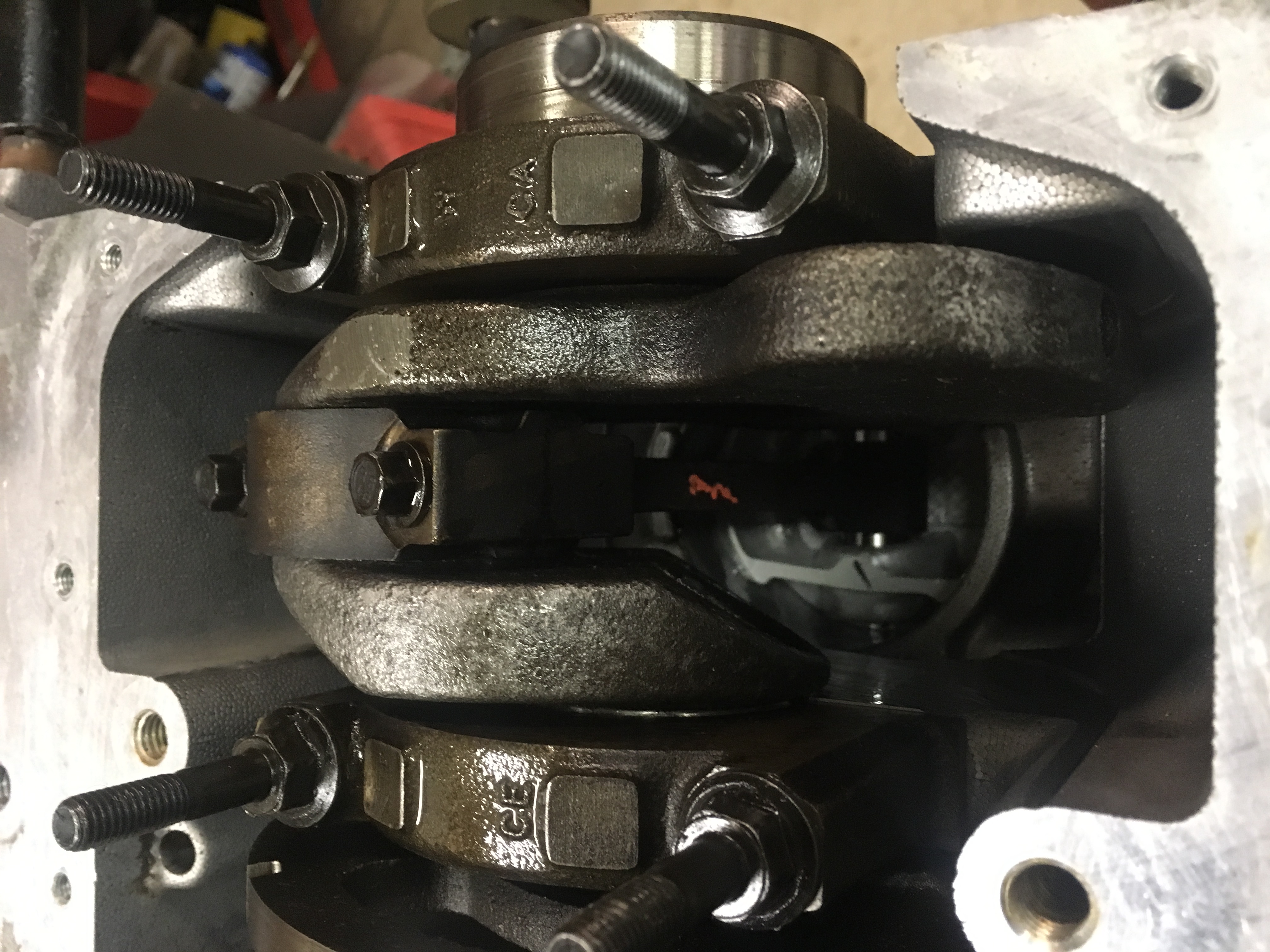

A few weeks back we made it to pull a part to get a transmission. While we had the engine out we pulled some connecting rods
This past weekend I got the block and crank back and did the assembly. Note rod #4 still sporting junk yard paint:

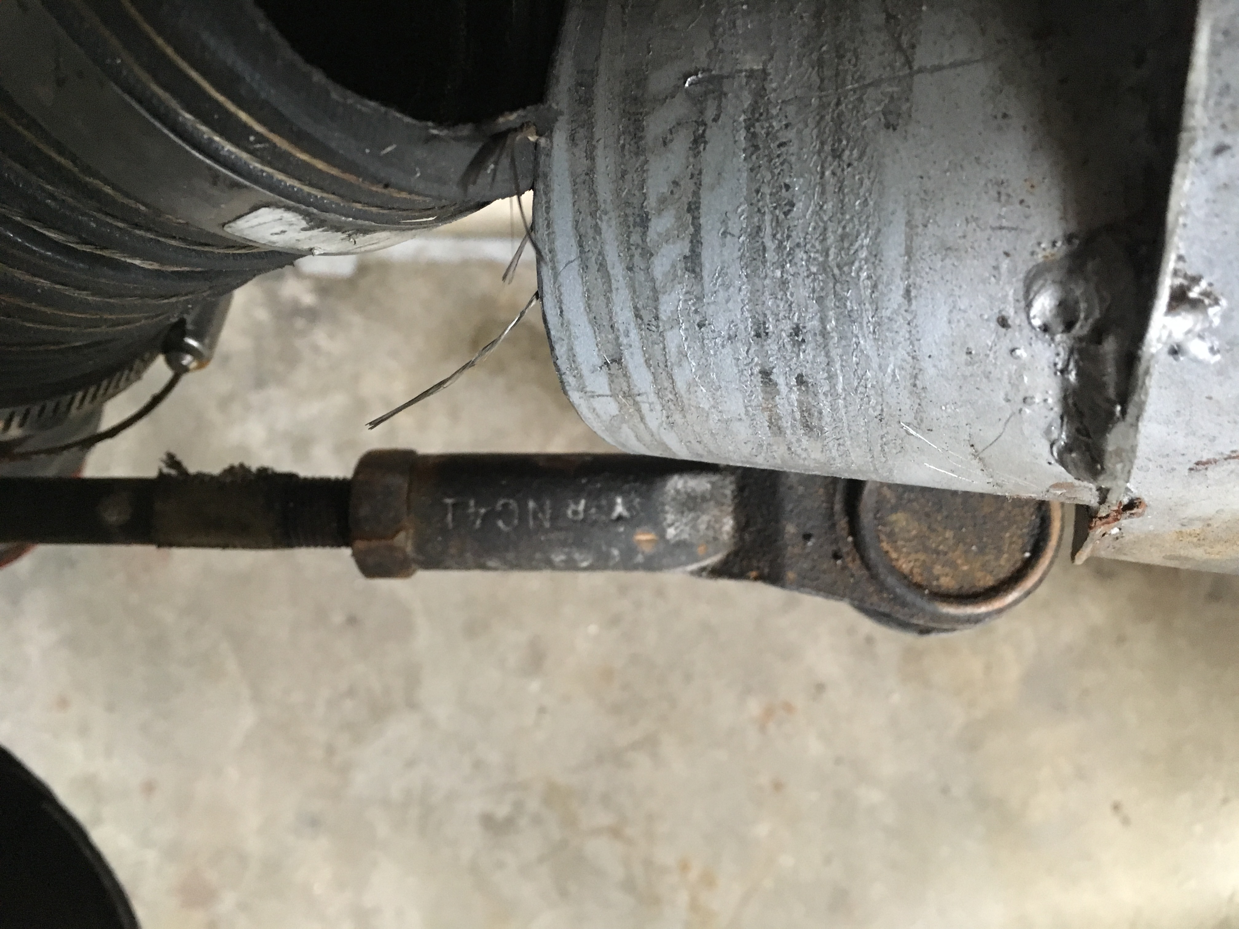

We have an issue with bump steer that has made itself evident driving on the uneven surfaces at VIR and Nelson Ledges. I just drive the car but the guys don't like it so we're going to fix it. The issue was created when we switched from stock knuckle to Ion knuckle. The tie rod end fit right in but we had to invert it and the connection point moved by maybe an inch vertically.
With just a little digging I discovered the 4th gen F-body has the same tie rod end as the Saturn.
This kit works but it's $170:
http://www.spohn.net/shop/1993-1997-GM- ... -Body.html
Now I can get just the rod part for $10 each:
https://www.speedwaymotors.com/Adjustab ... gK7sPD_BwE
I need to check the taper angle on each and then a Heim joint and the sleeve that connects it to the tie rod. Anyone have any experience with this?

I ended up ordering the Spohn kit and the other kit for spares. Installing the adjustable tie rod ends would have been easy except the pin intersected with my brake duct adapter. I decided to reduce the hose size to 2" since there was already a 2" section in the hose. Technically this is easy but it took quite a whil to cut the 3" off, fabricate a plate and a 2" pipe, then get it all welded back together.

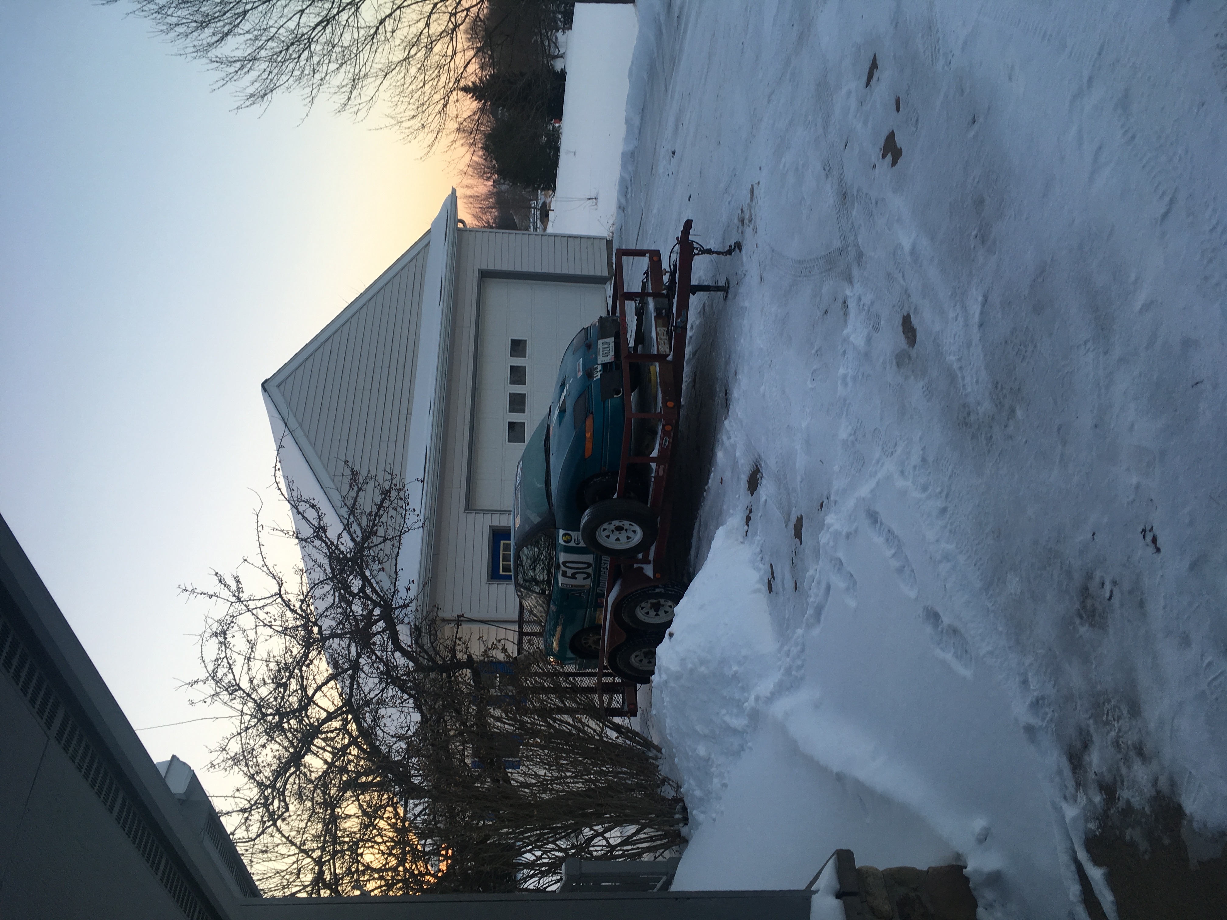

The other major update is with the ECU. Dave delivered the car on Jan 6 - drove it here in near 0 temps with wicked bump steer but operating on the newly installed Megasquirt. Well there are no tunes I could find on the internet so we were working with some base numbers Dave put together while garage testing with the purple Saturn. I visited Dave on 12/30 and we drove it around the block a few times in the snow - quite slowly but we only got stuck in the driveway on the way back in lol.

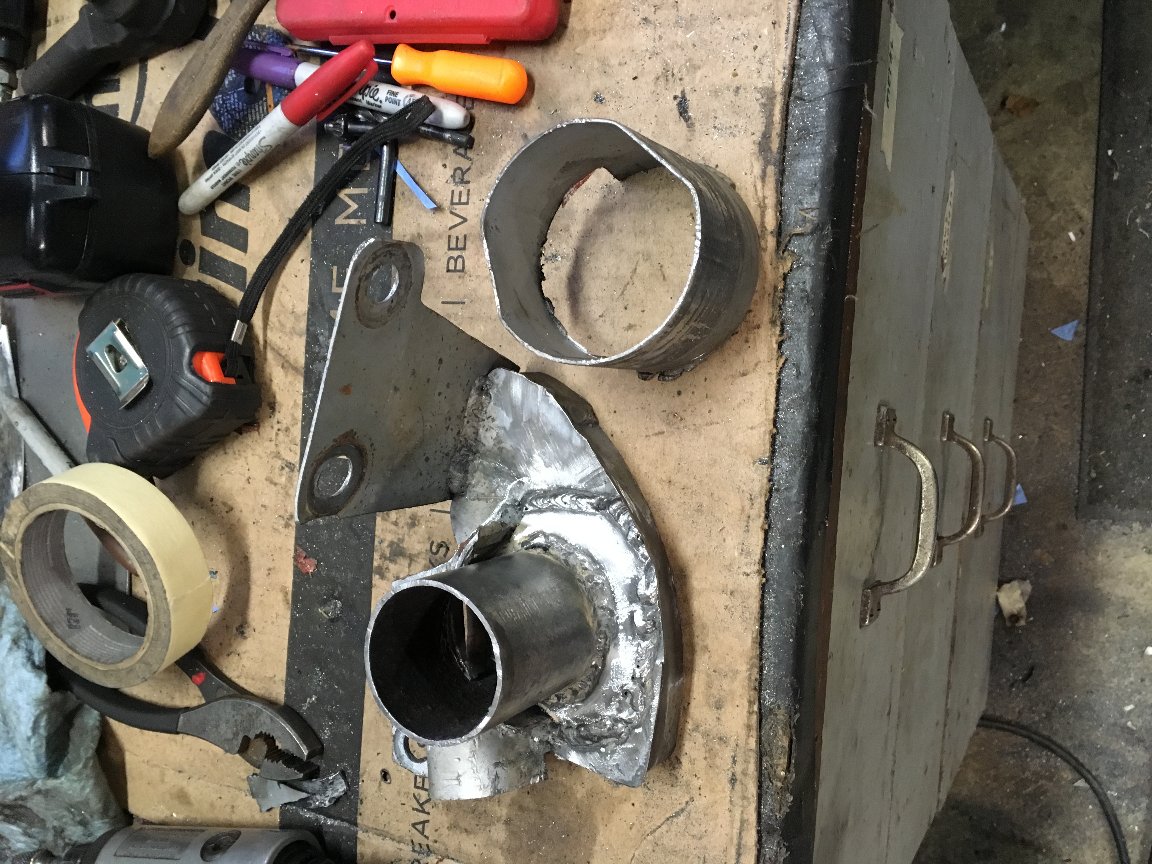

The other work was to create another exhaust pipe. I bent the pipe unloading the car at Dave's when I dropped it off for the ECU upgrade.

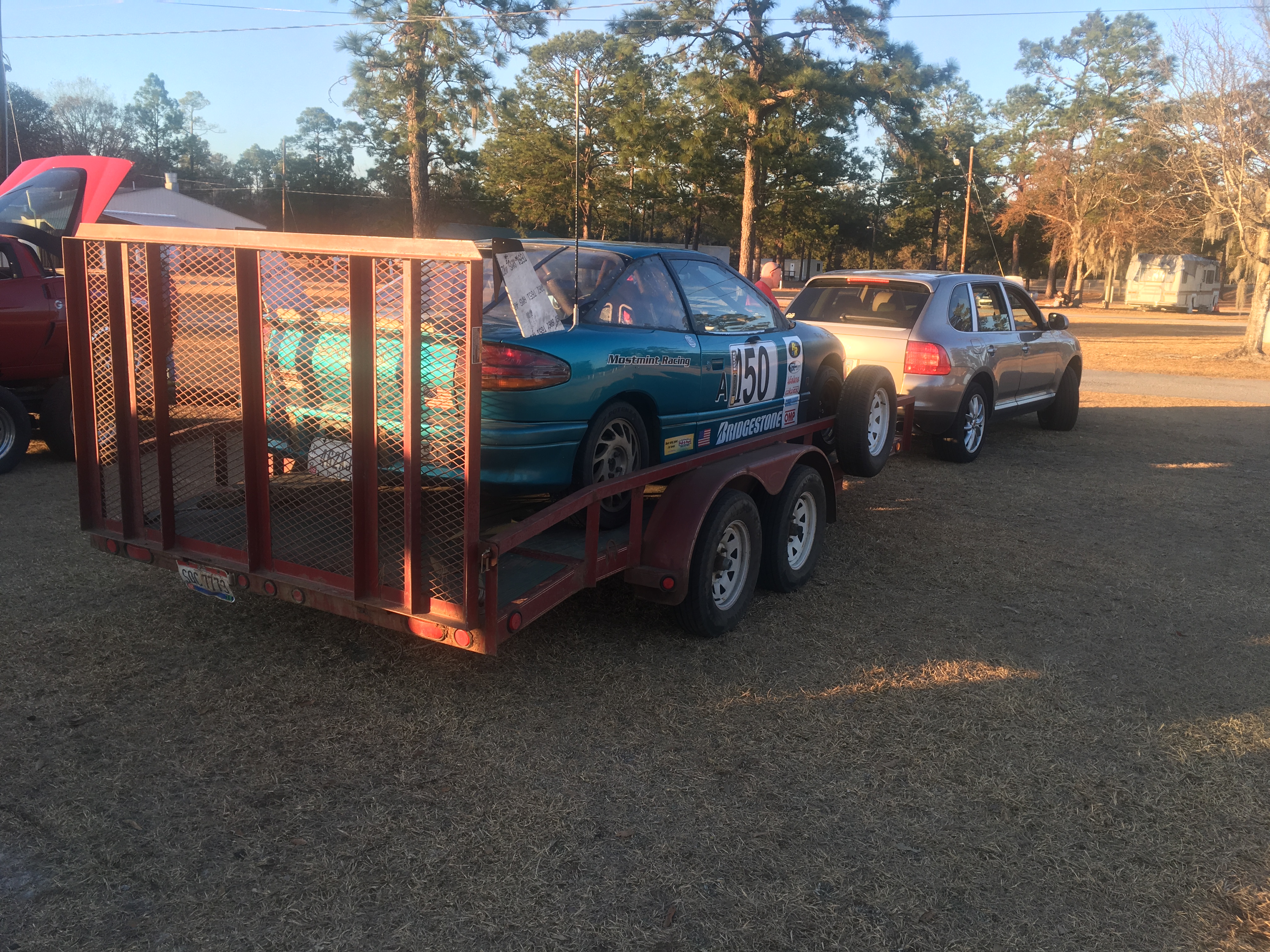

Had to get that all done by last weekend, since Joey had planned a trip to Roebling Road in Georgia for an HPDE weekend. I told him he could take the car if he ran some tests. With the whole Megasquirt still fairly immature I decided to go along. In all he put the car on track for 9 20-minute stints over two days. It was like 12 hours each way but probably no less insane than the entire concept of endurance road racing so why not!
Roebling Road is a basically flat 2 mile paved road course. It is very easy on brakes but the pavement is gritty and it is hard on tires. It's not a premiere track like Watkins Glen but the amenities and facility were decent. Hoping Nelson Ledges can end up like that some day.
The weather turned out to be great - basically sunny/clear skies the whole time with temps getting to 70 during the day.

The new tie rod ends were set up well and eliminated the bump steer. We still have issues with the nylock nuts backing off but we will fix that.

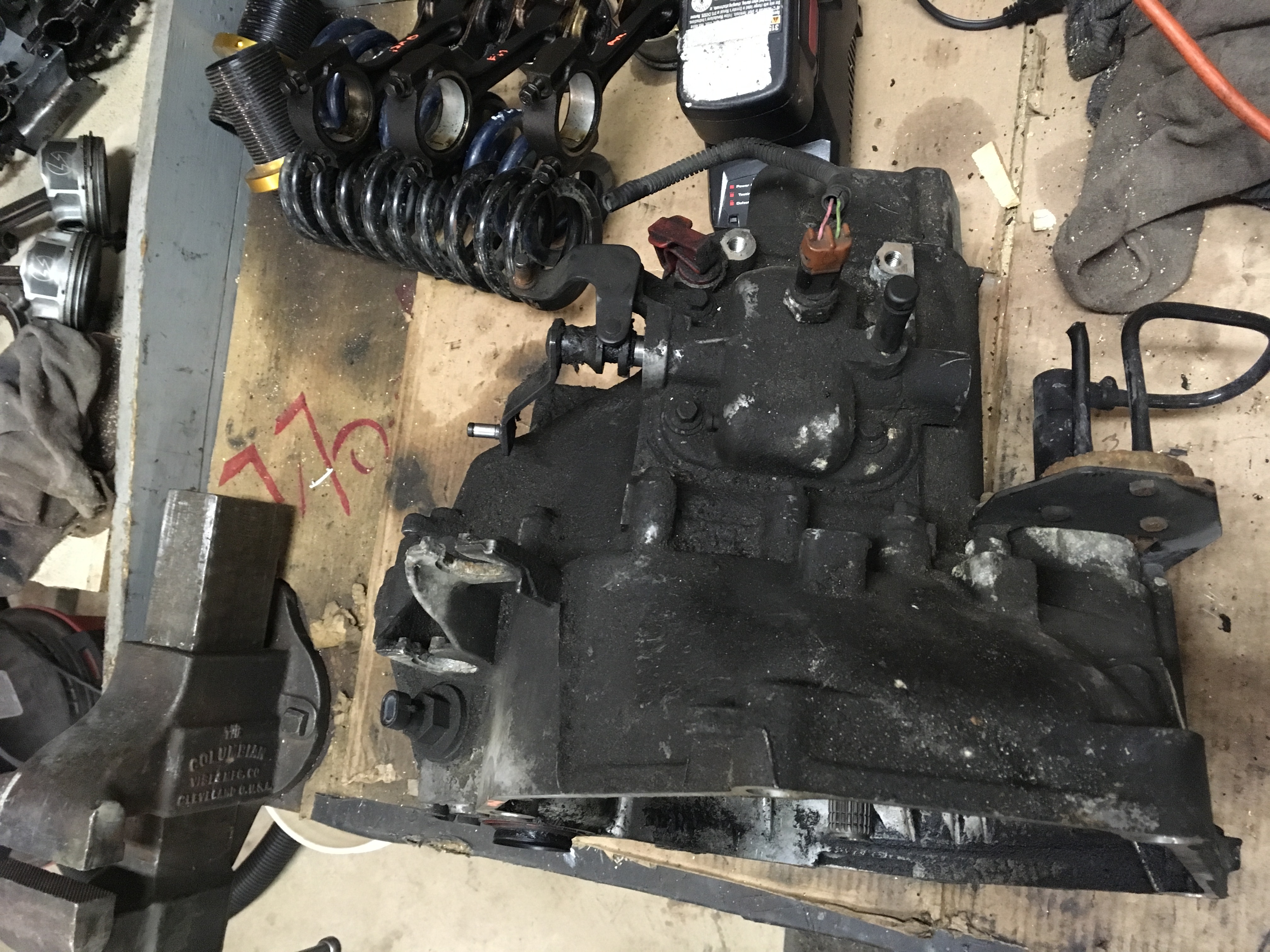

Late today I got the trans on the bench and started cleaning the exterior. If time permits I will dissemble to get the diff pin welded and to drill and tap a hole for trans temp sensor. Engine and trans going in on 4/29 barring some major problem.

Closing in on completing the transmission work. The case was so dirty - took quite a while to clean that up. Got the trans apart, had Kurt weld the differential pin, and drill and tap the case for an oil temperature cooler. Going to have it all wrapped up and ready for install this weekend.
