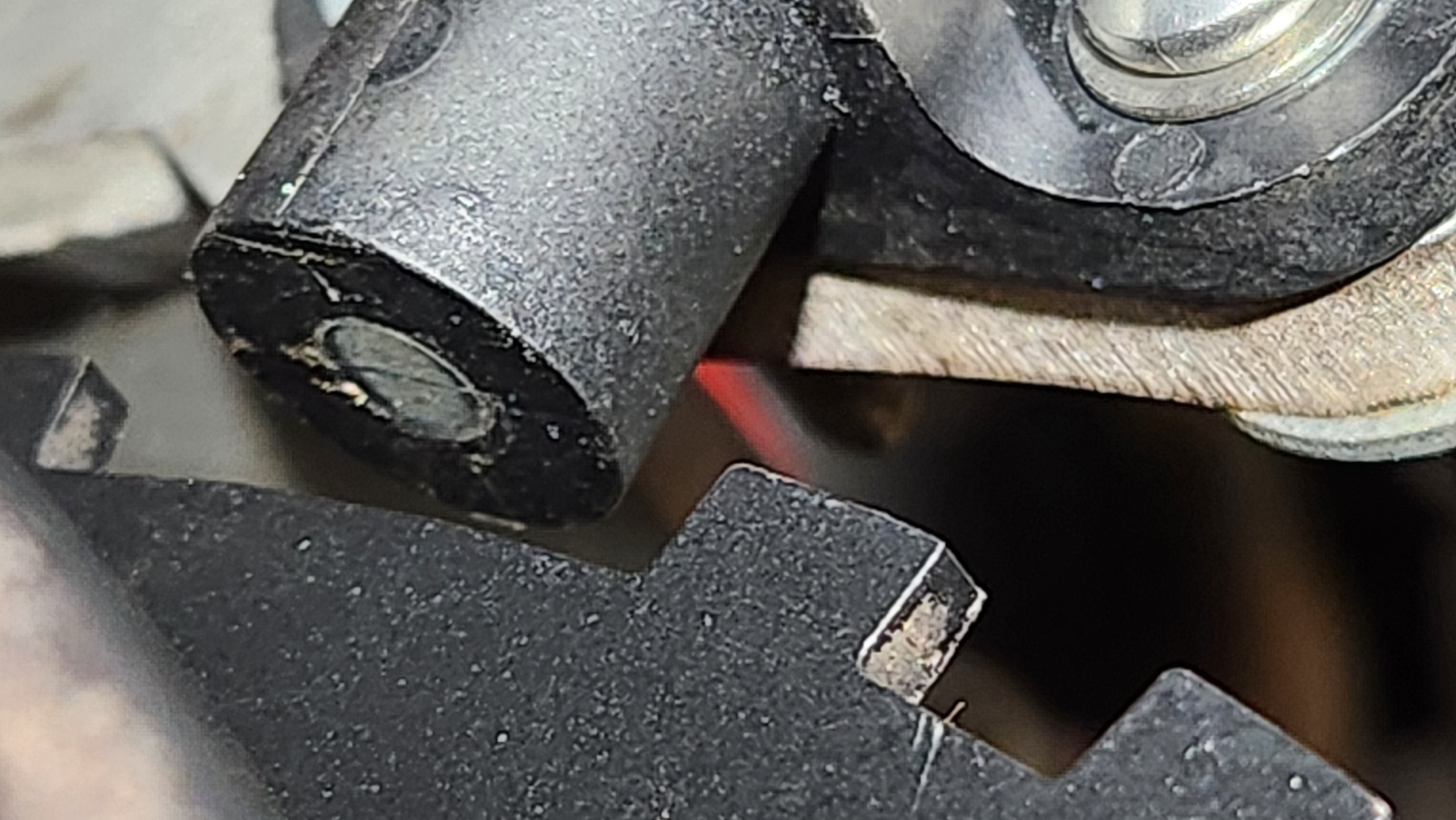

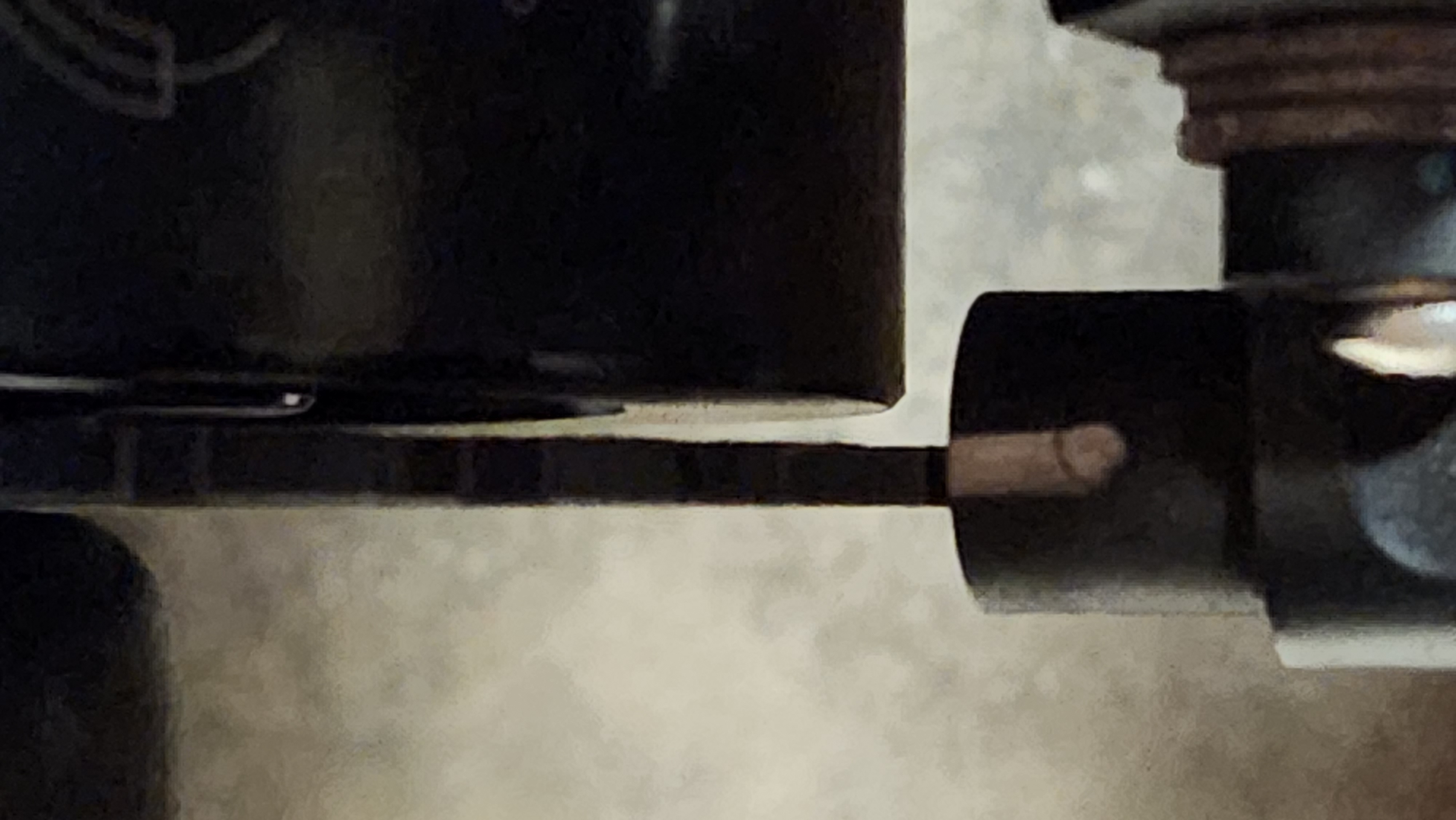

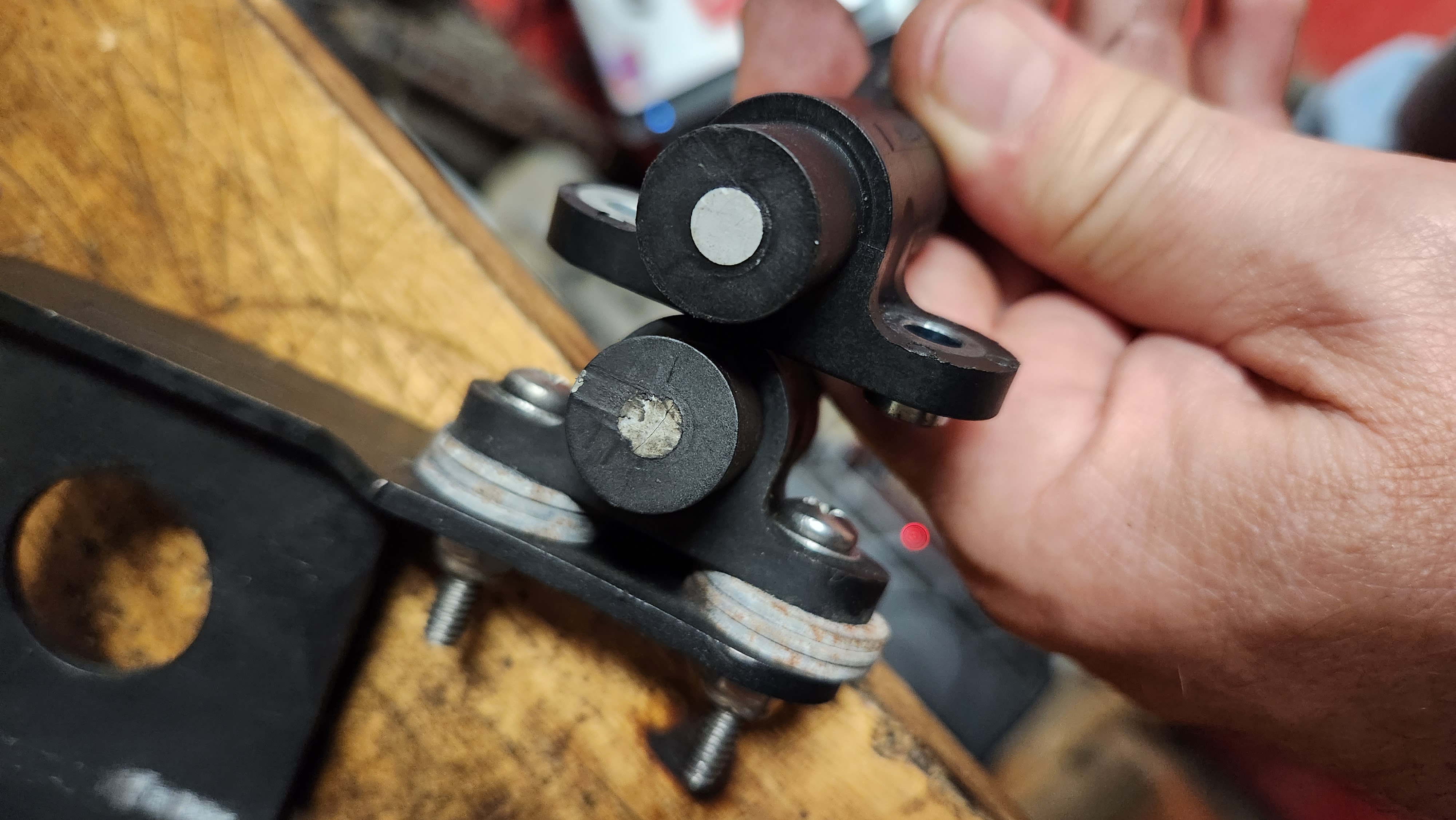

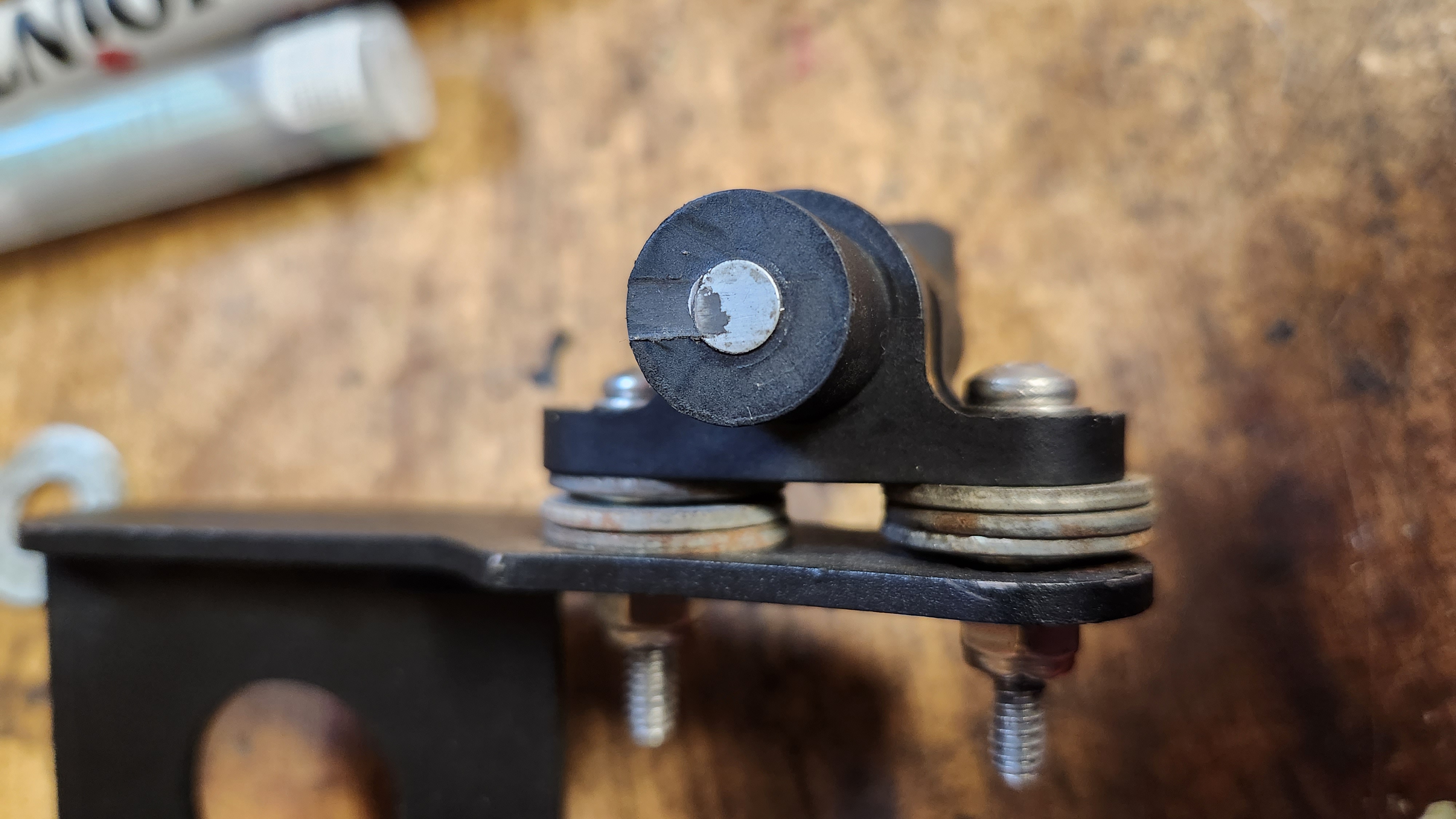

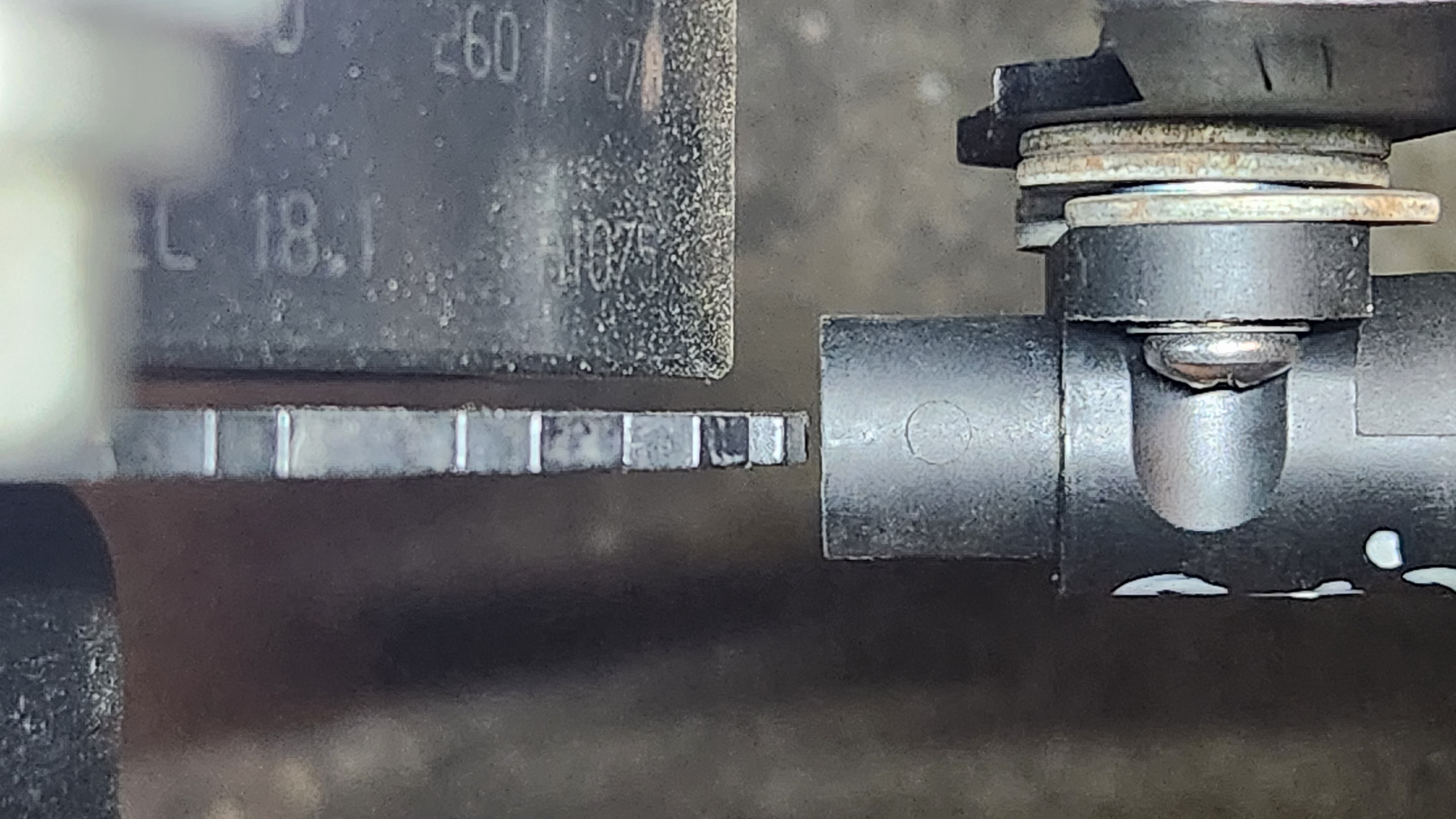

At some point after I got home I took the crank sensor off and it looked like it had made slight contact with the teeth of the trigger wheel at one point, along with a crack in the magnet. I have no idea when that happened.
I put the the new sensor on my bracket and also added one more small washer to the stack to get the sensor centered better on the trigger wheel.
Before: After: Gap set at .034" / .863mm

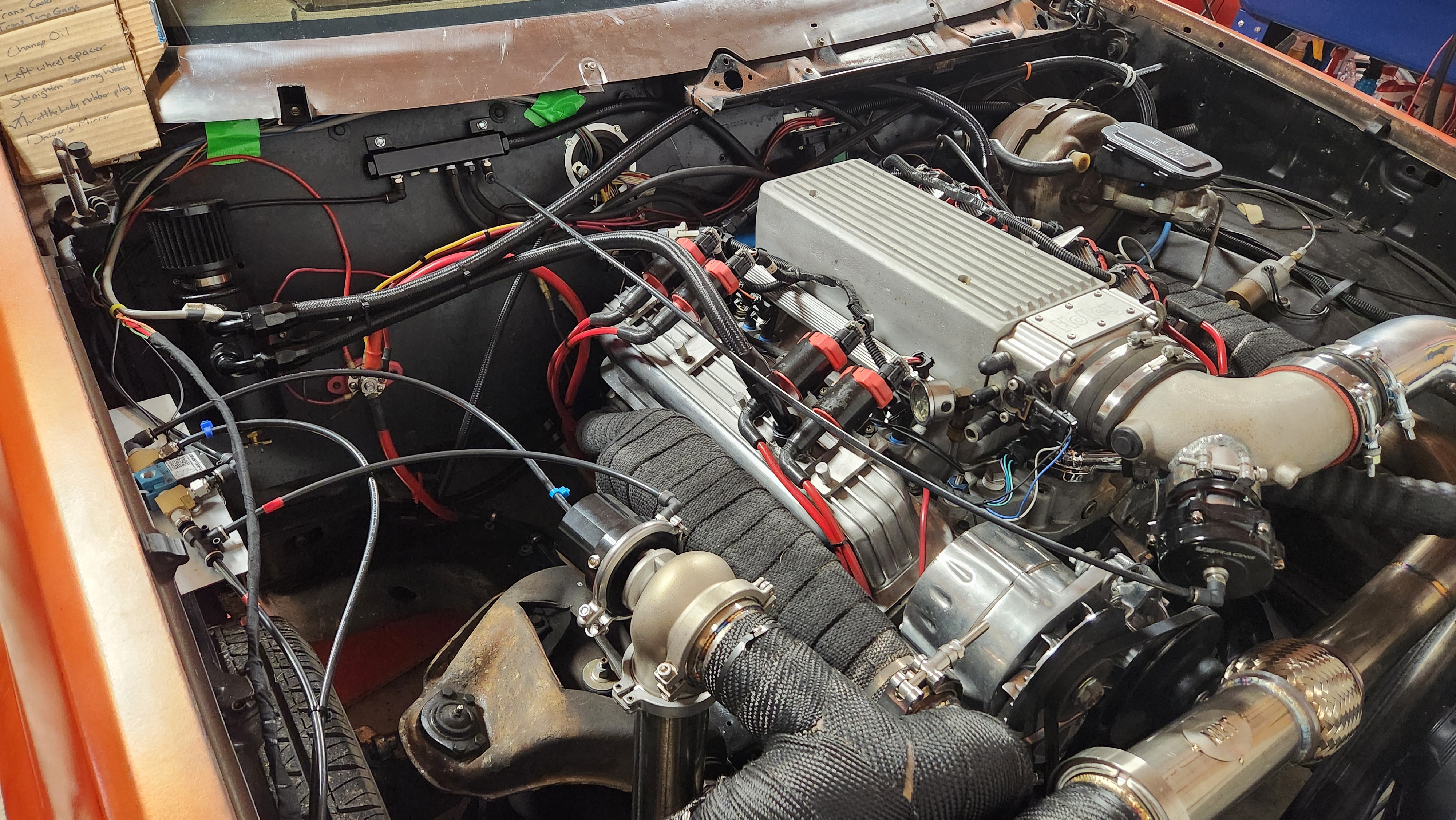

I also really need to get some heat-wrap on the piping near the turbo. I'm concerned about running with the hood on for any length of time for fear of it (the hood) getting too hot.

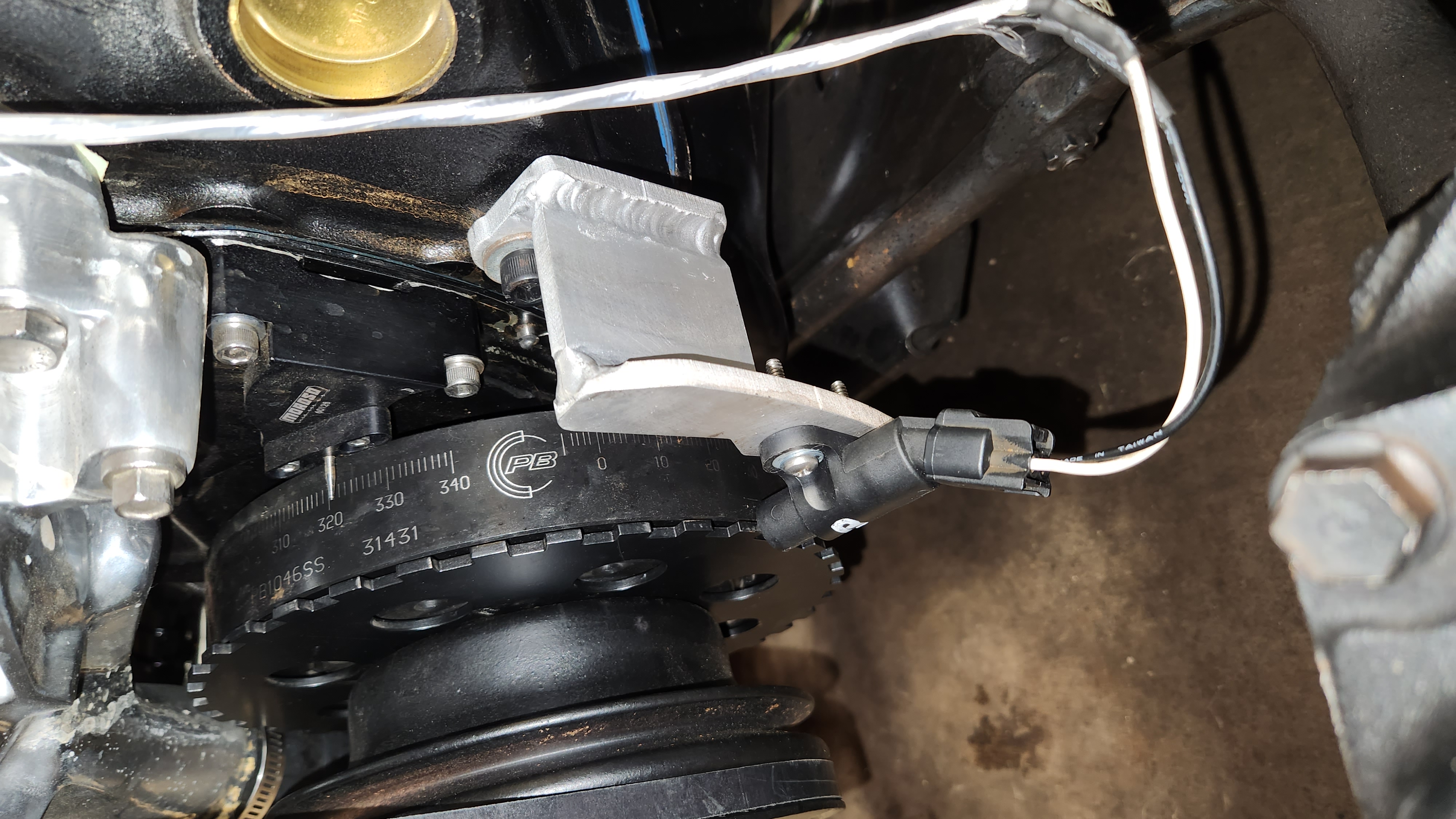

The big issue I found was the crank position sensor. You can see in the picture that there was some contact to the sensor from the trigger wheel. So I replaced the sensor. I was hoping that would explain my RPM signal drop-outs. Foreshadowing... Paul called me on Thursday and said Dragway 42 was having a test-n-tune on Friday and asked if I was going. I wasnt really planning on it, but I had already taken off Friday anyway, the weather was gorgeous, and the weather was gonna turn to cold and wet on Saturday. I was able to get a uhaul trailer in willoughby, so off I went.

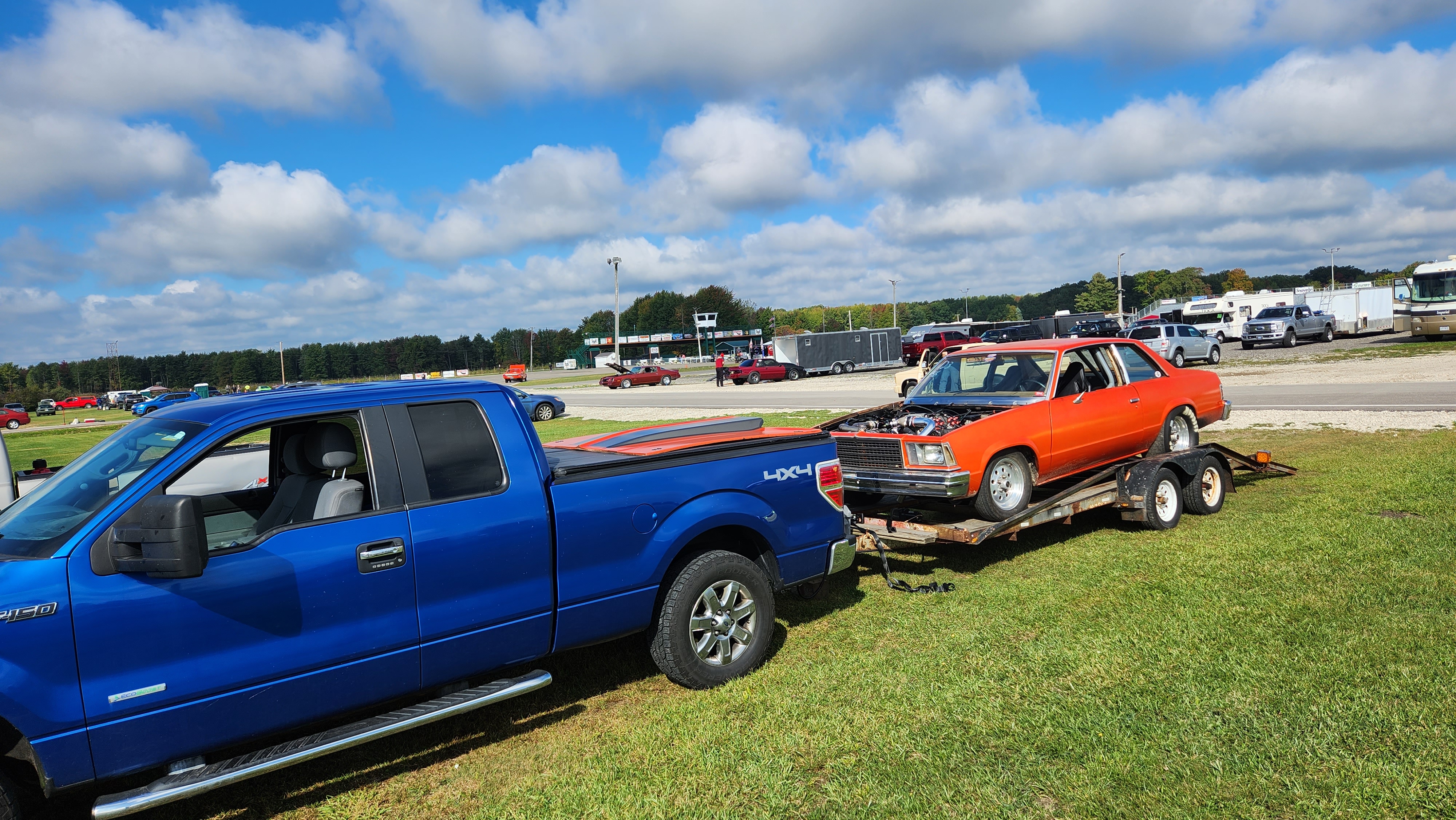

Gates opened at 4, runs would start at 6, and I got there around 4:30. There was like 10 cars there when I pulled in. I had to go through tech inspection and didn't do so hot, but they let me run anyway. I need a neutral safety switch, and I need to re-work my battery cut-off switch so it shuts the car off when running. Currently (electrical joke), it will continue to run with the switch off because of the alternator. Also, my belts expired in June 2023. I knew about all these things, but the last time the car was "teched", they didnt check *anything*.
Just before going to tech, I realized I was missing the USB cable to connect Megasquirt to my laptop. oh no!! A couple phone calls later, I was off to Scott's house to grab a spare cable, since he's only about 20 minutes away. I got back to the track just about when they were sending the first cars down the track. I was able to get up there and get my first run in.

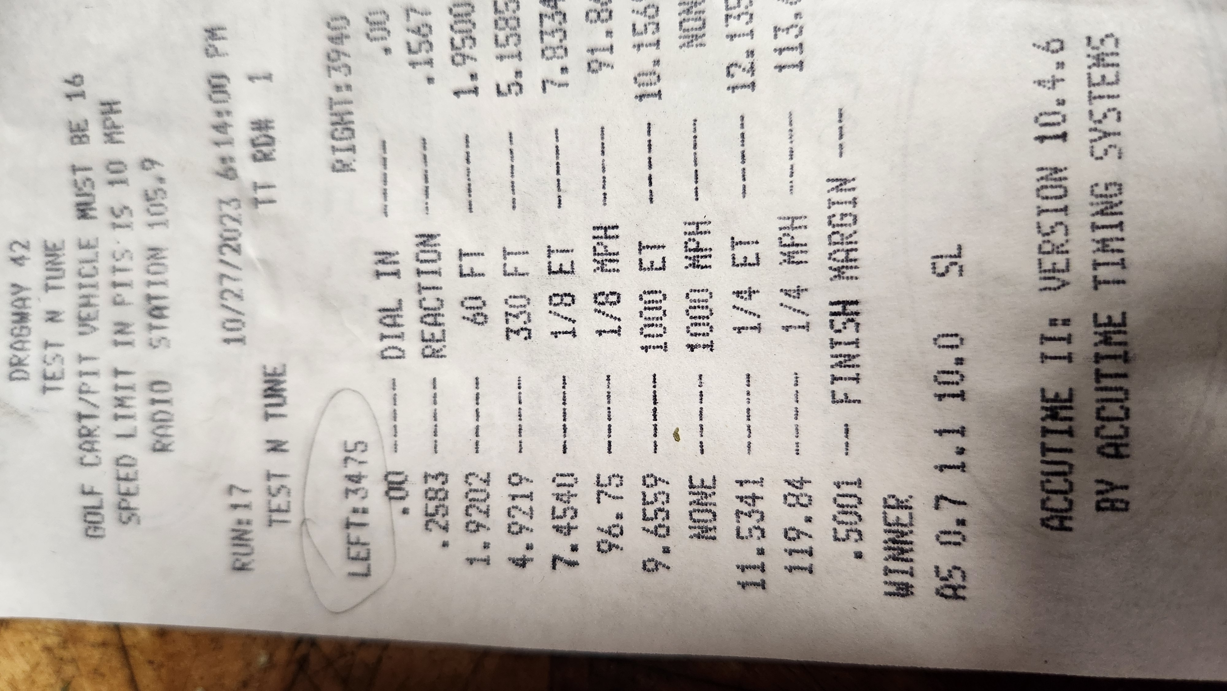

I finally pulled into my lane and here's how it went.
I was stoked! Almost 120mph! Went down the track, no issues, no funny noises... and barely any boost. My datalog showed 129kpa, which is about 4psi. There are two springs in each wastegate, I thought it would generate a lot more than that. Datalog also showed it was lean up top, so I added more fuel to the table.

I readjusted the bracket for the max clearance I could get on the crank sensor. I forget the measurement, I did that several weeks ago.

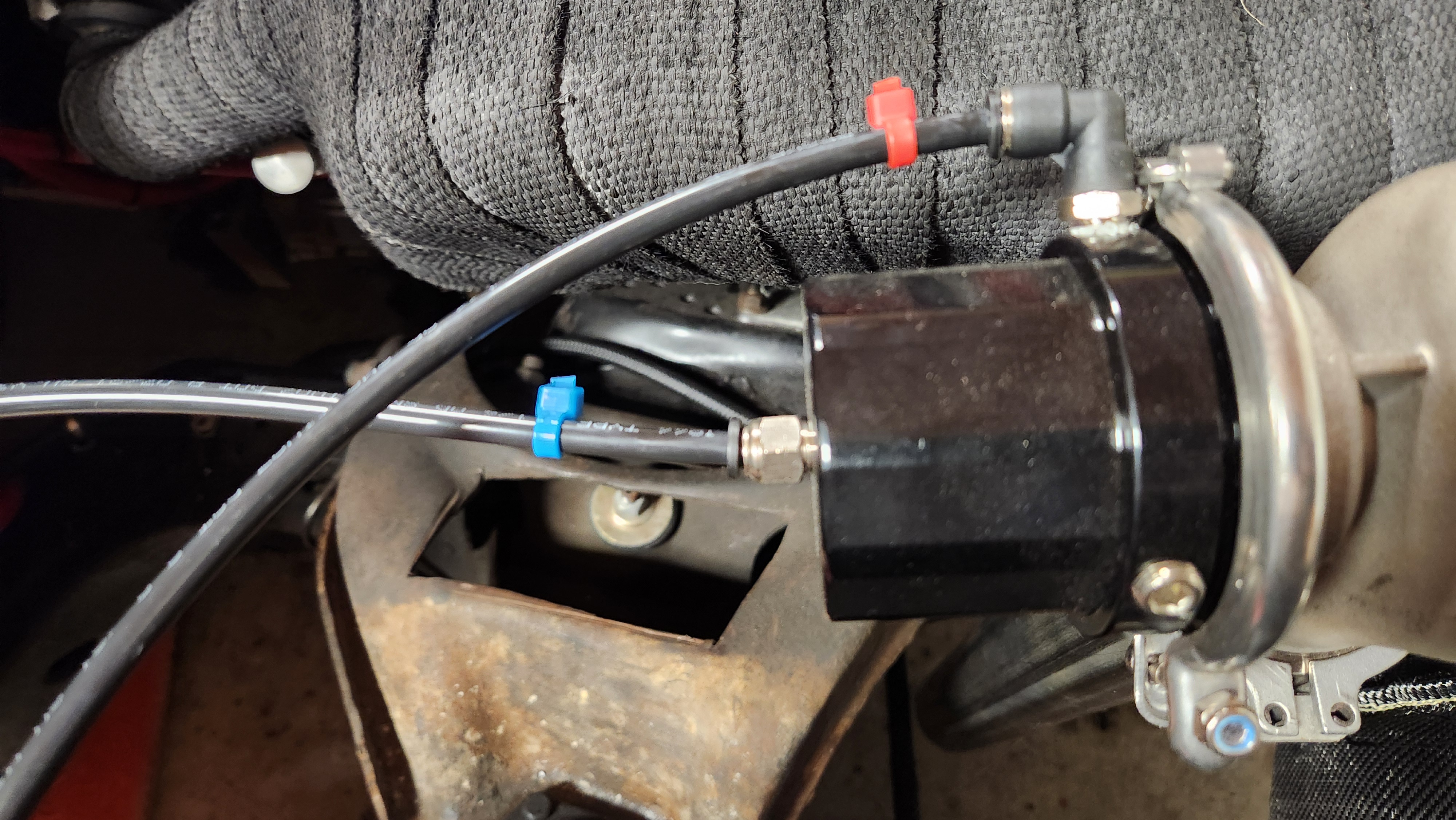

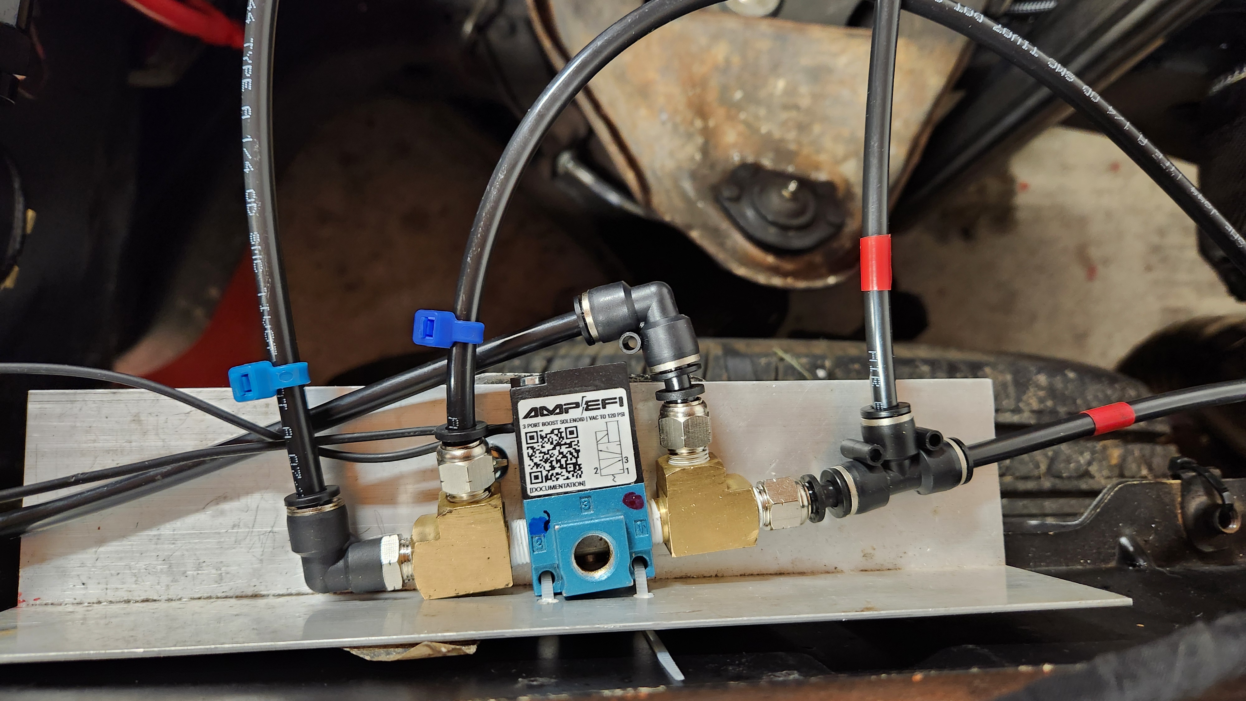

I got the boost controller all plumbed in and verified the solenoid works.

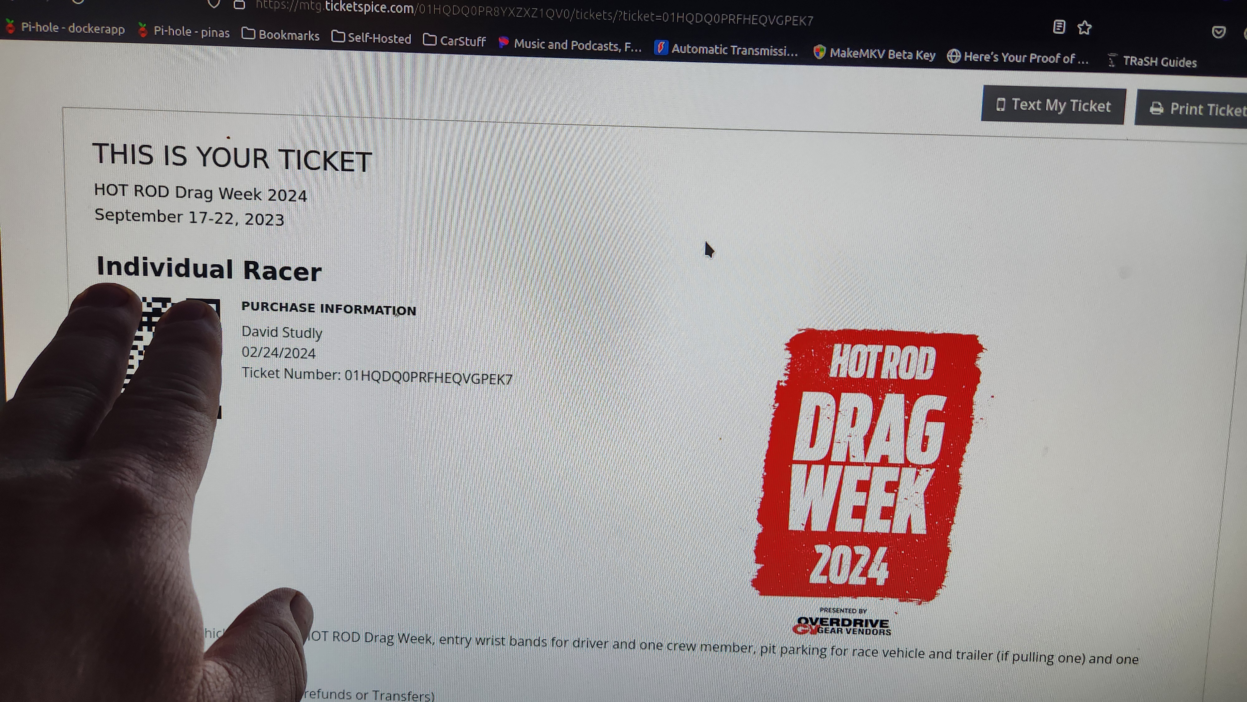

Well, I am a glutton for punishment, so I'm giving it another shot! Maliboost is officially entered for Hot Rod Drag Week 2024, Sep 15-20.
I'm entered in the Street Race Small Block Power Adder class. And this is the week after the Champcar Mid-Ohio race with the 944! September is gonna be busy!

Chris took my old crank-position-sensor bracket to work and they scanned it in. He got their CAD guy to fix up a few things, and we have now reproduced it in .260 aluminum. I'll be making a trip to Cut-N-Paste Welding this weekend to have it put together. I pulled off the steering wheel to re-clock it, as it was off 90 degrees. The tool I bought for removing the lock plate doesn't have the right size for the steering shaft (1/2-13). The tool came with an adapter for 9/16 and M14. I'm gonna try to fix the turn signal stalk and switch while I'm in there.

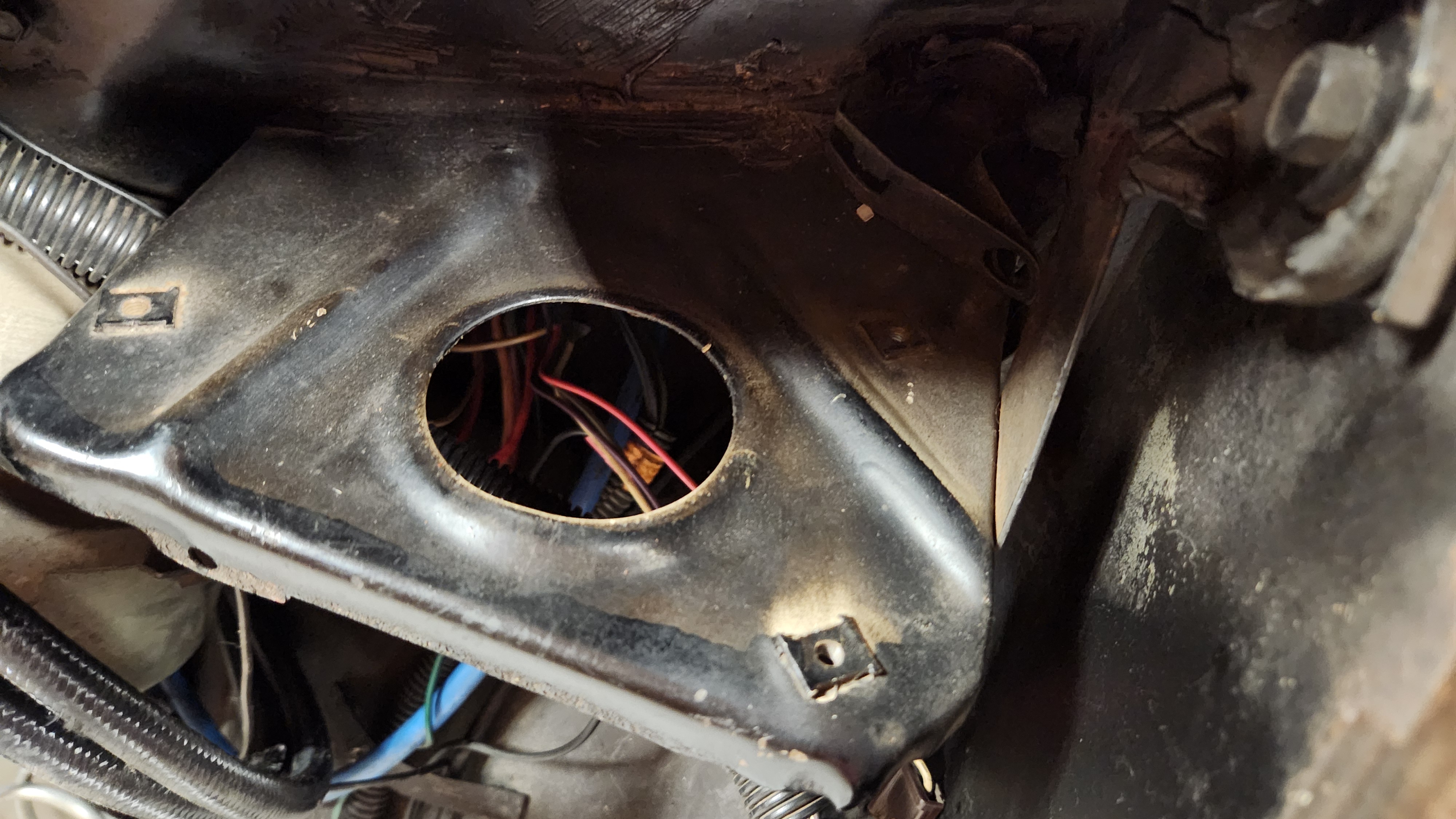

Small bits of progress over the weekend. The turn signals work! It was just a missing fuse in the fuse block. I still need to replace the lever.

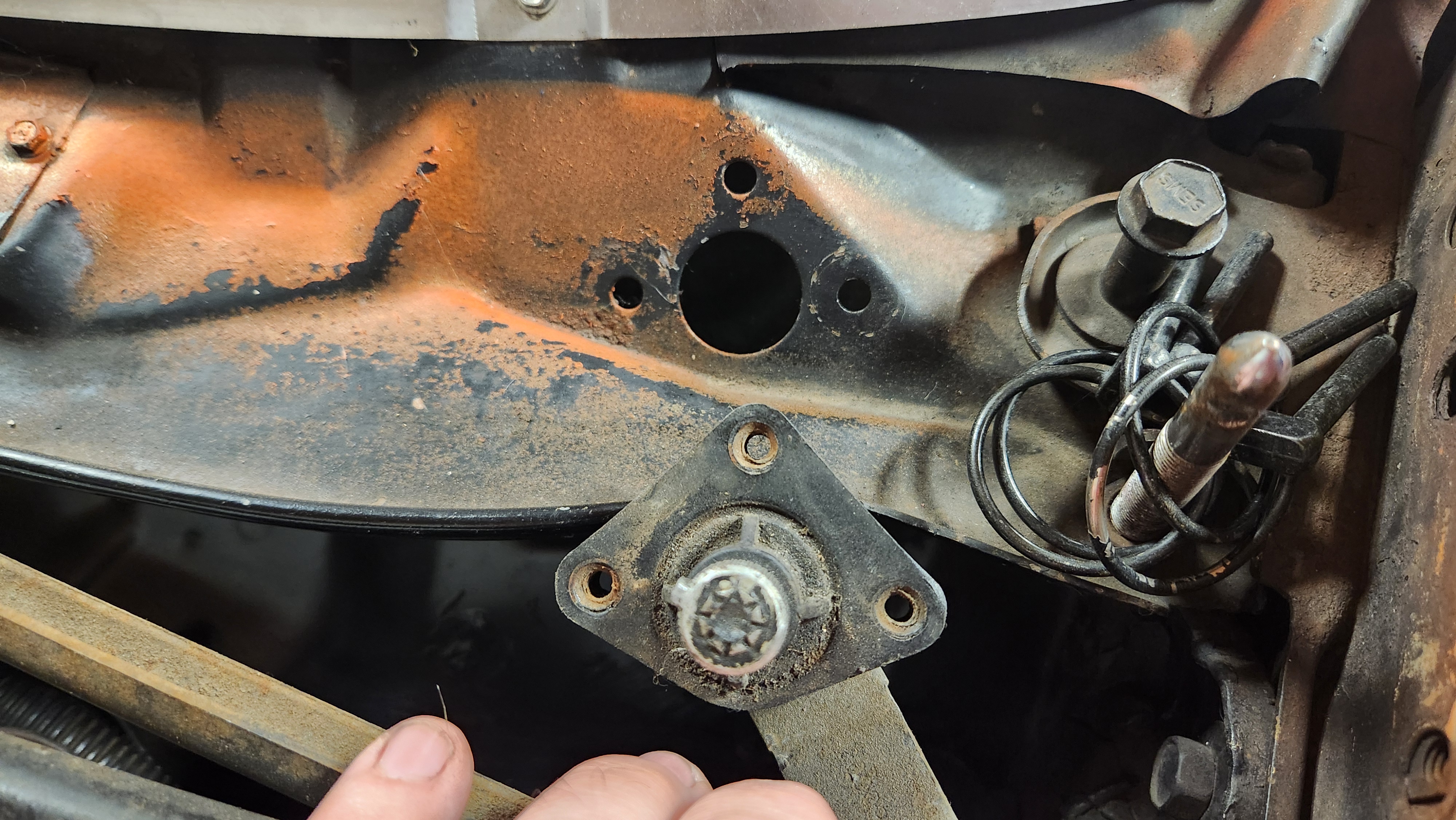

I dug out the wiper components that came with the car, only to find the wiper motor doesn't seem to work. Not sure if I need a switch, as the circuit testing didn't exactly pan out. And I need to procure a set of wiper arms + blades.

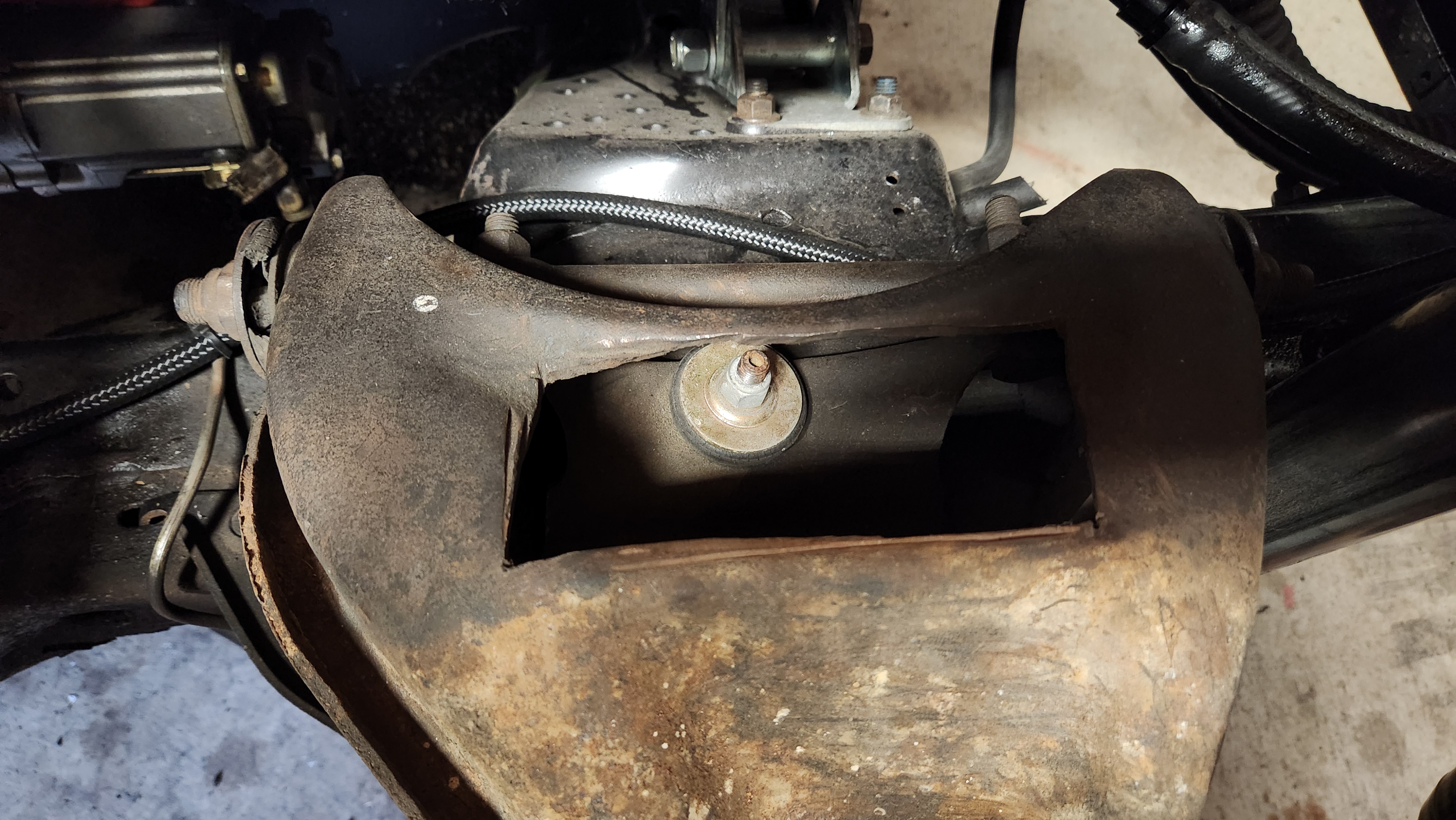

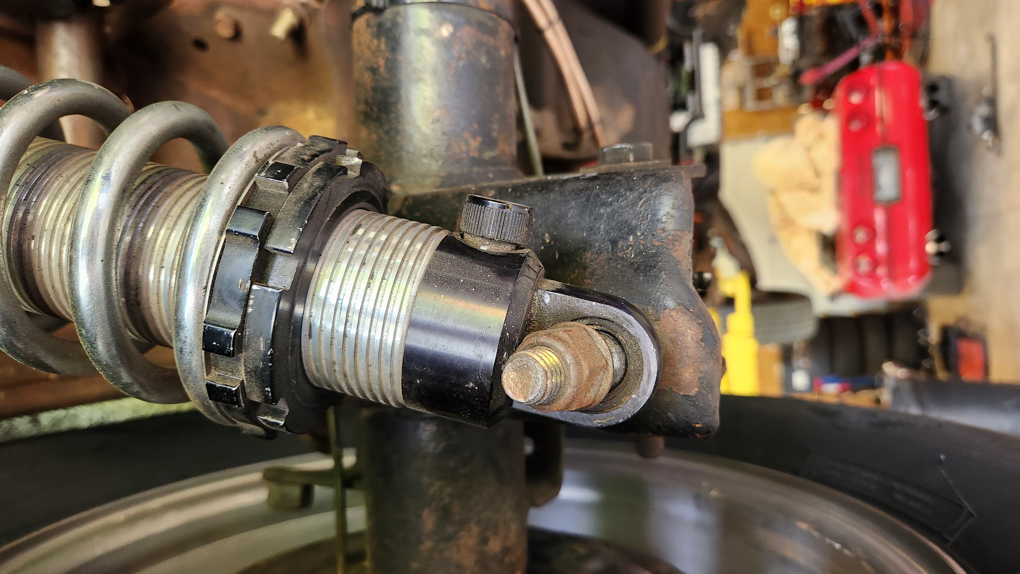

I need to make a decision on the front control arms. The bushings are shot, and I have new ones in inventory. I kinda don't like the looks like these arms for 1000 miles of street duty, though. Could do something as simple as shore it with some rod welded to it, orrrr... get new tubular upper arms. -Dave

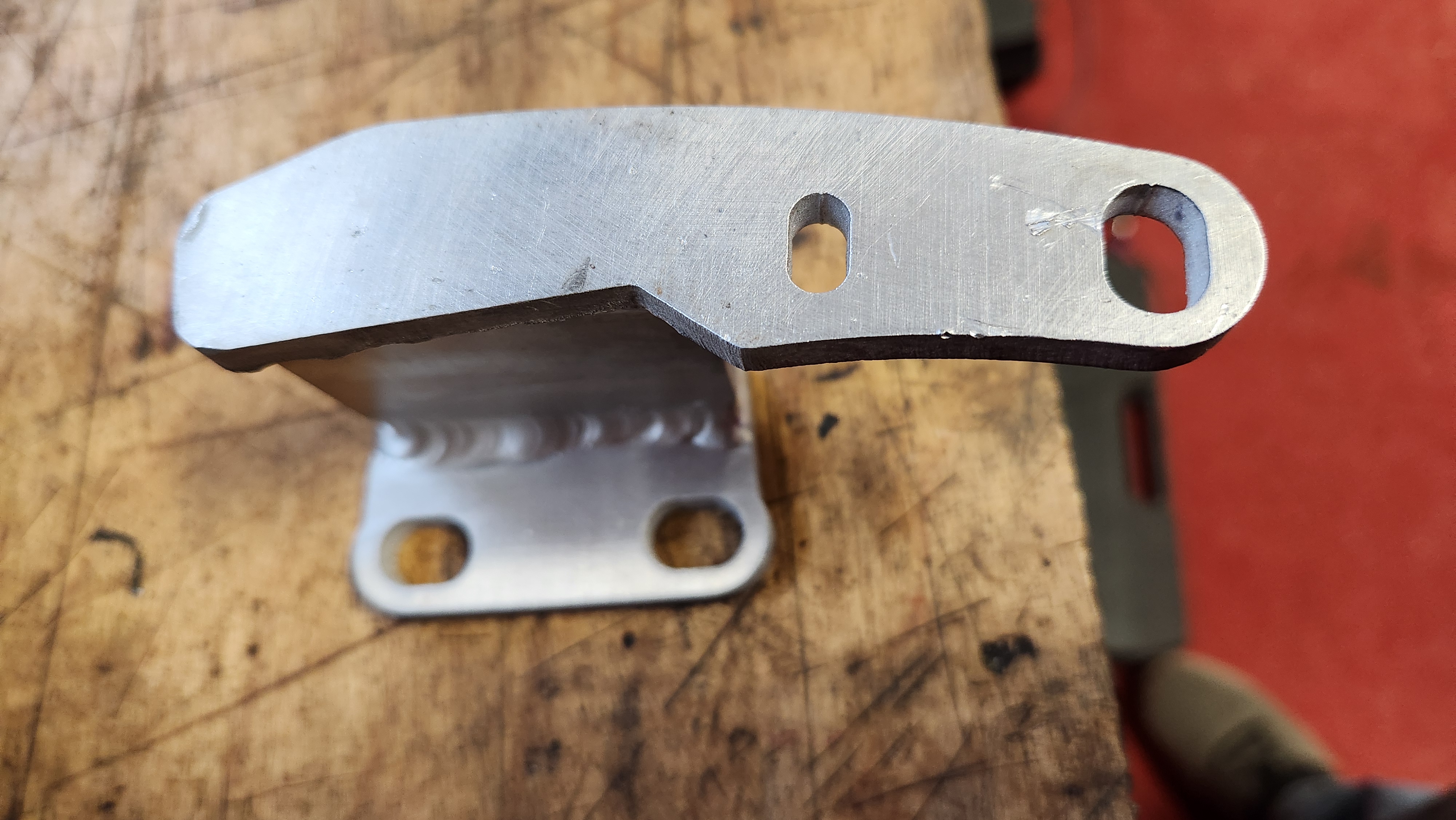

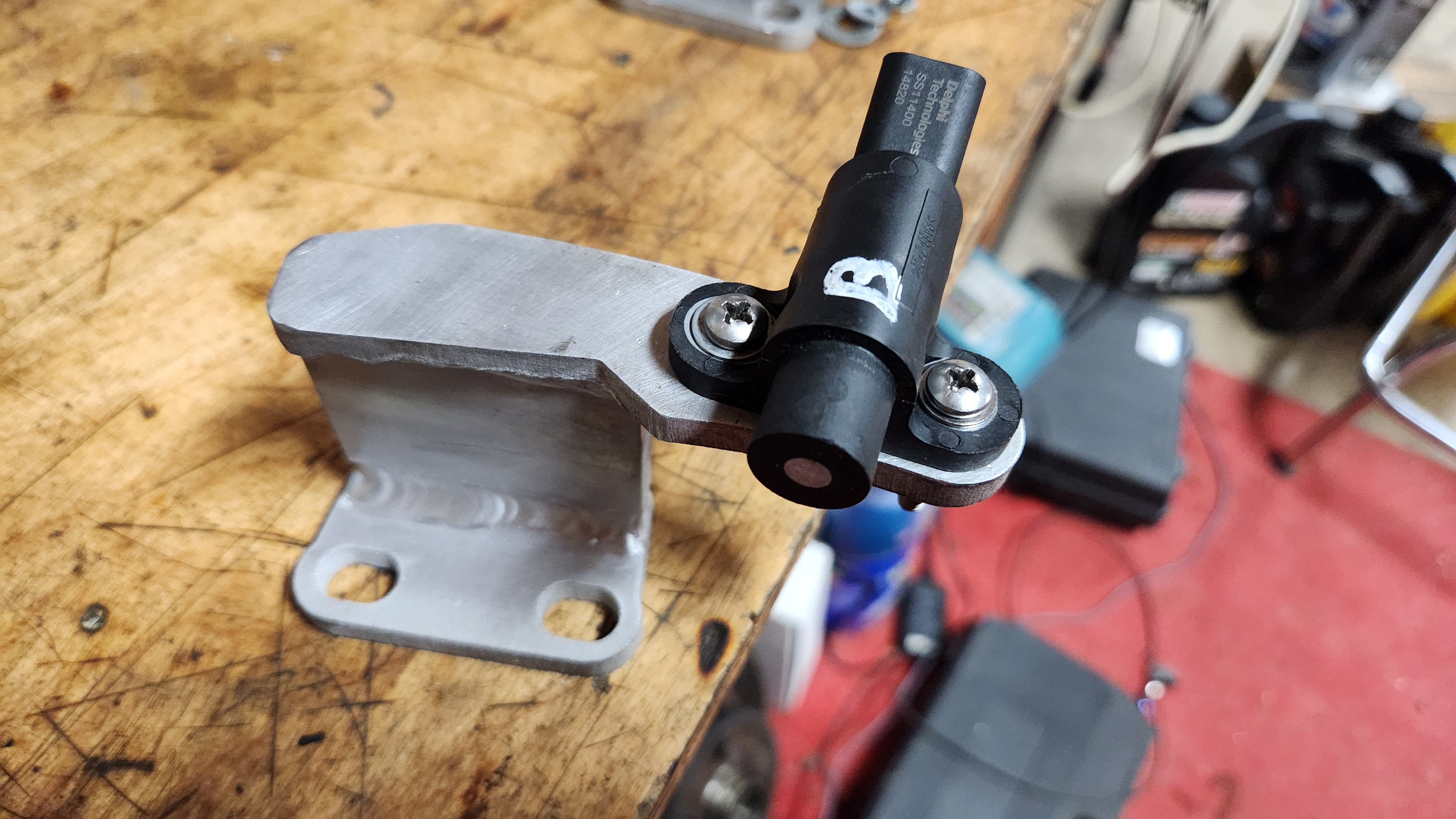

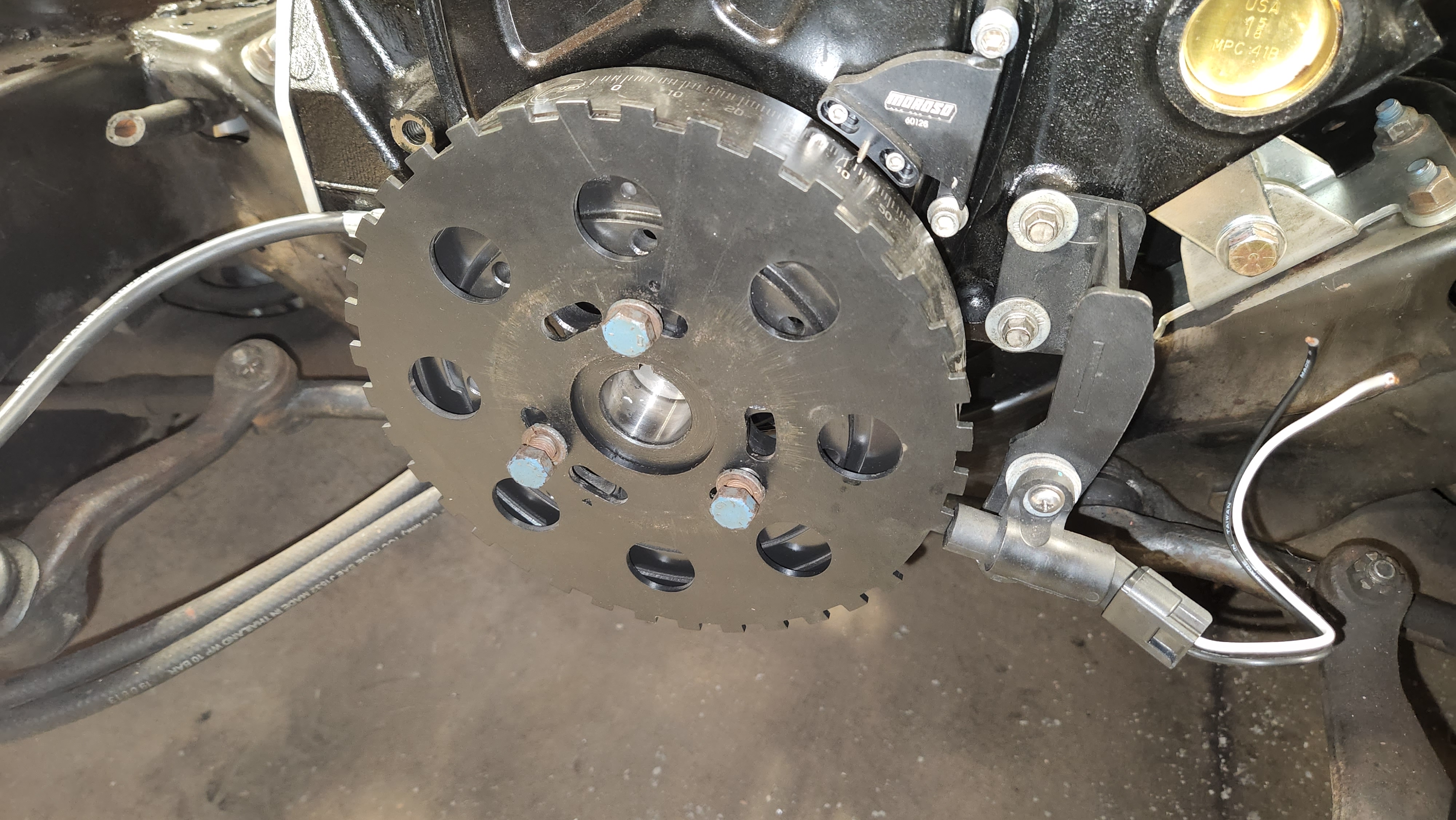

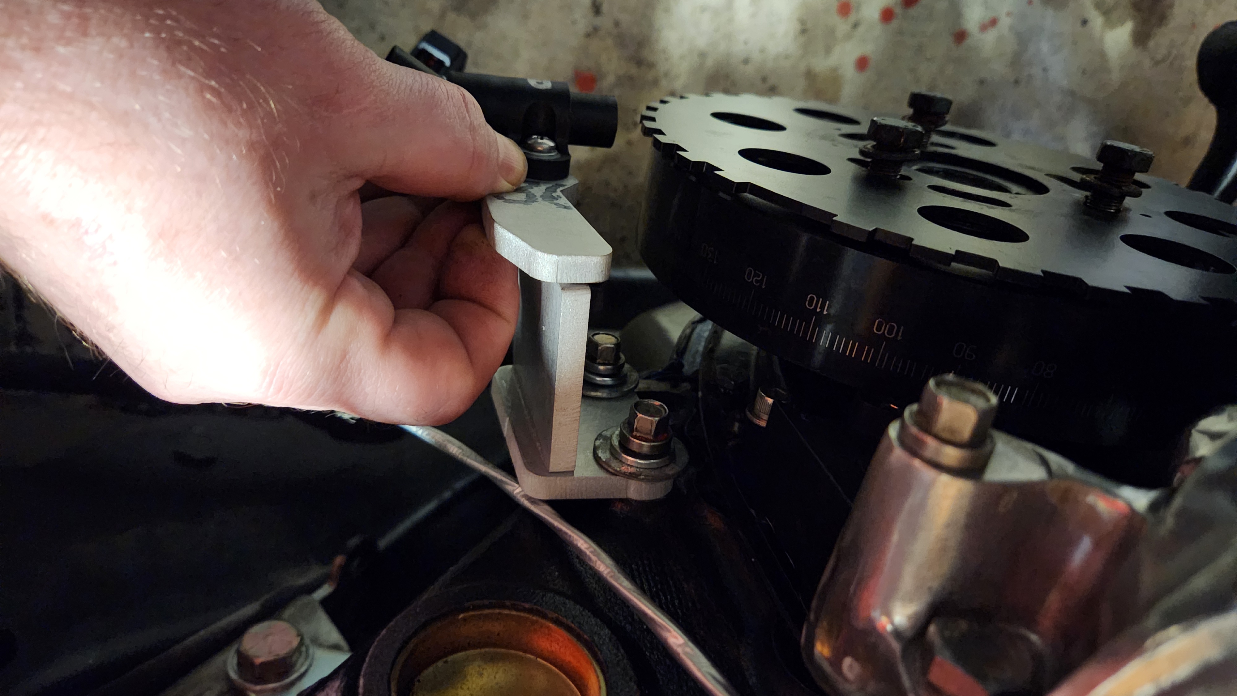

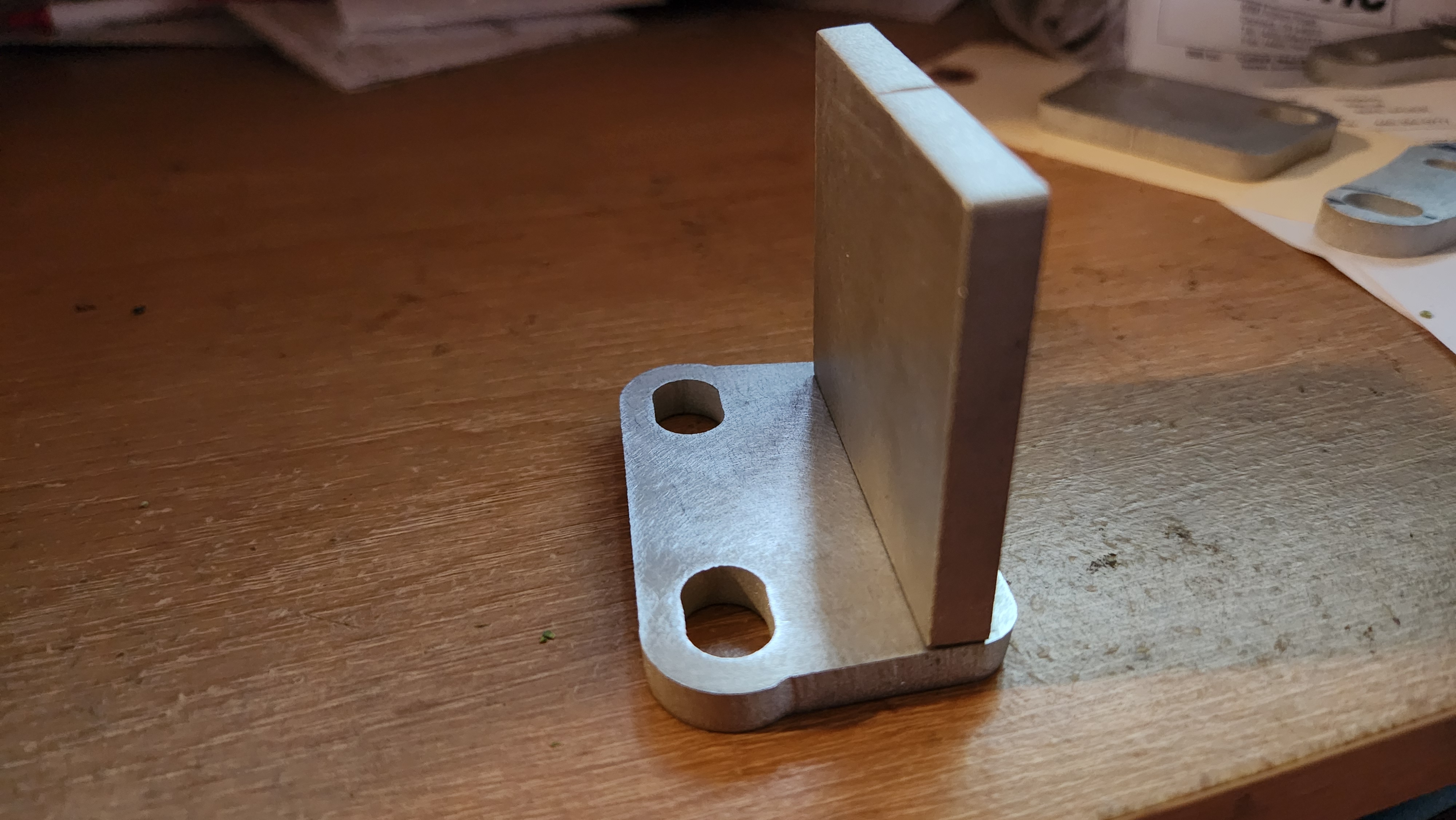

After a couple missed attempts, I finally have a new crank sensor bracket, made from .26" aluminum. It should be much sturdier than the .125 steel, and probably lighter.
Cut-N-Paste didn't have any gas for his TIG setup, so I threw a random post up in the Chesterland Facebook group asking if anyone could weld some aluminum. A guy named Griffin reached out and said he could. His dad lives over in Fox Wood Farms and that's where he does his work. He has some pretty crazy off-roader, has a Tacoma cab with some crazy exo-skeleton. Off-road/rock-climber. I had dropped off the pieces to him a week ago, but didn't have the orientation fully marked. So I took the final set of pieces down to him today and he welded them up while I waited. It came out great (so did the wrong one). They seem like good people. So I have a pretty cool local source for aluminum welding now.
I had to open up the holes on the block-mounting side just a little so I could get the sensor close enough. But after that, I set the gap at .91mm and it fired *right* up. That felt really good. I picked up a set of drag radials that I can feel a little better driving around on the street. They are only 28" tall (275-60-15), but I haven't bolted them on the car yet.

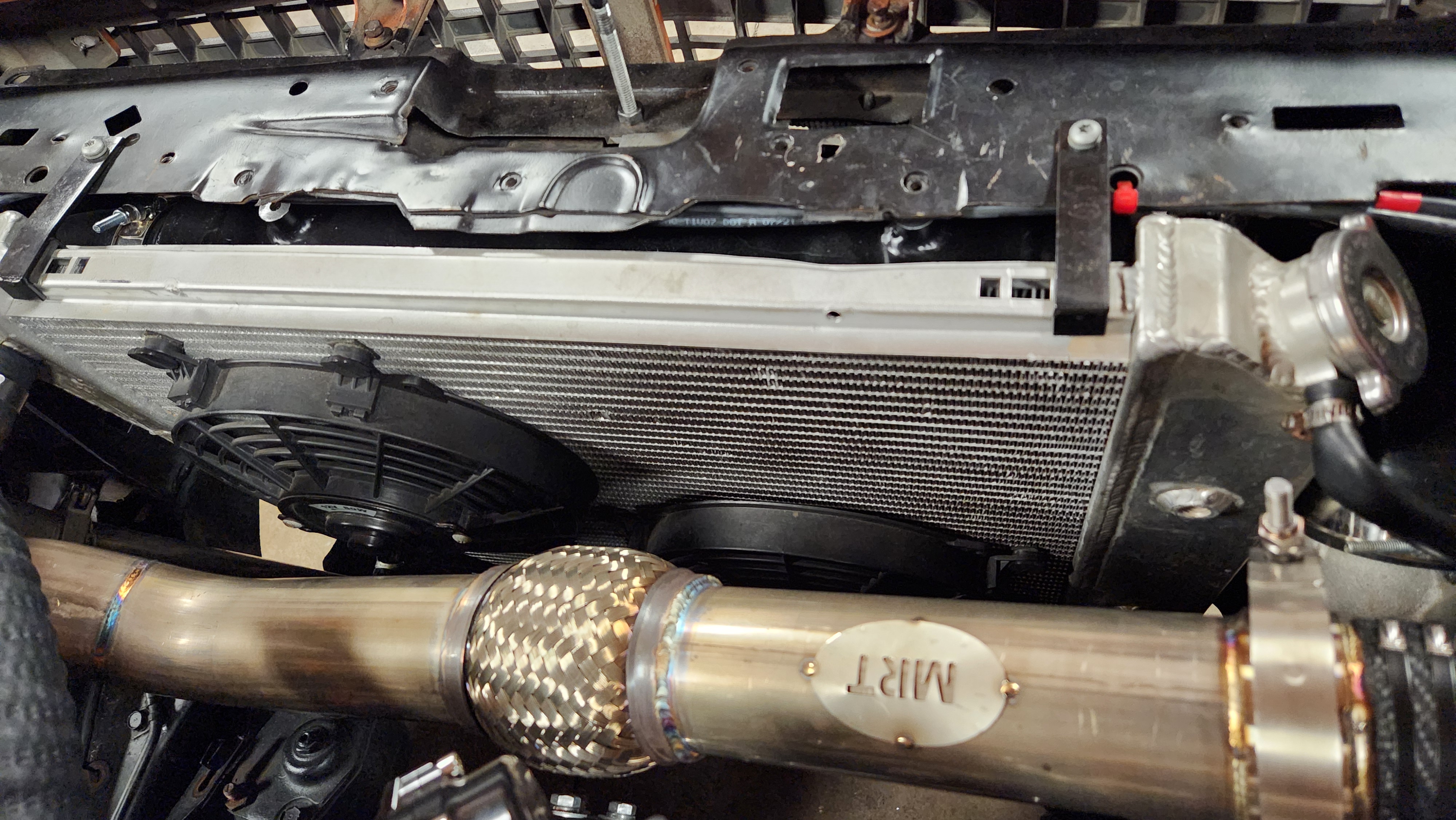

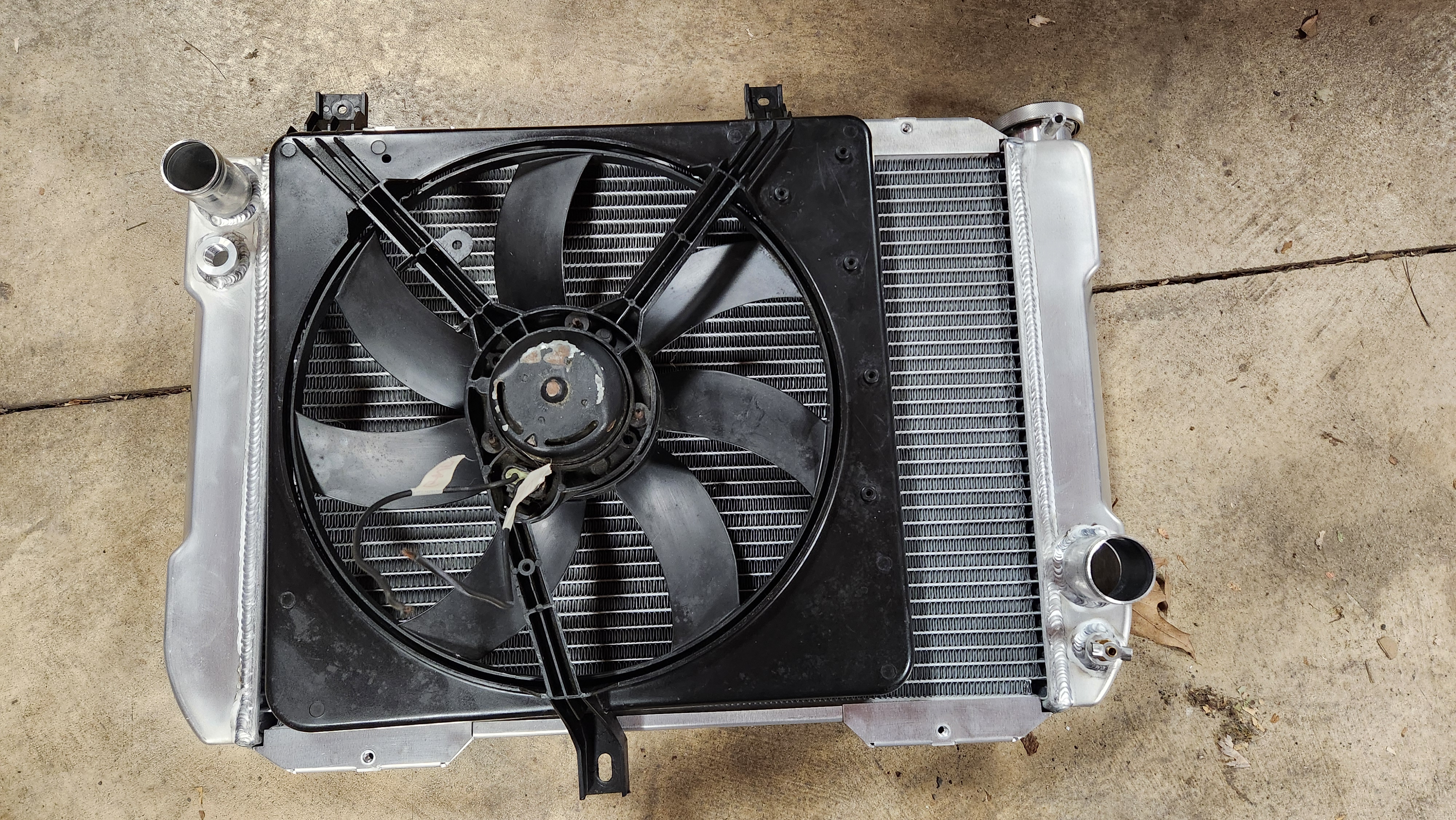

I also got a new radiator. It's the same size, but thicker. This is the fan I'm going to use. Some factory GM fan. You can see how much more area it covers versus the 2 dinky fans I have now.

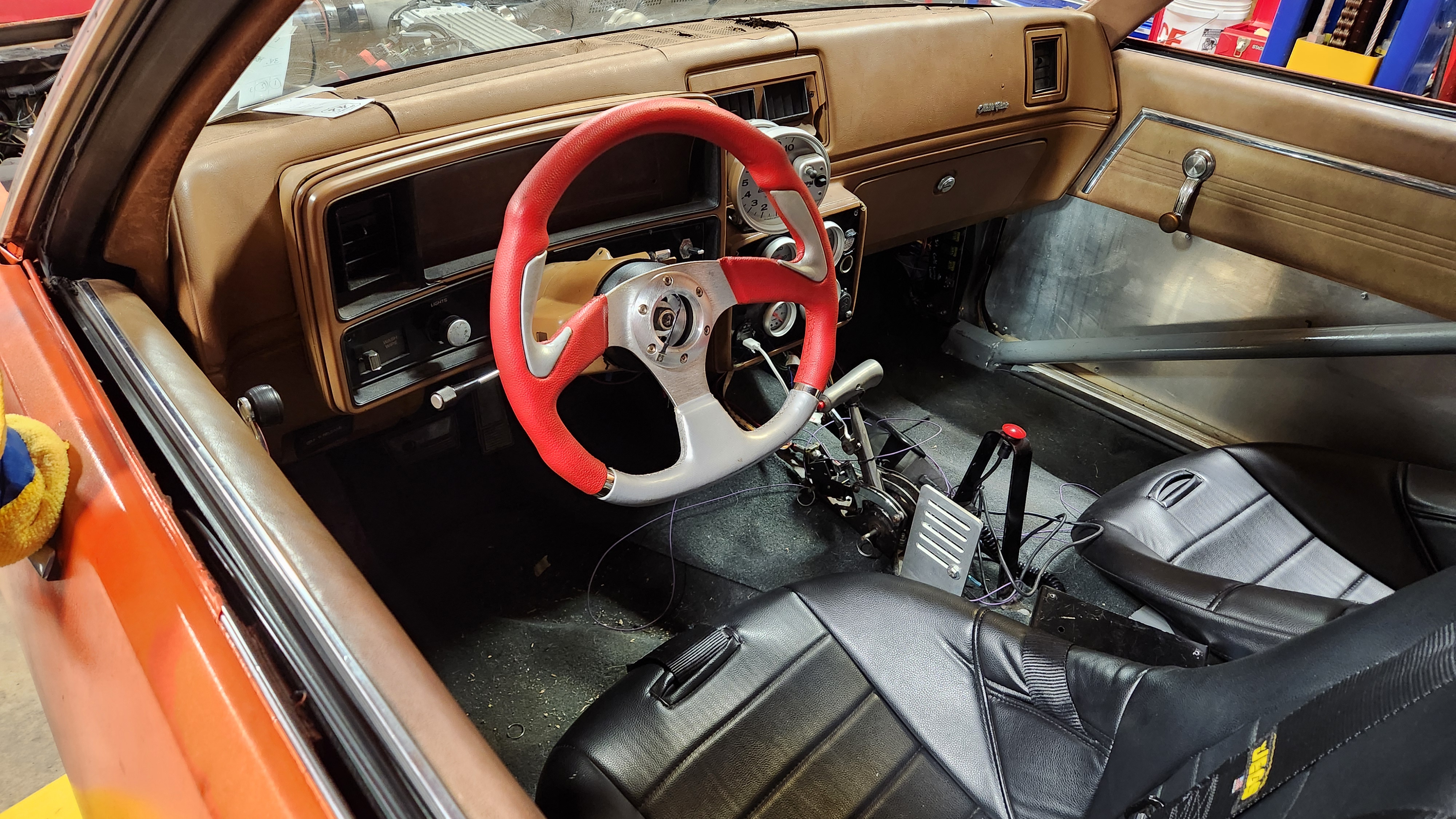

I'm still trying to come up with a removable steering wheel hub. Worst case, a smaller, flat-bottom steering wheel.

Are going to wrap that exhaust pipe between the block and radiator? Seems like a big source for underhood heat. That fan and radiator combo should be quite a bit better.
- Posts: 2655
Re: 1979 Malibu
Yeah, I do need to wrap that. I'll do it when I swap the radiator.

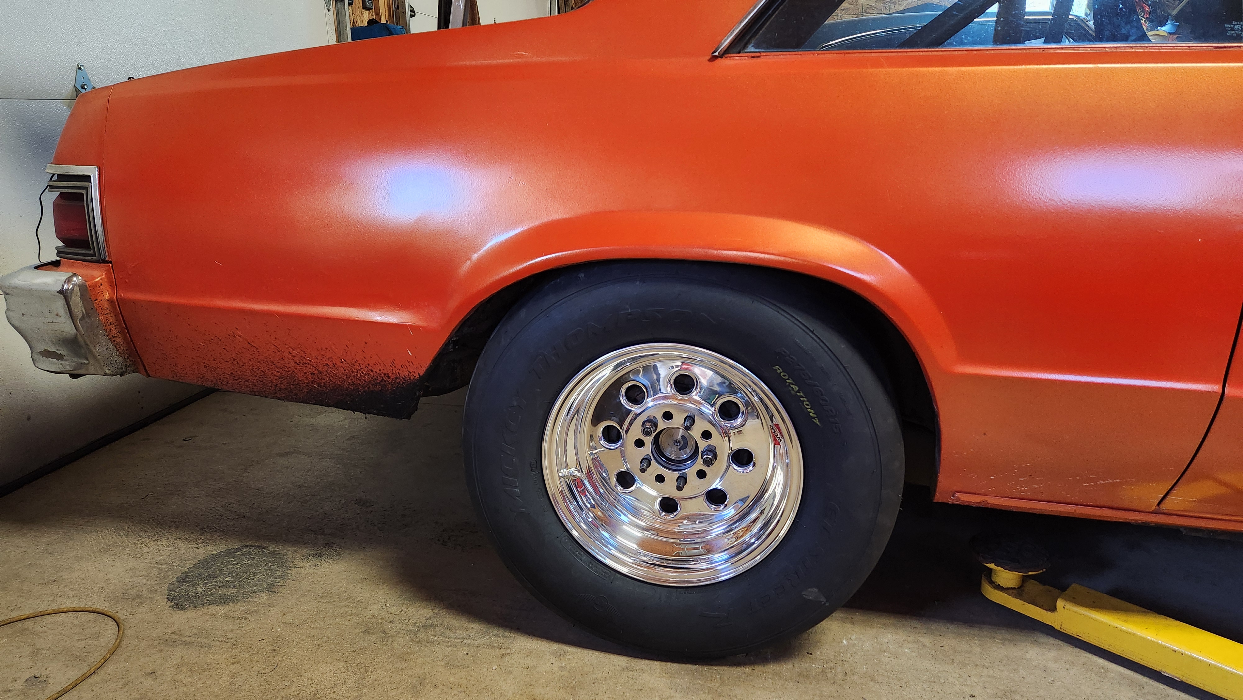

New rear tires (with correct rotation!)
Re: 1979 Malibu
Like the wheel and tire combination.

*) I bought an adapter off amazon for GM 36-spline steering to 6x70mm, which let me install a steering wheel that I had in inventory. Smaller diameter and a flat bottom to help get in and out. It helps over the oversize GM truck steering wheel that was in there. I know it looks terrible. It was a total swap meet special. But I now feel entirely better about whatever stupid money I spent on the steering wheel. ($20?)
*) The crank sensor is resolved! I tried it (briefly) on the transbrake-2step and all seems well. Woohoo! Also, Chris dropped off 3 more sets of pieces, should I need to make more.

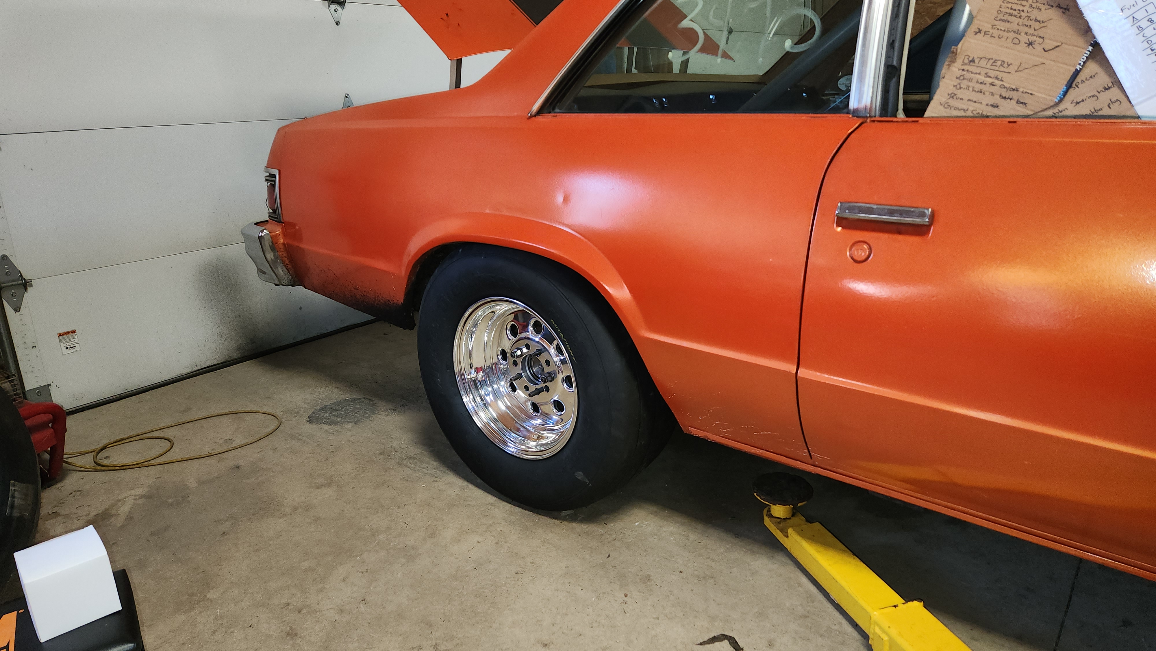

*) Went for a test drive around the block. Drivers side tire (new tires) rubbed terrible on the outside. We put the car back on the lift and raised the bottom spring perch on the rear springs. We were able to raise the rear of the car enough to go for a longer test drive with no rubbing.
*) Current radiator is totally inadequate. It cant keep it cool even driving around at 40mph. It just kept creeping up. Over 200 by the time we got home. But I also have an intercooler right in front of it. We eyeballed it up, and it looks like I should have the new radiator modified with a 45 or 90* bend out of the radiator on the top/inlet side, to work around the turbo crossover pipe.

I'm sure that big steering wheel was in there to help steer the car with no power steering. Your ingress / egress ease will be a tradeoff with harder steering at slow speeds. Looks like a video game wheel!
