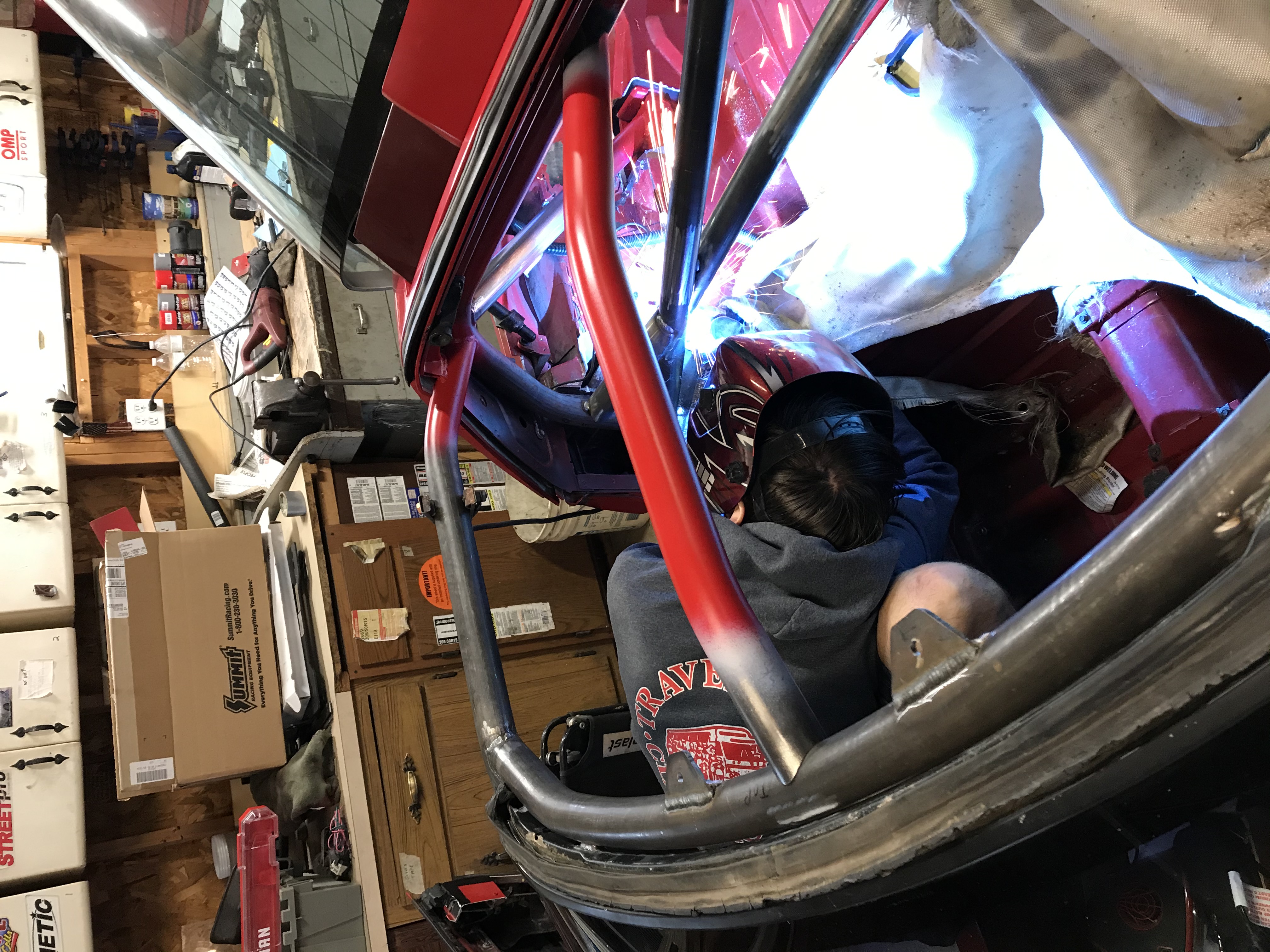

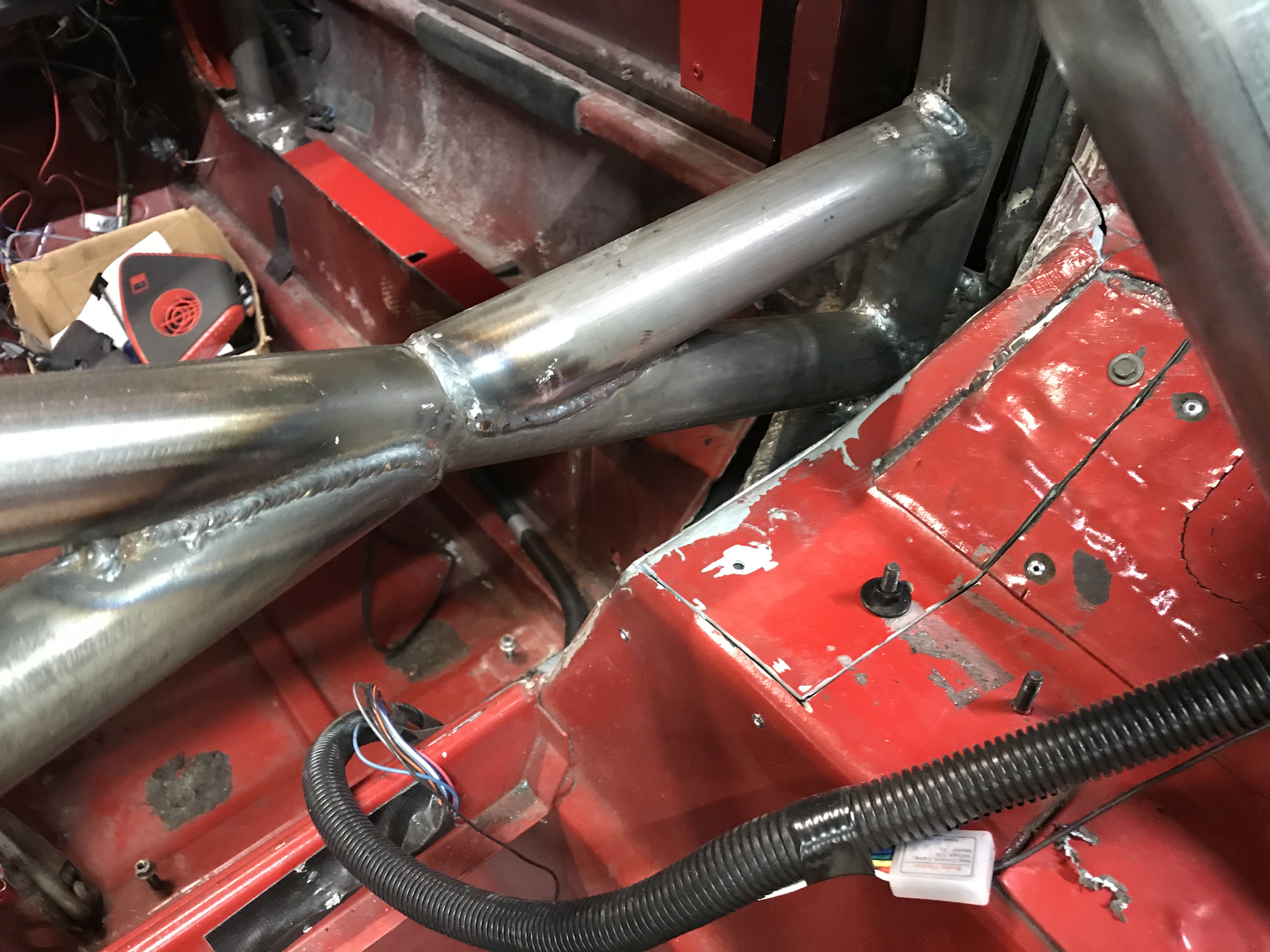

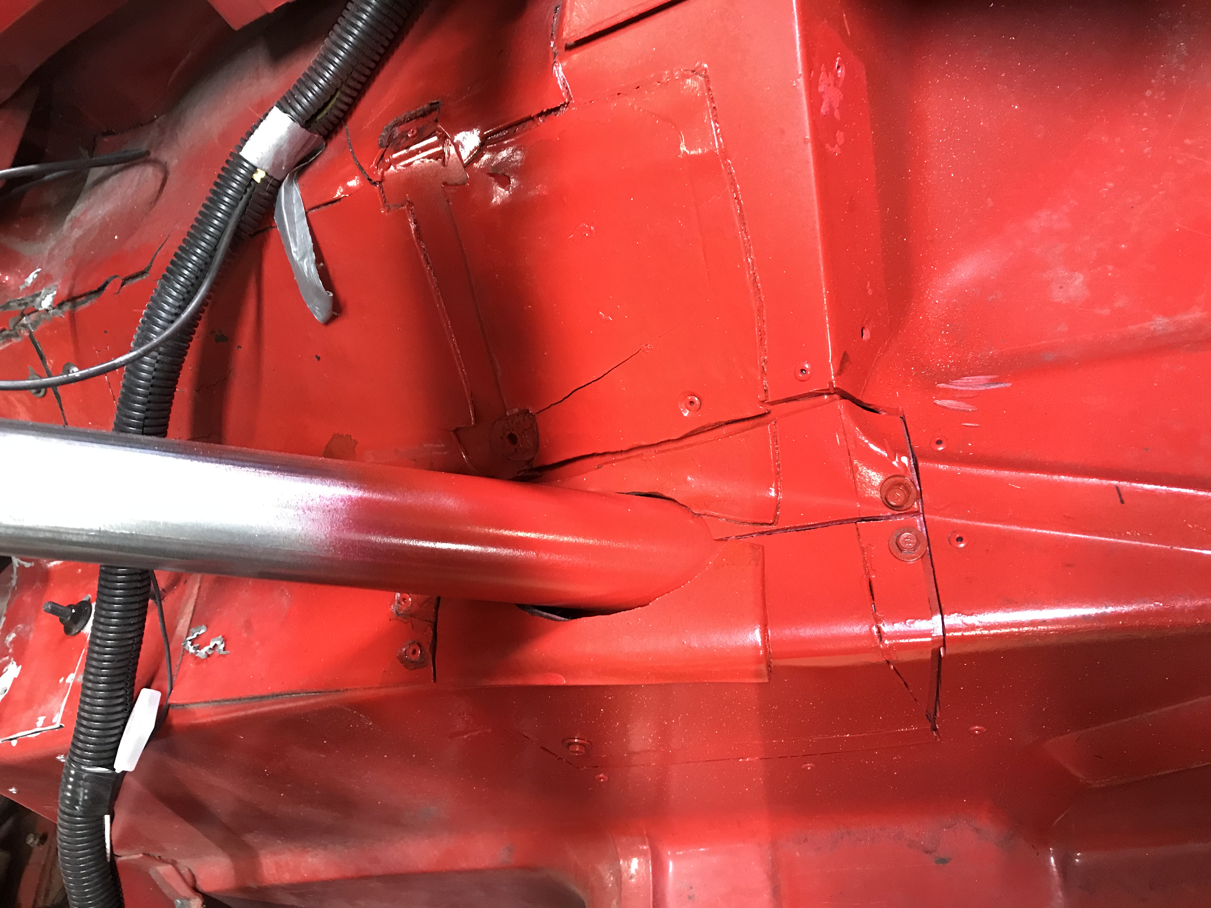

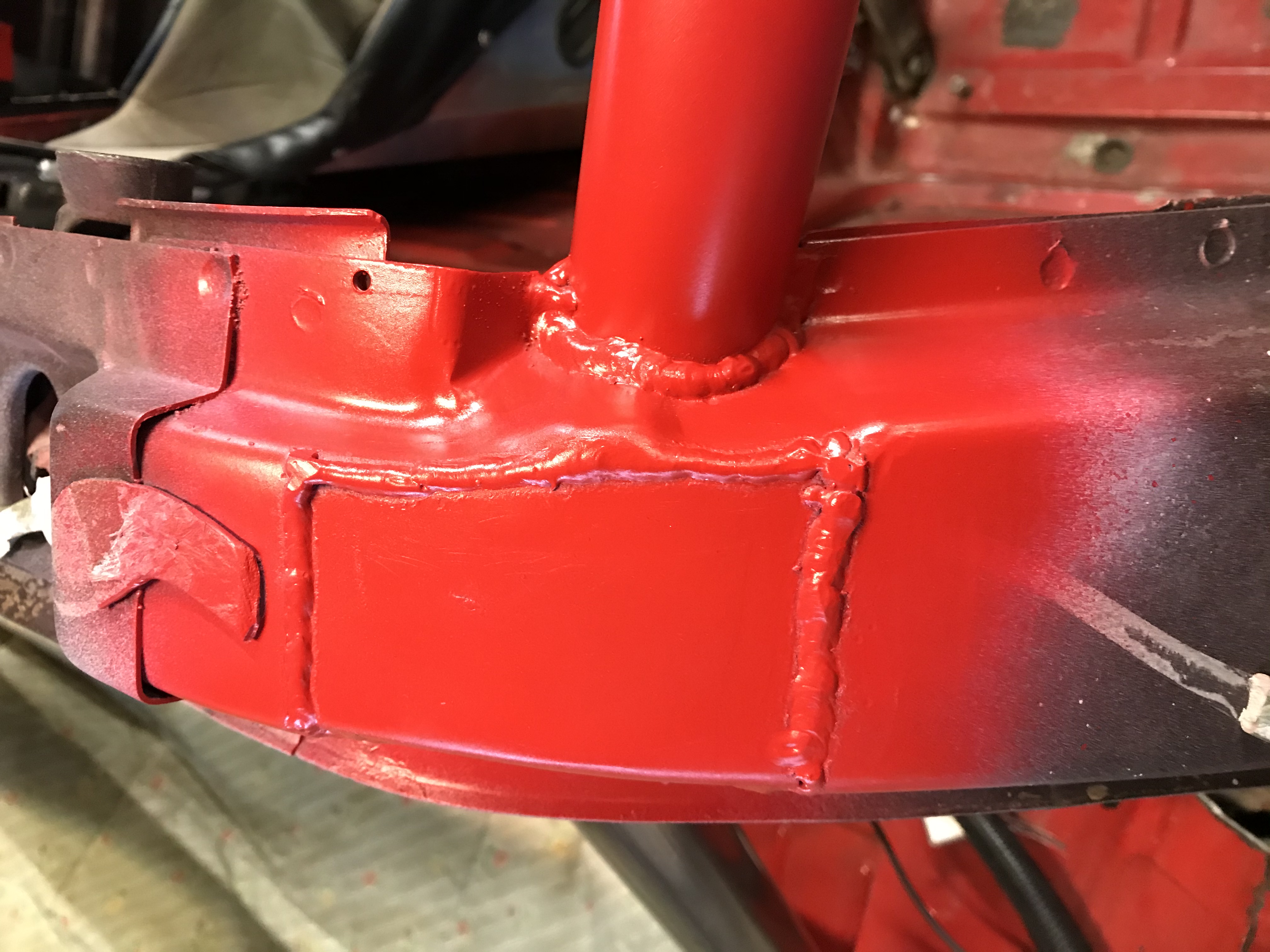

roll cage:
* harness bar and center top bar fabricated and welded in
* roof tabs welded onto targa top frame and roll cage - test driven this holds good
* fabricated removable covers for roll cage mounting points in the back. This took an inordinate amount of time due to needing these to be removable for safety inspections.
* cage about 80% done - now needs dash bar and door bars on both sides

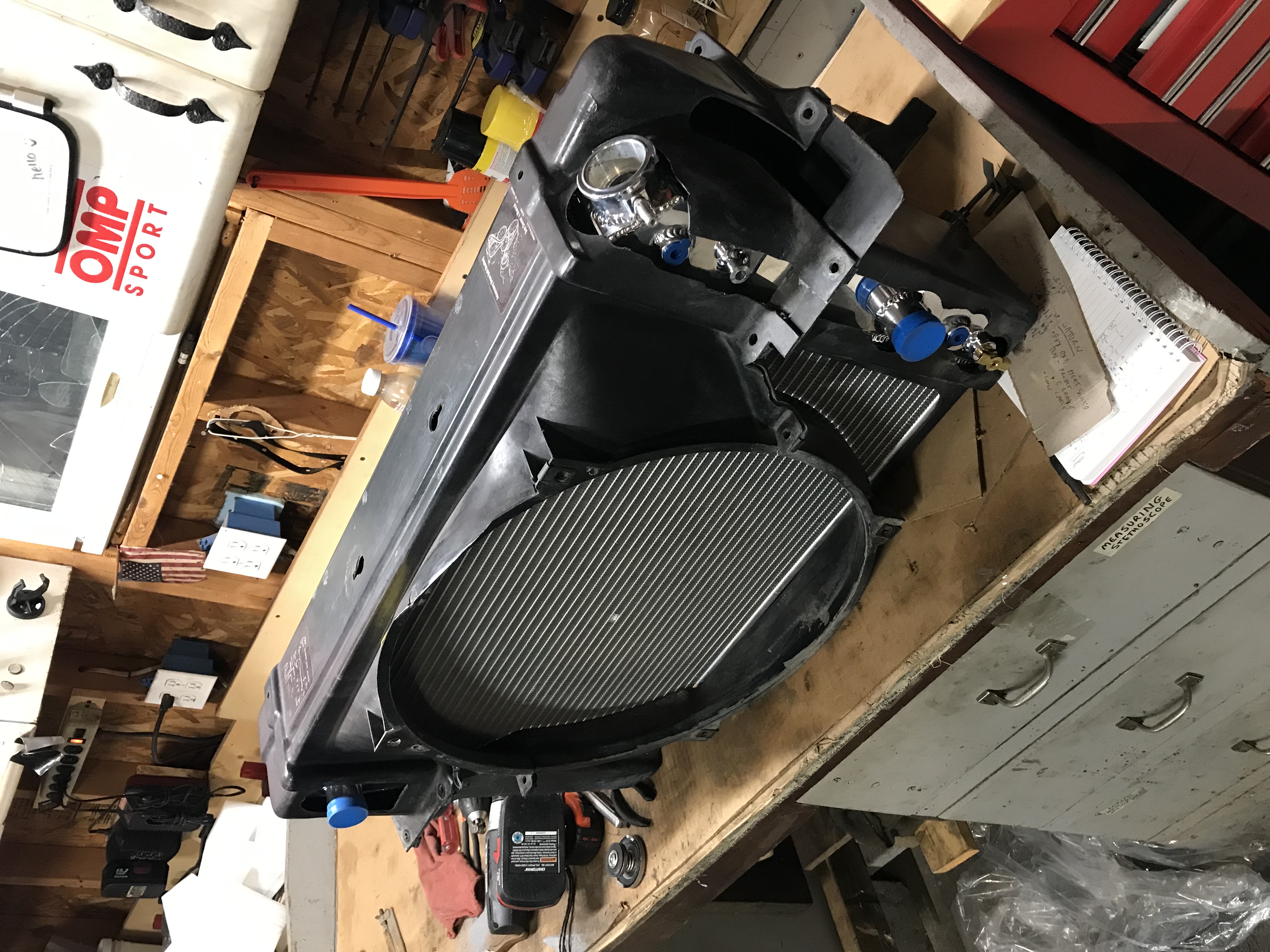

Last weekend I started fitting the new radiator into the factory shroud. I’m using the shroud I got from a lot of parts I bought from an 86. It physically fits in the shroud with all the openings in the right place but lots of fab work will be needed to make it fit. I started trimming the shroud and the rubber grommets to fit this new wider radiator. Still a ways to go but it’s a start.

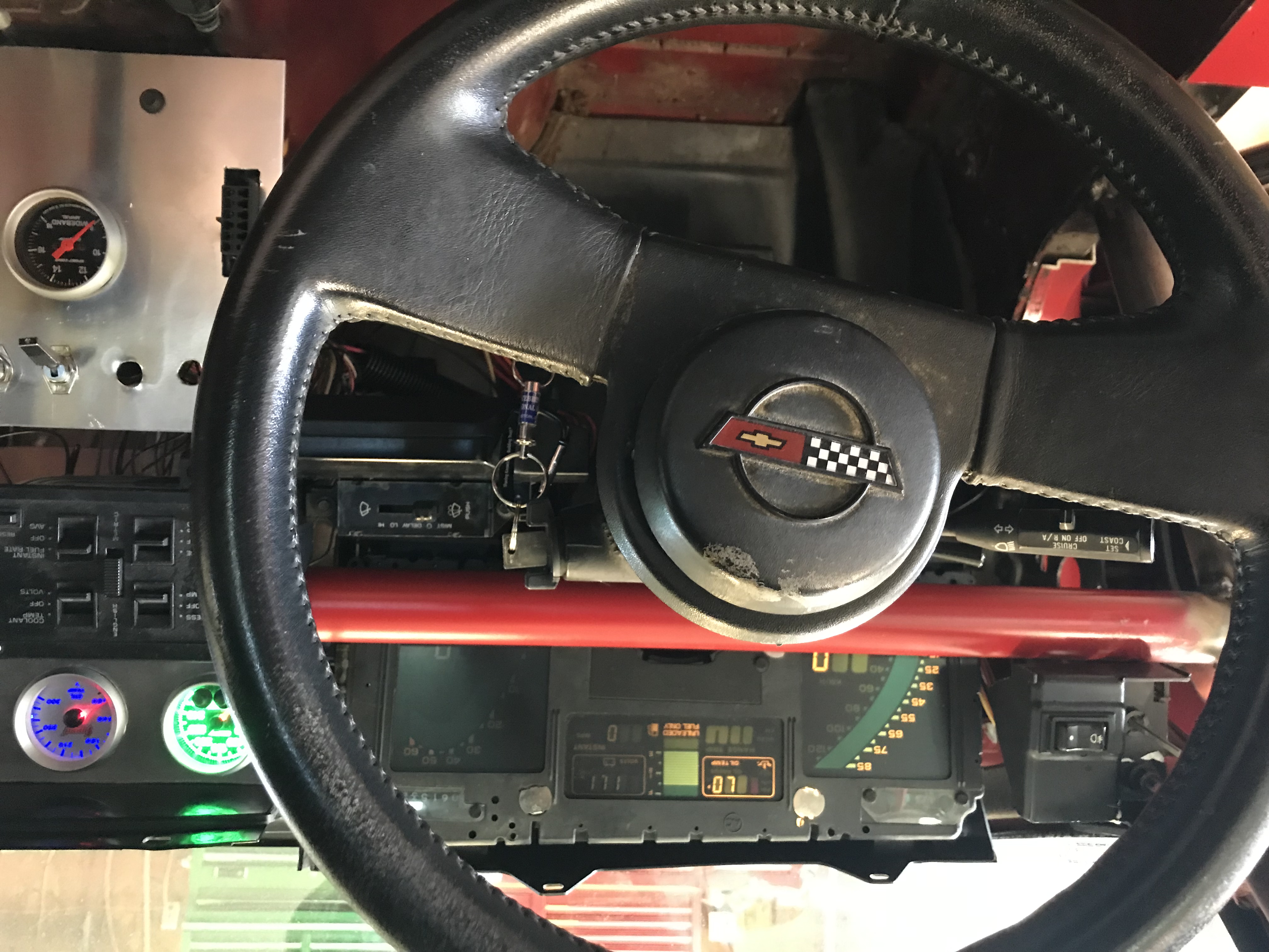

This project has been stalled for months. Apparently retirement does not automatically make enough time for two race cars. Since the Saturn now need an engine teardown and Kurt is slowly putting his Vette together, I decided the next step is to get some kind of dash setup for this car.
With the dash bar in place it was obvious the stock dash would not work as the bar goes right through the digital dash space. I'm not planning on having the digital dash long term, but converting all that info to different gauges going to take more time than I want to spend right now. With this in mind I looked at the dash, and realized I could move the digital dash back and up a bit and still use it. I cut and had Kurt weld the support bracket to get that part of the dash in a good position.
The center of the dash also got repurposed, as it will be much easier to adapt to it rather than start from scratch. I've mocked up this center section and tried it in the car for size. There is a little shelf on the left side where the wiper controls will now live. 1/16" aluminum sheet is on order and should be here this weekend.
Also the left side of the dash - which holds the headlight and fog light switches, got adapted and will be used.
I also painted the dash bar, repaired the connection points for the center section of the dash, and fabricate something for the two fuse panels.

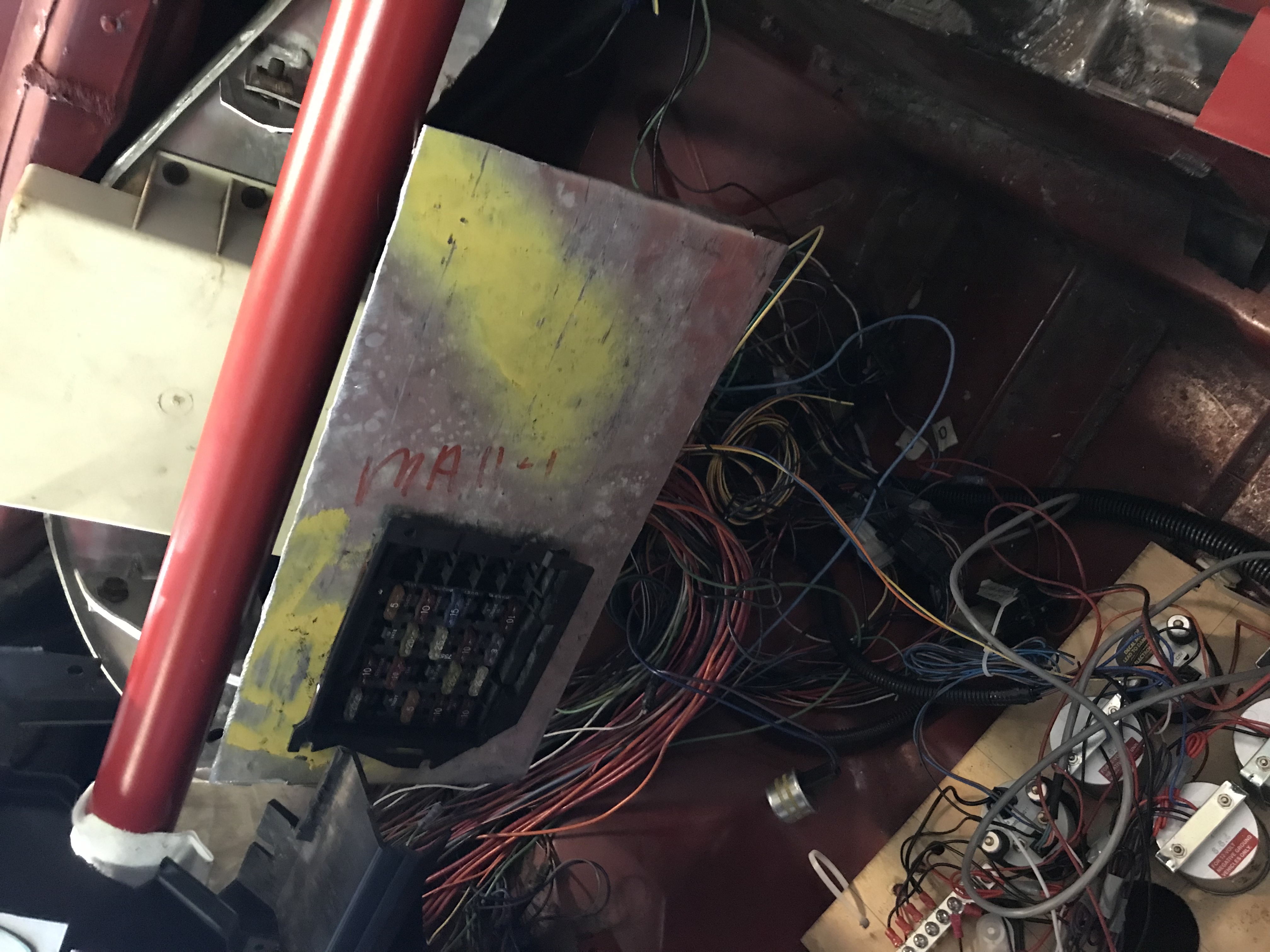

The dash bar is now welded in and I have rough fabricated a bracket to hold the fuse panels

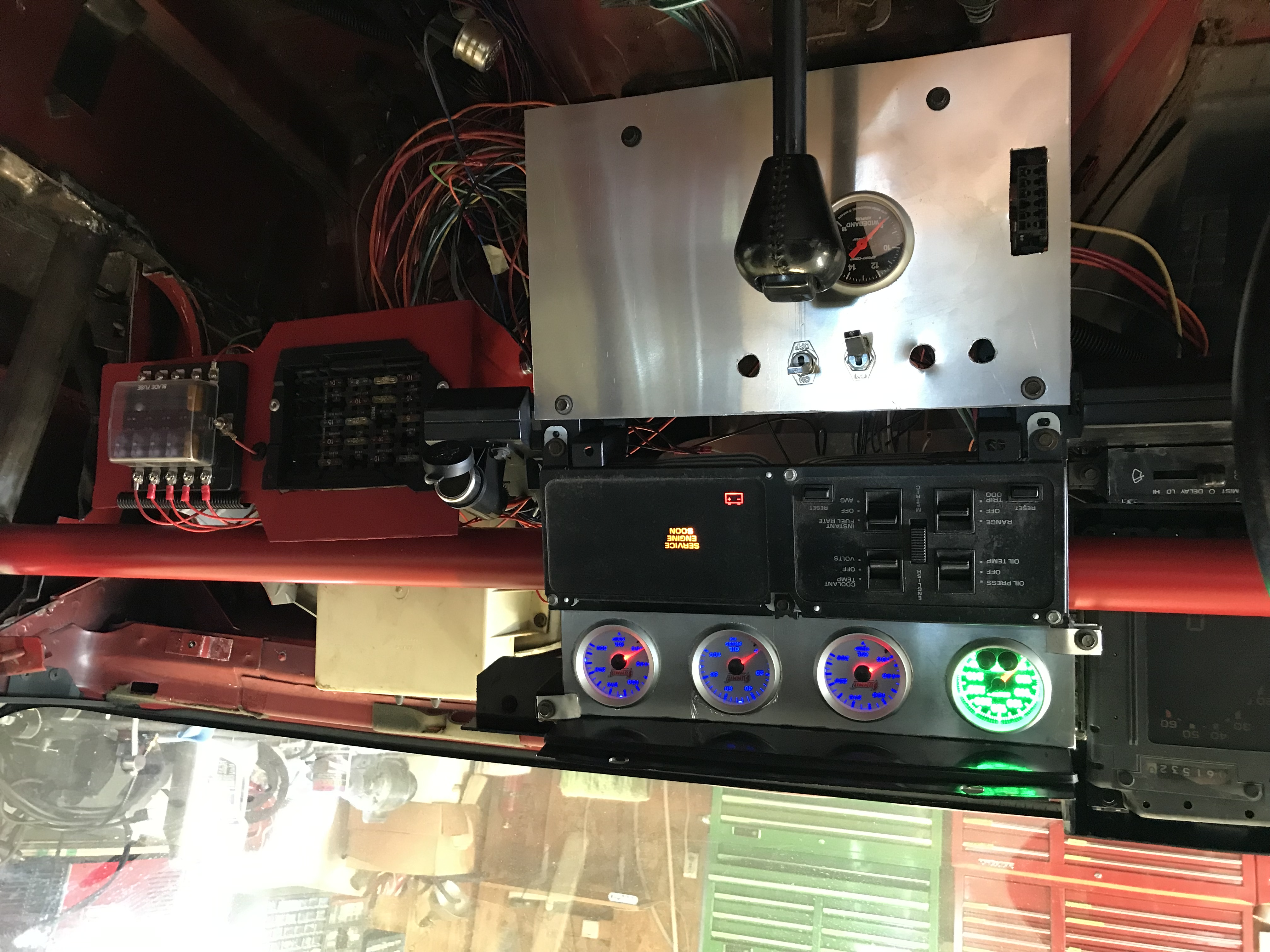

It doesn't look like all the work it took, but the dash fabrication is done and all major components are assembled.
Moving the gauges to the center of the car, and moving the ground bus and light bus required some rewiring. My plan was to make these buses and the fuse panels easily accessible for troubleshooting.
The center portion of the dash is connected to the car in three of it's original moorings, and one additional connecting it to the dash bar.
I decided to cut the lower center panel for 5 switches, the diagnostic port and one gauge. Later we can add fire suppression, kill switch, and the radio. The metal is 1/16" aluminum sheet - and this panel is held on with 4 bolts. It can be easily replaced if another configuration is needed.
The fuse panel bracket was cut from some diamond plate aluminum - it was an old floor mat that came with Kurt's Saturn. It's a little thicker which reduced the need for side support. Again I was able to use factory moorings to connect it to the car. Since the aluminum was scuffed up, I decided to paint it red to match the car - as I had painted the roll bar as well. There are still a ton of wires and some various plug in modules that used to be connected to the dash (low coolant sensor module, flasher module and others) that need to be gone through. I'll have to decide if that is next. As far as this car - the next big item will be to get the new radiator, oil and transmission cooling installed. At this time the radiator is fitted to a shroud, but the other coolers need fitted. After these are operational I may consider a track day with this car. As it stands now, it's close to ready for some passes at the drag strip.
