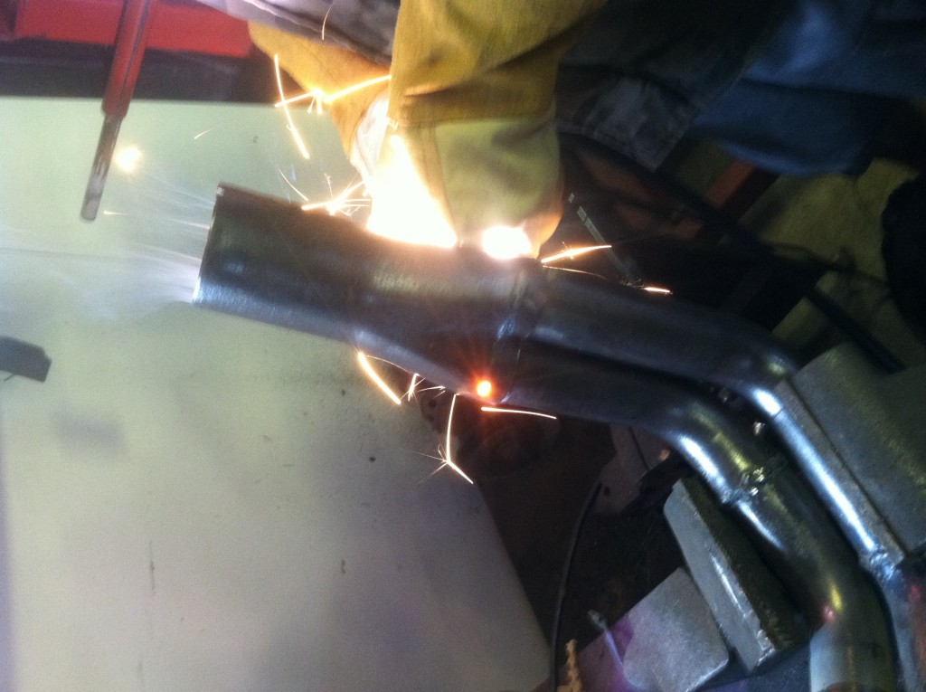

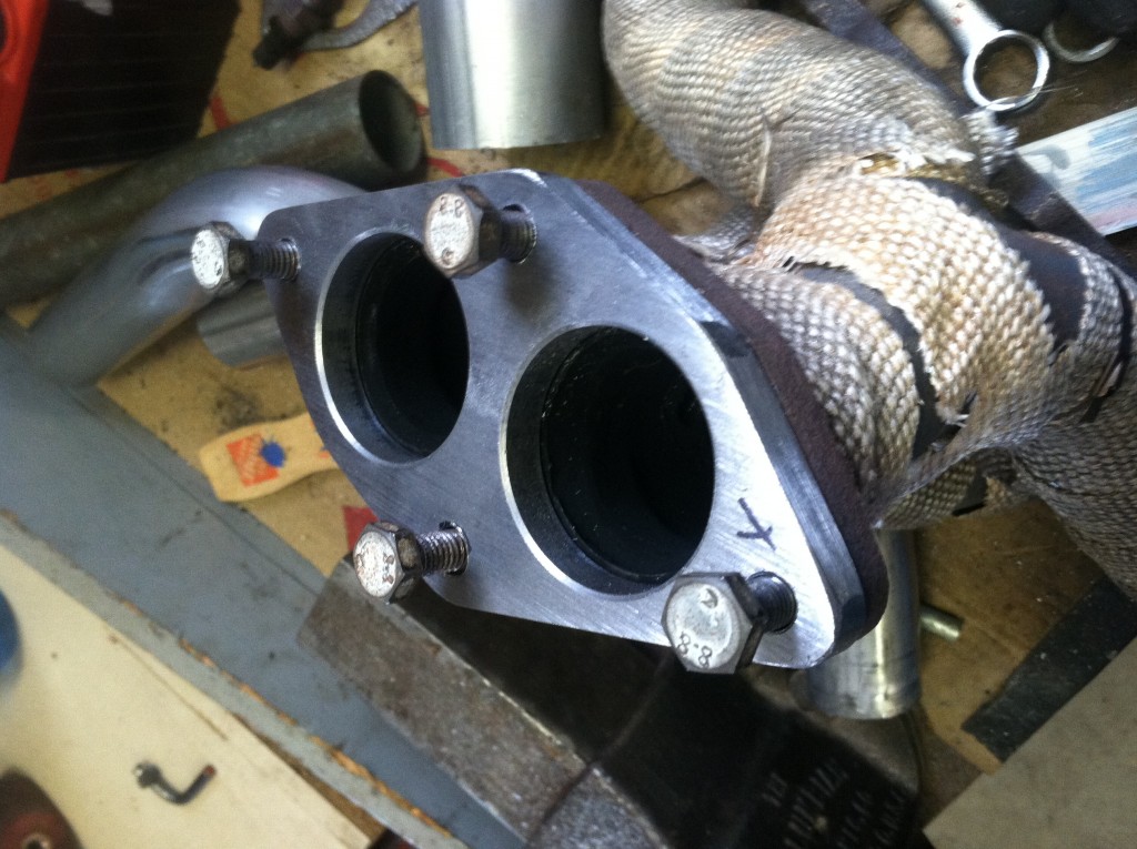

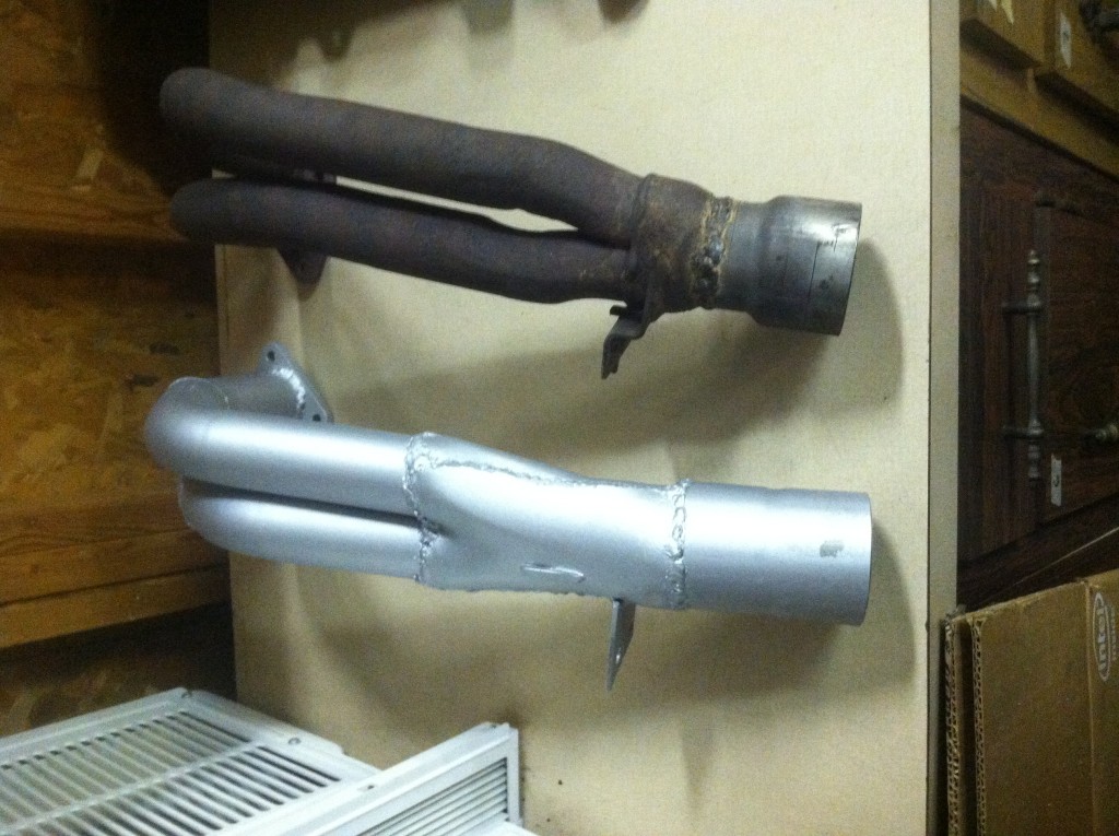

So quite a bit has happened since the last post.
1) Baseline horsepower. Took the car and put it on a dyno to baseline.

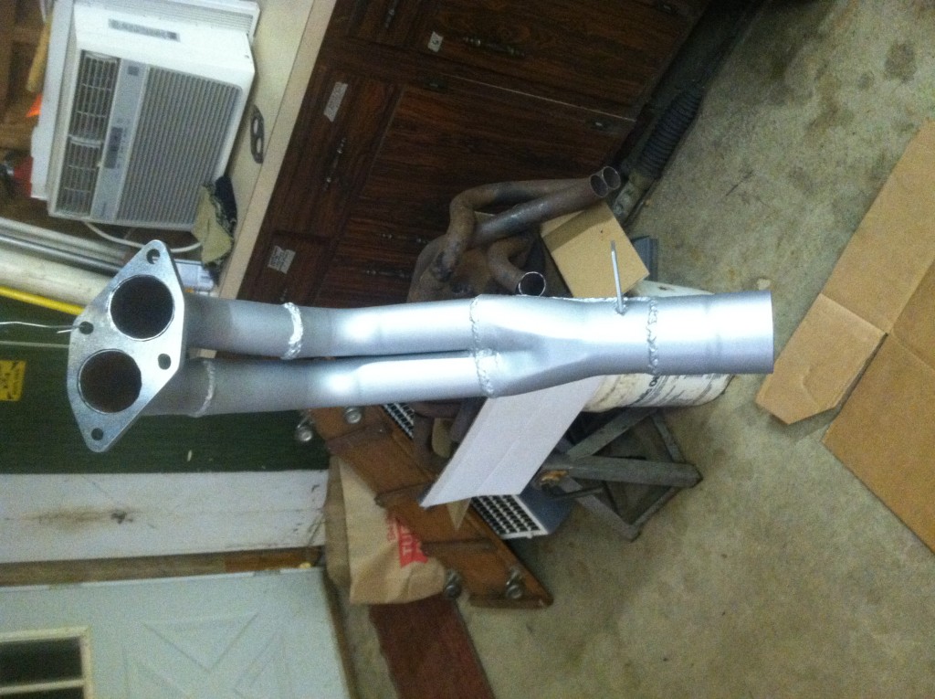

2) Exhaust upgrades. Yikes the downpipes were small. In 2011 I put an Autozone downpipe on there and that was a mistake. Countless horsepower wasted over all the races. The rest of the exhaust was bad also - stock width pipes from the muffler back up to the midpoint of the exhaust. It also had a SuperTrapp muffler which I guess is not that great either.
First I decided what I wanted. After some research I decided to get larger downpipes 1.5" into 2.5". Also decided to shorten the exhaust and drop it in front of the rear wheel. To do this I would need a muffler that would fit in the tunnel where the cat sits.
I took it in for an estimate and the shop will not do an exhaust without a cat so I decided to do the exhaust myself. I will take it back there for the downpipe since I can't bend the pipes. In the meantime the original downpipe was larger than the Autozone pipe so I started with that. I had the muffler shop make a short custom pipe to help.
I am embarrassed that it took this long to address it.
Of course this needed welding.
3) Measure air-fuel ratio. The car is running rich and in order to know how rich I will need an air-fuel gauge. Since the car runs on narrow band O2 sensor I decided to get a second sensor and a gauge. Found a good one online and installed it. This confirms what I learned on the dyno and gives me a chance to adjust it.
Much more analysis after that and I now have a way to control fuel pressure using stock parts. I just need to implement it.

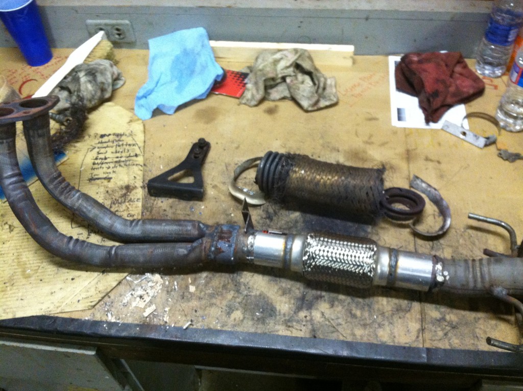

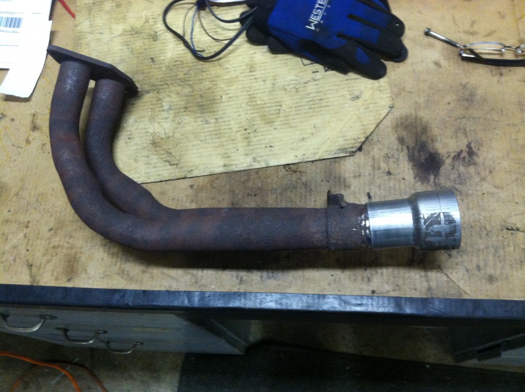

Wow am I behind on posting here. Last year the plan was to free up the exhaust. I have already explained most of the mods above, but the downpipe did not get done until after the 2015 racing was done.
The worst downpipe - and what had been on the car since fall 2011: The original downpipe - adapted to fit large exhaust - on the car for 2015 race: When this year came I wanted to improve that a step further so I got to fabricating a down pipe. There is no one offering a flange to fit the Saturn header so my cousin machined one: I then needed the 1 3/4" downpipe material. I tried having a local chop bend them up but they did a poor job with the bends, so I found a used set of Chevy headers and cut them apart. I found the bends I needed there and fabricated the pipes. $50 was a lot cheaper than $160 to buy a kit with these types of bends for $160. Kurt welded it together: Putting it on the car, you could feel the improvement immediately, and the air-fuel ratio got a lot leaner.

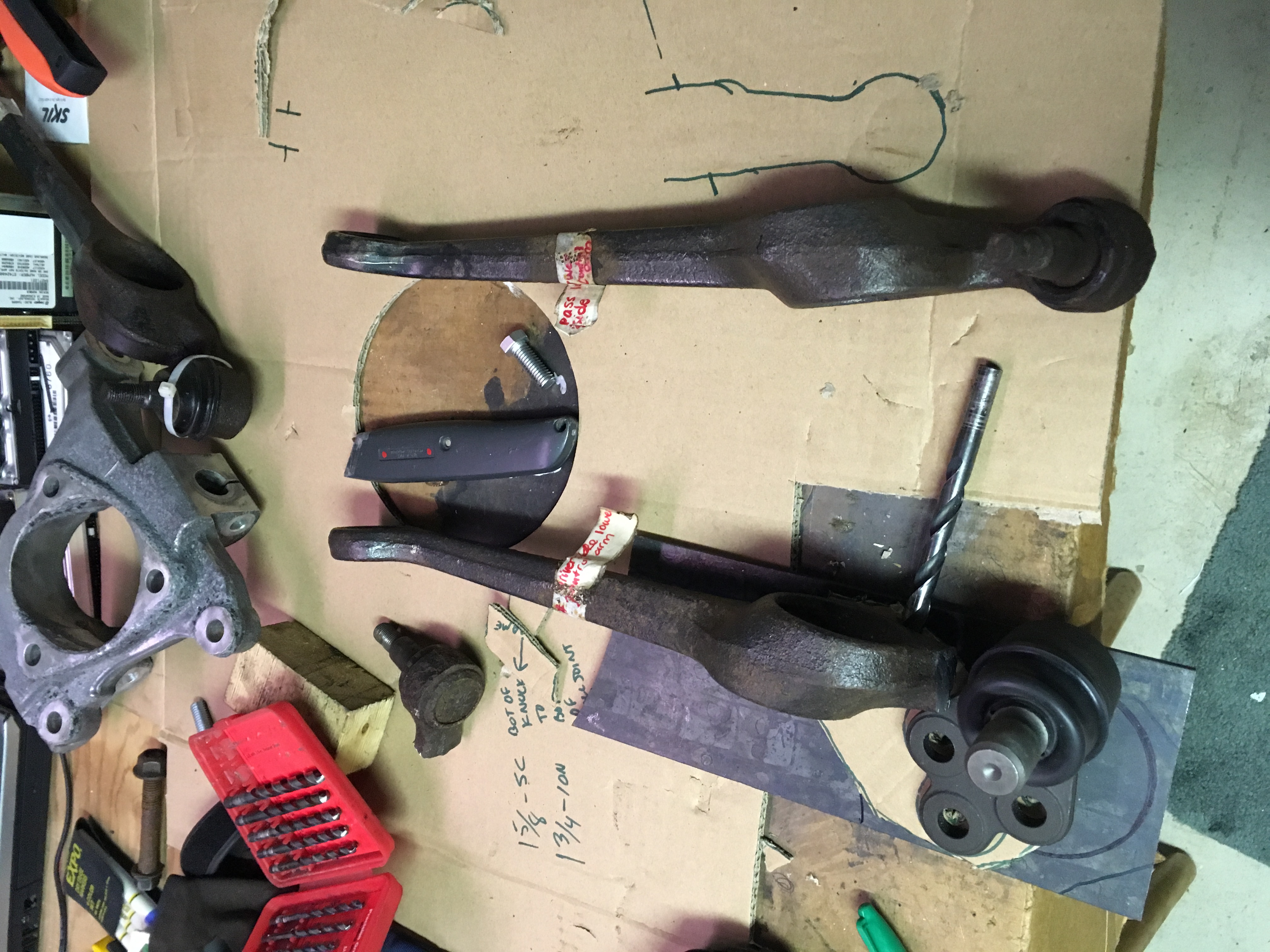

For 2017 we are going after three main things:
1) improve the front bearing durability
2) getting control of the ECU for better mileage and power
3) weight reduction

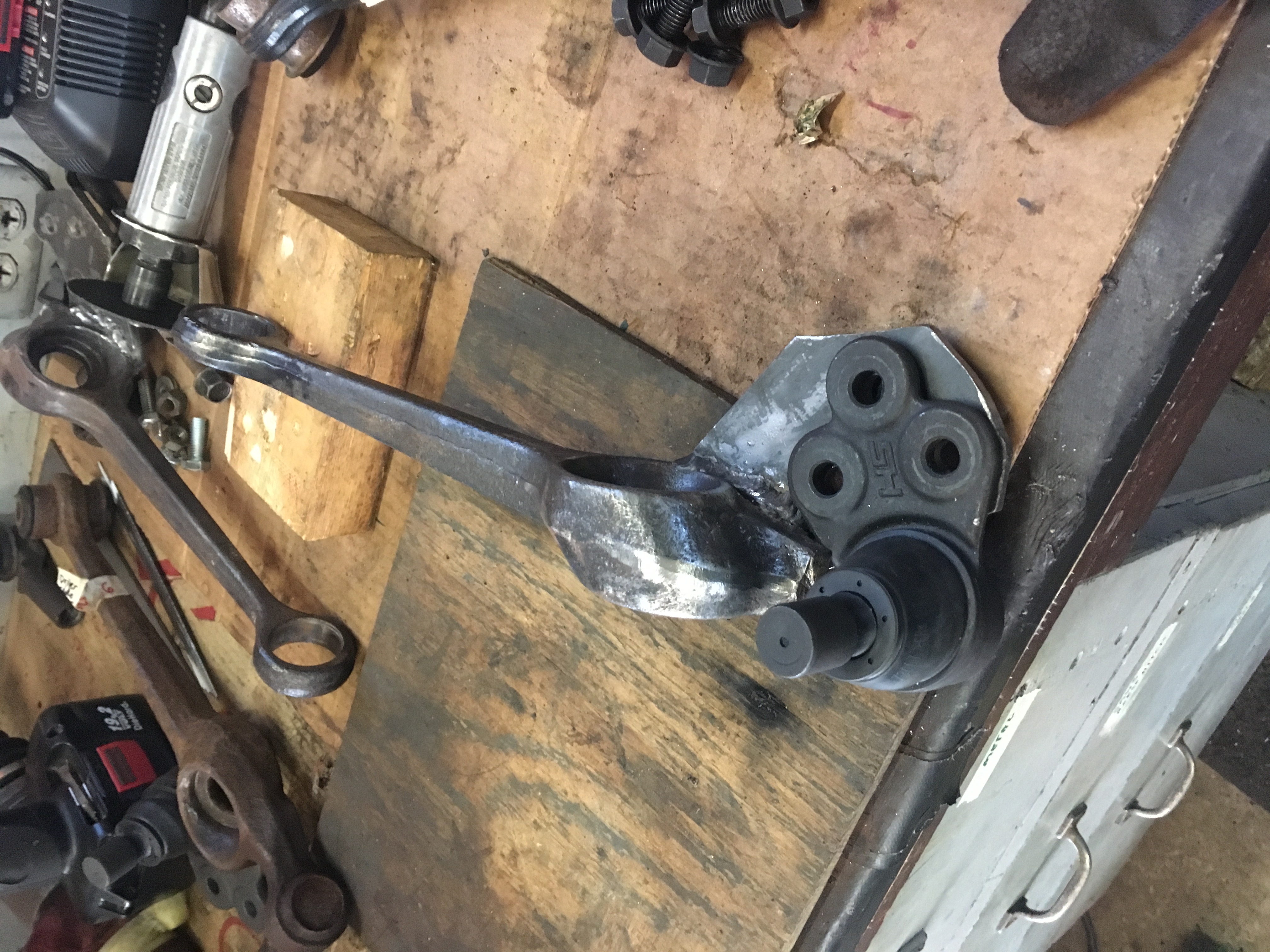

For #1 I have already scoped out Cavalier front knuckle and bearing it has a high probability of working

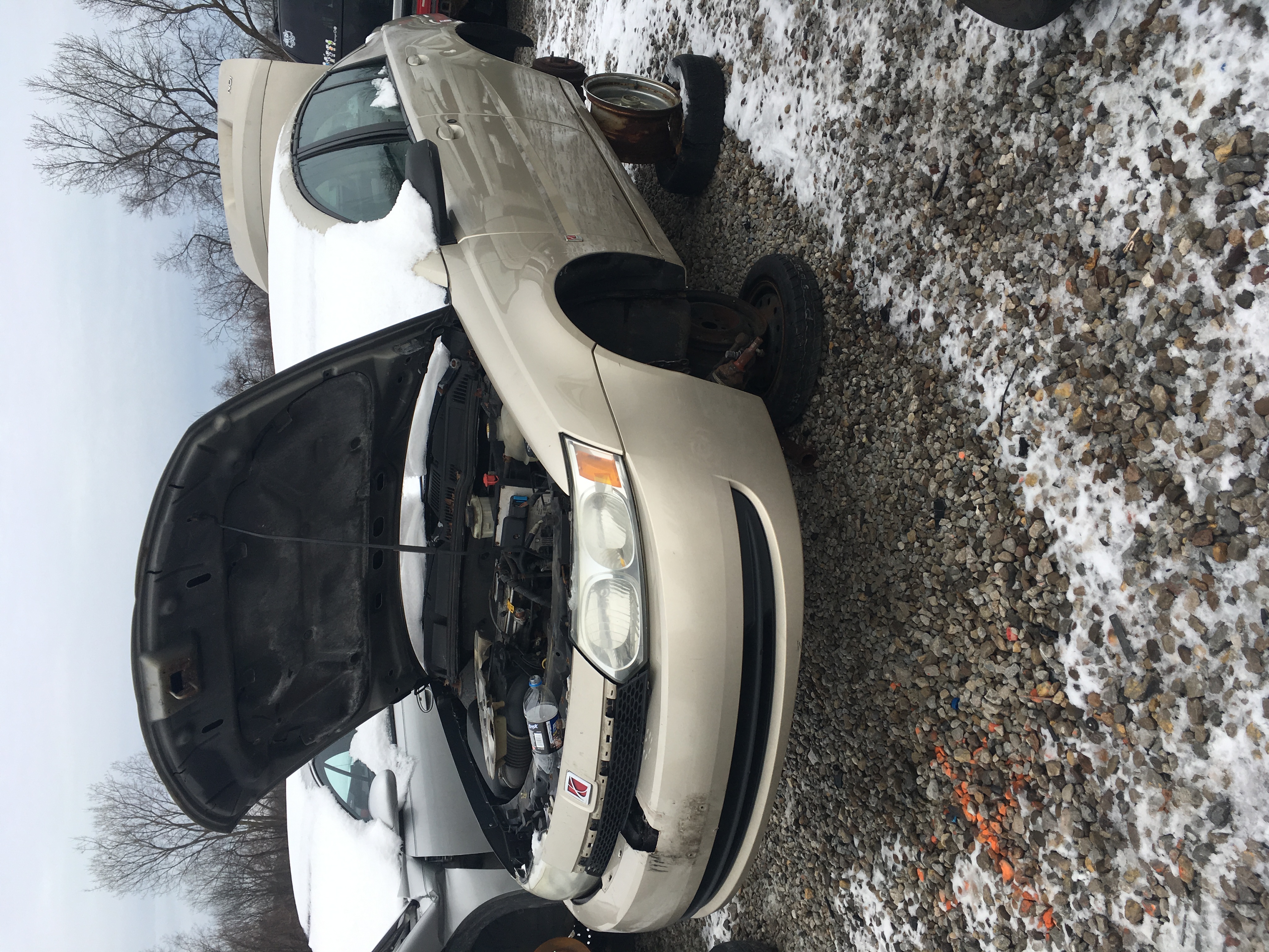

For #2 we have a mule car - its a 95 SC2 5 speed DOHC. Looks to be a running car - and for $350 its low risk. I gave it to Tiresmoker so he could play with running it on Megasquirt in the convenience of his own garage.
3) weight reduction

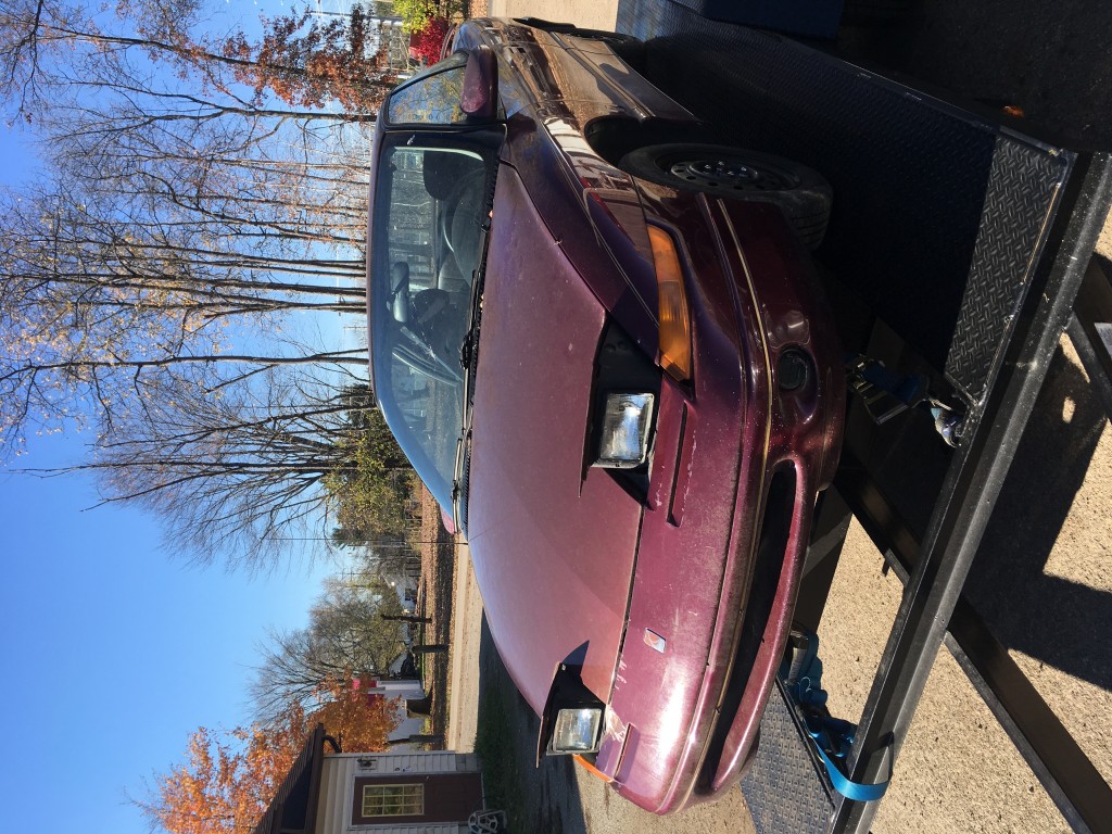

Re: cheap car racing
Update:
It's official the car is 25 years old and I now have historical plates on it.
My helmet was Snell SA2005 and 2016 was the last year I could run it. Merry Christmas/happy birthday I have a new helmet. The old helmet was a bit close to my nose and would fog up almost immediately when the visor was down. When racing this was not a problem but during refuel visor down is required. It took many attempts to find a helmet that fit and was not ridiculous expensive. What I have now fits decent around the crown but I need some wider jaw/cheek pads to stabilize it.
The mule car has been starting and moving on a regular basis, the wiring harness connector showed up but this is not at the front of the line of projects at Tiresmoke Central so not planning to use it for Watkins Glen.
Our second race for 2017 is planned for a 24 hour event at VIR in August, and for that we need a hub that can last 24 hours. As I mentioned before this is #1 on the list of upgrades for 2017.

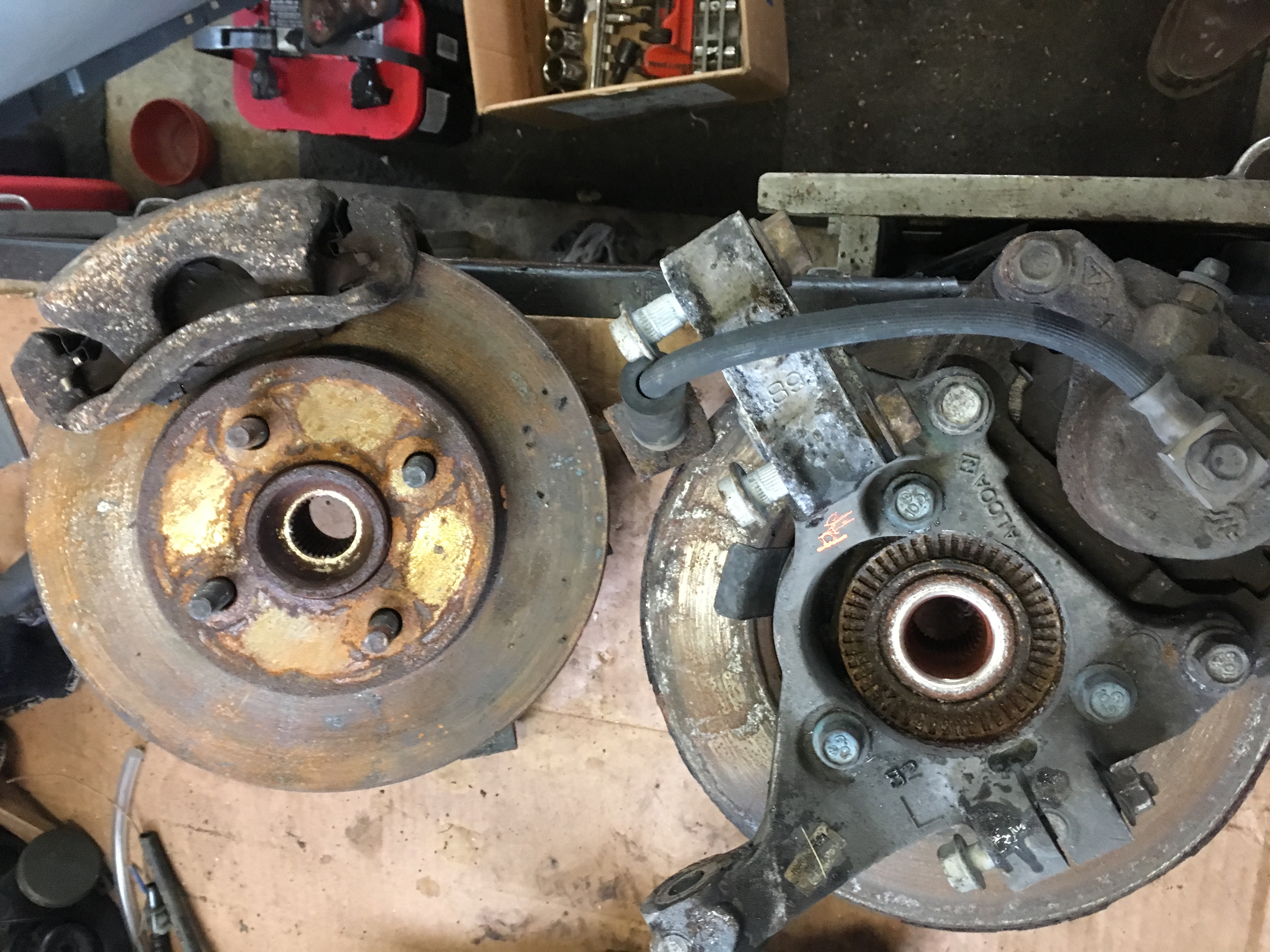

It turns out the Cavalier bearing is basically the same size as the SC and the one Cavalier team I know said they are not very reliable. Unfortunately I already had the parts from pull a part but they were within 30 days so I took them back.
With some digging (and copying another Saturn team!) I had also learned you can run Ion/Cobalt knuckle, bearing, hub, rotor, caliper assembly on the SC. What does not change is the halfshaft and the bolt pattern. The SC strut can be adapted to fit the Ion knuckle with a little fabrication. The tie rod end will fit right into the knuckle it just needs to be inserted from above rather than below. The biggest challenge is the Ion uses a lower ball joint with a shank and a retaining bolt rather than the typical tapered press fit lower ball joint like the SC. I researched this exhaustively as I wanted to put the shank ball joint into the SC lower control arm but in the end I could not find the right part to fit that specialized application. Instead I cut the lower control arm and fabricated a plate to weld to it so the Ion lower ball joint will bolt on. It took me a while to be convinced I could weld this part, as I was thinking cast parts are cast iron, however after way too much investigating/deliberating I decided they were cast steel (did you know you can do a spark test with a grinder on metal to determine what kind of iron it is?).
Donor car Parts fresh off the donor Halfway through the conversion Lots of welding semi-finished product That project is not yet finished - I took the front end apart tonight. Still some fabricating to do.
Chump Car got a new primary sponsor RVA Graphics and Wraps and we have to rebadge the car - so I had them ship me the decals to do this at my leisure in the garage and not on race weekend:

Today I got to putting the parts on the car. Installed the lower control arm, halfshaft, knuckle, strut. Looking at the alignment I can see the strut to lower control arm alignment is wrong. The halfshaft boot is solidly rubbing the lower control arm at bull extension. I tried adding 1/4" of washers to raise up the ball joint but it still hits. Stepping back I can see a couple things
1) The other team put the ball joint at a point where the lower control arm is at least 1/2" longer than mine.
2) I did align the ball joints OK but the geometry of the knuckle puts the hub lower in the Ion knuckle.
I have some work to do in order to resolve. I have some options to salvage what has been done with rework, or there is going to be quite a bit of rework.
