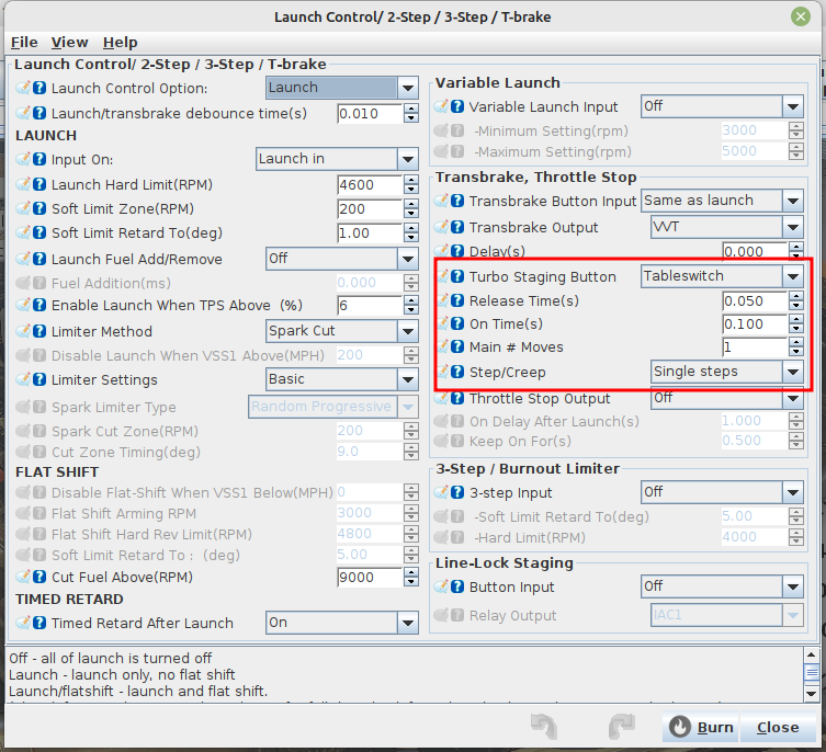

At the Lake Effect Showdown, it became obvious that I needed a staging/bump button when running on a Pro Tree. I can't build boost quick enough. The good news is that Megasquirt natively supports transbrakes and a staging button (bump button). It was a little more work than I thought at first, as I ended up redoing some work from when I first built the car. But in the end, I added a new solid-state relay to control the transbrake, and a physical staging button. It works as expected in driveway testing.
I'm going to pull the headers soon to re-wrap them and replace the gaskets, and at that point I'll safety wire them.

I took Maliboost out to Thompson on Saturday. I got to try the bump button for real. The good news is that it helped my launch/60ft a LOT. A full tenth, 1.5x to 1.42. The bad news is I have to figure out a new staging routine. I only got 1 time run, which went fine.. in fact, I went 9.72 @ 138 with a 1.4 60 foot! I was super pumped with that!!
On my first elimination run, I lit the first bulb, but I hit the bump before it was at full RPM/boost. When it bumped, it flickered the 2nd bulb, but not quite enough. I had to bump a second time. While I wasnt truly deep staged, I think I was deeper than I would be if I had footbraked into it. So I lit the red-light. I did the re-buy and red-lit again. .12 and .10 red, so not even real close. I just need to come up with a new staging routine, or maybe figure out how to adjust the bump settings to get a slightly longer bump. I went for a last time run and went 9.71, It's a rocket ship!
