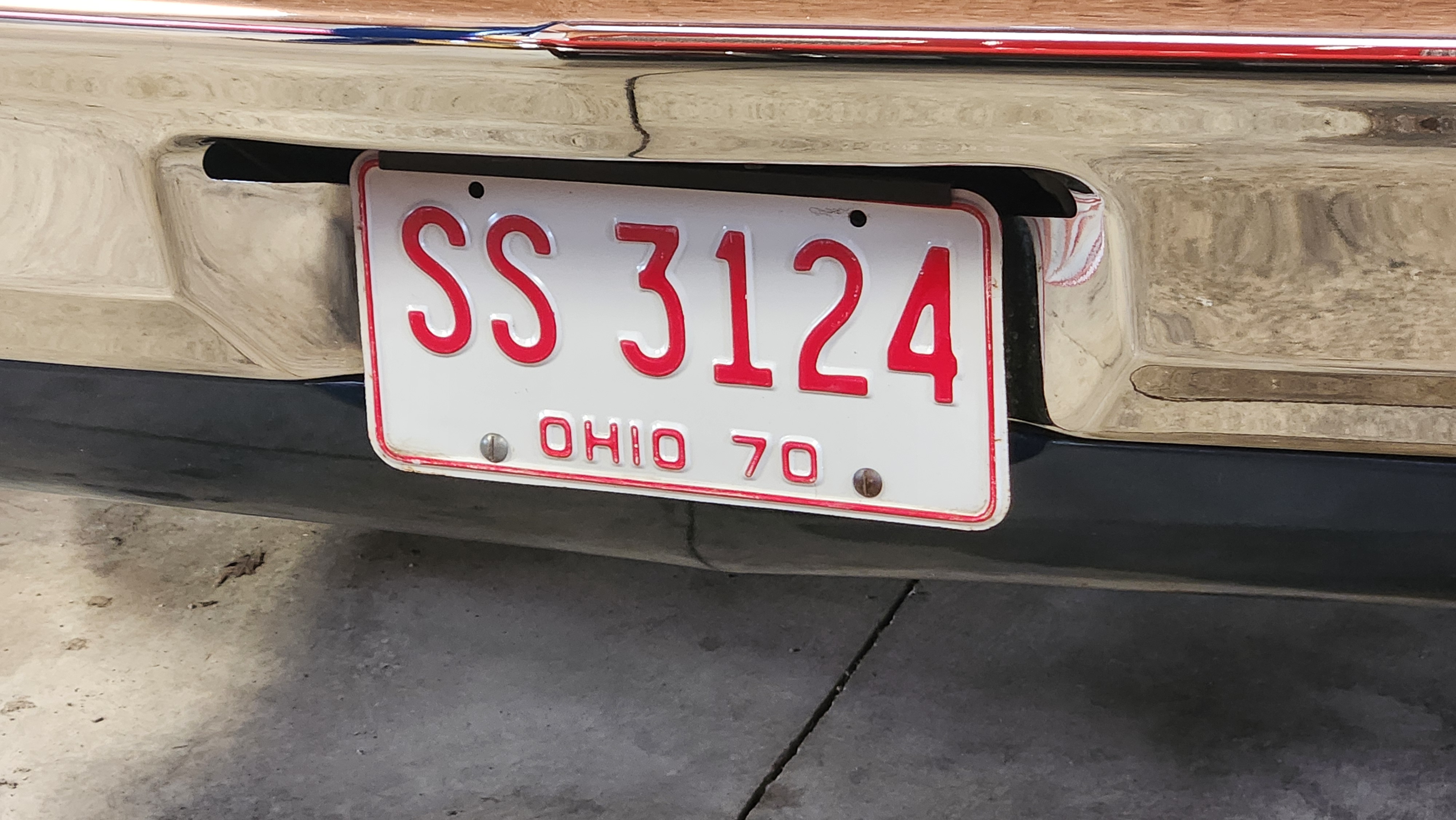

First, my friend Jim Radel found these awesome 1970 model year plates, and they start with SS. I got rid of my DS1970 personalized historic, got a regular historic, and then added the model year plate. Tony has the same setup on his Chevelle. I love how they look. Red lettering, white plate, blue car.. 'murica!

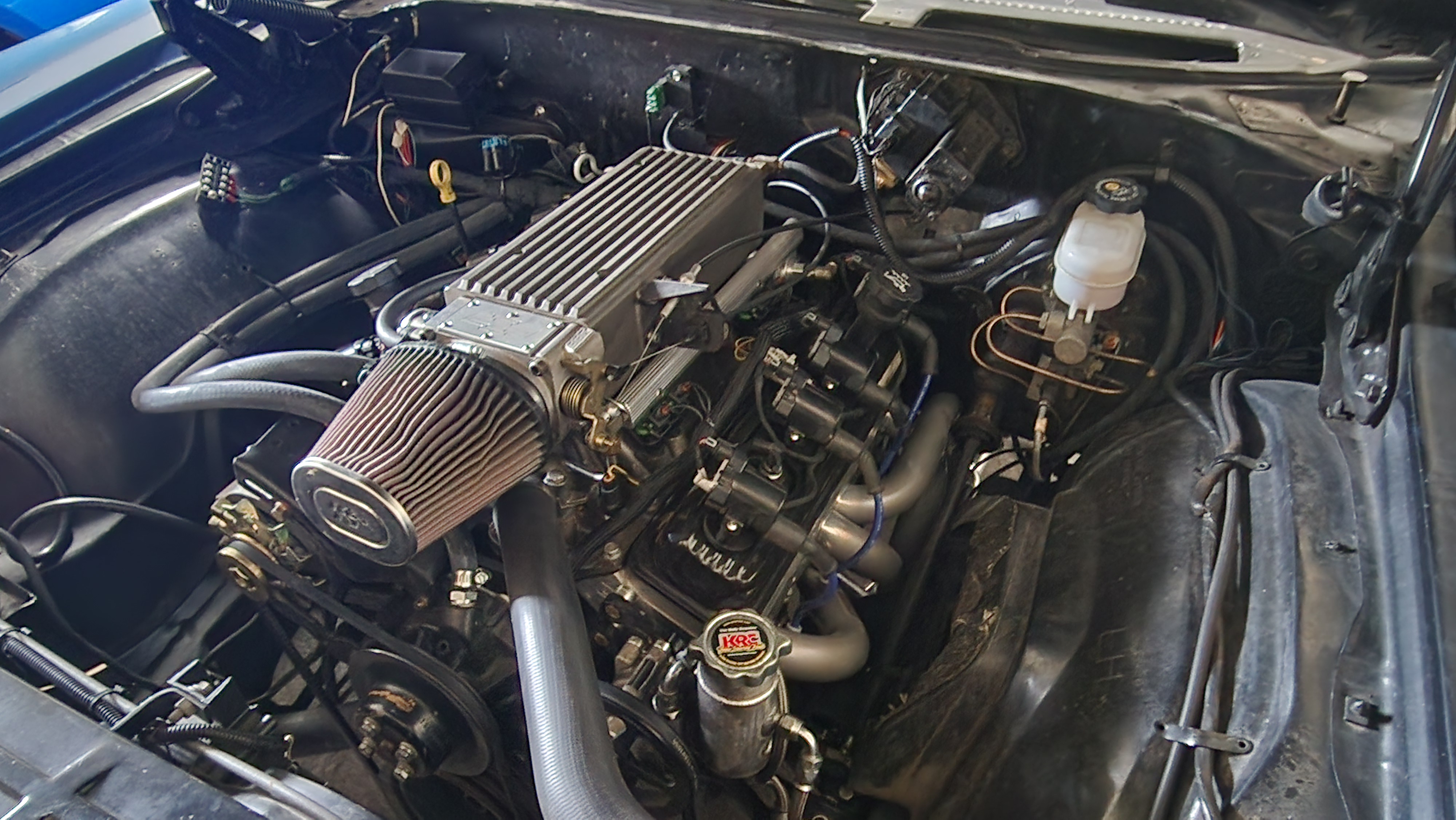

When I ran Buckeye Sklps in the fall of 2025, the car was mis-firing on my dragstrip pass. Not awful, but clearly... amiss. Come spring of this year, it started stumbling when I'd pull away from a light, or go around a corner. It seemed very fueling related, honestly. But it would run just fine most of other times. I tried making a couple fueling changes, and it had no effect on the stumbling.
I had a full set of AC Delco coils on the shelf for drag week spares. I installed them on the car and everything was instantly resolved and the car just seemed to run better than ever. I made some adjustments to make the closed-loop idle work better. It's really about the best the car has ever driven, and its very satisfying to drive.
