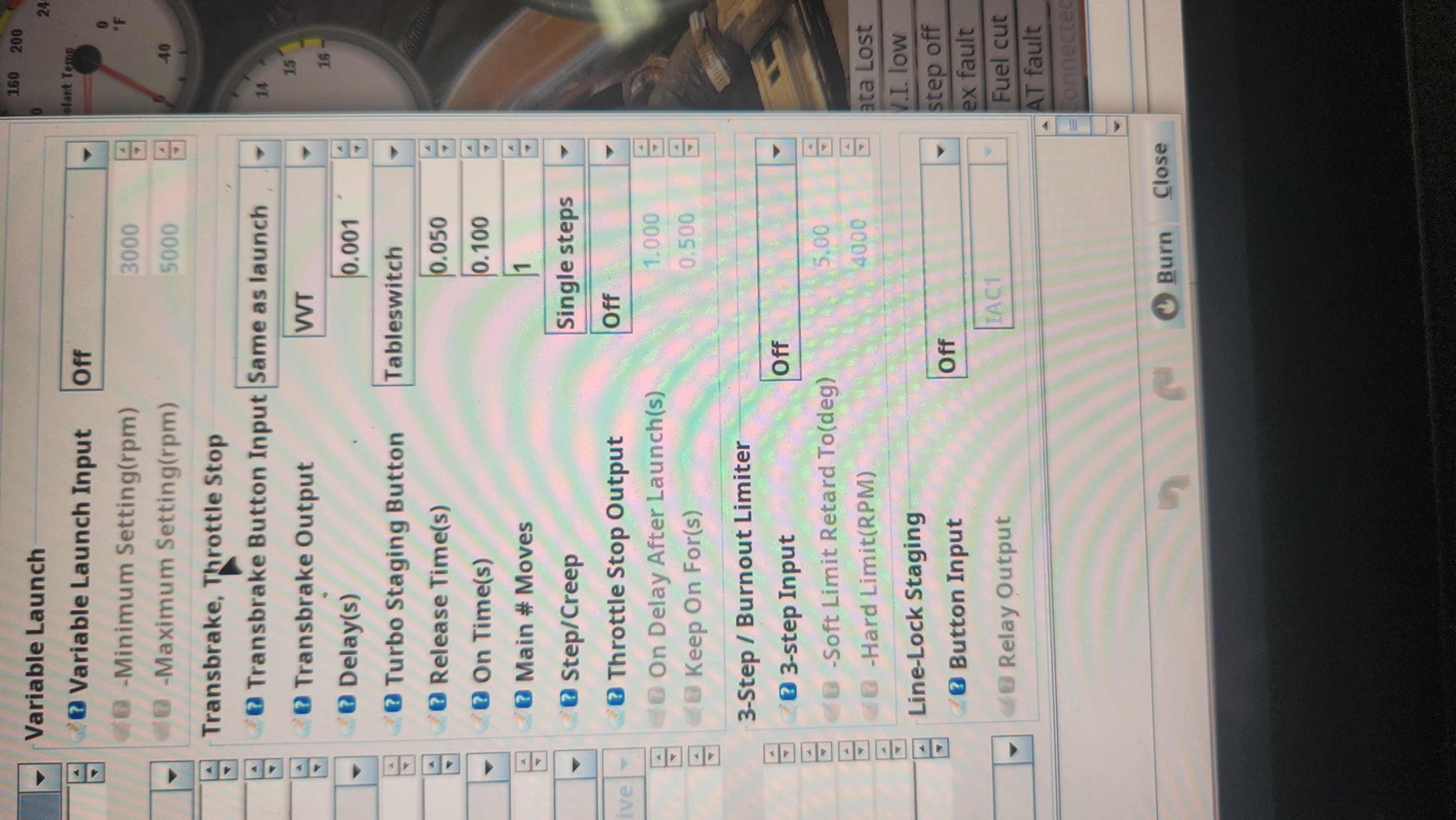

First pass, I run a 10.18 @ 133. Next pass 10.25 @ 133.. wtf? Why so much slower than Wednesday, with better air? Checked the datalog, and I was only getting 7-8 psi, not my expected 10-11. Further, it showed it wasn't even commanding the boost controller (0% duty cycle) until 3/4 of the way through my run. It should be 40% the whole way. I had played with one setting called "Launch Boost Duty %", which I thought was how much boost duty cycle it should command when the transbrake button is in. It had been 0. I changed it 30, thinking it might spool the turbo faster when I'm staging. For some reason, when set to 30, it totally delayed my boost coming in. I set it back to 0 and went 9.95 @ 135. I followed it up with a 10.00. Head scatcher. I posted a question in the megasquirt forums about it. I feel like its a bug. https://www.msextra.com/forums/viewtopic.php?p=615221

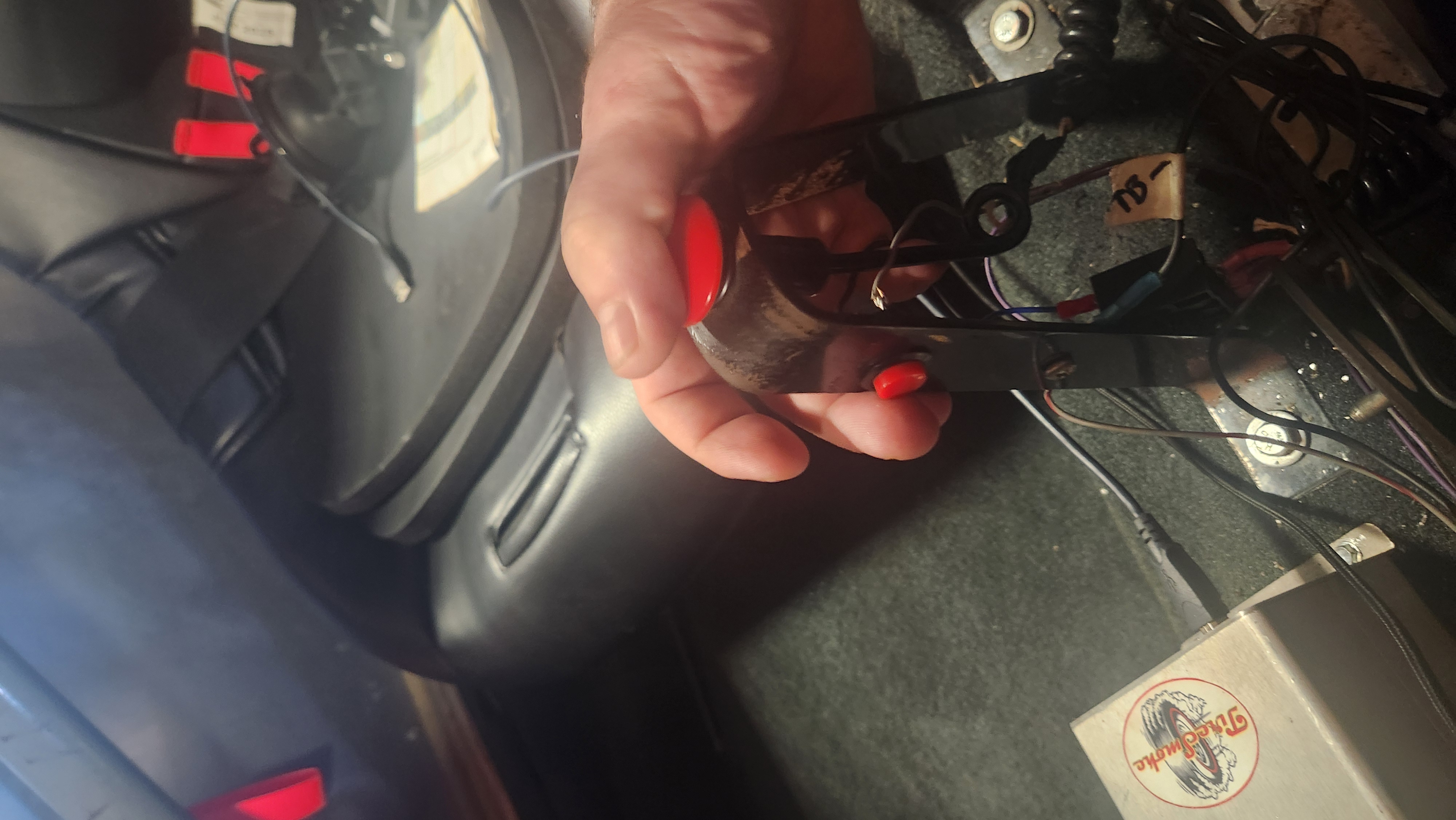

So after the race on May 30th, I had to fix my seat adjuster. The adjuster bar just fits/stays in by the springiness of the steel pressing outward to stay engage on a couple pins. After 2 seasons of me using my foot on the adjuster, it tweaked enough to fall out. The fix ended up being pretty simple. I got a thread coupler and two pieces of threaded rod and used them to hold outward pressure.

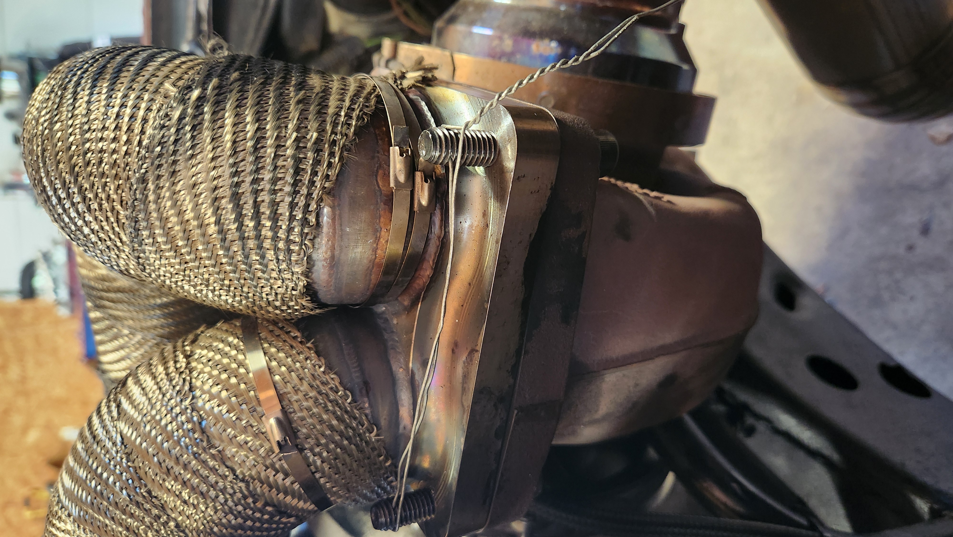

After the Lake Effect Showdown, I had the familiar tick-tick-tick of an exhaust leak and found another bolt missing and two that were very backed out. I decided I've had enough decided to take action. I had already ordered some 1/16" drill bits from amazon and went to work.
I'm going to pull the headers soon to re-wrap them and replace the gaskets, and at that point I'll safety wire them.
At the Lake Effect Showdown, it became obvious that I needed a staging/bump button when running on a Pro Tree. I can't build boost quick enough. The good news is that Megasquirt natively supports transbrakes and a staging button (bump button). It was a little more work than I thought at first, as I ended up redoing some work from when I first built the car. But in the end, I added a new solid-state relay to control the transbrake, and a physical staging button. It works as expected in driveway testing.
