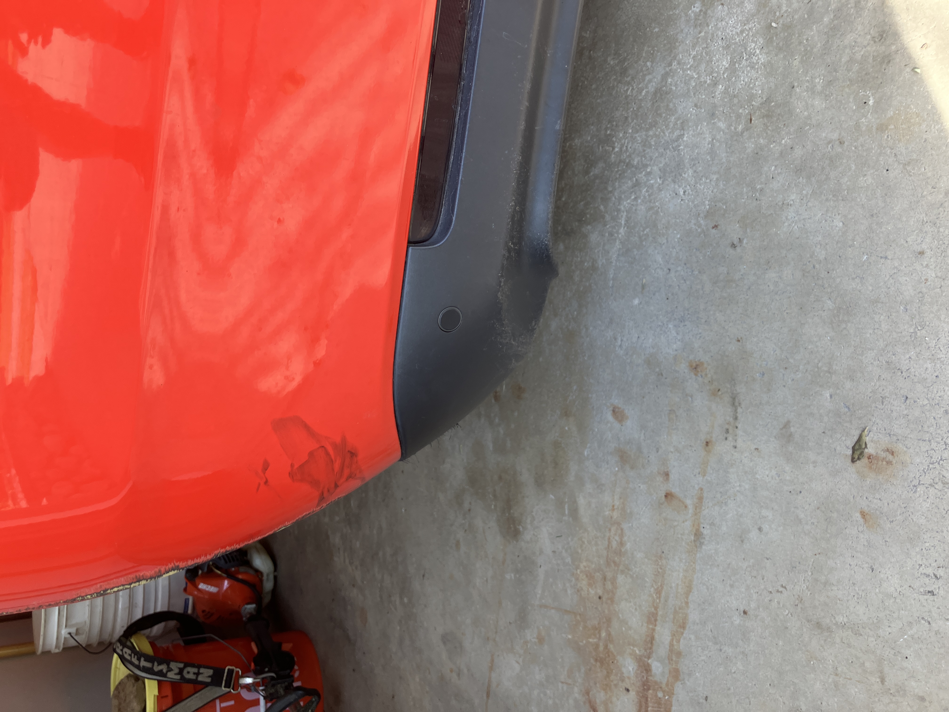

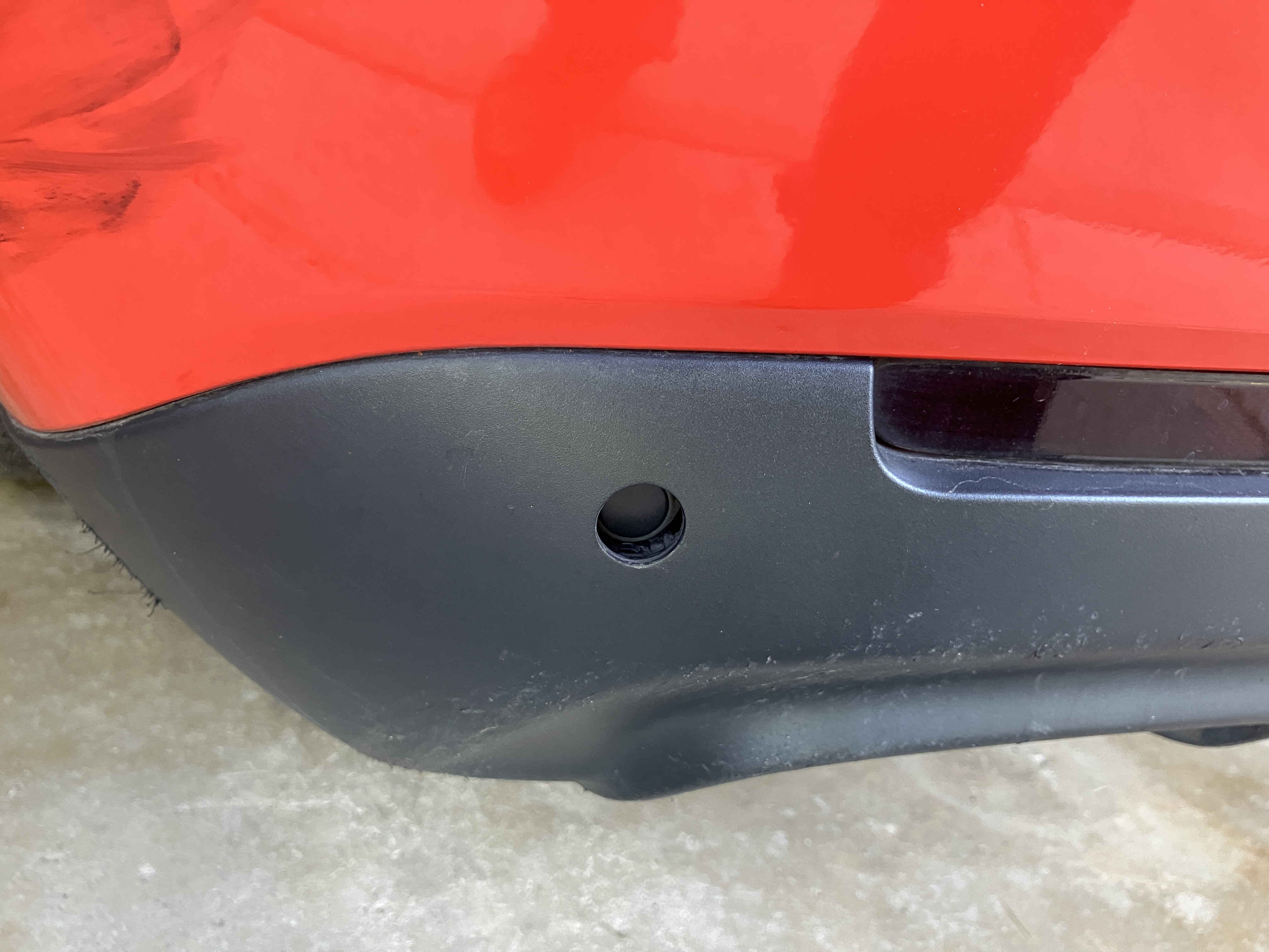

The other day I washed the car and shortly after it started complaining one of the backup sensors was dirty. Turns out it actually popped free of its mooring and slipped inward.
I had to loosen the black trim from the bumper cover to get inside and snap it back into place. Pretty sure I never removed those from the trim so this might be a leftover from the accident.
