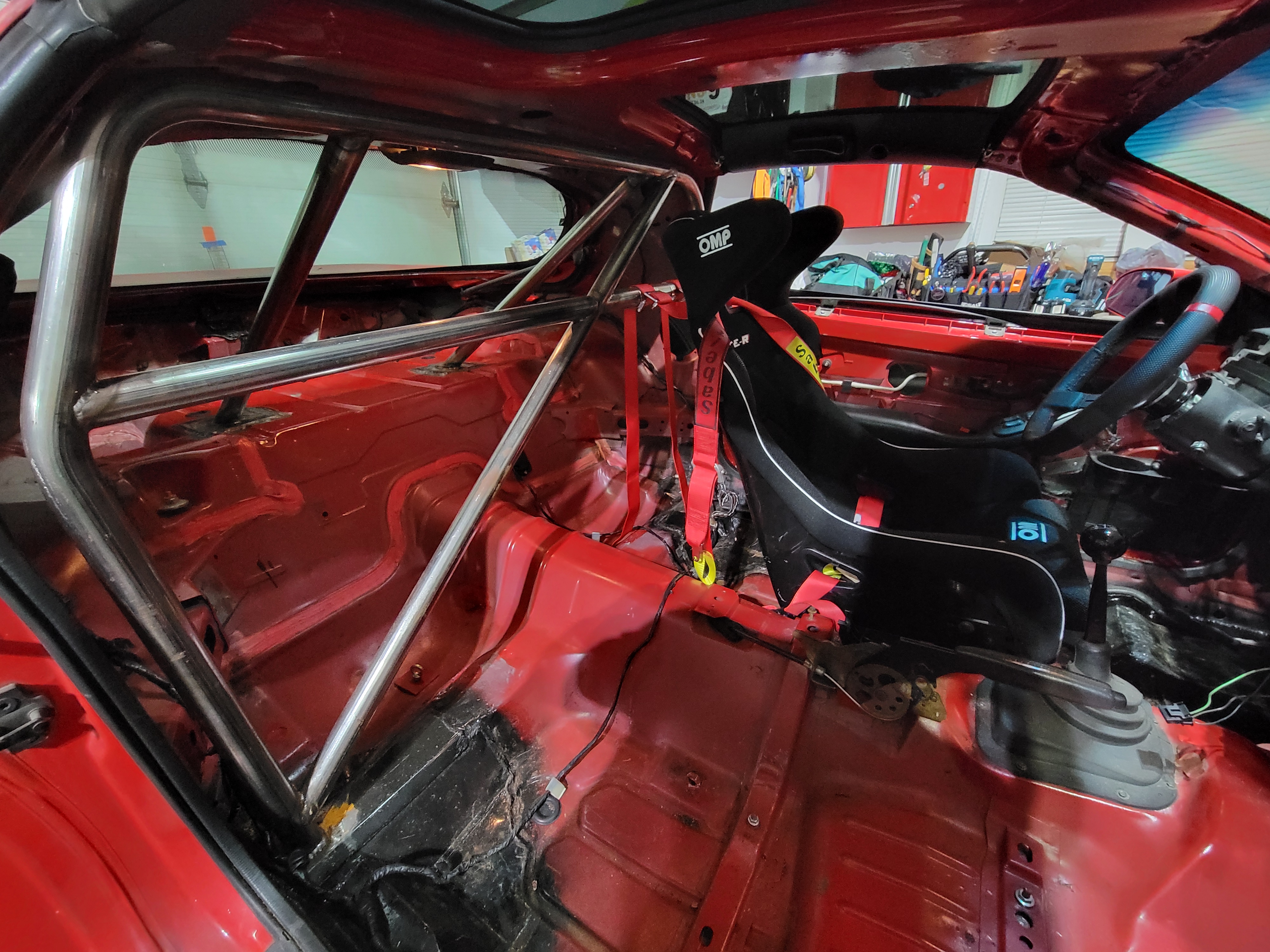

I wound up with TrackBird a couple years ago. She's still tracking in northeast ohio. Added a roll bar, full containment seat, and removable steering wheel. Minor upgrades, new bearings, longer studs, 18" wheel, steering rack & pump (still dealing with overflow issues, looking to move cooler).

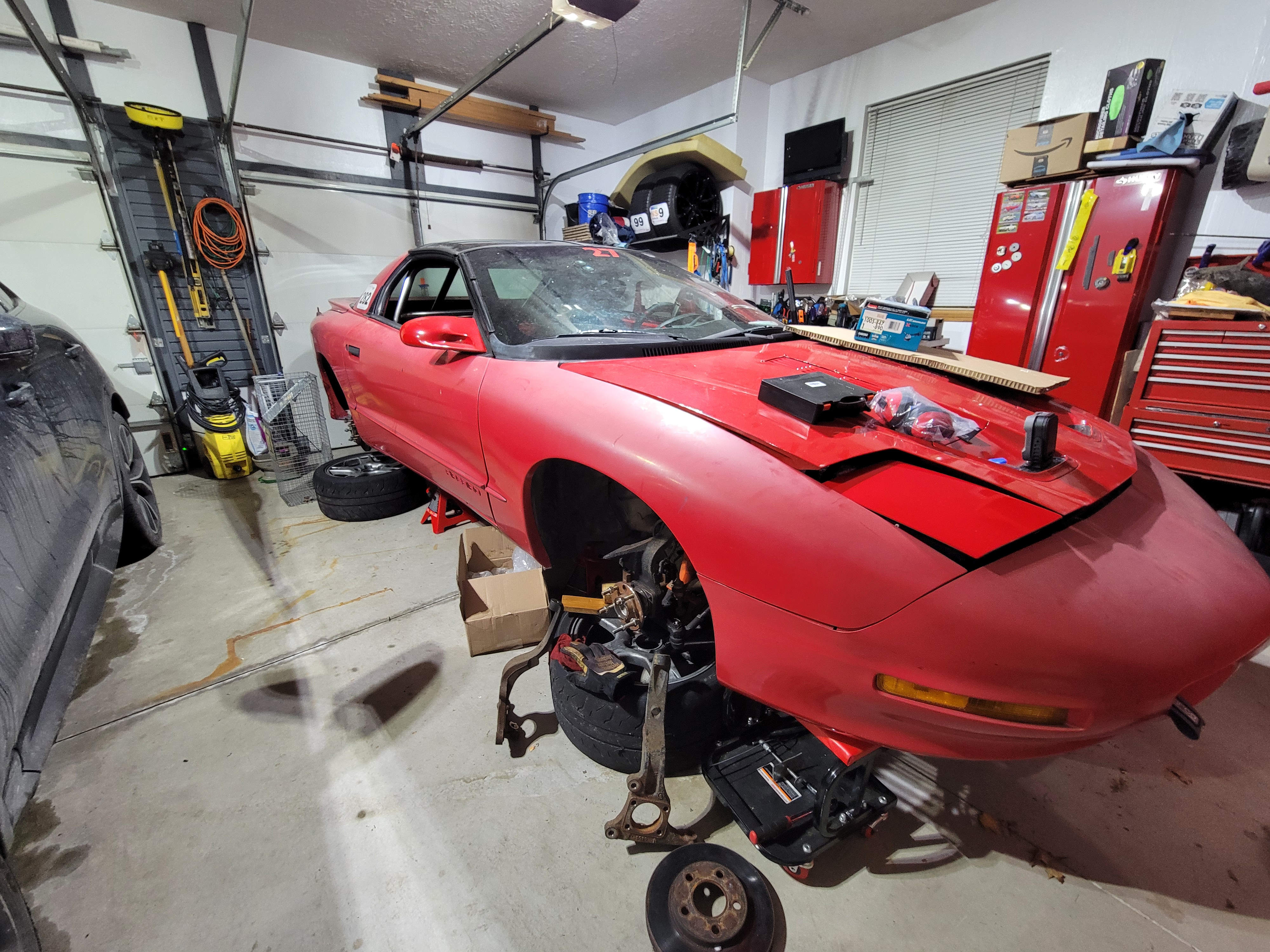

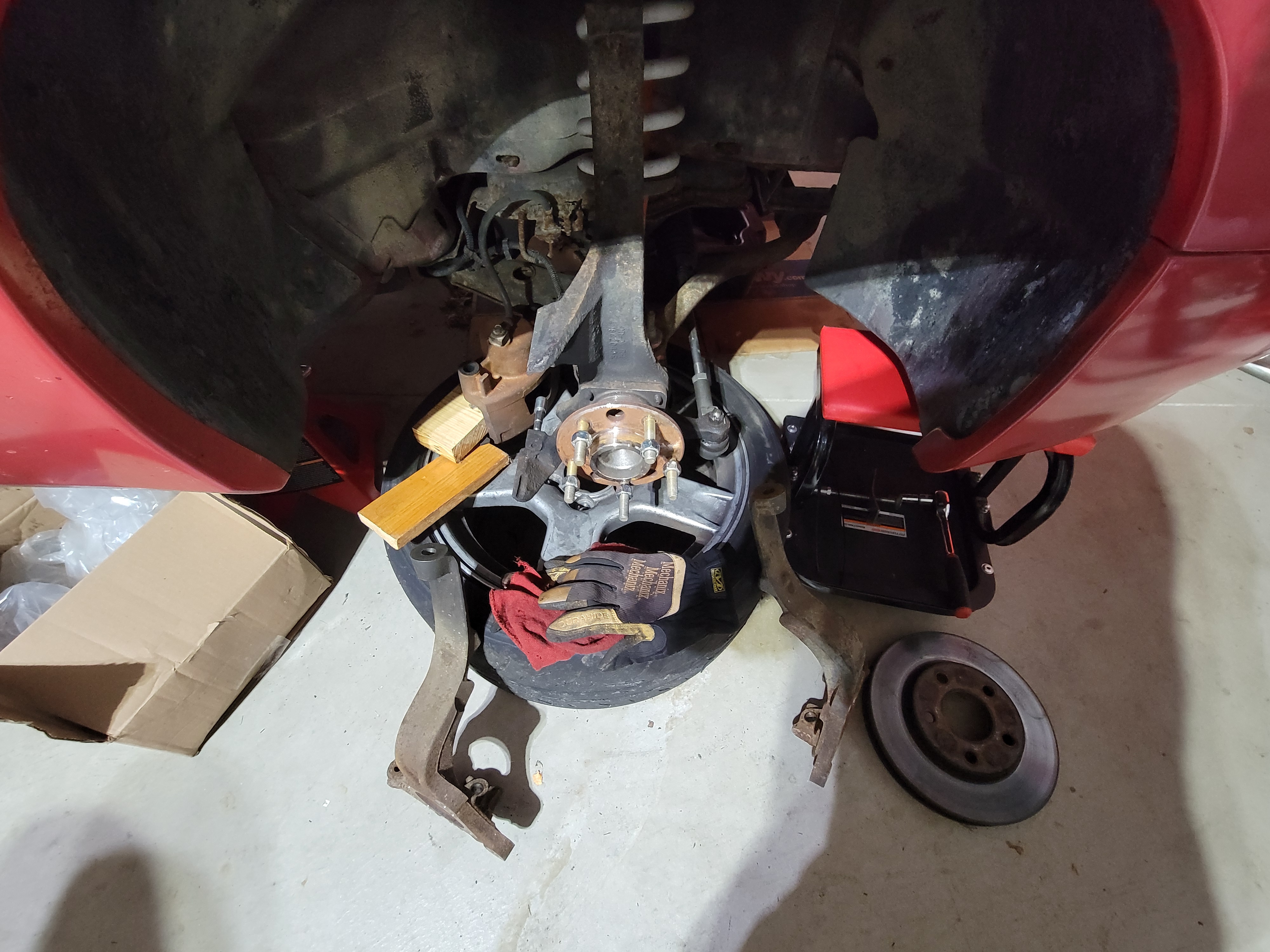

Working on upgrading the front to LS spindles to add 4 piston brakes. Going back and forth on adding some UMI control arms. Maybe add a oil cooler.
