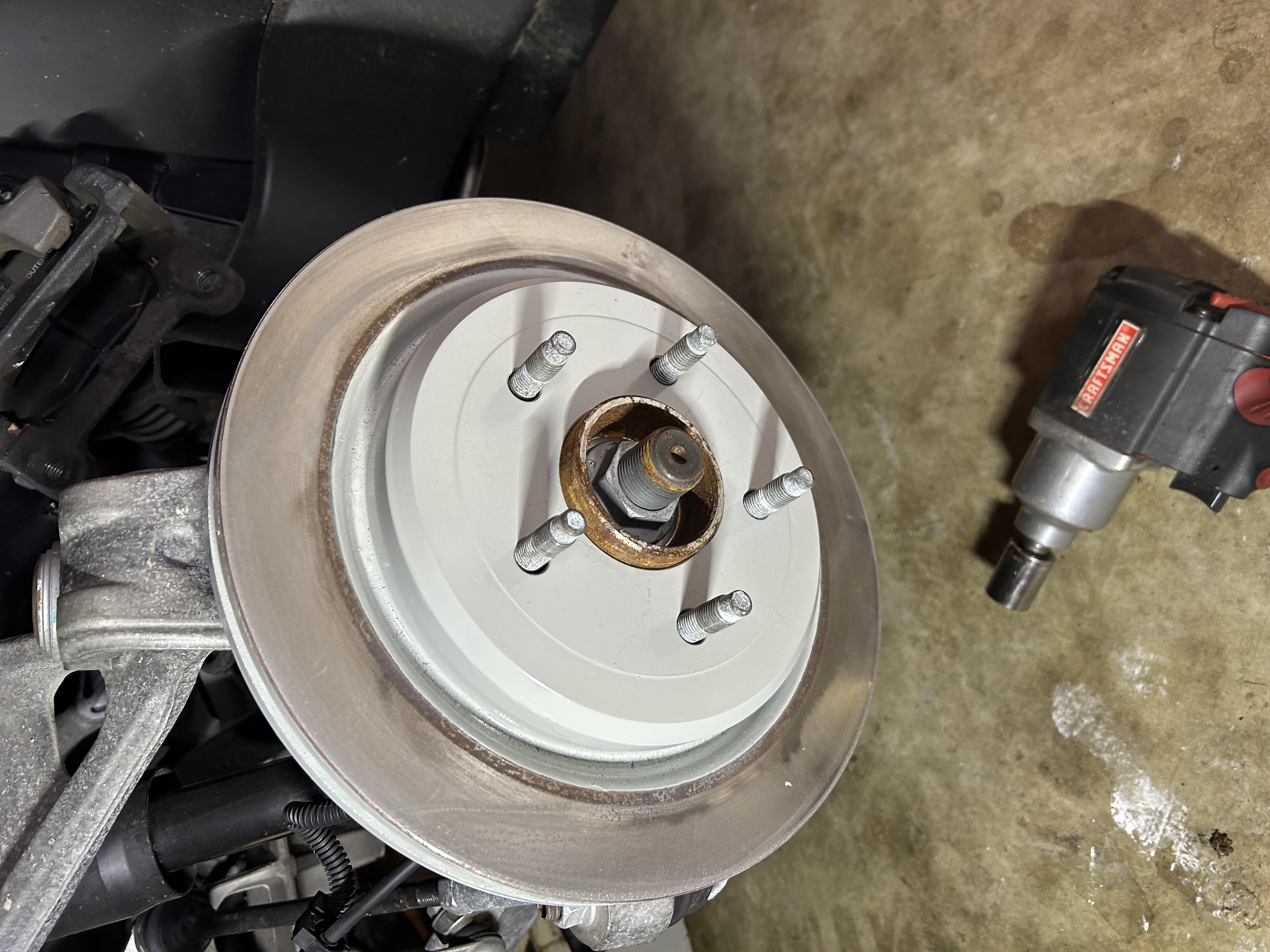

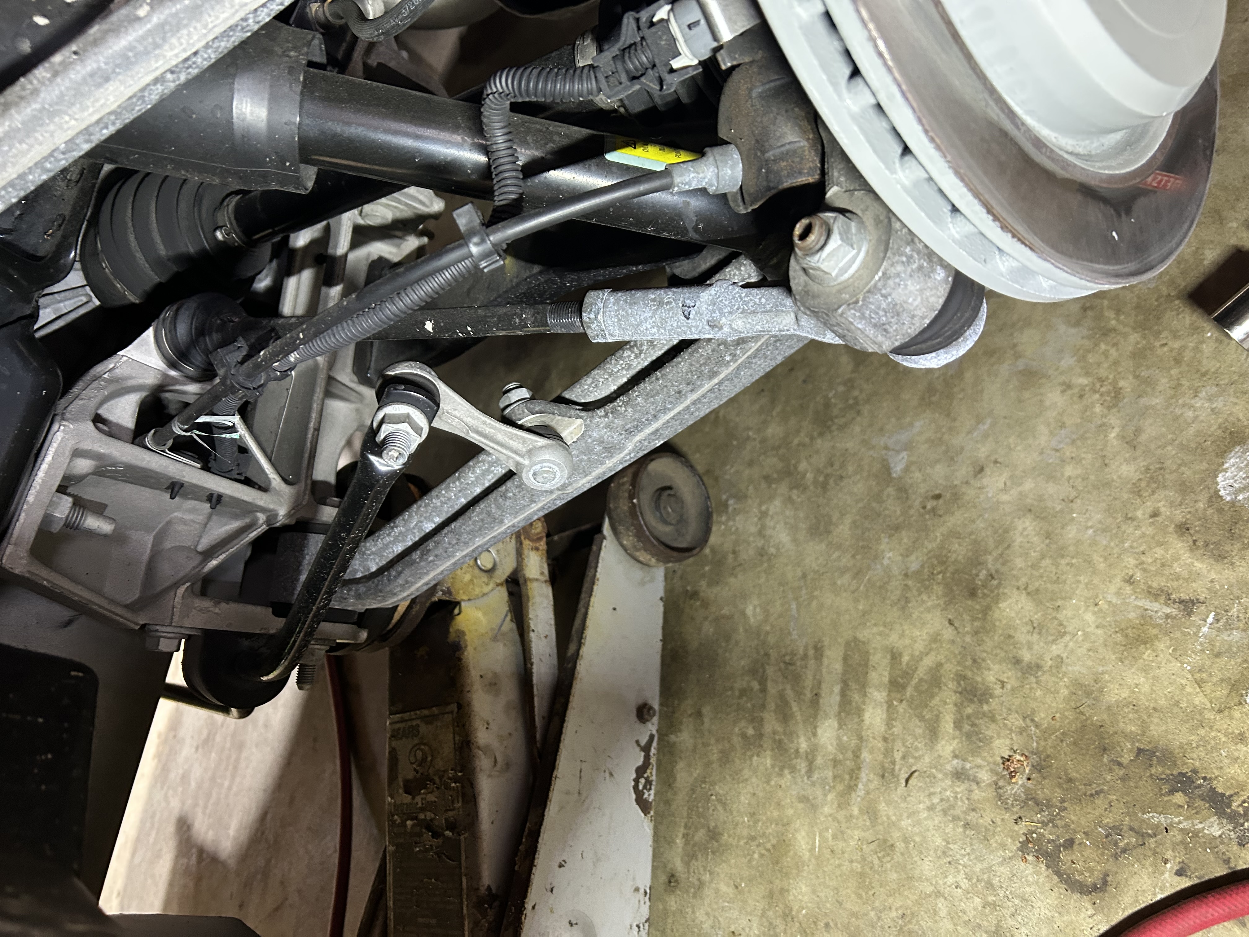

Rotor Paint Job

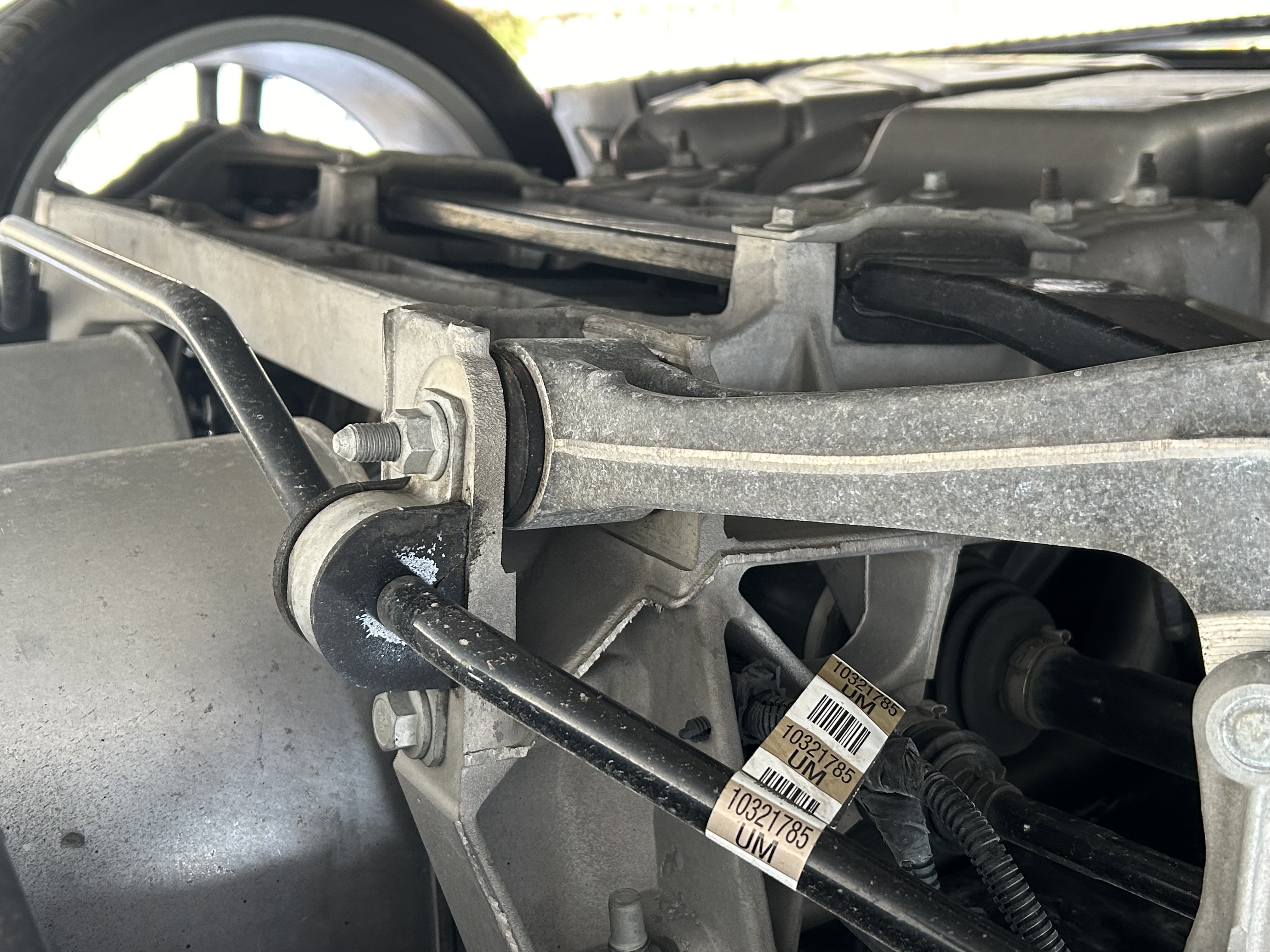

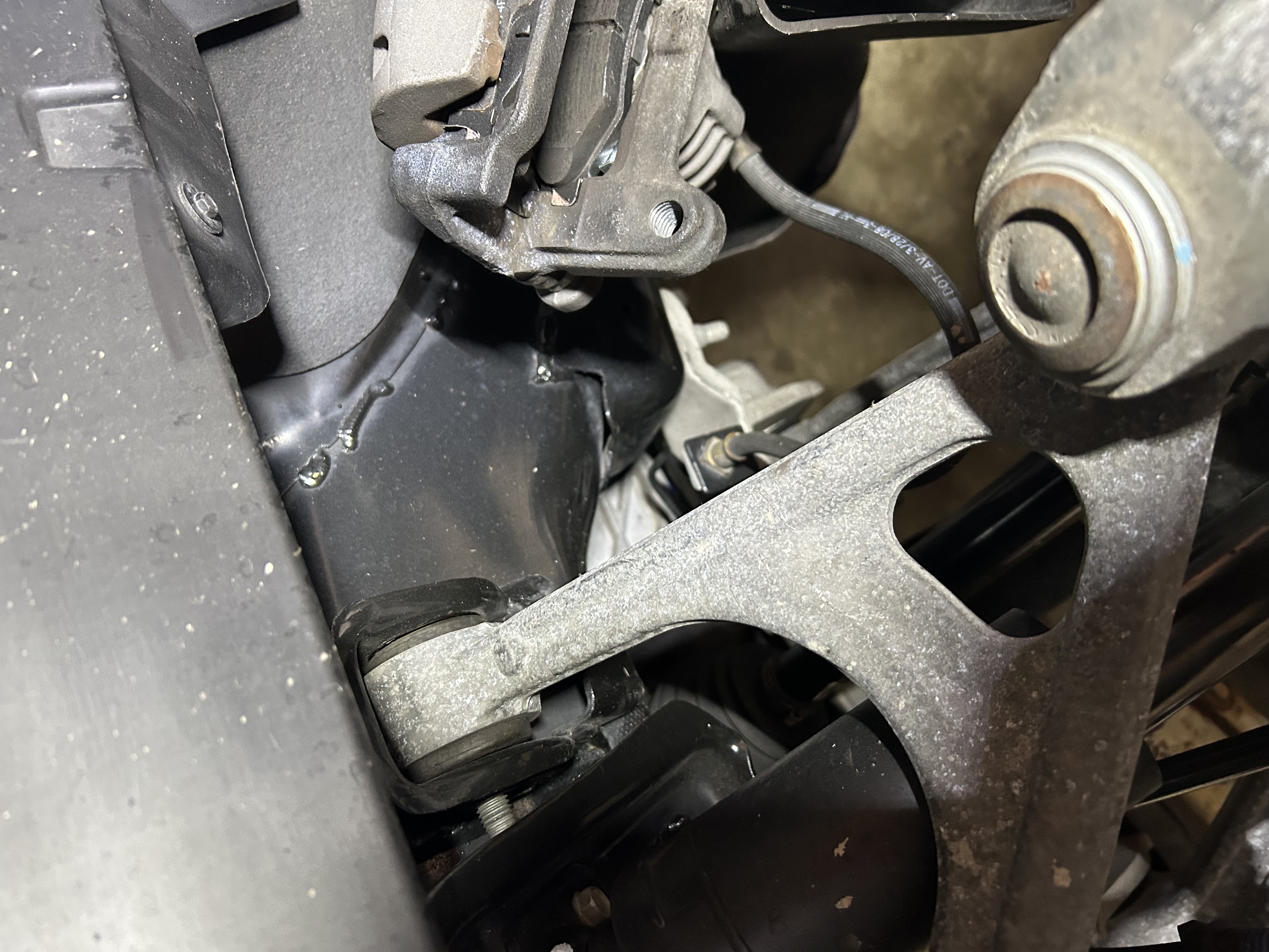

38,040 ….. I did this project about a week ago but have been a bit lazy about posting it. It really wasn’t a hard project, but one that needed to be done. Before I got the car, the dealer had new brakes and tires installed on it. They used uncoated rear rotors, so they were all rusty. I painted them to give it a cleaner look. The good news is that the brake disassembly was pretty easy with no special tools required. The whole project took a couple of hours. I let the paint dry over a full day so the wheels won’t get bonded to the rotors by the paint. The color match wasn’t 100%, but because the fronts and rears are so far apart, you can’t tell….. and a bit of brake dust will help the cause out as well. I have driven it between the raindrops, but weather is getting better, so that will change. This is a super comfortable and enjoyable car to drive! Also to note is how CLEAN this car is… the first couple of pics show the frame and suspension components…. There’s minimal dirt under this car… the frame still shines like new!

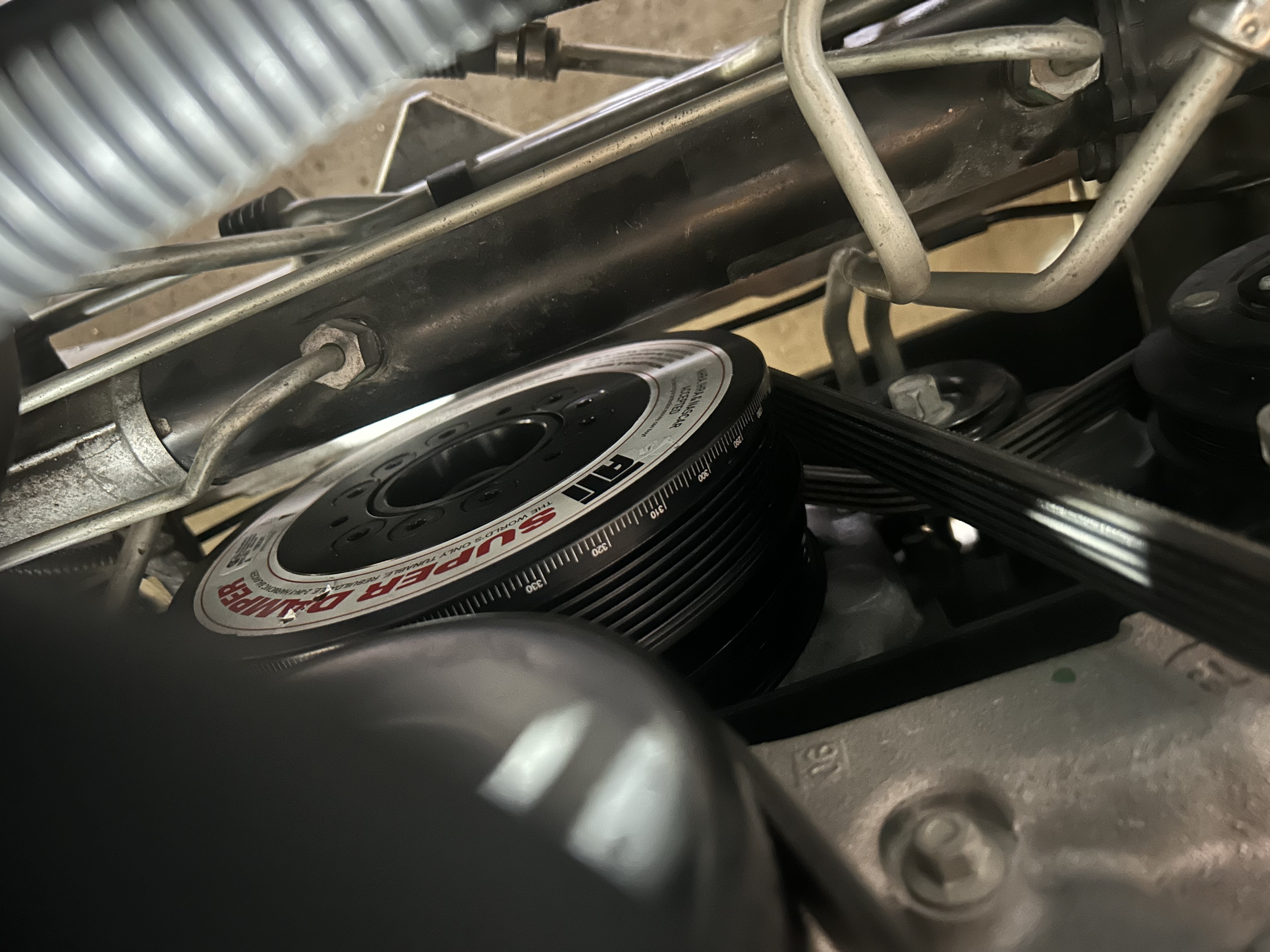

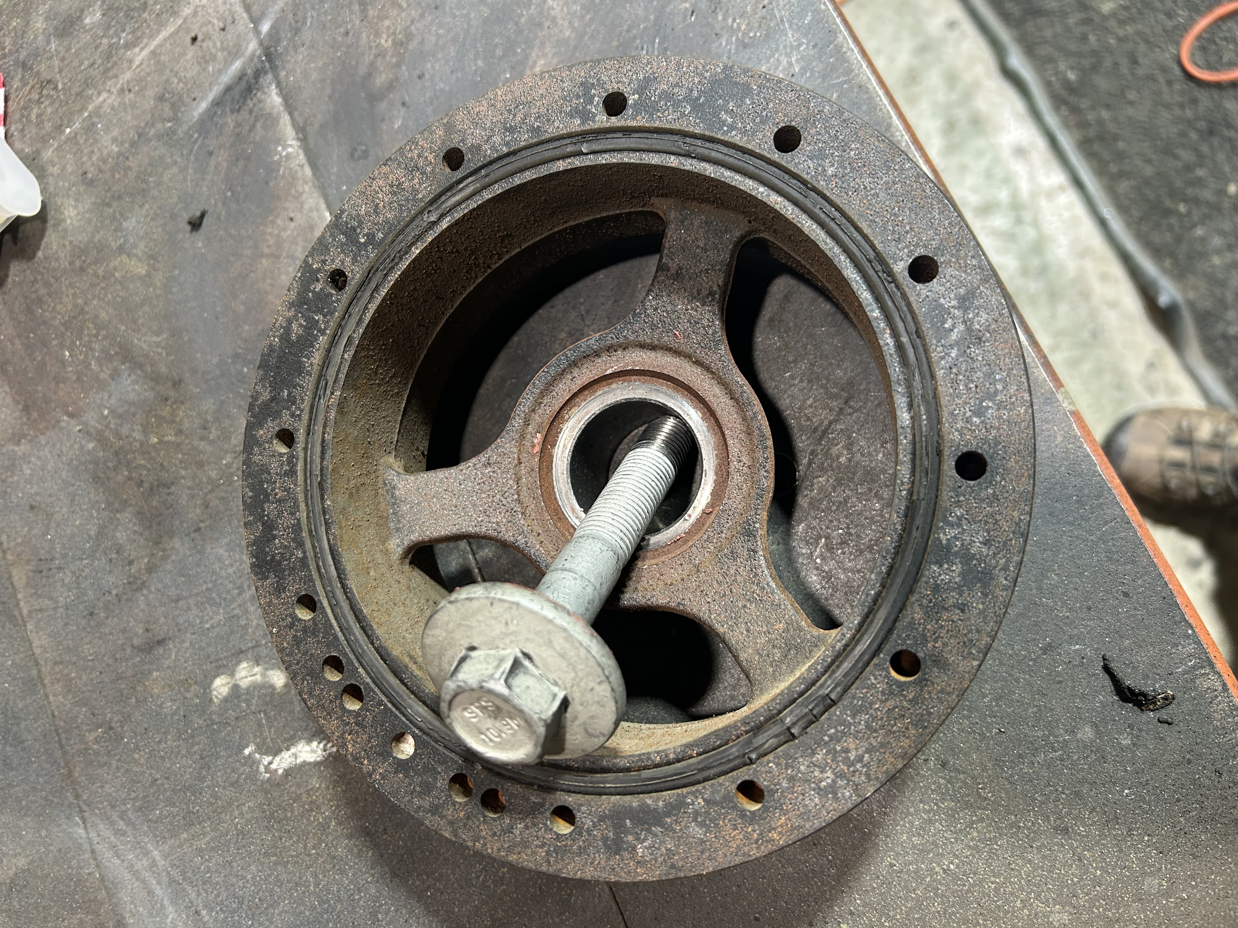

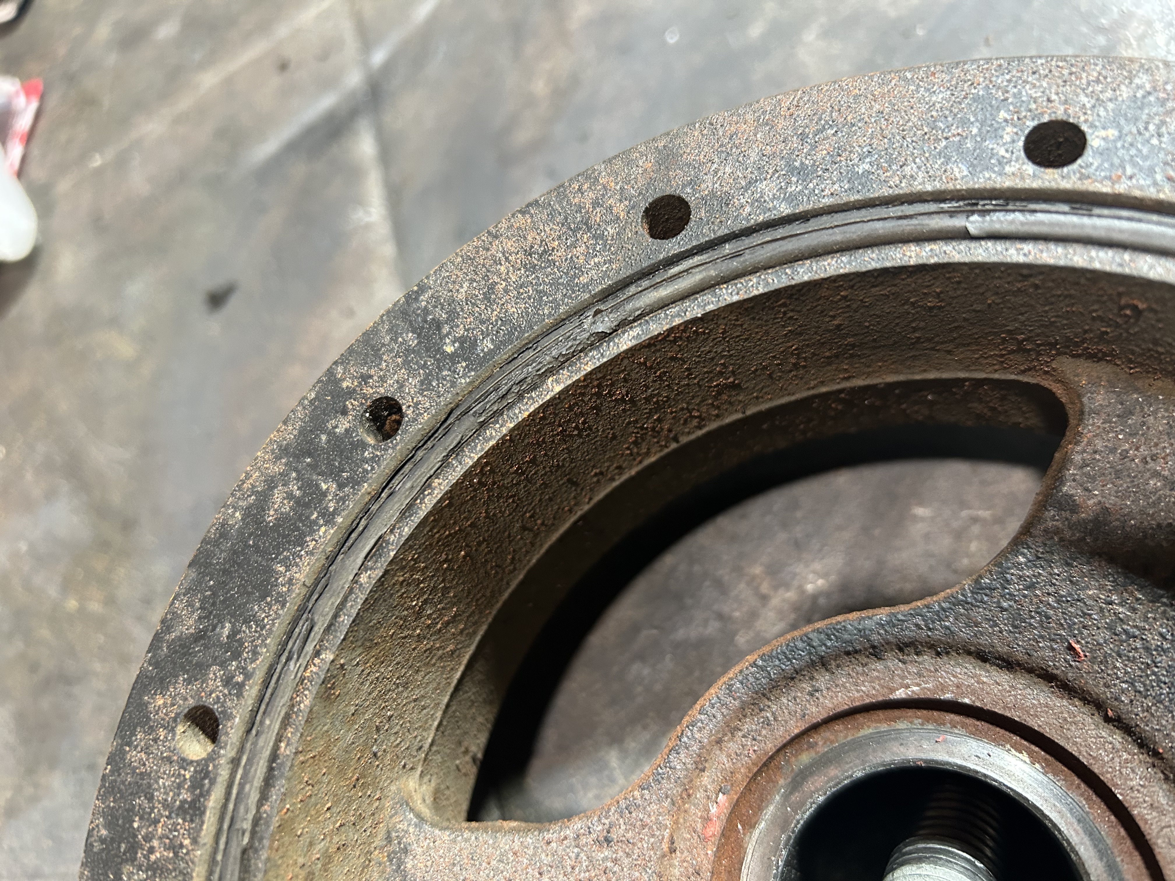

Preventative upgrades
38,628 … So, the C6 Corvettes have many issues that are well known. Let’s face it, this car is already 17 years old! One of the well known issues is the harmonic damper failure. My car still had the factory damper on it (still in good shape and not wobbling) but, I opted to get it replaced as a preventative measure. I’ve read about terrible things happening when they fail. In my mind, it was not if it would fail, but when it would fail. I took the car to Hutter’s for the repair. I had an ATI Super Damper installed. Way more race than required, but guaranteed not to fail. Do it once and it’s done. While in the shop, I had them change the shifter cable grommets (they dry rot and fail, leaving you stuck in park) and they zip tied back the park pall (the solenoid fails and leaves you stuck in park). While trying to replace the grommets, they broke the shifter cable plastic clips, so they bought a new cable for me and installed it on the house. These are three of the four major issues with an automatic C6. The last issue is a gas smell that comes from a failing cross-over tube for the fuel tanks. I’ll wait for that to fail before sending it in for repair. Hutter verified they can do the work, so I’ll send it to them if/when the time comes. They do fantastic work and are very fair. For now, three issues behind me …. Ready for more driving!
