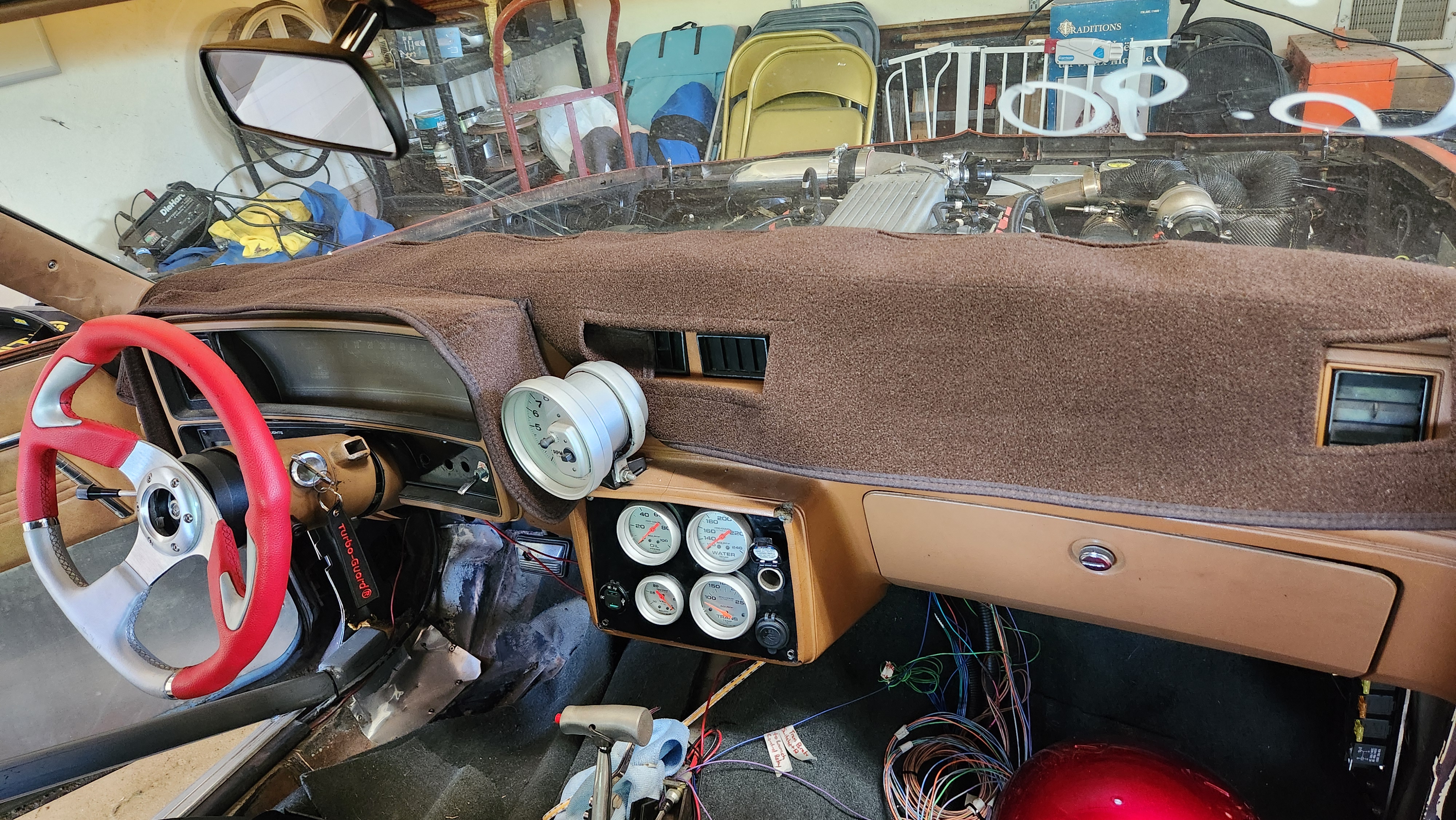

Now that your car is super fast, and you have cool videos from inside the car, you need to replace the dash pad.

It would be a definite improvement. Or just take it off altogether. The rest of the car is empty already. Does this car currently have a heating/defrosting function still?

Ok, ok.. I ordered the dash cover. We'll see how it works.

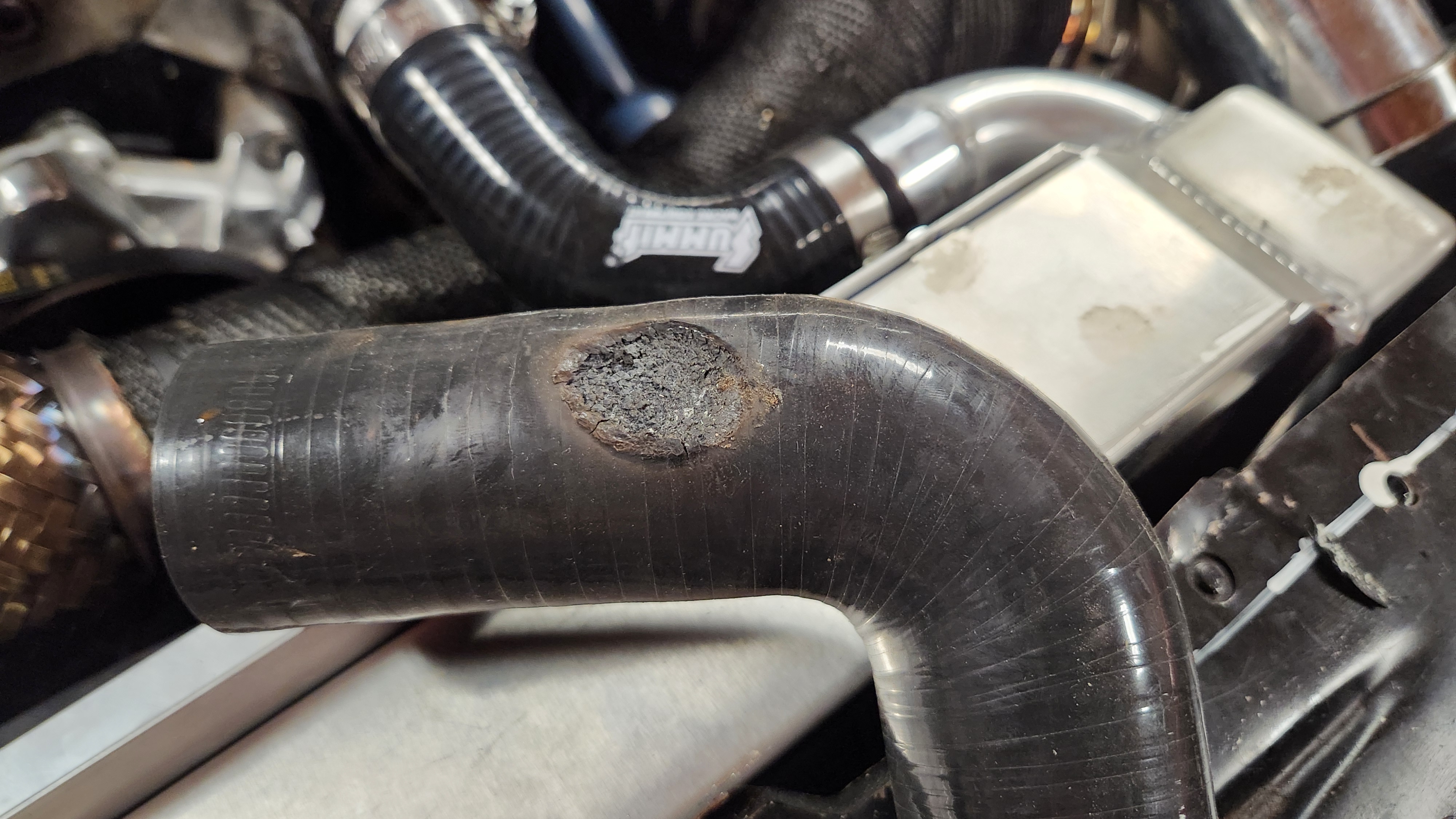

Post-race inspection revealed an upper radiator hose that was touching the heat-wrapped crossover pipe. When I first discovered it, by feel, it felt terrible, and I was amazed it hadn't blown. However, once I got it off, it probably only got half-way through.
Chris was over and we decided to put some wood spacers under the radiator to raise it up a little, which gives quite a bit of clearance to the crossover
pipe.

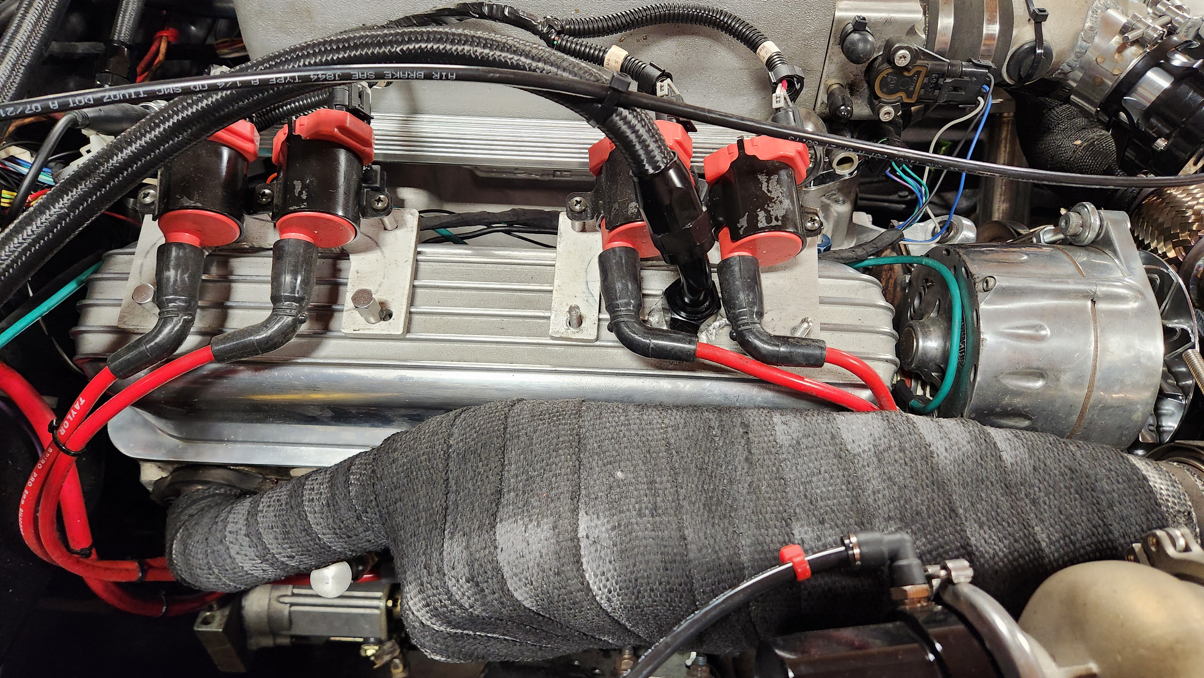

I changed the oil + filter today and another minor issue has been revealed. It's tough to add oil to the engine since the turbo install. I had Steve weld AN fittings into the valve covers for the catch can. Well, there are no other opening in the valve covers. And there are baffles under that AN fitting. I had to use a funnel small enough to go into the inside fitting. And you basically need to take the coil bracket off to get a wrench onto the AN fitting. Yay for my 2-piece coil brackets that at least make that part easier.
Improvement is needed here.

Among those who've seen it, the consensus seems to be that it is an improvement. Not awesome, but less sucky. That's just sitting in place after about 30 seconds of effort.Basement Paul wrote: Thu May 30, 2024 11:21 am Now that your car is super fast, and you have cool videos from inside the car, you need to replace the dash pad.![]()
