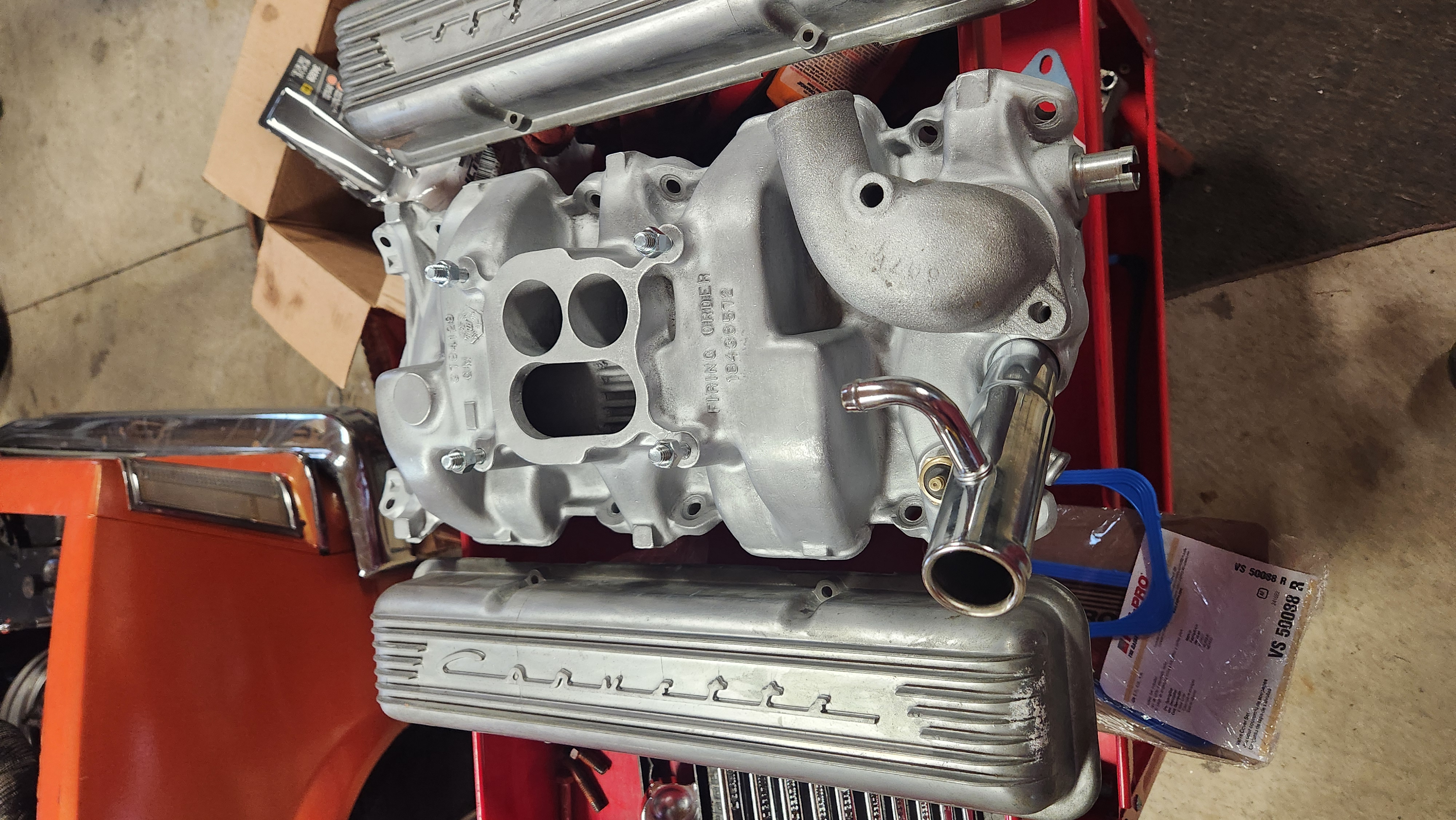

So my next plan was to get a '63 327/340hp intake. It will look correct, and I can fit an air cleaner. But these are kinda rare, 1-yr only intake. I shelled out $500 on ebay for a nice one. It had both heater hose fittings, a temp sender unit, a base gasket, a complete bolt kit -- it was so close to being 10/10. Except someone put 3/8" studs in for carb!! They're supposed to be 5/16". I was sooo mad. I reached out to the seller and he's agreed to work with me.
Today at lunch, I dropped it off at Michael's to have him repair it. I'll have it back next week.
Another fun fact I've learned on this job, early Chevy intakes could have the oil fill tube point to either passenger or driver's side. The Edelbrock goes to the drivers, as does the stock '63 327/250hp, while the '63 340hp goes to the passenger. And the oil fill tubes are different too, because of where the hose barb comes out.
