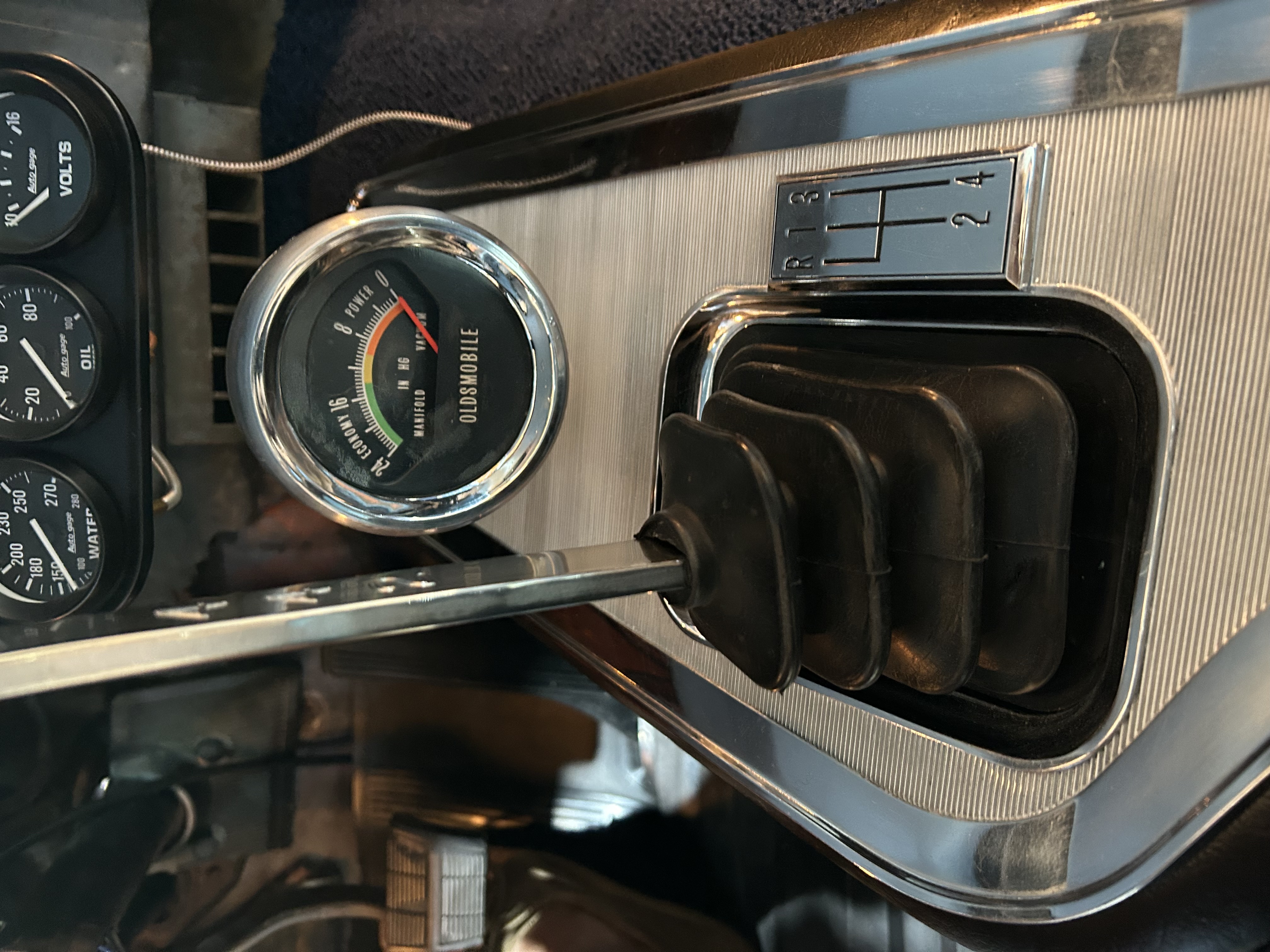

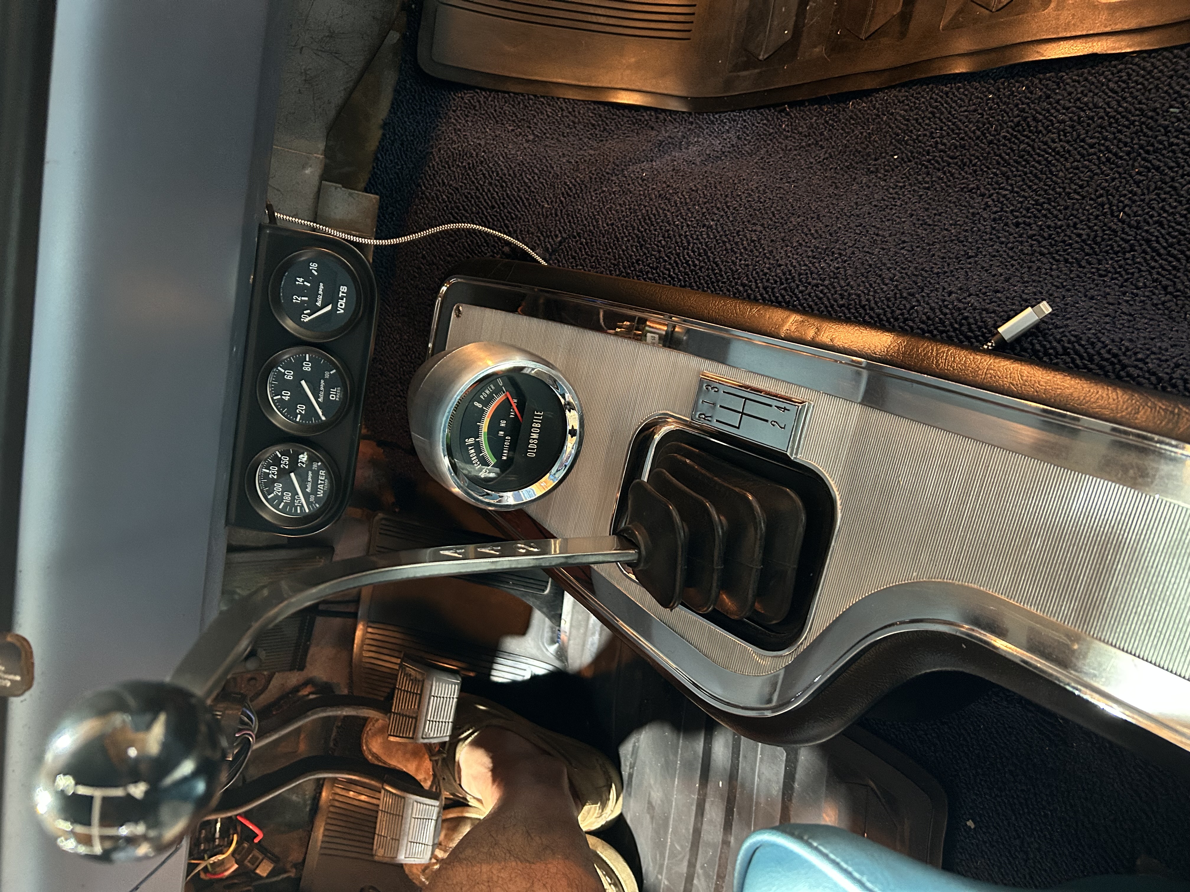

41,000 …. I found a sweet deal on Ebay on a factory vacuum gauge for the 442. For under $100 I got the gauge shipped to me and purchased the new vacuum hose and the brass fitting to connect the hose to the intake manifold. It took me a couple of hours to do the install, but when I was done it worked 100% on the initial start up. The gauge is super clean and adds a bit of color to the interior of the car. I like the look and it was a pretty painless project.

Did the console already have accommodations for installing the gauge?
Posts: 1235
Re: 1965 Oldsmobile 442
wxo wrote: Sun Jul 23, 2023 9:32 pm Did the console already have accommodations for installing the gauge?
WXO,
Yes sir! There were three options for what goes in that spot from the factory,
a tachometer, vacuum gauge, or a rocket emblem. I’ve completed the trifecta
now, the 442 has had all three since I’ve owned it. There was no customizing
required for this project.

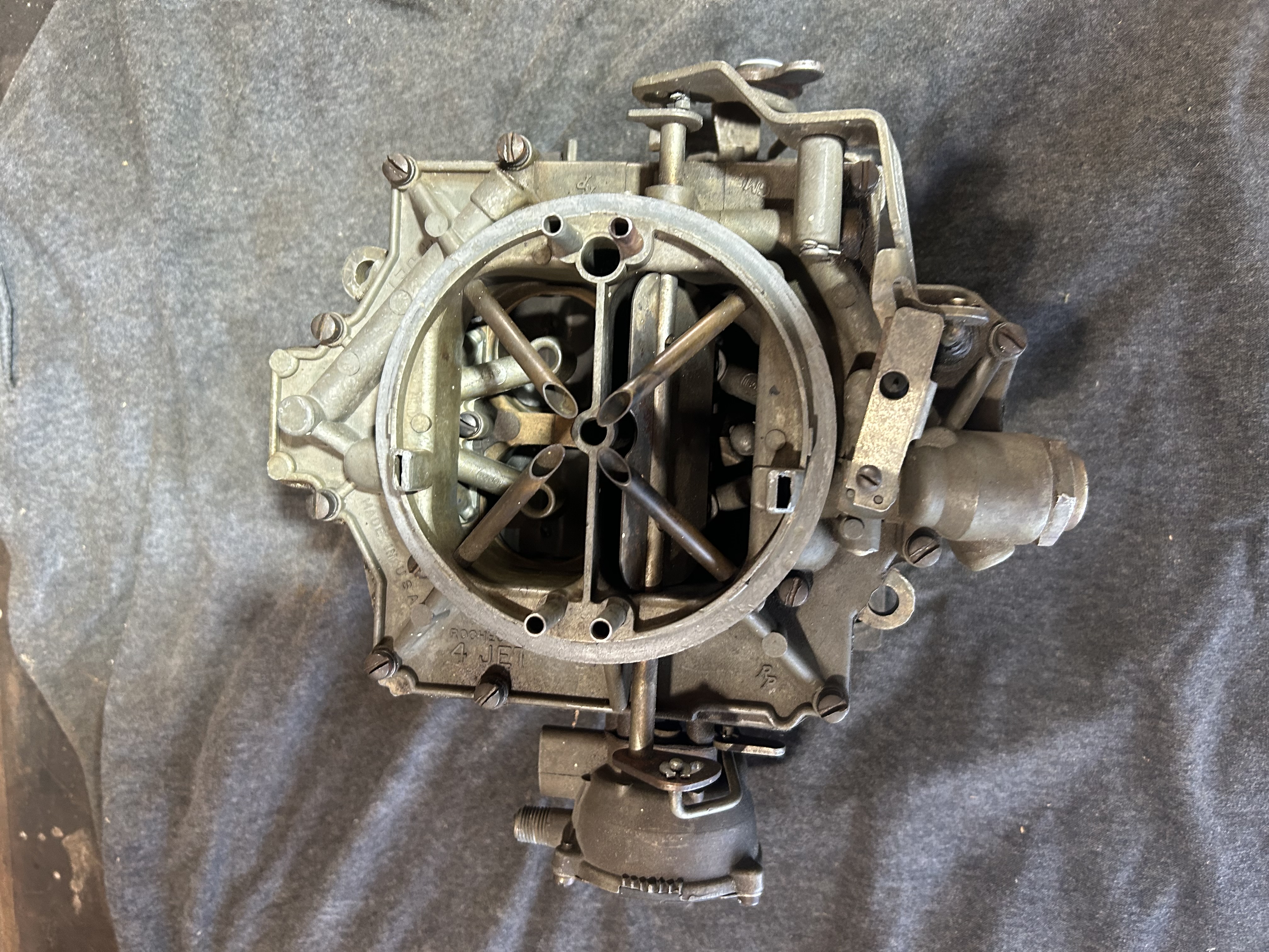

Original Carb Rebuild
41,385… Well, it literally took a year for the second phase of carb rebuilding to come to a close. About three weeks ago, I took a Saturday morning and rebuilt the original carb. I had about three hours of my time in the rebuild, which included resetting the float height and drop, both of which were wrong on both floats according to my 1968 Motor Manual. I did the install today and, like the last rebuild I did on a 4GC Rochester, I had no leaks and the car ran perfectly when I was done. It took about an hour and a half to do the swap and that was with me dragging my feet. I took it for a test drive and all works correctly. I’ll take it for a longer Labor Day Weekend cruise later on in the weekend. It’s nice to finally have that carb on the car and off my workbench!
