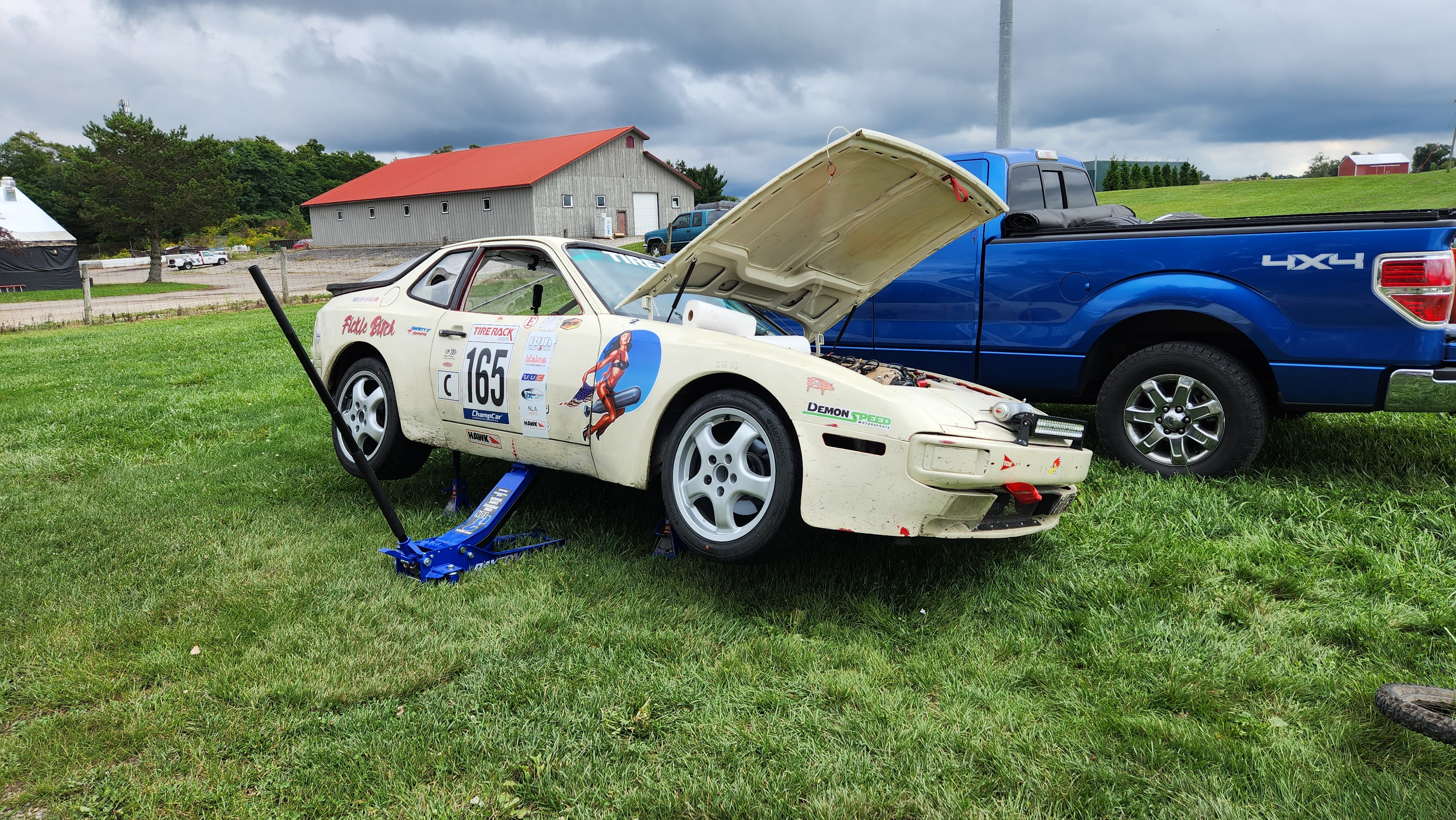

Well, Mid-Ohio is in the books. Hindsight is 20/20, and we should've waited for a trackday to shake it down.
We got to the track on Friday morning for practice. While warming the car up, I noticed the alternator wasn't charging. It was a brand new alternator that Scott had installed between the time it left my house and Friday -- 6-7 days? Scott even had sent me a pic, showing his meter with 13.5 volts. Well, knowing alternators generally have an excite wire to 'turn on' charging, I figured out we needed to run a wire from the B+ terminal to the D+ terminal. In the end, an easy fix and didnt take too much time to sort out.
Once Scott took the car out, we noticed it came back with no air filter. Luckily, it was picked up by track officials perfectly intact. We used some Gorilla tape and a clamp and it stayed put the rest of the time,
The next time out looked like disaster. Joey was in the car, coming down the front straight and just TONS of smoke. When they towed him back, they took the car to the grass to let the oil drip-dry there. But it wasn't disaster. There is a single bolt that holds the oil cooler feed and return lines to the engine. It was too short and backed out. We got a longer bolt and were able to get it back together.
All 4 of us made practice laps. I went last. The car has some top-end speed! The new tires were not as grippy as hoped.
On Saturday, Scott took the green flag at 9am. At 10:30, he was towed in, car was dead and wouldn't start. The new aftermarket bracket that was a combination crankshaft-sensor-mount and alternator bracket had broken. This threw the sensor way out of alignment. With some hardware store help from Chris and Jered, we were able to MacGyver together a working solution, and I was out on track by 12:30pm.
I didn't have any issues during my stint and the last 20-30 minutes were really fun. We had a FAST car. We could out-run or run-down just about anyone in the straights and we werent terrible in the corners. Joey and I both saw 5600 RPM on the back straight, which worked out to 143 MPH.
I got out of the car at 1:50pm and went from exuberant to pissed off in about 30 seconds when I heard the car turning over and not starting. This time, the alterntor pivot bolt was missing, which again messed with our crank sensor alignment. Chris and Jered made another quick trip to the hardware store, got a bolt, and we had the car running again for Tom's stint.
Tom got towed in with the car not running, but his issue was quick. It's easy to bump either the ignition switch or fuel pump switch sometimes when shifting into 3rd (happened during my stint), and he hadn't realized he bumped it. Turned everything on and he went back out.
Joey got in the car at 3:45pm, but it would only last 20 minutes or so before he was towed in with catastrophic engine failure. We could see a hole in the block where the upper balance shaft goes.

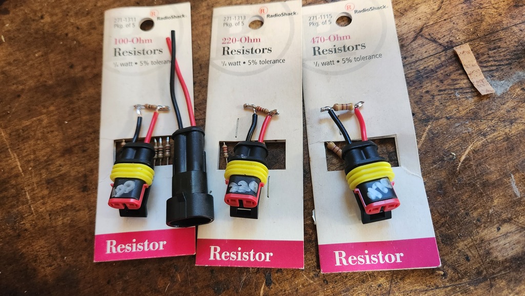

So our session last weekend was less productive than hoped for. The car would barely rev before the RPM signal would drop out. fuuuuddddgeeee..
I made a post on msextra.com and was directed toward this post:
https://www.msextra.com/forums/viewtopic.php?p=584569
which basically said "in our testing, we needed a 220-ohm resistor across the crank position leads to achieve max RPM" while also showing what other common values resulted in.
I'll wire in the socket on the harness, and I can I easily swap plugs to another if 220 is not the correct value. The original poster had a variable used a variable resistor (twist knob) till he found something that worked and measured it. I didnt have one on hand, and he was doing a 60-2 setup on a Porsche 928-V8, same era.
