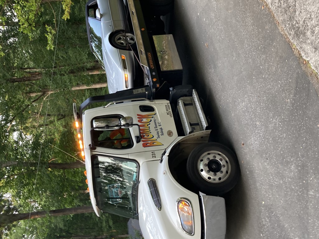

I took Silvia out to pick up dinner this evening. She was running perfectly with the fuel pressure set at 46 psi. On the way back she just quit. I took a quick peek at the fuel pressure while on the side of the road and it was ZERO when I turned the key on. Could it be another failure of a brand new Delphi fuel pump??? If it is, I need to choose a different brand. A BMW mechanic stopped to see if I needed any help along the road. We started talking and he reacted quite negatively when I mentioned that this was a Delphi pump. He suggested Walbro, so Walbro it will be (probably).
This is the fourth rollback ride for Silvia since we met.
