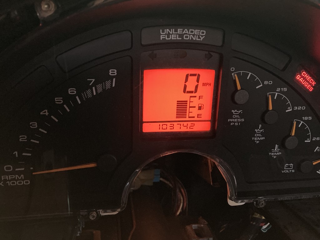

I took a break from Silvia's rear end and worked on refurbishing her digital drivers information center. Crossing my fingers, I installed it and was rewarded with a bright, clear display.
