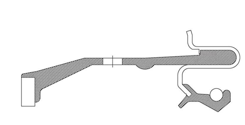

In the mean time, this afternoon, I decided to change the tail shaft seal in the 6 speed. The old seal came out without a major struggle and I unboxed the replacement seal I had ordered from Amazon.
This seal is unique in that it has a dust boot to keep dust, dirt, and other debris off the main seal. The original seal didn’t have this dust boot. It seems like a good idea so I’m going to go with it.
