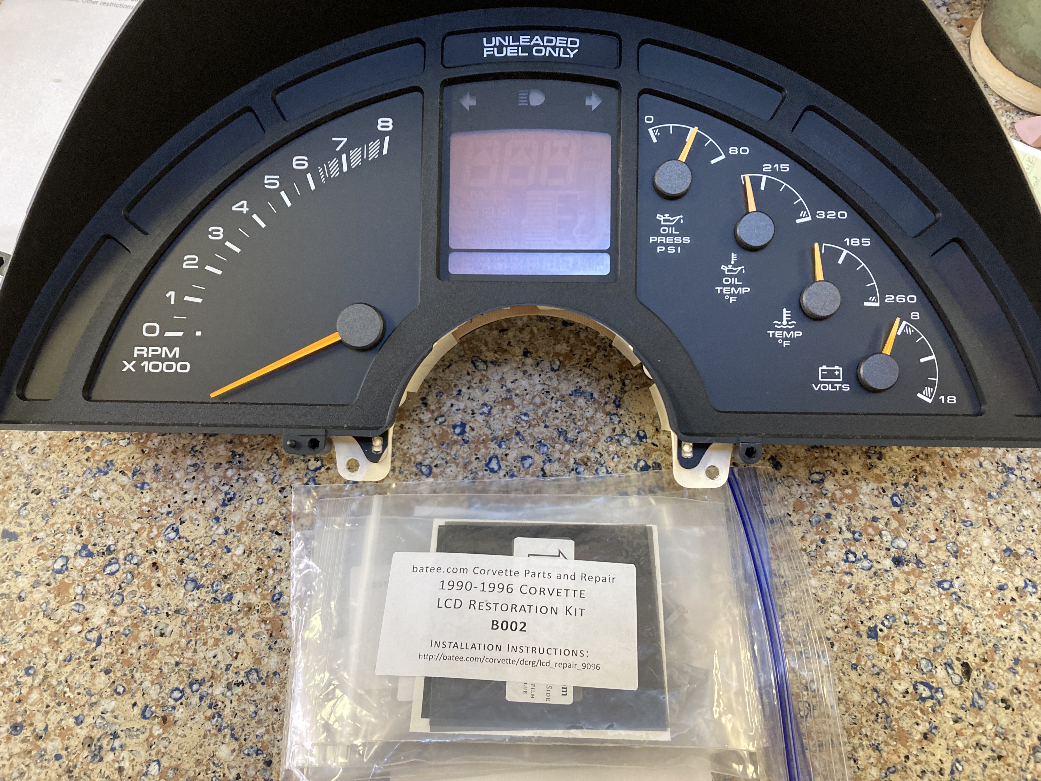

Since I'm waiting for stuff to work on the exhaust, Dave's post motivated me to get started on my digital dash restoration. I took out the instrument cluster today and watched the Batee video for the restoration. Hmmm...it looks like it could be tricky.

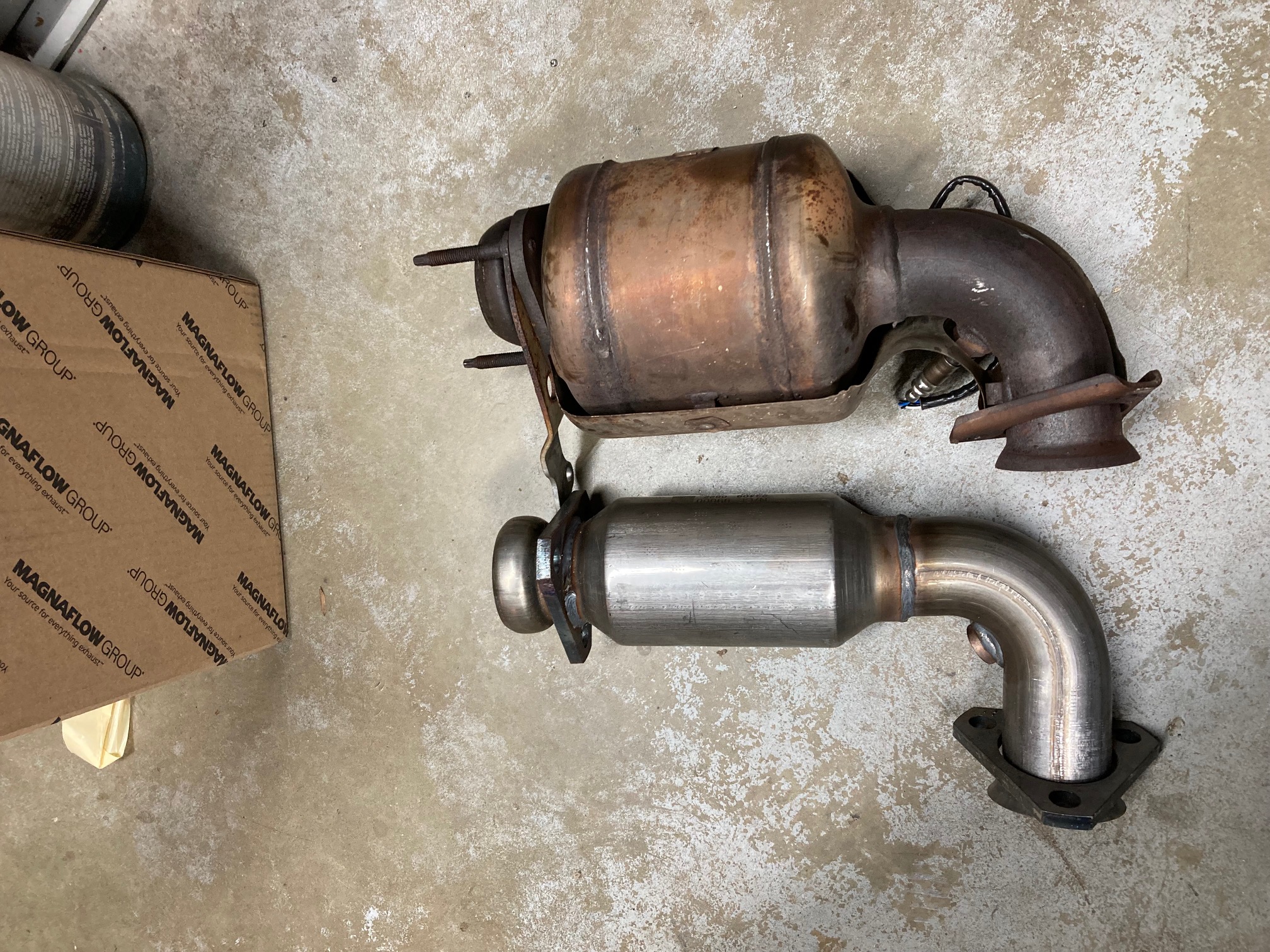

With the exhaust system out of the way, I turned my attention to replacing the catalytic converters. Getting them out turned out to be a two afternoon job. The right side was difficult due to inaccessible hanger bolts. It took me several hours to finally get it out of the car, but it was the left side that really kicked my butt. The top hanger bolt was located in a spot so high up I couldn't touch it with my hand. I tried several open end wrenches and finally ended up getting a ratcheting box end on it to screw it out. To make things even more difficult, the bolt was boxed in by the fiberglass body panel. I was relieved to be able to unscrew the bolt until I realized that I had gone too far. I had backed it out too close to the body and the wrench was captured in place. I couldn't screw it back in to release the wrench because the ratcheting wrench needs to be removed and turned around to turn the bolt in the other direction. I returned the next day to have a fresh look at the situation. I could see the bolt and wrench from the top, so I decided I could get a hand on it from the top if I removed the windshield wiper motor. This is not a simple task, but I thought it would be worth it if I could get myself out of this predicament. Once I got the wiper motor out, I saw that there were bundles of wiring blocking my path to the bolt. This was not going to help at all. So back down underneath. I used a long screwdriver to tap on the points of the bolt head to screw it back in enough to get the wrench out. Then I used the same technique to back it out again, but now it was touching the body with not enough room to get it completely out to release the cat. The next part was sheer desperation. I tapped it and moved it to the side a bit and finally removed all the other attaching bolts on the cat so that I could move things around a bit more. This worked! I now had enough room to push the bolt a enough to the side to allow everything to come loose. I have no idea how I'm going to install the new cat. It is designed to use the old hanger bracket and I will be required to use the same bolt locations to install it. Well, I'll figure that out when I come to it.
Here is a size comparison of the old and new left side cat: Once I get all this stuff back in place I should have a lot more working room in this area.
