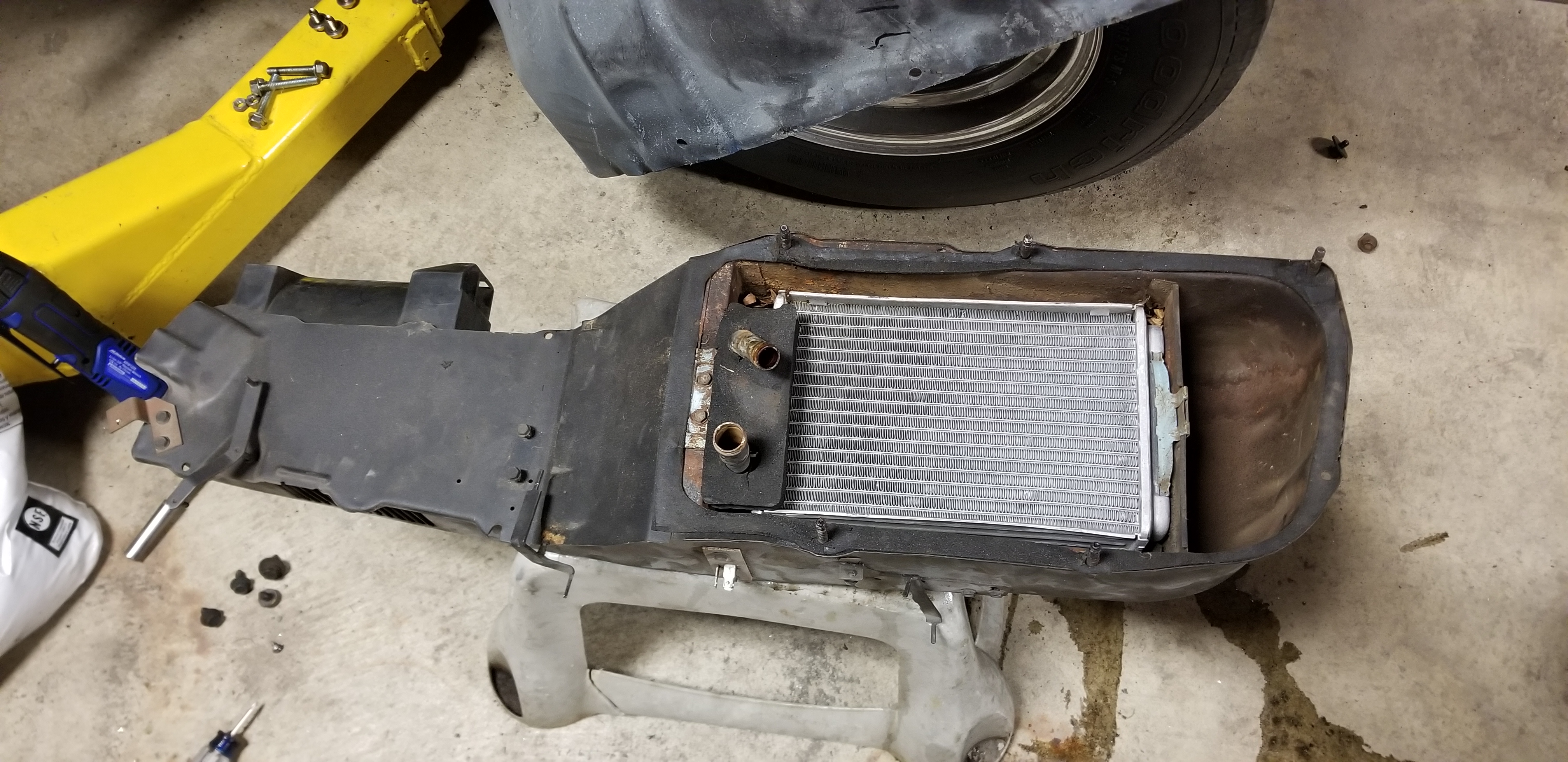

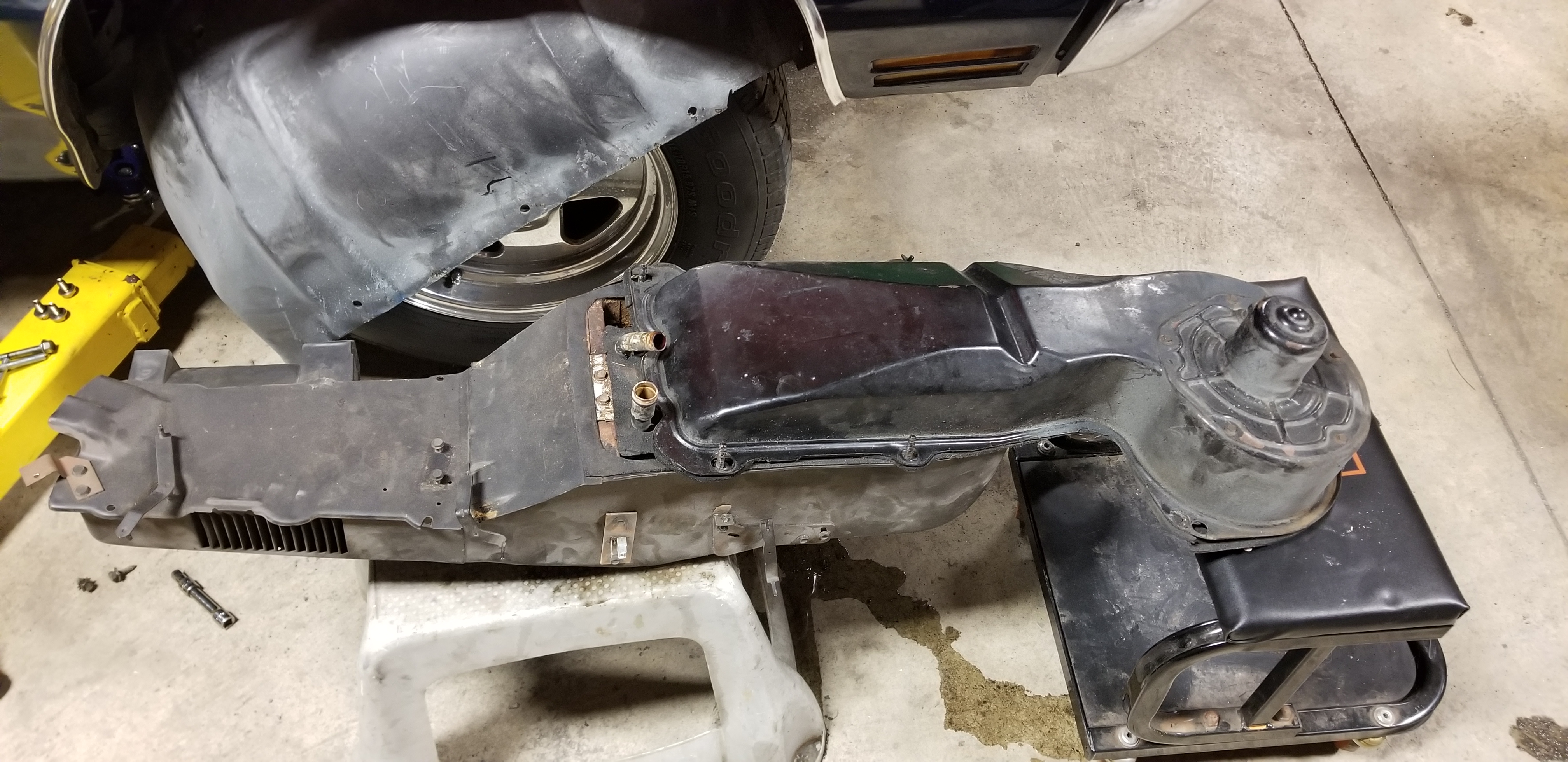

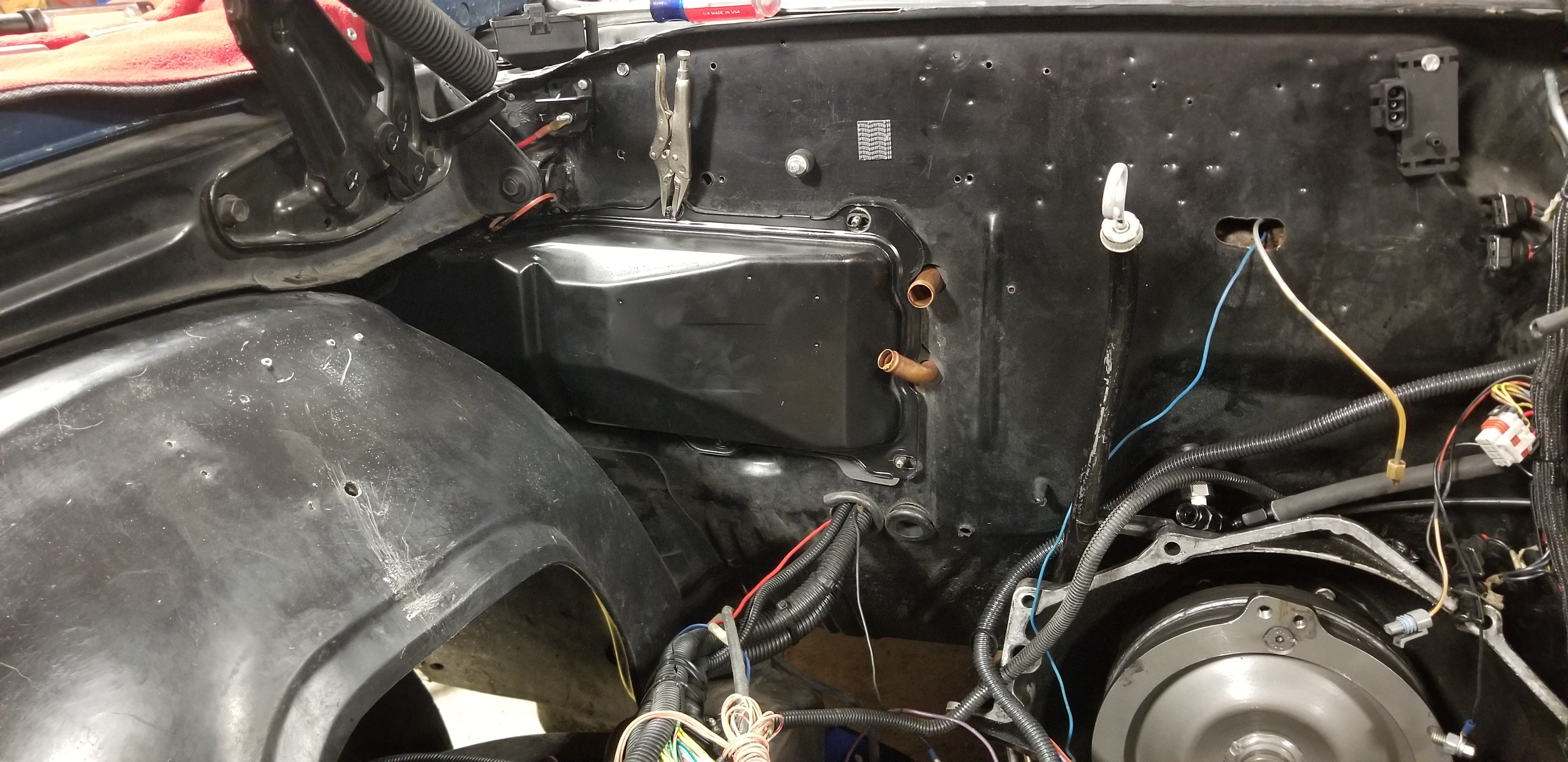

At the end of '21, the heater core started leaking. I un-plumbed it from the system and quickly realized how much it's needed. So tonight, for what I'm pretty sure is the third time in my ownership, I tore the heater box out. I've gotten increasingly efficient every time I do it.. Pulling the inner fender makes it pretty painless. We'll see how it all goes back together. Tomorrow.

Got the heater box re-installed yesterday, along with the inner fender. I put in all new gaskets, including one which acts as damper on one of the vent doors that I'm sure I used to hear ting-ing around ever now and then. I repainted the box in the engine bay, but skipped repainting the heater box inside under the dash. That was too much of a make-work project for the moment. I also replaced the blower motor, just because the other one is 50 years old. With this side project complete, I can get back to putting the engine back in.

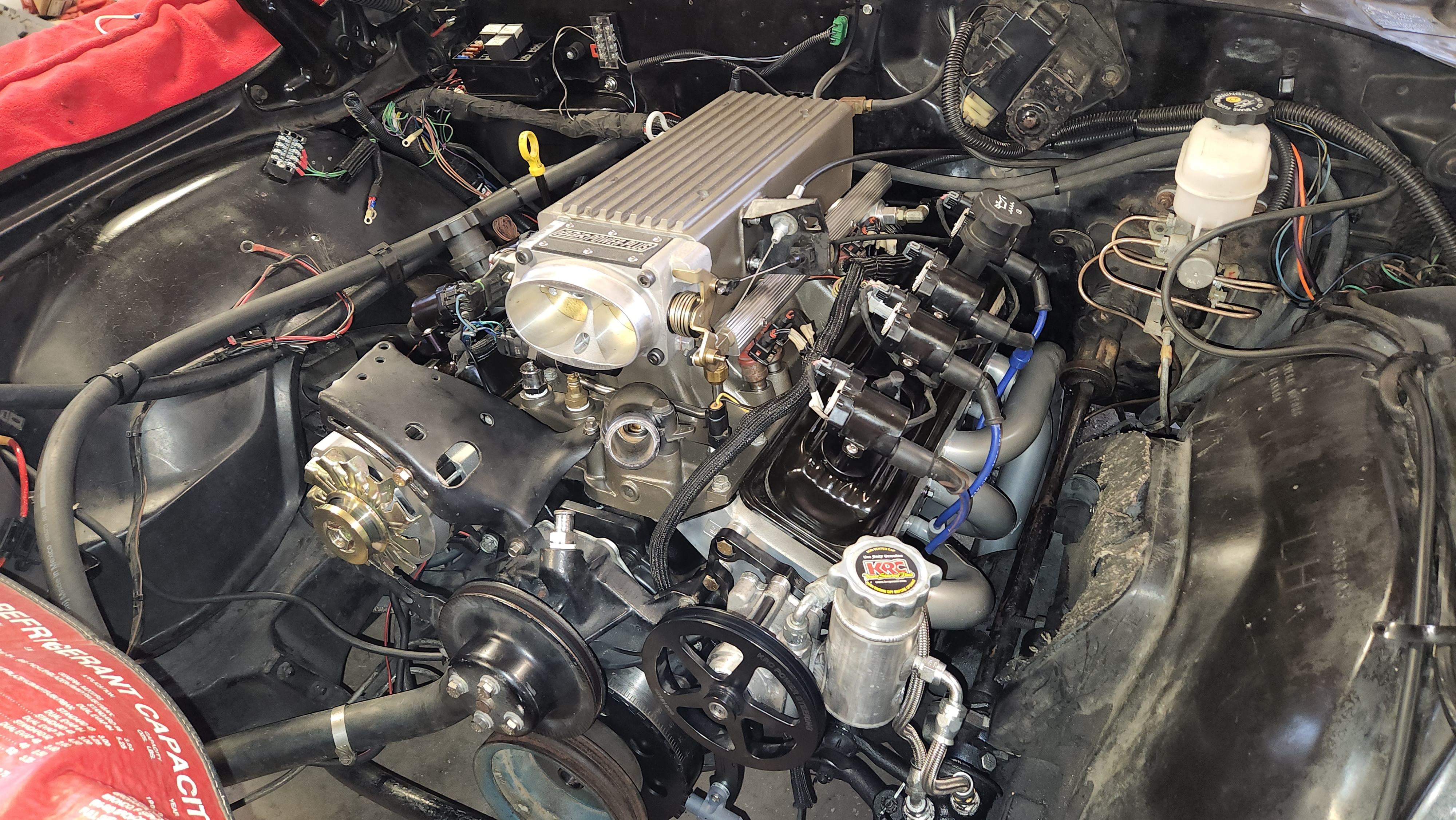

Tonight I got the ZZ383 set back into the engine bay. It took a little more goofing around than usual to get everything lined up, but it's in! Now I can pick at it all week
