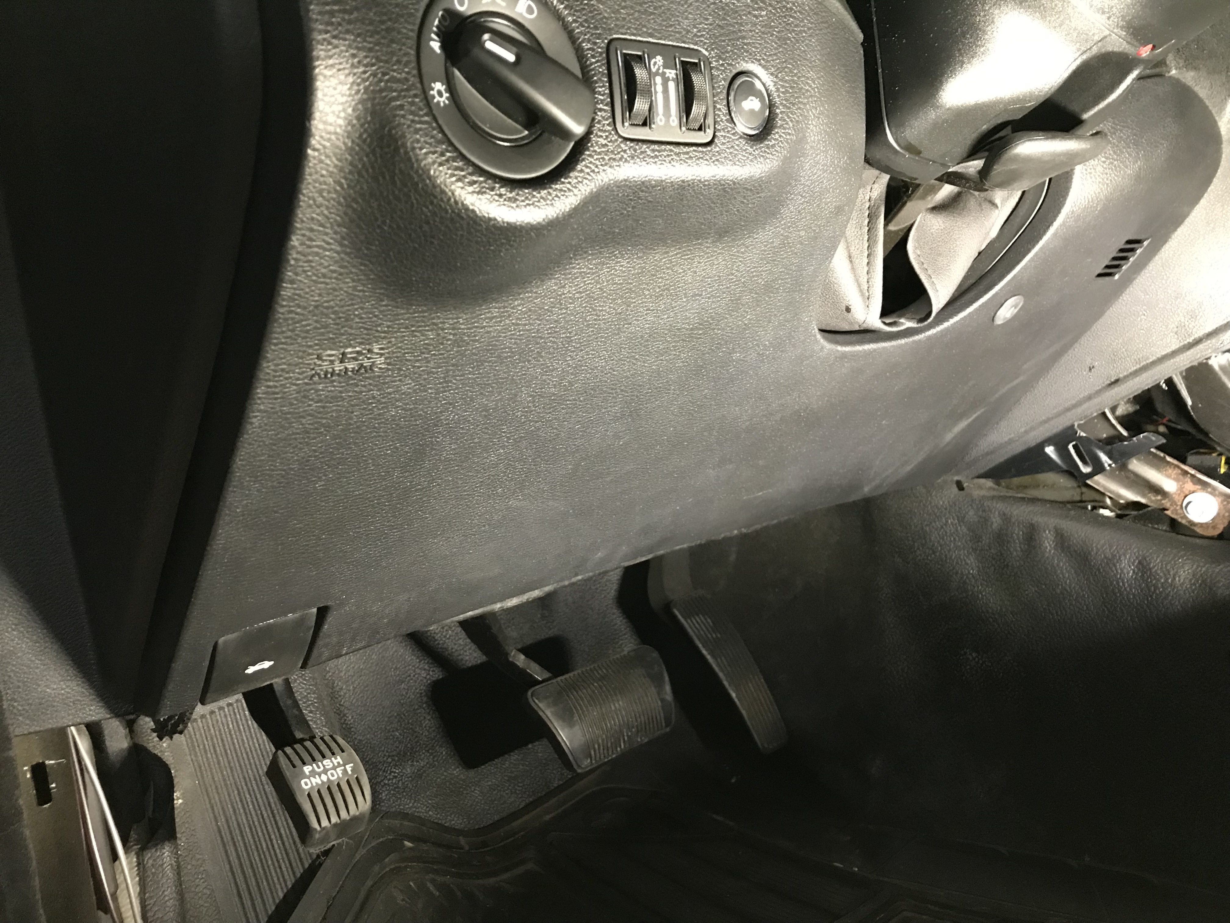

* With the engine running I took the time to let it warm up a little and test things. The trunk release button on the dash does not work, dash lights for ABS, traction control and the airbag system are still on. There is a squeak from I think a pulley on the driver side of the engine.

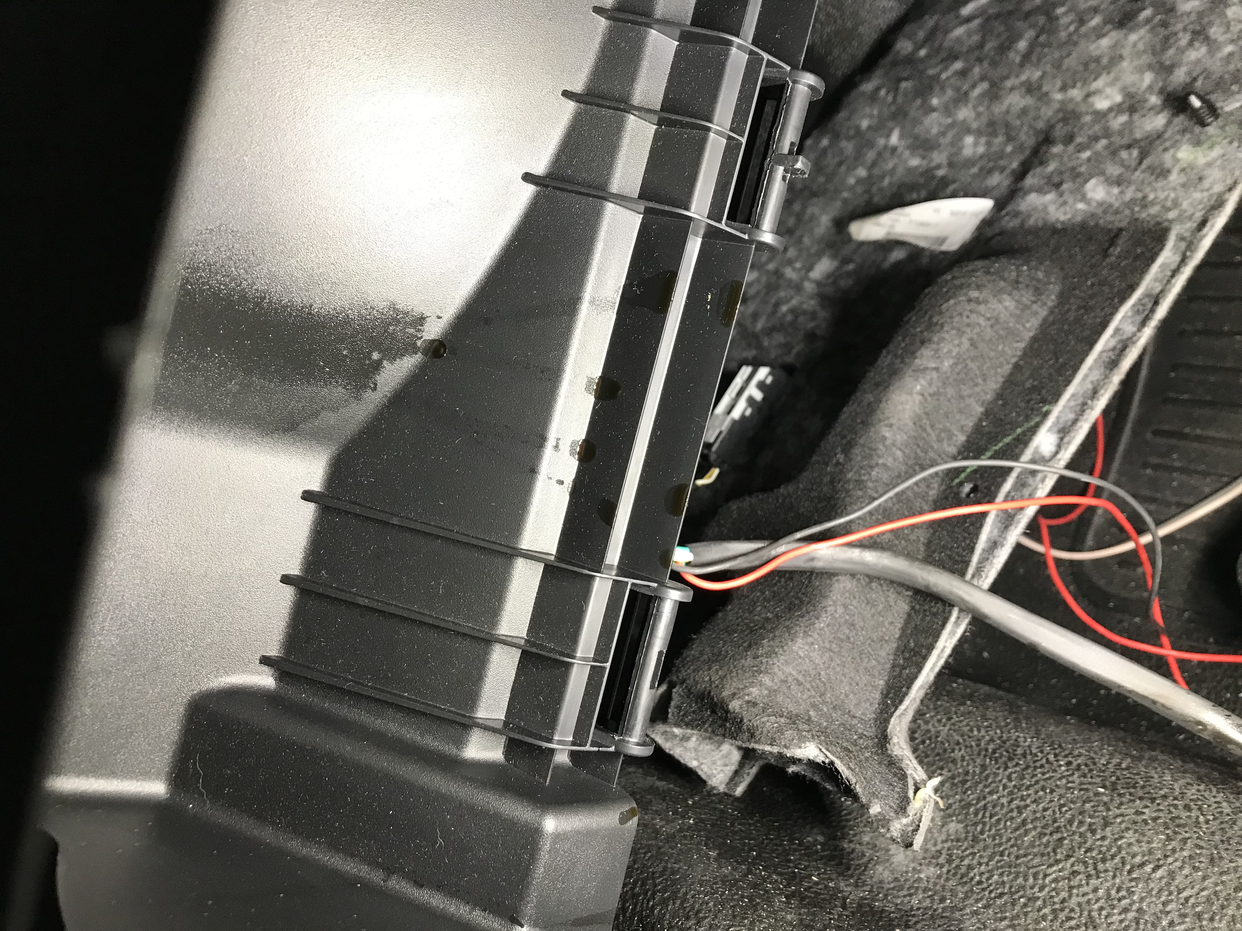

* Found a wire connector in the console area that did not look OEM, so I followed it up behind the glove box, only to find this harness had tapped into the passenger airbag wiring. This is probably why the airbag light did not go out. Best guess is the police computer would allow the officer to override the airbag sensor in the passenger seat, in case they were carrying something over there that would not want to impact the airbag. Anyway with the police computer removed it was just not connected.
* Received the airbag module after reset and installed it - now there are no lights in the dash. Oddly enough the horn and seat belt indicators did not work with the airbag module out.

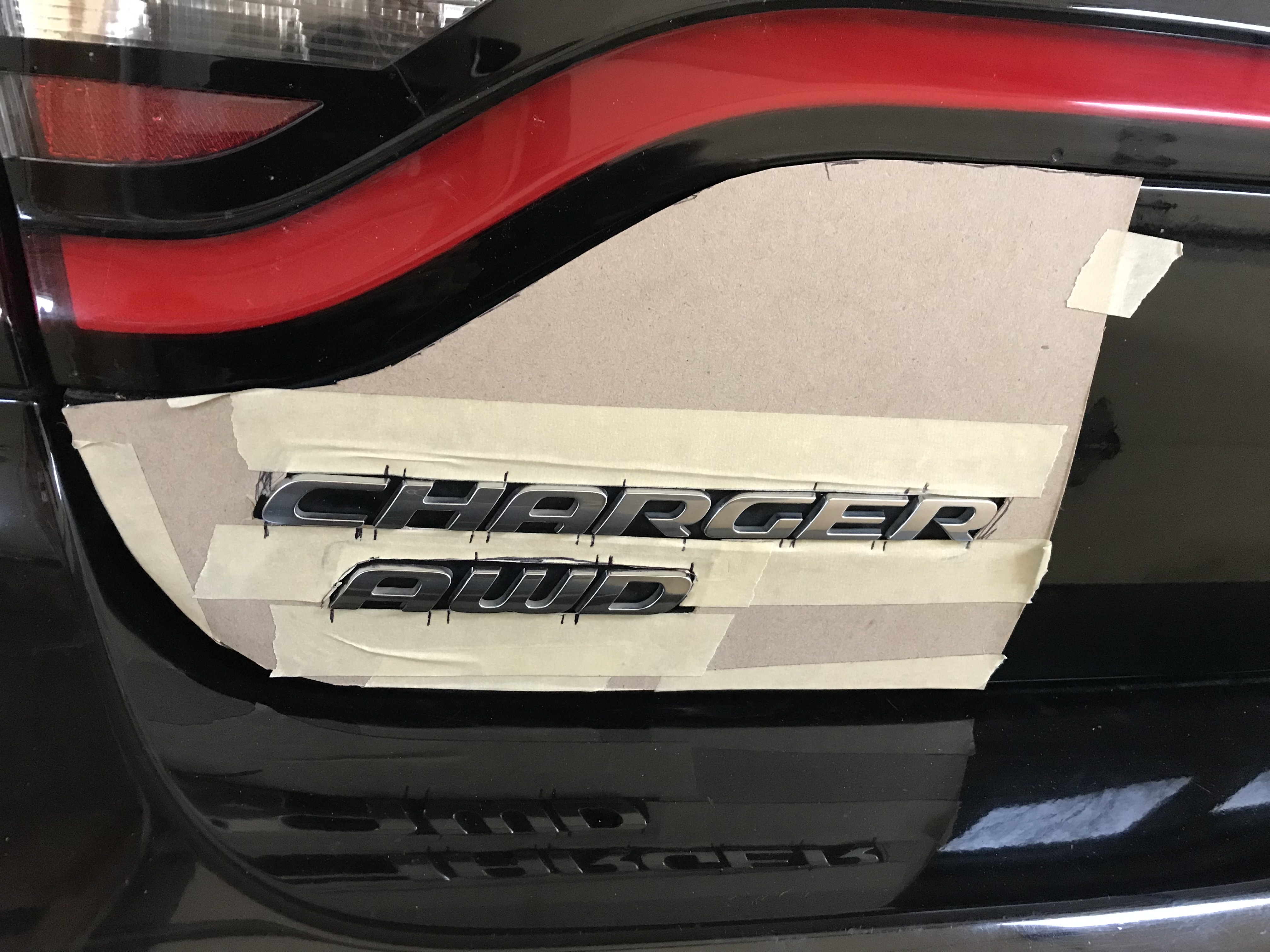

- Remove Charger AWD emblem – made a template for reinstall, also removed the center of the rear lights on the trunk, and the backup camera

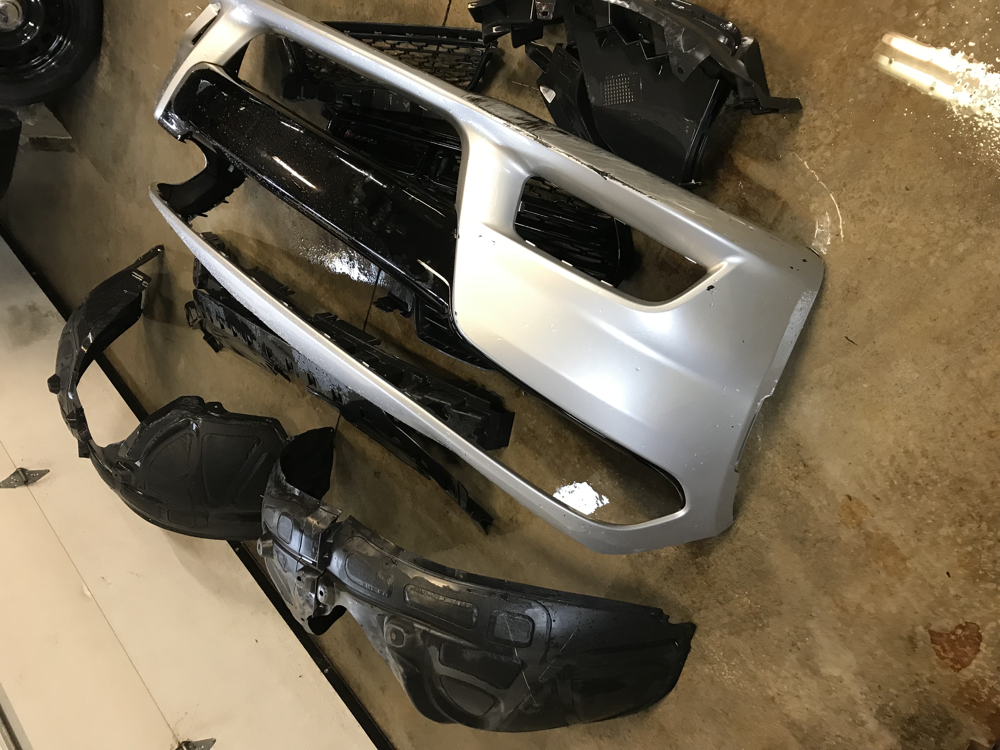

- Disassemble front bumper cover, clean all the parts, and clean door and trunk jambs in prep for paint work

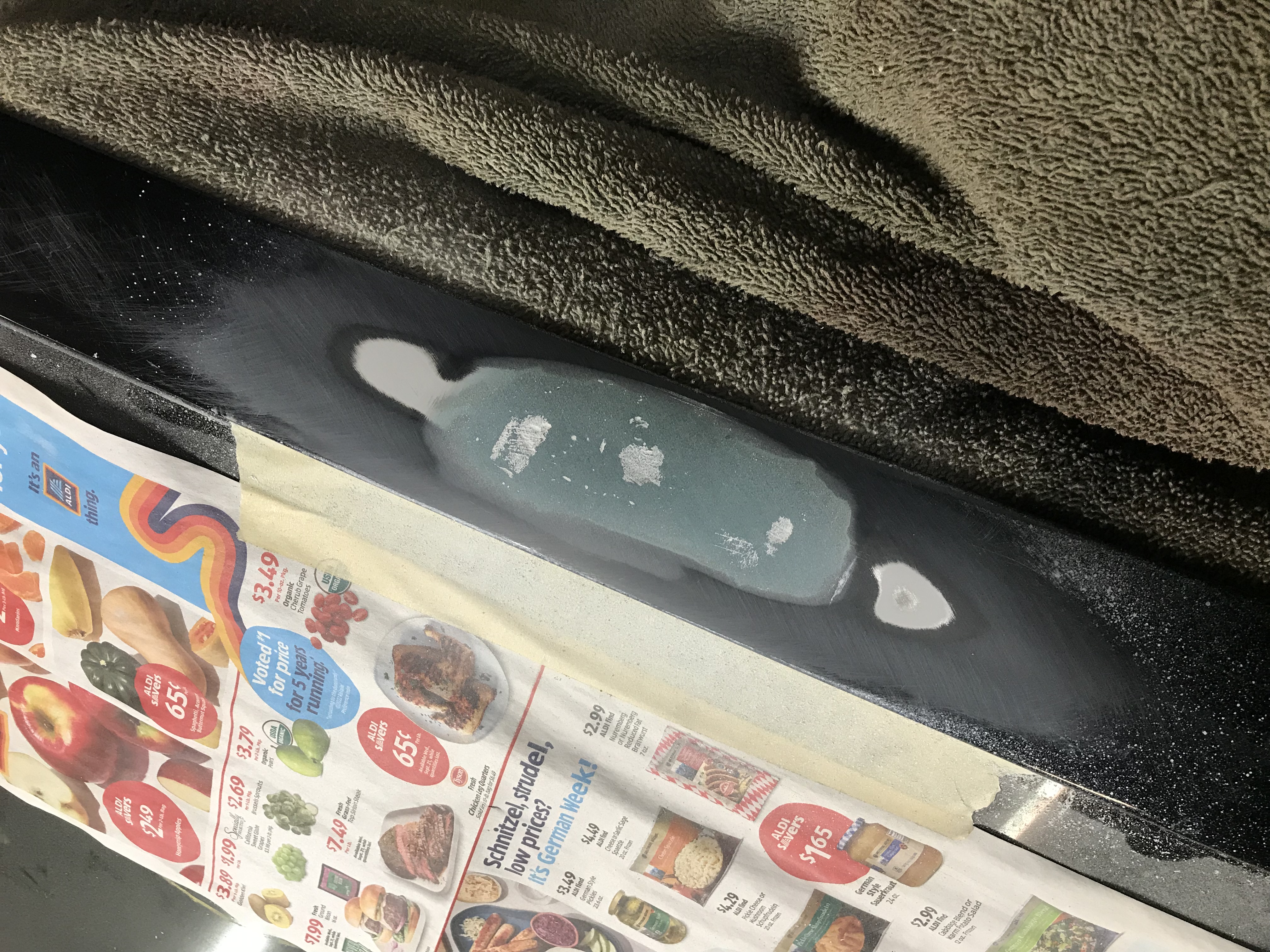

Put some color on the bottom of the hood and inner edges of the front fenders
Posts: 2447
Re: 2019 Dodge Charger
I laughed at the third thumbnail, thinking something was gonna be Saturn Teal. That's B5 Blue?
