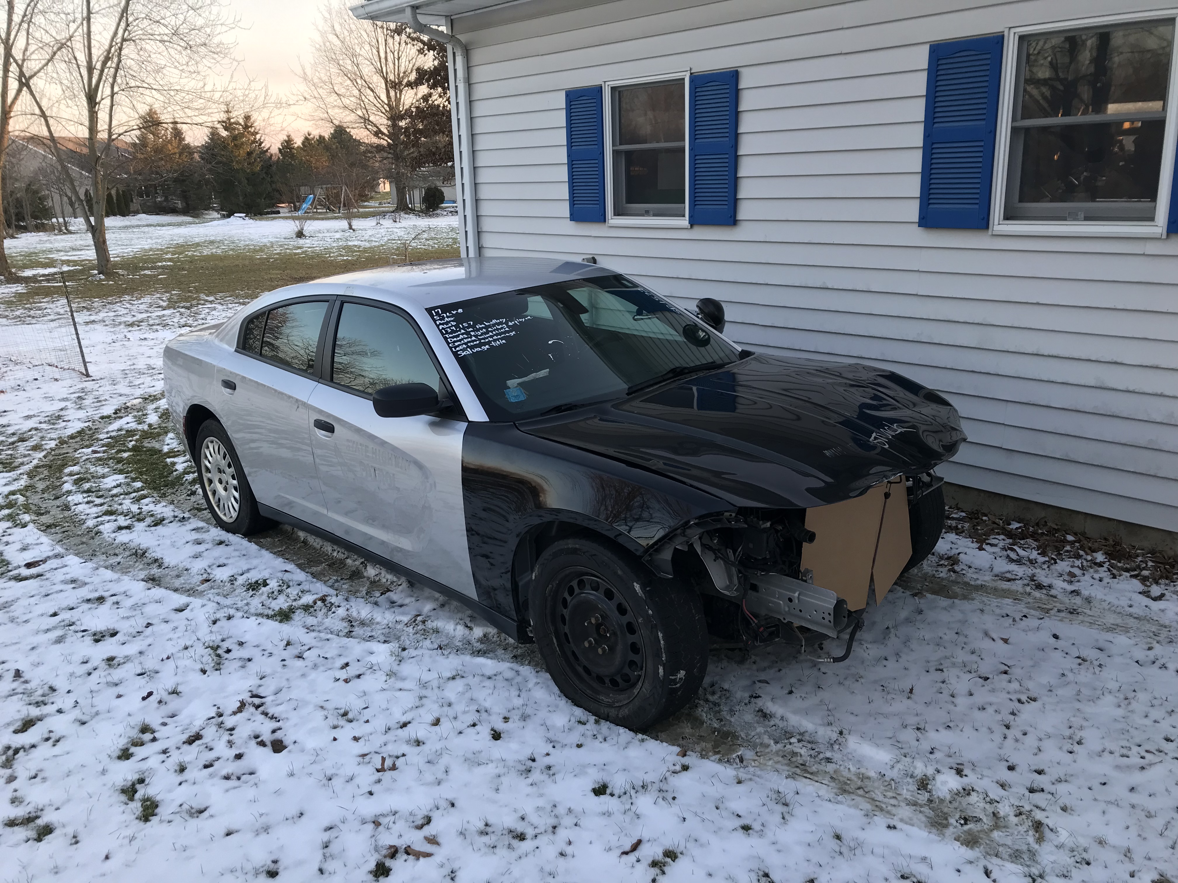

• Removed the front clip, prepped all surfaces, Kurt welded everything up
• Cleaned up welds and painted all the repaired surfaces
• Installed a lot of parts on the front of the car: power steering, alternator, A/C compressor and lines, lower radiator support, washer bottle, radiator hose, front bumper, hood latch cable, other small misc
• Cleaned the surface rust on the fenders and hood, and treated them with rust inhibitor
• Straightened some minor damage on the RF – put my newfound knowledge with hammer and dolly to work
• Pulled codes for ABS and electronic stability control
• Fred32v was over today and got the rear plastic seat/belts out and replaced them with the OEM seat and belt
• Removed police wiring harness – this was over 20 lbs of stuff
• Crossed the 100 hour mark on this project

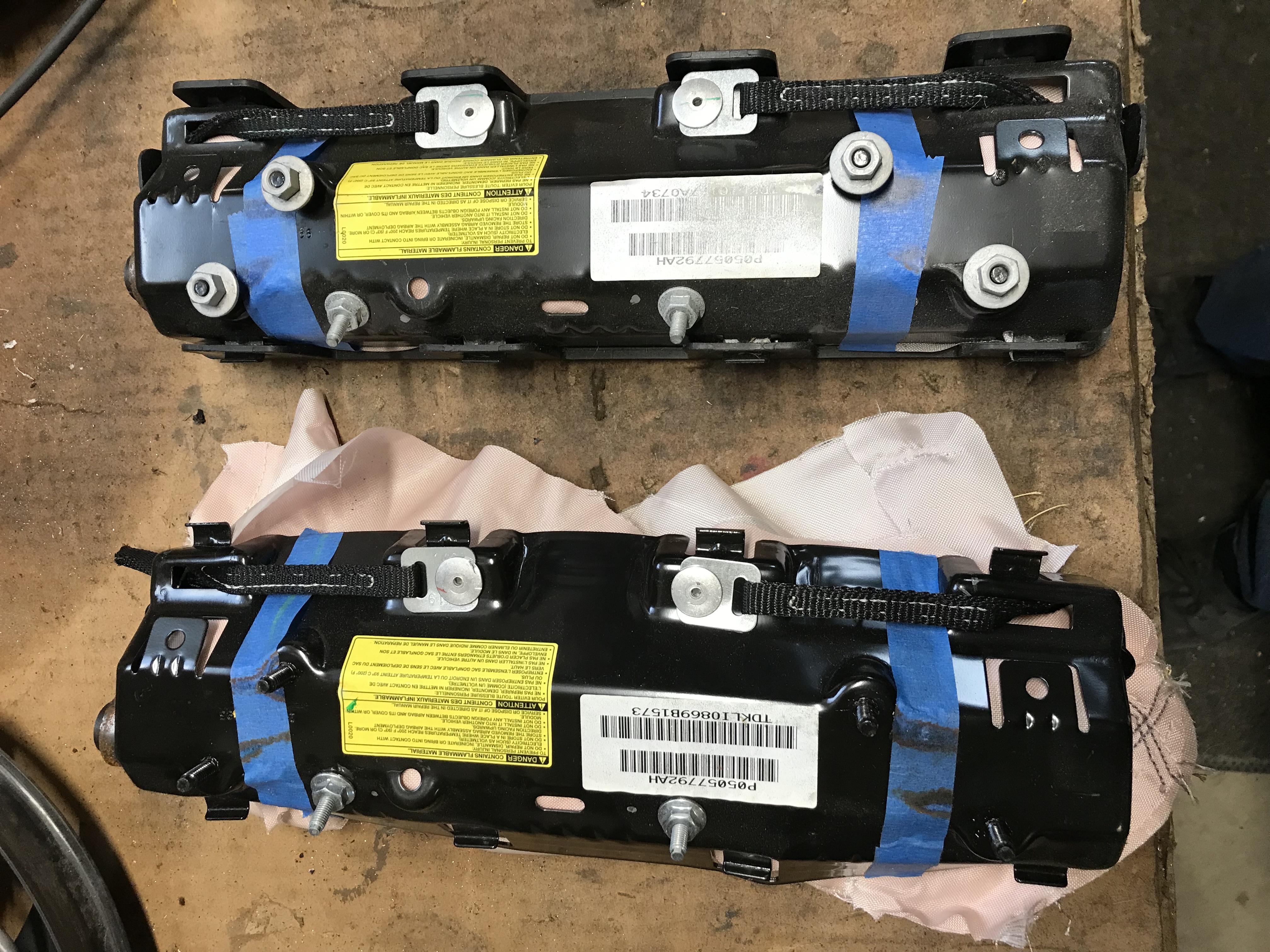

Bonus pic - on the left is the deployed lower airbag. Note the metal casing is deformed from the deployment!

* The airbag module is out for service, expecting it back within a week

* Received the airbag module after reset and installed it - now there are no lights in the dash. Oddly enough the horn and seat belt indicators did not work with the airbag module out.

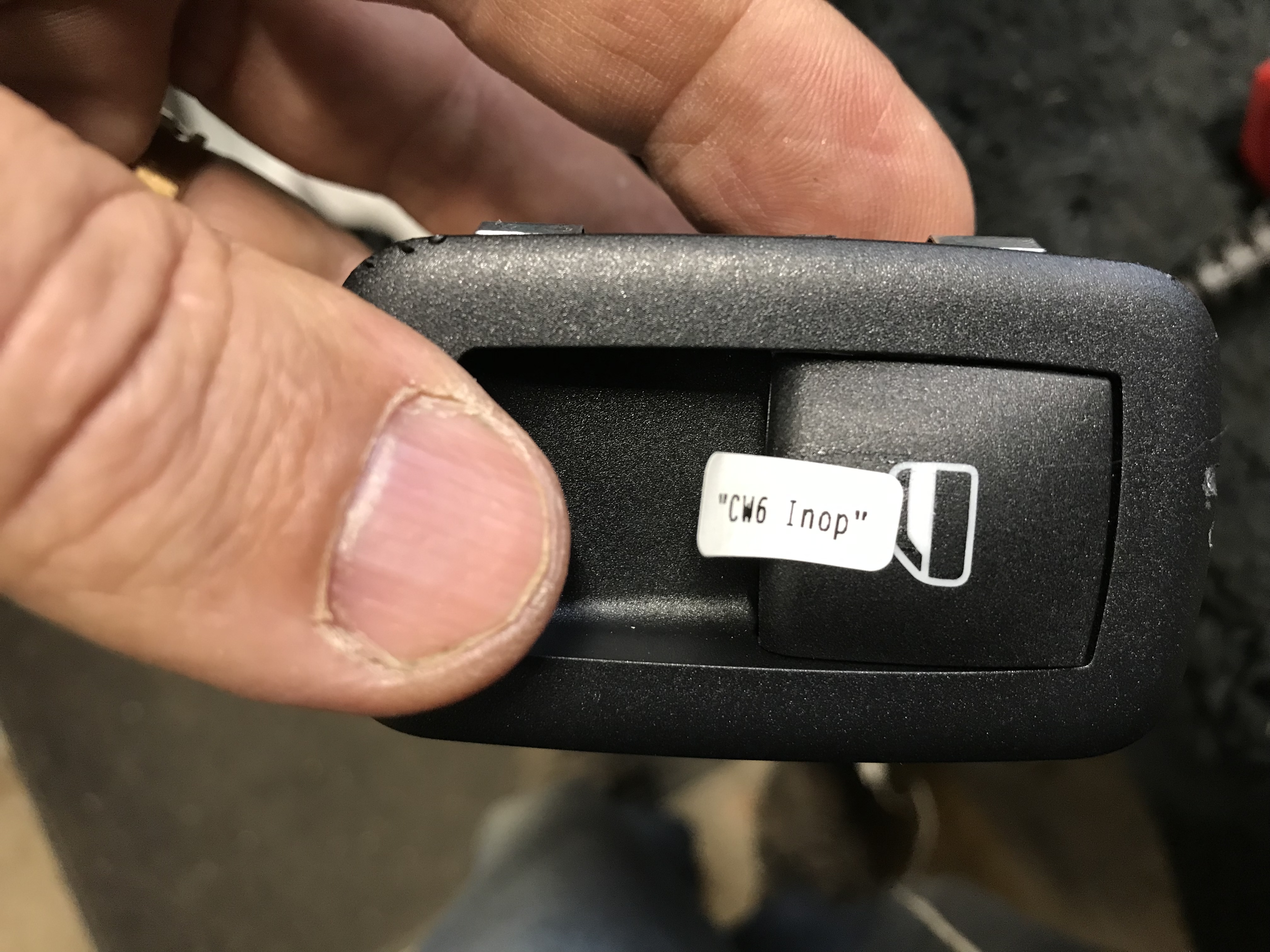

* Rear doors now have functioning handles, locks, window switches (almost)

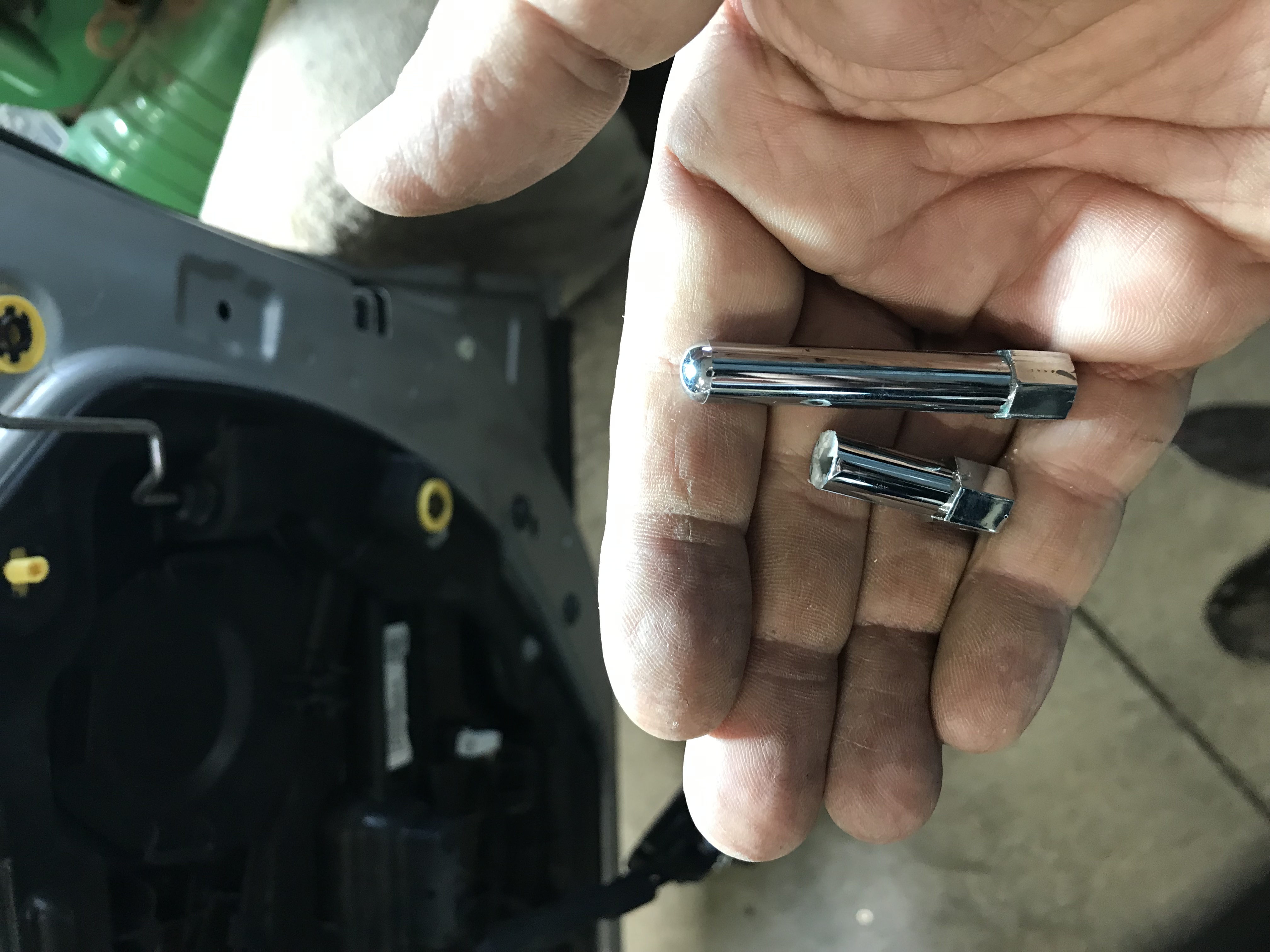

This car had the door cables and lock mechanisms in the doors, and the door handles in the glove box
Rear door lock buttons were cut, so I fetched the front buttons from the parts car and installed them
Window switches were inoperative. They have circuits in them and the windows will not go down even from the driver door controls unless these are installed. I ordered one and installed it to confirm, and the other is on the way
Rear door handles were quite easy to install.
Once the other rear window switch arrives and is installed this will be done

RR window switch arrived and is installed

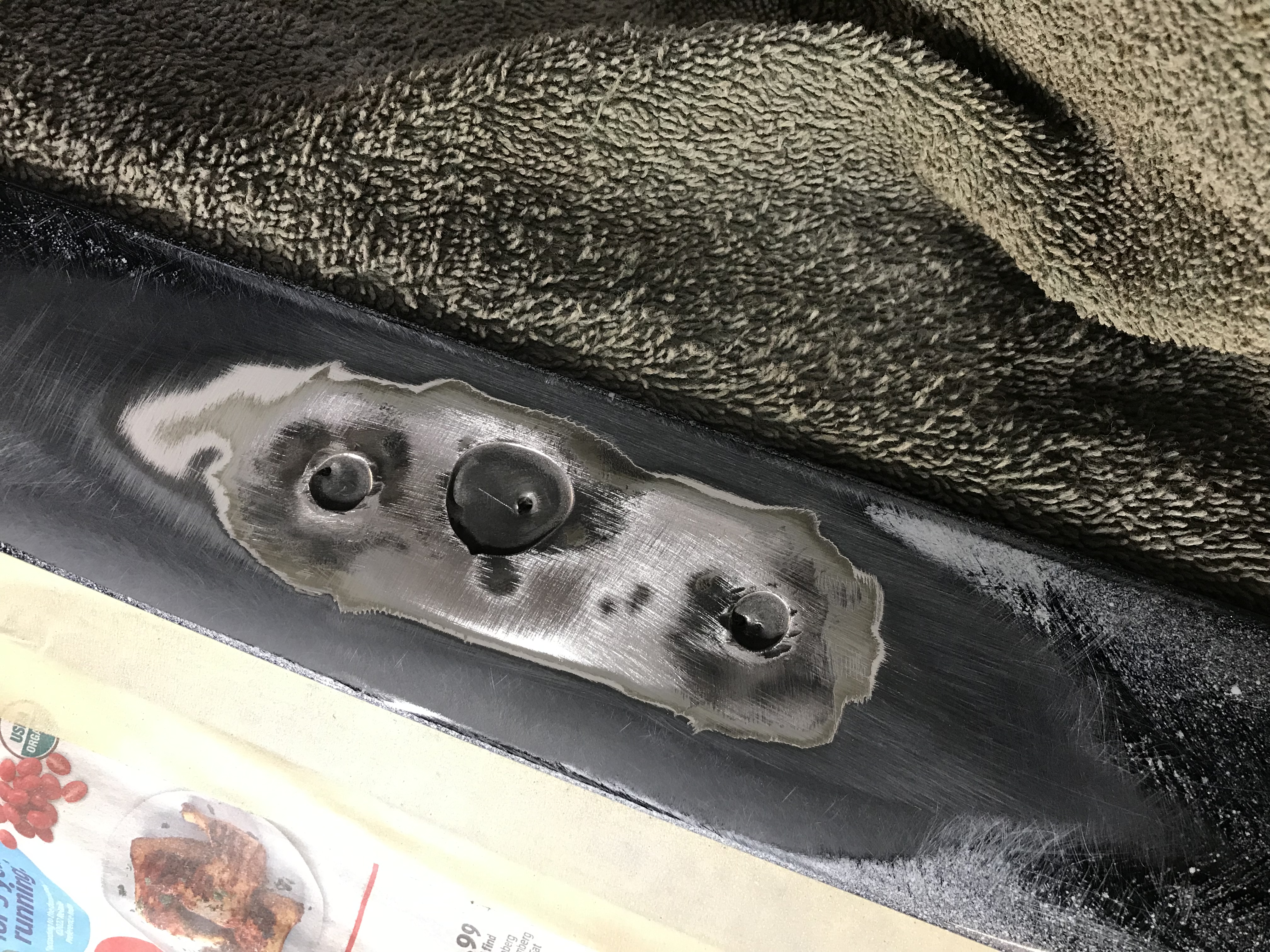

- Fill the holes in the A-pillar from police spotlight. Fabricated some metal pieces, and secured them on the inside of the pillar using metal bonding adhesive. Covered that with fiberglass reinforced body filler. Still need a little more shaping with glazing putty
