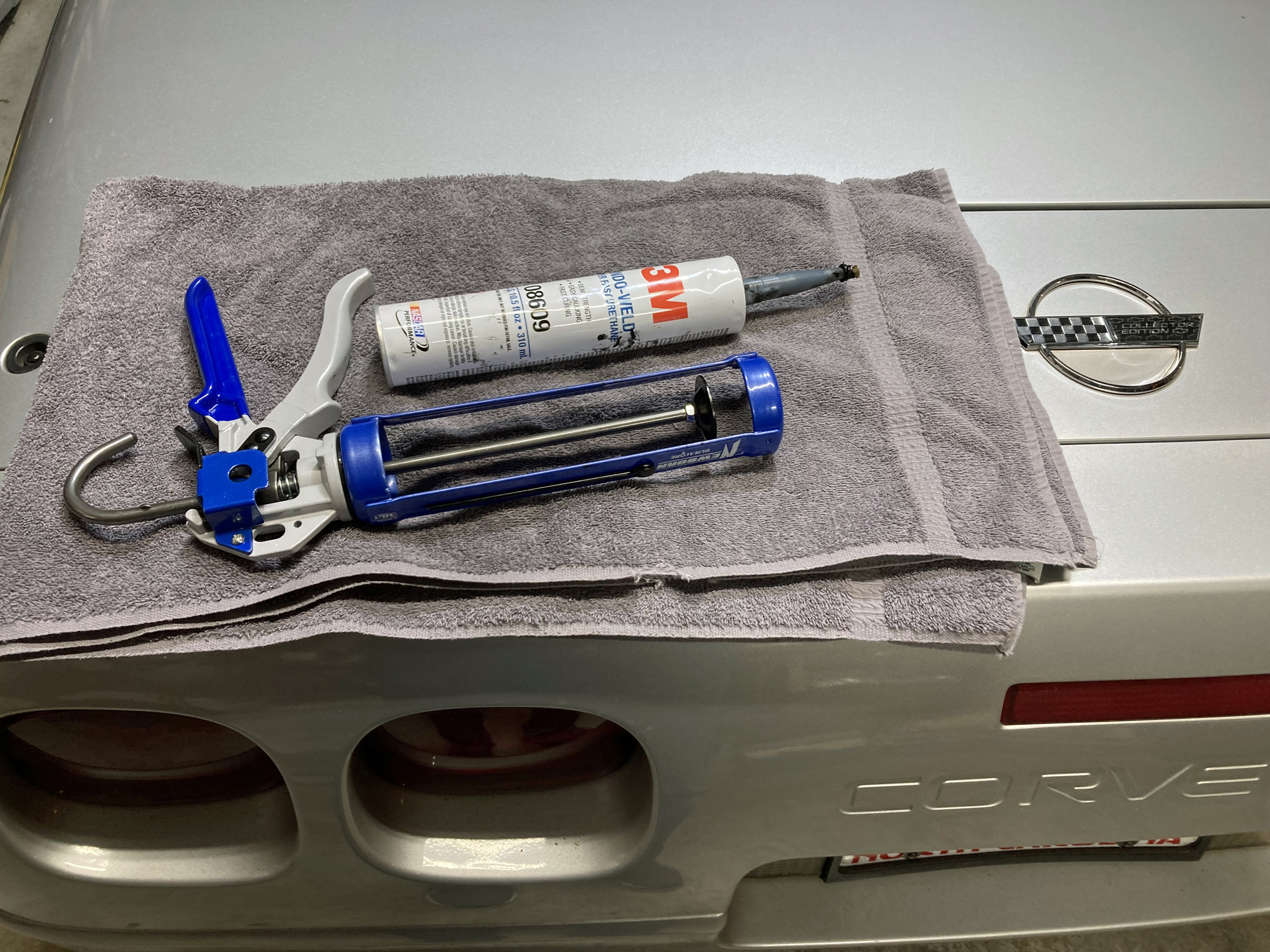

Since the LT4 is running like it should, I'm branching out to other things that need my attention. The back window fell out last Spring when I was on my way to the tuner guy and fixing it has been a priority. But, since the car was not running, it didn't matter. Now I want to go out and enjoy the warm Fall weather so I started the job of re-installing the glass rear window of the convertible top. I plan to do the job in two stages because I only bought 6 clamps. When the adhesive cures tomorrow, I will work on the bottom of the glass.

I have finished reattaching all the edge bindings on the roof where the stitching had come apart. My first thought was to stitch them myself, but after I used the 3M Window Weld urethane to reattach the back window and I saw how strong the bond was, I decided to try it instead. So far I'm pleased with the results, but time will tell. In the mean time, the roof badly needs a cleaning. I'm waiting for a reasonably warm day to get that done.

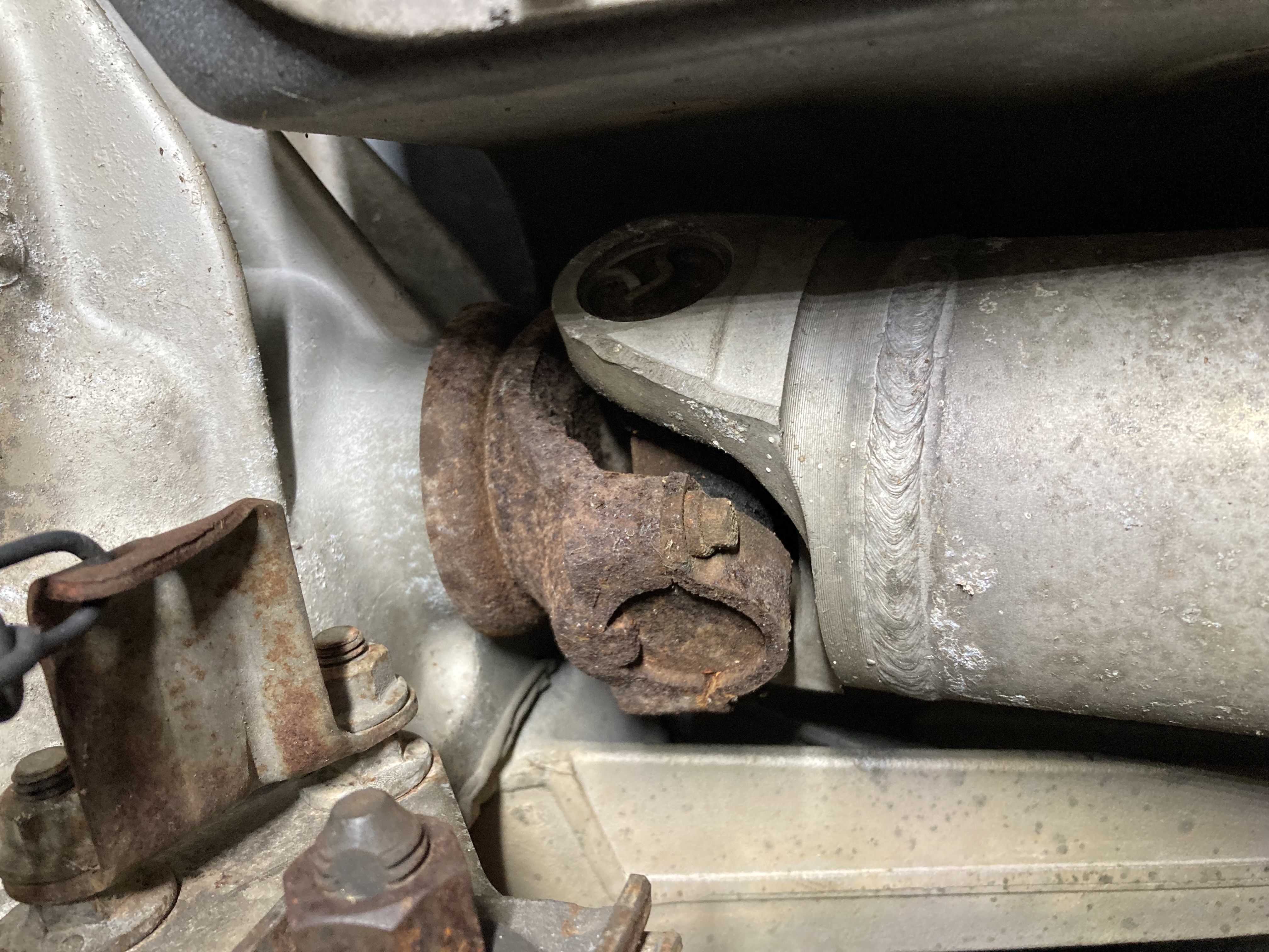

The digital display went blank again, so I don't know the actual miles on the odometer. I guess it's time to increase the priority of this item on the todo list. I backed Silvia out of the garage yesterday to apply protectant to the rag top. What a huge transformation!! The top looks great now. That's when I noticed a pool of oil on the garage floor. I didn't taste it like Derek does on Vice Grip Garage, but I smelled it and it has the smell of 90W gear oil. The rear mufflers and undercarriage are dripping with it. Stay tuned while I get her up on jack stands to see what's going on under there. Too bad I don't have a friend like Smoker in the neighborhood.

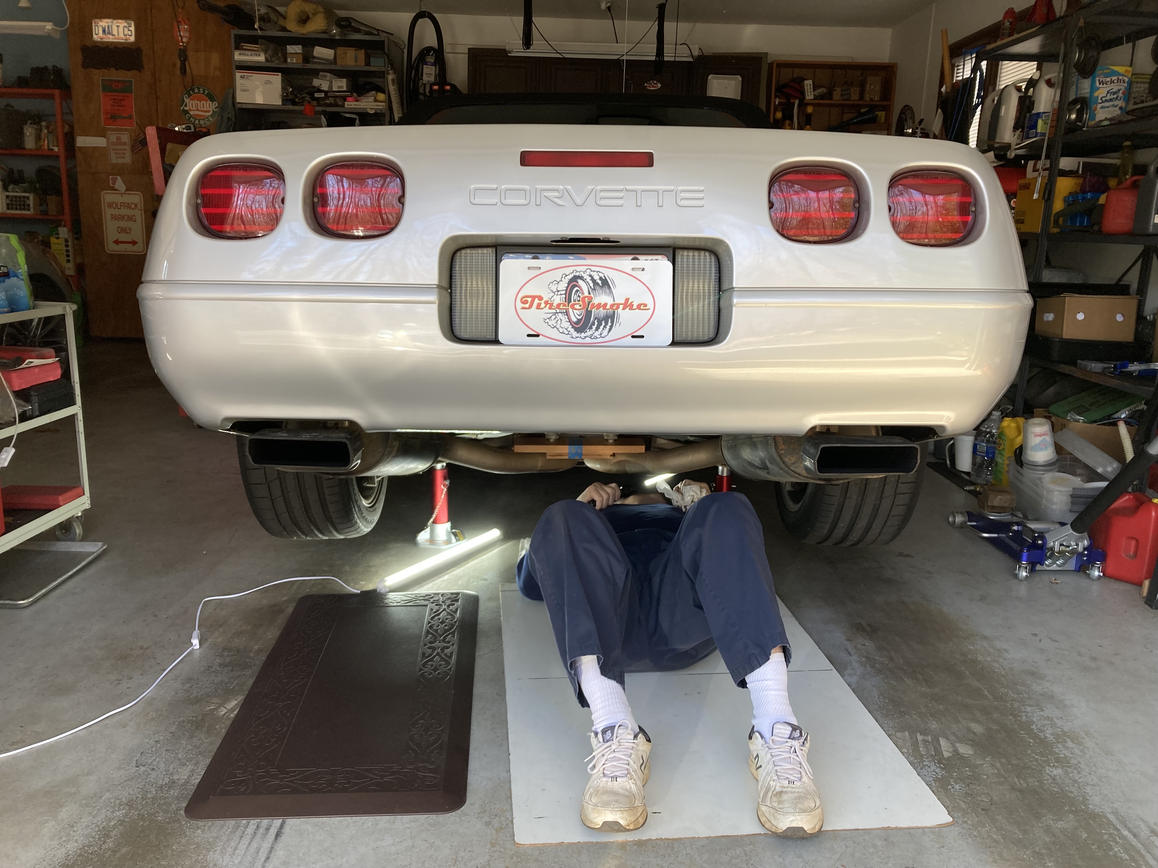

I put Silvia up on jack stands and took a look underneath. Evidence points to a pinion seal leak. Both axle seals are dry.
It will be very tight working up in there. The service manual states a torque of 200 lbs-feet for the pinion nut. I'm not sure how in the world I'm going to manage that. I only weigh 165 pounds!Re: 1996 Collector Edition Corvette
This thread from Corvette Forum provides just about all I need to get my arms around this pinion seal job (if you are curious and want to read it):https://www.corvetteforum.com/forums/c4 ... n-nut.html
We had a near 50° day here in Raleigh yesterday so Maverick came over to check out Silvia's rear end leakage.
He agrees that the pinion seal needs to be replaced. I guess it could be a lot worse.Re: 1996 Collector Edition Corvette
You may want to check the tolerance for free play in the pinion and then measure yours to confirm this is just an old seal wearing out and not an old bearing wearing out causing a seal to fail.
Yep. That occurred to me. Pinion seals don't usually fail like this. That was Maverick's thought, too. Have you ever checked this tolerance? Is it just an up and down push/pull to see if movement is detected?
