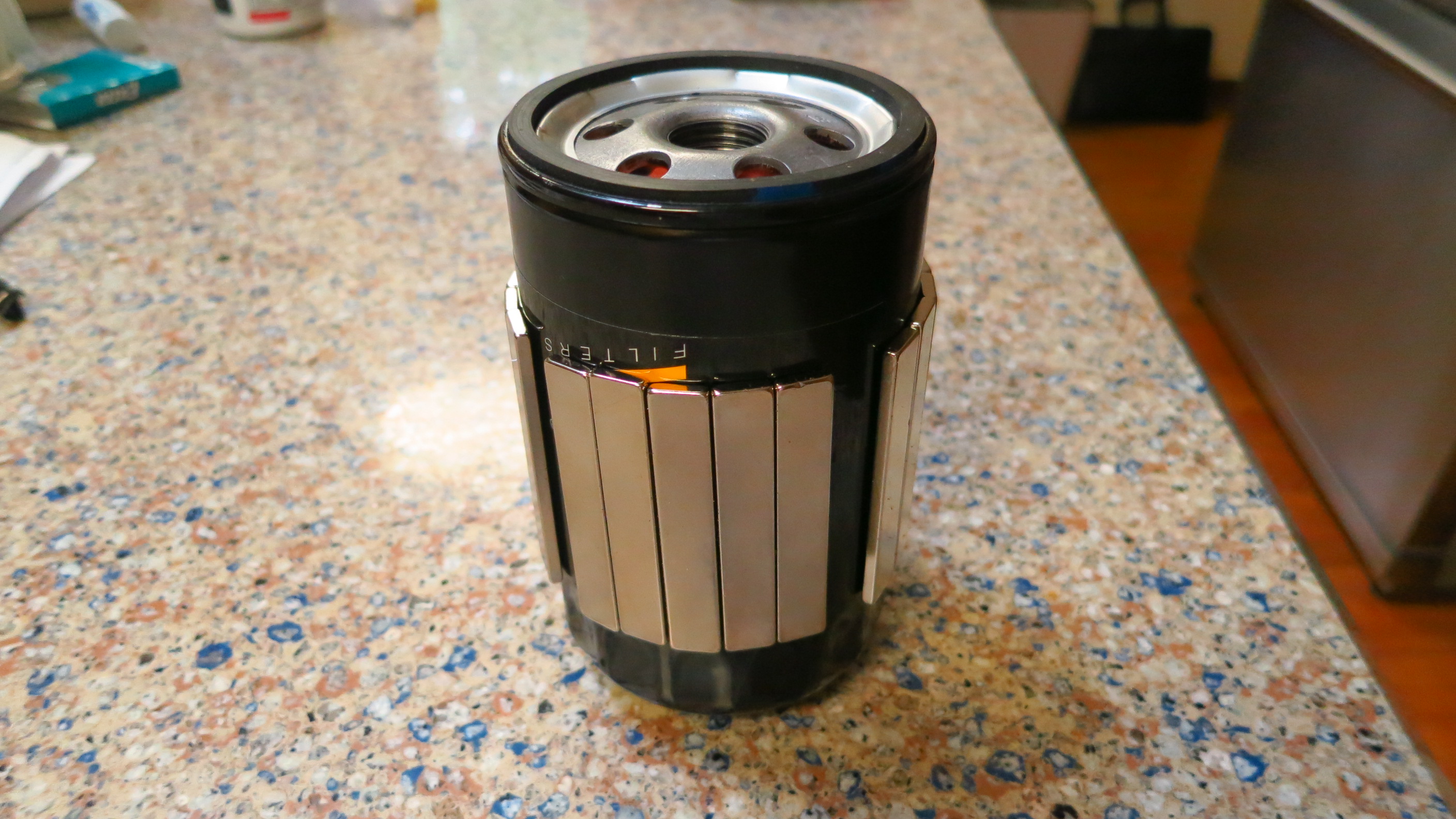

I started another deep dive into the LT4 today. Antifreeze and oil are completely drained, starter is off in preparation for taking the oil pan down again. I had a couple of notable surprises. Oil drained from the oil pan and filter was noticeably free of the larger glistening particles and there were none on the magnetic oil drain plug. I cut open the oil filter and examined it for metal particles. They were relatively few and far between, and they were smaller, but at this point, not very worrisome. I'm looking forward to seeing what is in the bottom of the oil pan. Maybe next week.
