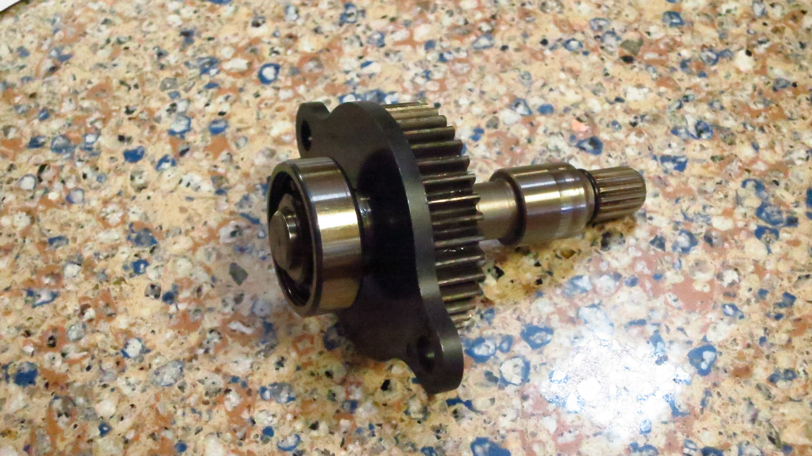

Yesterday afternoon, a few minutes before Maverick was due to arrive, I was staring down at the timing set before me and just by chance I grabbed the oil pump drive gear shaft and wiggled it. When I did, I heard a scritching sound very similar to that which we heard when the engine was running and in the same area of the sound. Since the bearing is pressed into the block, I was surprised to feel some movement of the shaft. Remember that this was the shaft that went to the machine shop to have the bearing and the gear pressed off and the gear replaced with the one that matches the new timing set. When Maverick arrived, we pulled the water pump drive shaft from the block and checked out the bearing. Although it had some wiggle to it, It felt smooth and quiet. :shock: Also, there were NO steel chips anywhere to be seen. :?: So where did the steel chips come from if this was the source of the noise? Thinking about it, if the bearing was dropping the chips, they must have been dropping into the lifter galley because that's the only open side of the bearing. Were they washed by the flow of oil into the oil pan? I pulled the oil pump pickup and looked at the impellers and saw some evidence/scars of steel chips going through, although there were none in the filter element when I cut it apart. This bearing, I believe, is the 103K mile original. Thinking back, it was a foolish decision on my part to reuse it, although, at the time when I assessed it, I believe there was no play or noise coming from it and it was very smooth rolling. Perhaps it was damaged during the work at the machine shop.
At this point, I have ordered a replacement bearing from Amazon https://smile.amazon.com/gp/product/B00 ... UTF8&psc=1 and I will take the shaft assembly back to the machine shop to get it replaced. I'm not completely comfortable, yet, on how to explain the lack of steel chips in the area. Maverick suggested cutting the old bearing apart to assess the damage and to understand more about this puzzle. I plan to do that.
Re: May have found the problem
Now I'm convinced that the water pump driveshaft bearing was the source of the noise and the steel filings in the oil pan. After I removed the driveshaft from the block, I flushed the bearing with brake cleaner and some filings came out. Not very much, but they were visible. I had a new bearing pressed on yesterday so I cut open the old bearing and could see that the races were badly pitted. So that part of the case is closed.
So now that I'm thinking about starting reassembly, I began to wonder how this bearing is lubricated during operation. It sits high on the front wall of the block just under the front lip of the intake manifold. The water pump side of the bearing is covered by it's retention plate, but the other side is exposed to the interior of the lifter gallery. I see no obvious path for oil to get to it. I guess it could get misted with oil mist in the lifter gallery. I have done a lot of searching online, but found no mention of lubrication for this bearing. I wonder if I should fill it with grease like a wheel bearing. I plan to pose the question on a forum to see what I can find out.
The other issue is that of the filings in the oil pan and what, if anything, I should do to protect the engine. My main piece of evidence is that fact that there were no filings in the oil filter. I assume that is due to the fact that the engine was not run very long. My inclination is to just put everything back together, clean out the oil pan, install a new oil filter and move forward. There might be some residual filings in the lifter gallery that have not been flushed down the oil drain path, but I think a new oil filter should catch them. I also thought about pouring a quart of oil through the bearing hole in the block. Seems to me that it should help flush more of the debris down toward the oil pan. As always, your thoughts and ideas are welcome.
