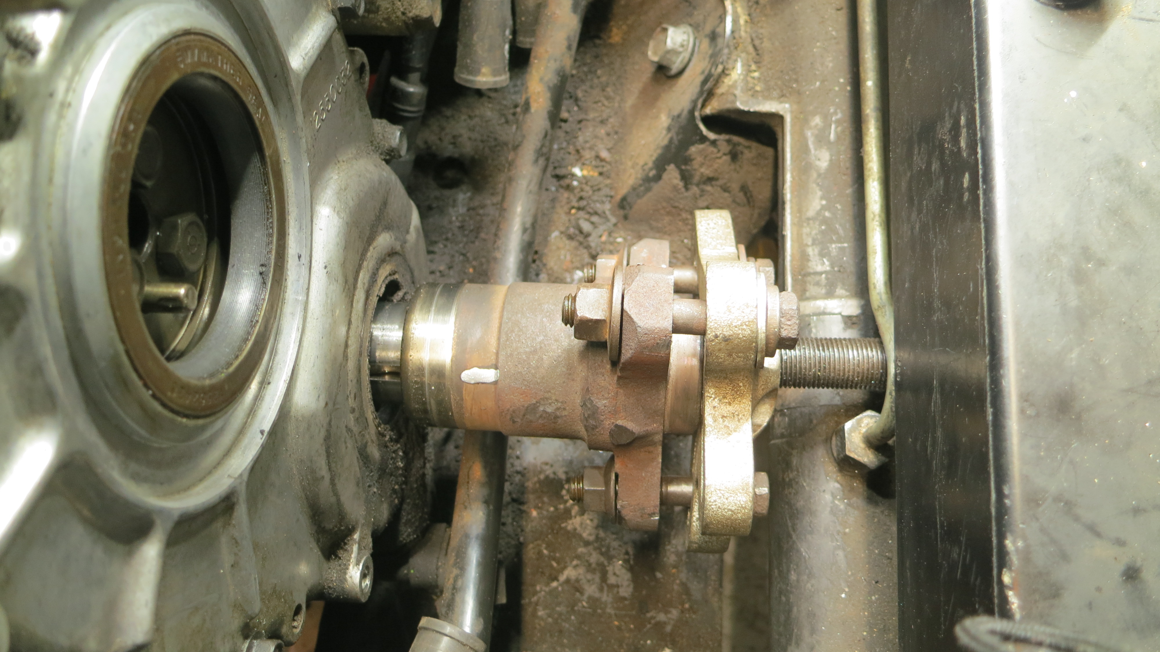

I was able to remove the balancer from it's hub. Unfortunately it is still trapped in place. I can roll it from side to side to work on the Opti-Spark, but I may have more work to do to take it out and slip my new balancer in place. Right now my short term goal is to change to the new opti unit, install the old balancer on the hub and run the engine without a water pump in place to test the opti.
This tool enabled me to pull the balancer: https://smile.amazon.com/gp/product/B01 ... UTF8&psc=1. I had one heck of a time making it work, though. First, it would not fit between the balancer and the frame member. Fortunately, each of the 3 grabber arms is pinned to the body of the puller with easily removable pins. I figured out that, to get the hooks into the damper slots, I had to completely disassemble the puller and insert each of the puller grabber arms into place first. Then I was able to drop the body of the puller into place and insert the pins to reassemble the puller. But now when I screwed the pressure screw in with the shortest rod, it was way too long and wouldn't work. I had to make my own short rod from a 5/16 bolt and a half inch drive 3/8 socket with a nut inserted and glued into it.

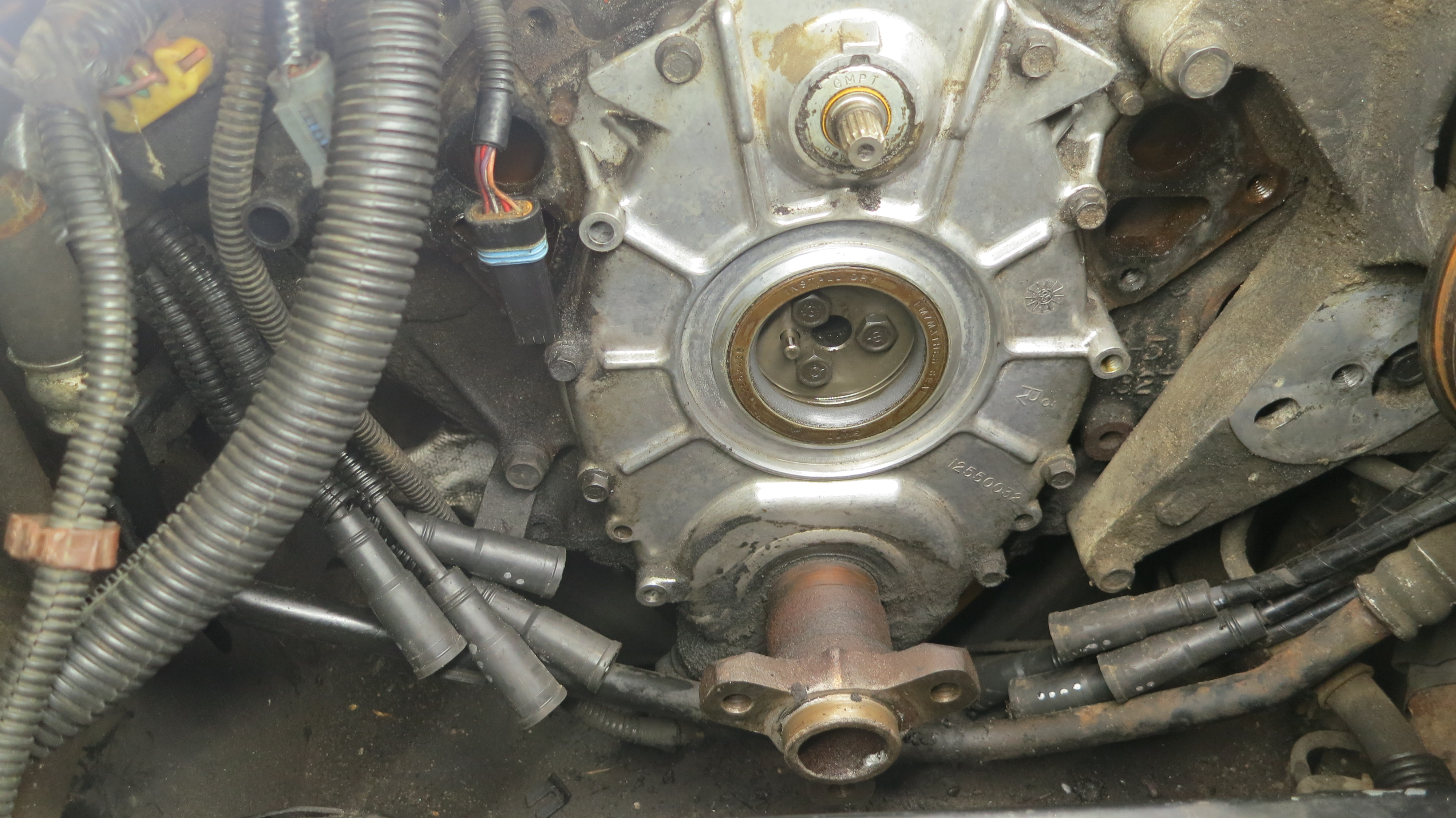

This is a quiz.
Two things are missing in this picture. what are they?
Answer: First is the balancer from hell. You can't see it, but it is in here.
Second is the original Opti-Spark.
Silvia finally released her grip on the trapped balancer when I removed one, and loosened the two remaining bolts that holds the rack and pinion assembly to the frame. What a struggle! But, after an hour or so in the electrolysis bath, I was able to get a better look at the condition of the balancer. It actually looks quite good. I could see no degradation of the rubber. Looking back, I'm really glad I didn't go through with the purchase of a replacement. Furthermore, I understand why I was not able to install the original size serpentine belt. I had to buy one one size longer. It was due to all the buildup of rust in the grooves of the balancer. Now, I suspect I will be able to use the original shorter one.

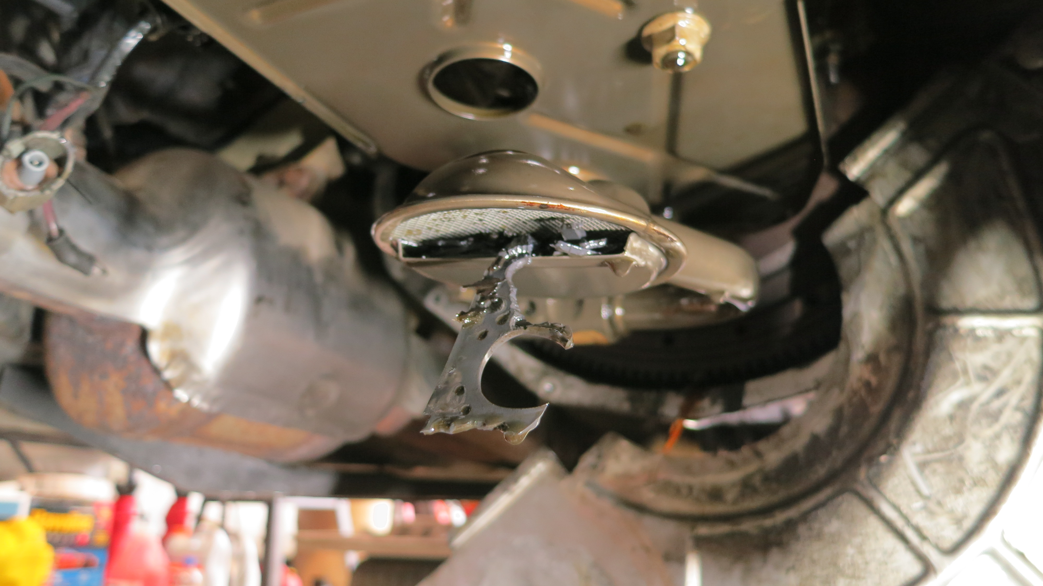

Maverick came over yesterday to help me with removing the oil pan and the timing chain. First the oil pan. I had all the bolts out and everything out of the way, but it was caught in the front at the cross member. While Maverick rotated the crank I was underneath wiggling the oil pan and it came loose slick as can be. Once I set it aside, this was staring me in the face.
I believe it is silicon rubber gasket scrapings from some past jackleg work. I pulled this out of the oil pickup screen.
There is more in the bottom of the oil pan. That stuff was in there the whole time I've had this car, including the dyno runs. There is no way I was getting full oil flow to the engine. I'm so glad I took this time and considerable effort to pull the oil pan.
