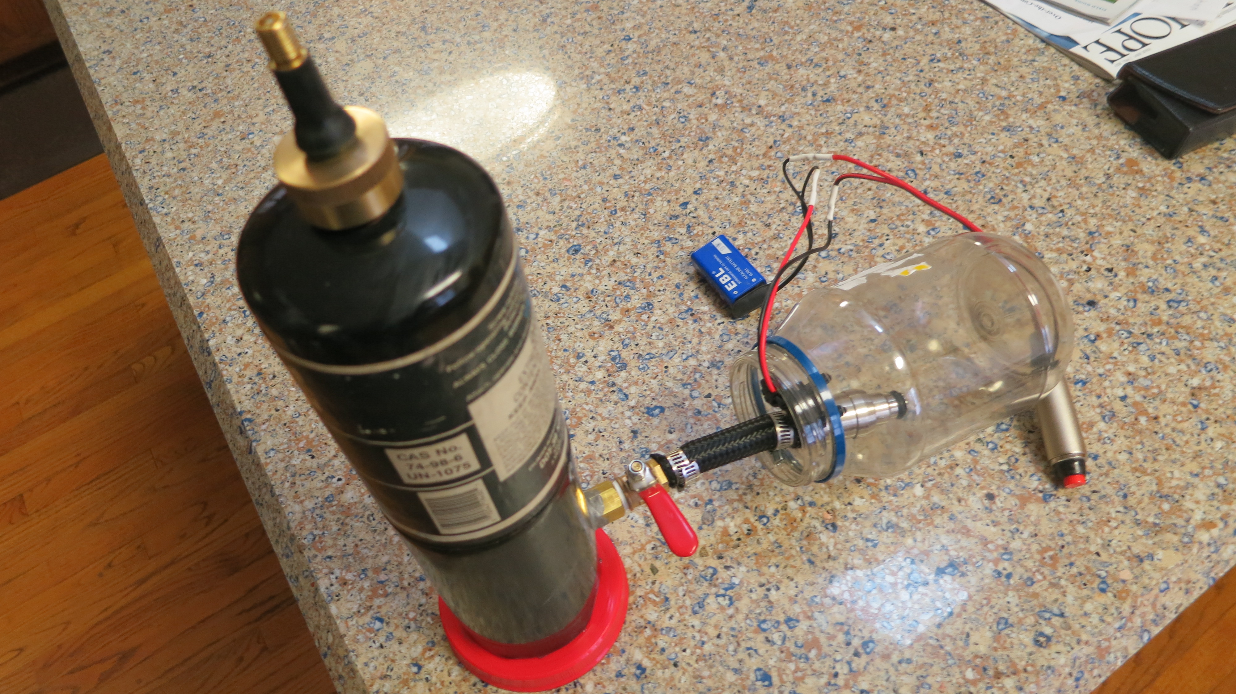

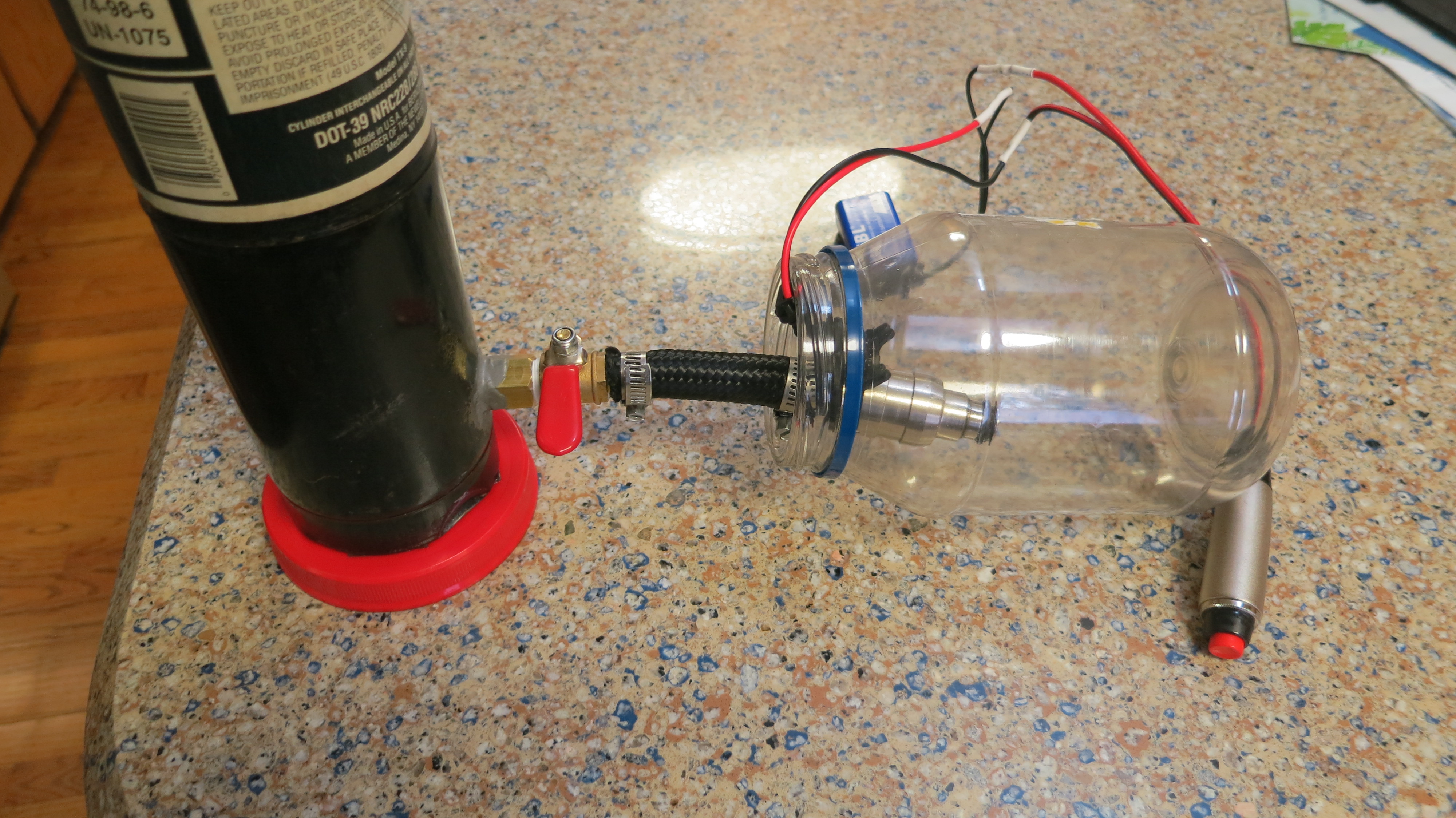

Another successful day today. I set up my home-made injector cleaner/tester and I'm pleased with the outcome.
I partially fill the cylinder with injector cleaner and then pressurize it to about 48psi. Then I turn on the main petcock and listen for any leaks. Then I hit the button to energize the injector solenoid and watch the pattern through the transparent jar. The first injector I looked at was from #6 cylinder which displayed a sooted spark plug that was different from the rest after the flooding incident. The spray pattern was not uniform so I held the button to clean it out until the pattern returned to normal. Then I tested a brand new injector to see what the pattern should look like. Finally, I tested the one from #8 cylinder. It, too, had a non-uniform pattern and, again, I was able to run the cleaner through it until the spray pattern returned to one that looked like the new one. From here I plan to test and clean all eight injectors to get the fuel system ready for installation when the time comes.

Thats slick, Walt! I love how its basically self-contained with 9v battery.
I used this guy's idea: https://youtu.be/twXhiVLb9H4
