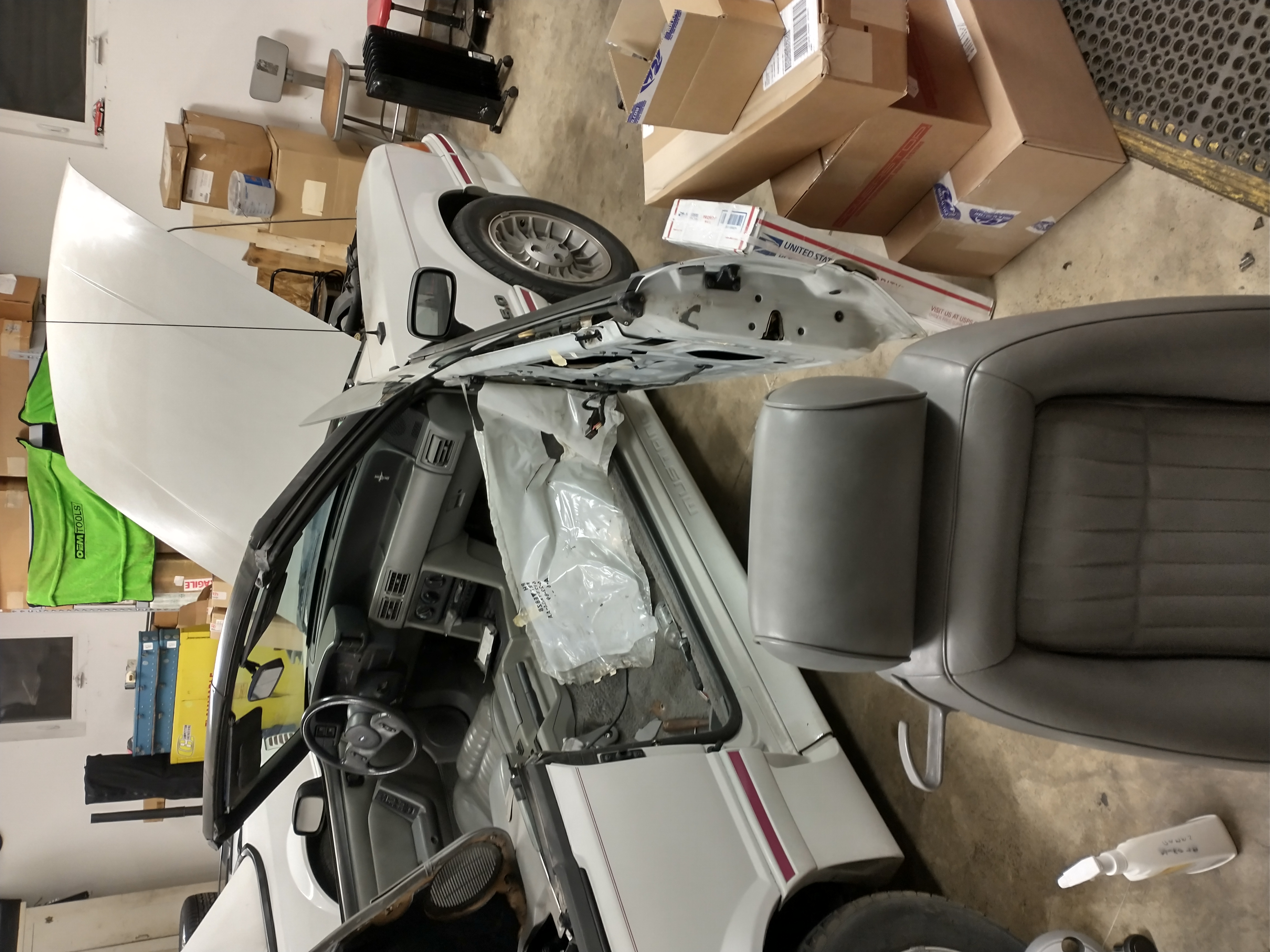

I dug into the gray Mustang this weekend. I had a bunch of trim pieces laying all over the place, a couple big mouse nests to clean up, and other misc things I wanted to do. And as it turned out, the passenger's door wouldn't open up.
The first thing I did was lube every hinge and lock. Then I topped off the power steering fluid and put new wiper blades on. Kevin left the rear seat bottom loose as there was a BIG nest under that, so I got out the shop vac and took care of that and the one in the trunk. I reinstalled the rear seat and treated the leather seats.
I went into the trunk and took all the trim pieces out and also the spare tire to give it a good cleaning. There was a aftermarket CD changer laying in there and wired so I removed it and all the wiring to the front and under the dash. Now the trunk is put back to normal and looking and smelling decent again.
I did try the power too and that seems to work as designed. The top itself is in mediocre shape, but it does function and the rear glass comes out like it's supposed to. I lubed ALL the pivot points for the top too.
Then on to the passenger door. I had to pull the seat so I had access to the door skin. I could see someone tried to pry the door open from both the outside and inside at some point. It took a lot of lube and some careful tapping and whatever was holding it from locking and moving broke free and now functions correctly. I will reinstall all the parts this week, and then have to do this same thing to the driver's door as it's stuck in the unlocked position.
