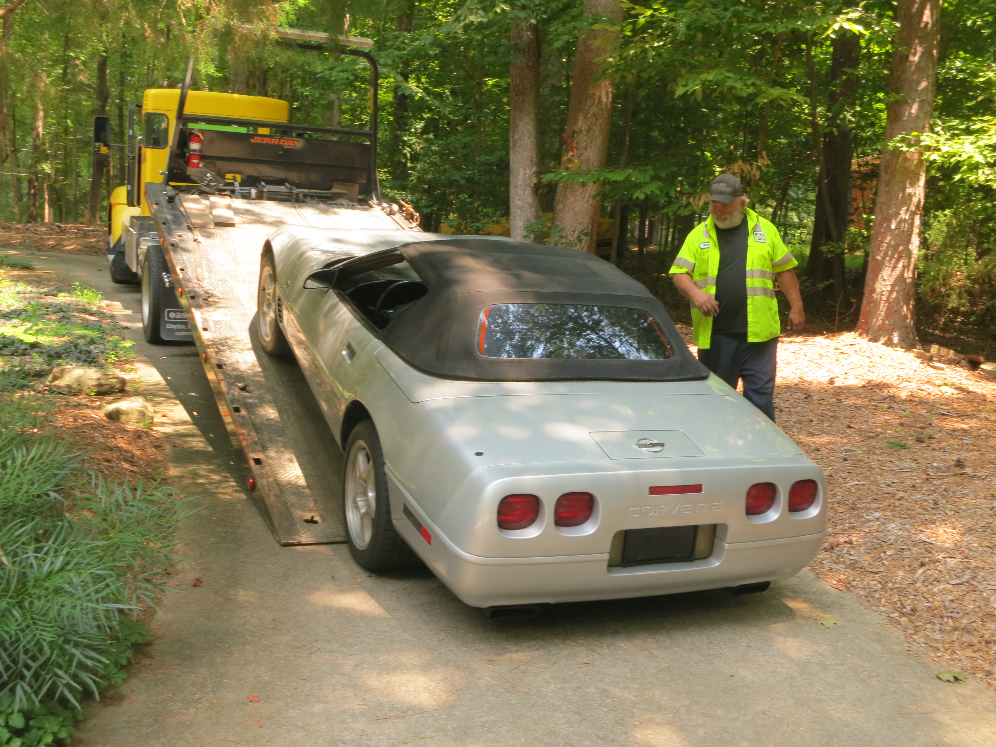

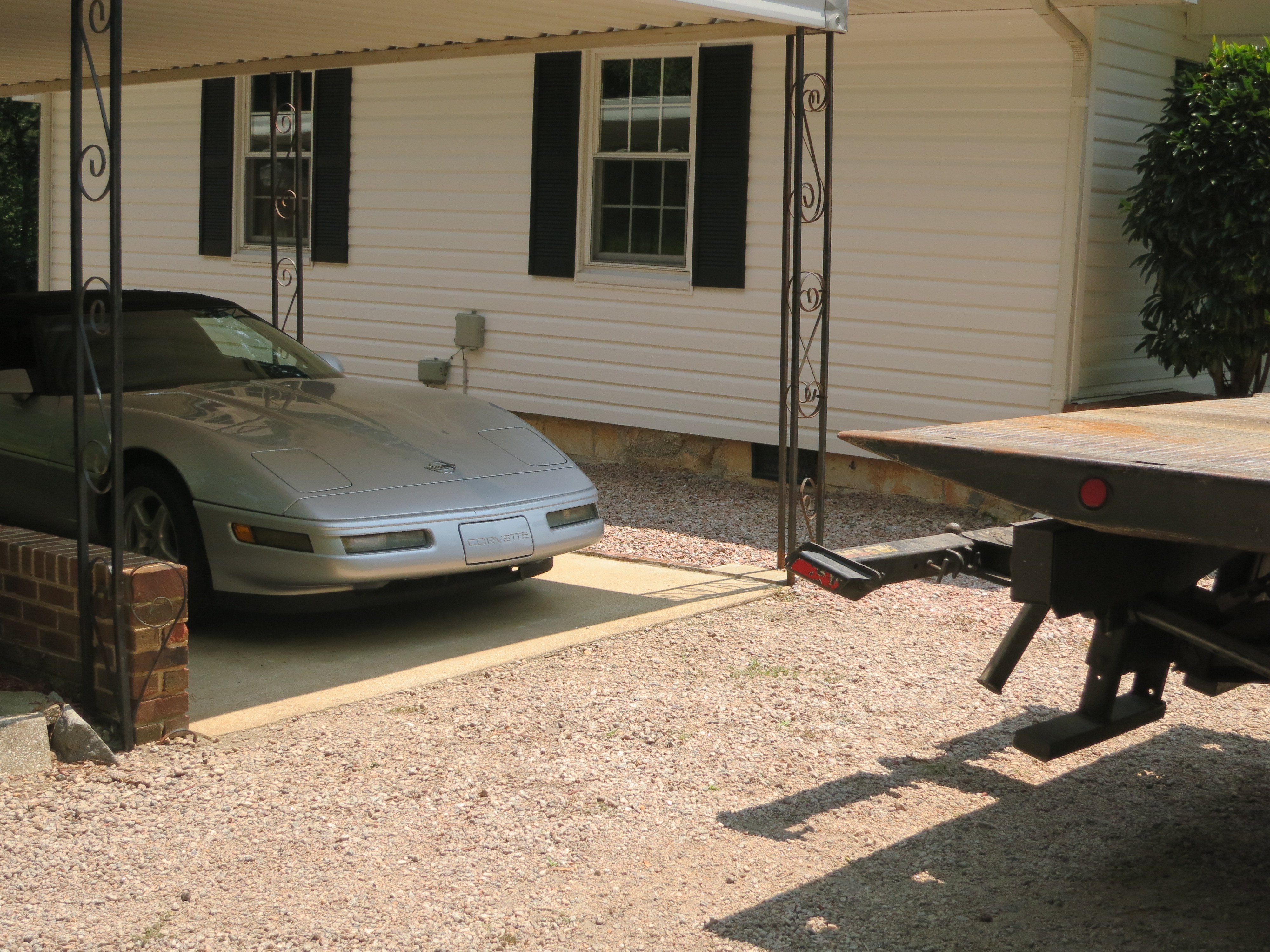

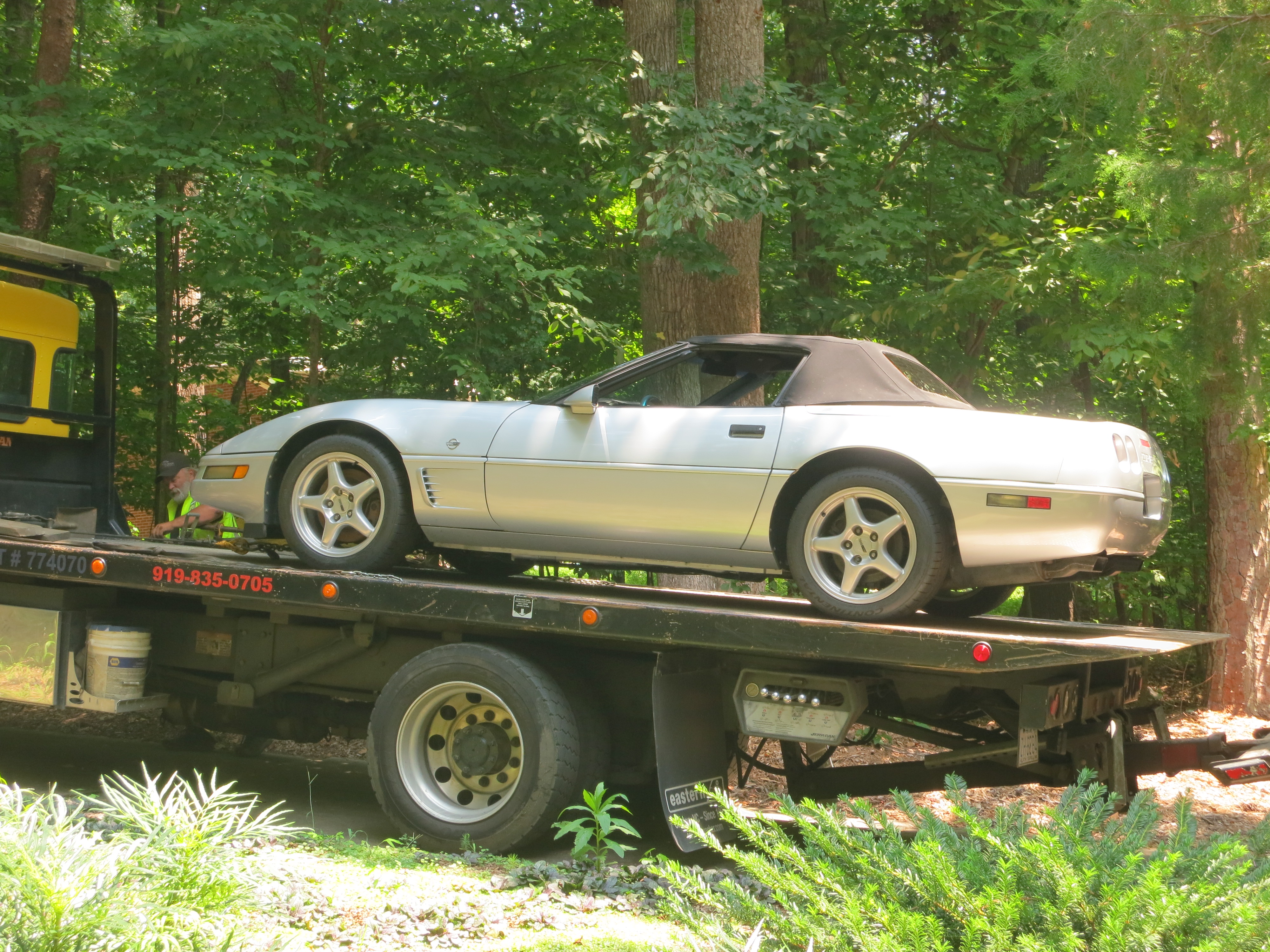

The seller tells me that it was running well 3 years ago when the clutch slave cylinder gave out on the road. It was brought home on a rollback and it has been under a cover in a garage for 3 years. CarFax tells me that it has logged only 742 miles in the last 14 years. It has almost 103K on it now.TireSmoker wrote:thats great!! So, what does non-running entail?

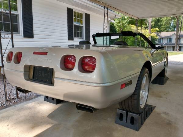

Here is the ad text:
Collectors Edition C4 Corvette convertible. Sebring silver, black leather interior, LT4 (Grand Sport motor), ZF6 manual transmission, and selective ride control. This car was packed with all the latest goodies of the day, and is the last of the corvettes before they switched to a transaxle.

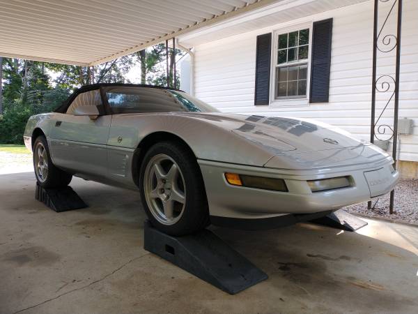

The car was parked 3 years ago due to a failed slave cylinder, this is an external slave and can be replaced without dropping the transmission. The car has sat in the garage under cover since then, it has recently been moved to the carport and put up on ramps.
The car has new continental "extreme contact" tires 275/40ZR17 front and rear (matched size)
Brand new interstate battery, fresh oil change, a new air filter, and a set of plugs and a new serpentine belt in the cargo area. Will need the tank drained and whatever your favorite long term start-up procedure is, I am moving and no longer have the time or space to finish this up.

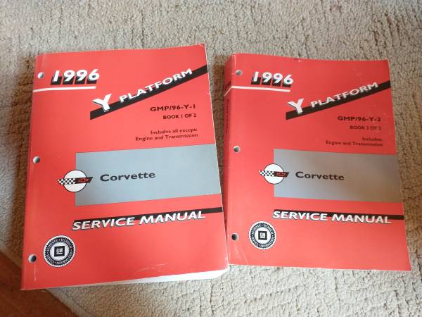

A VERY clean set of 1996 Corvette Factory Service manuals are included. This is the only set of manuals that cover the OBII C4 corvette.

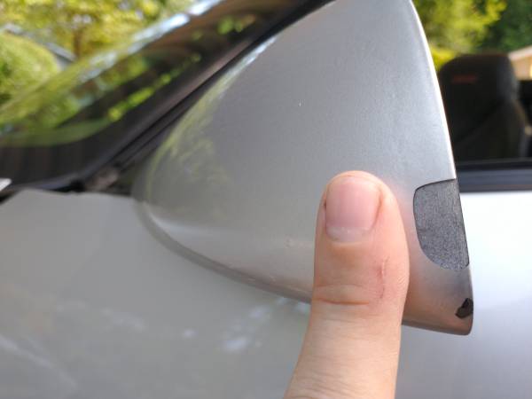

3-small paint imperfections that I have seen, one small scratch on the nose, one chip on the drivers side rear view mirror, and paint work on the battery cover panel (typically damaged by unknowing mechanics).
Headlights need new pigtail connection to function (I manually flip them up and down for the few times I drove the car at night)
Offers not made in person will be ignored, bring cash, bring a trailer, leave with a clean, clear, notarized title.

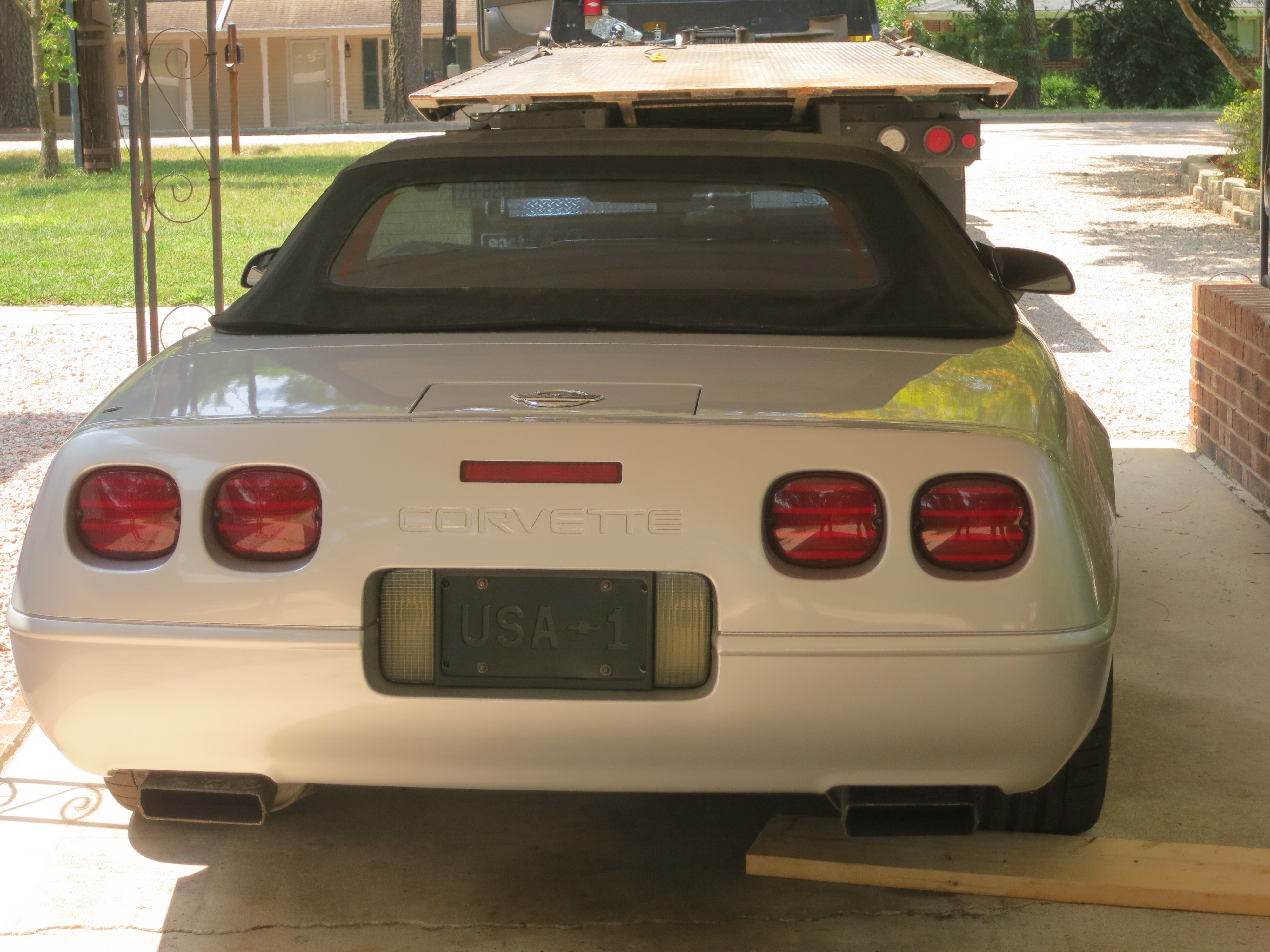

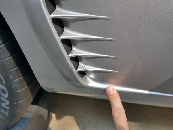

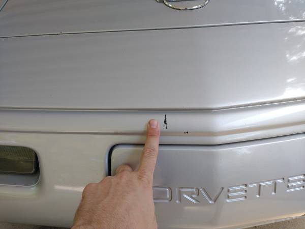

Carlisle is an unlikely hope. There's not enough time for me to get it running well enough and learn to trust it enough to travel to Carlisle. Maybe next year.
I siphoned the remaining gas from the tank yesterday. The gauge showed 3/4 full, but I pulled out only about 7 gallons of the 20 when full, so the gauge is reading incorrectly. Also, I saw a small amount of rusty sludge on the siphon hose when I pulled it out. I learned through YouTube videos that pulling the pump/sensor assembly is a piece of cake. I plan to remove the assembly and take a good look down into the tank and see if I can clean it out through the access hole. So now I believe that the sensor part of the assembly is bad. I don't know the condition of the pump yet. So it begins...

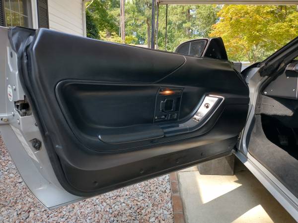

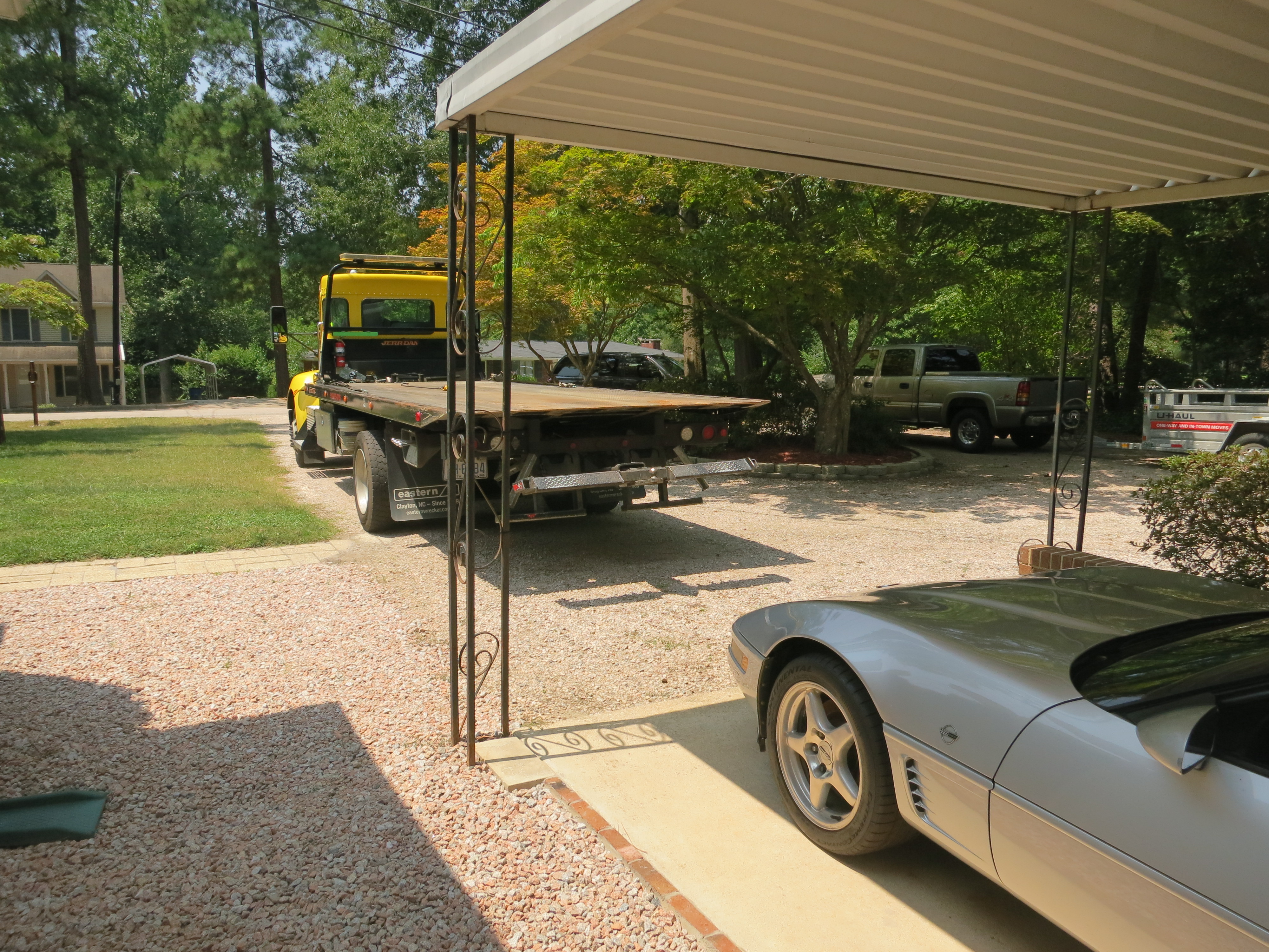

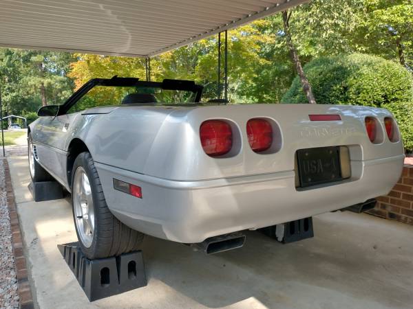

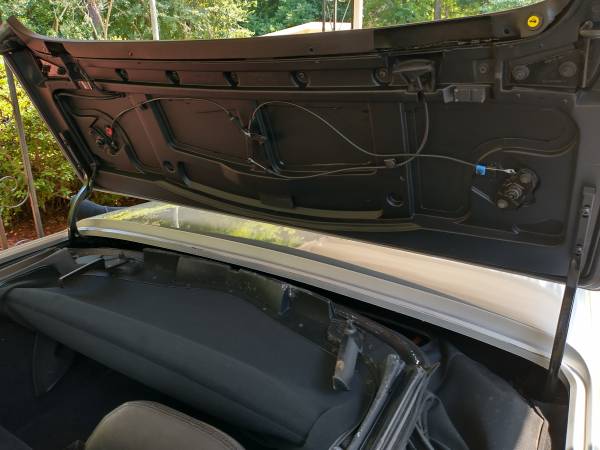

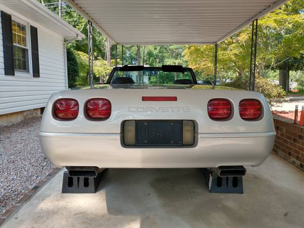

Also, I had saved a copy of the ad webpage before it was deleted , so I went back and pulled off the pictures most of you haven't seen. Here they are:

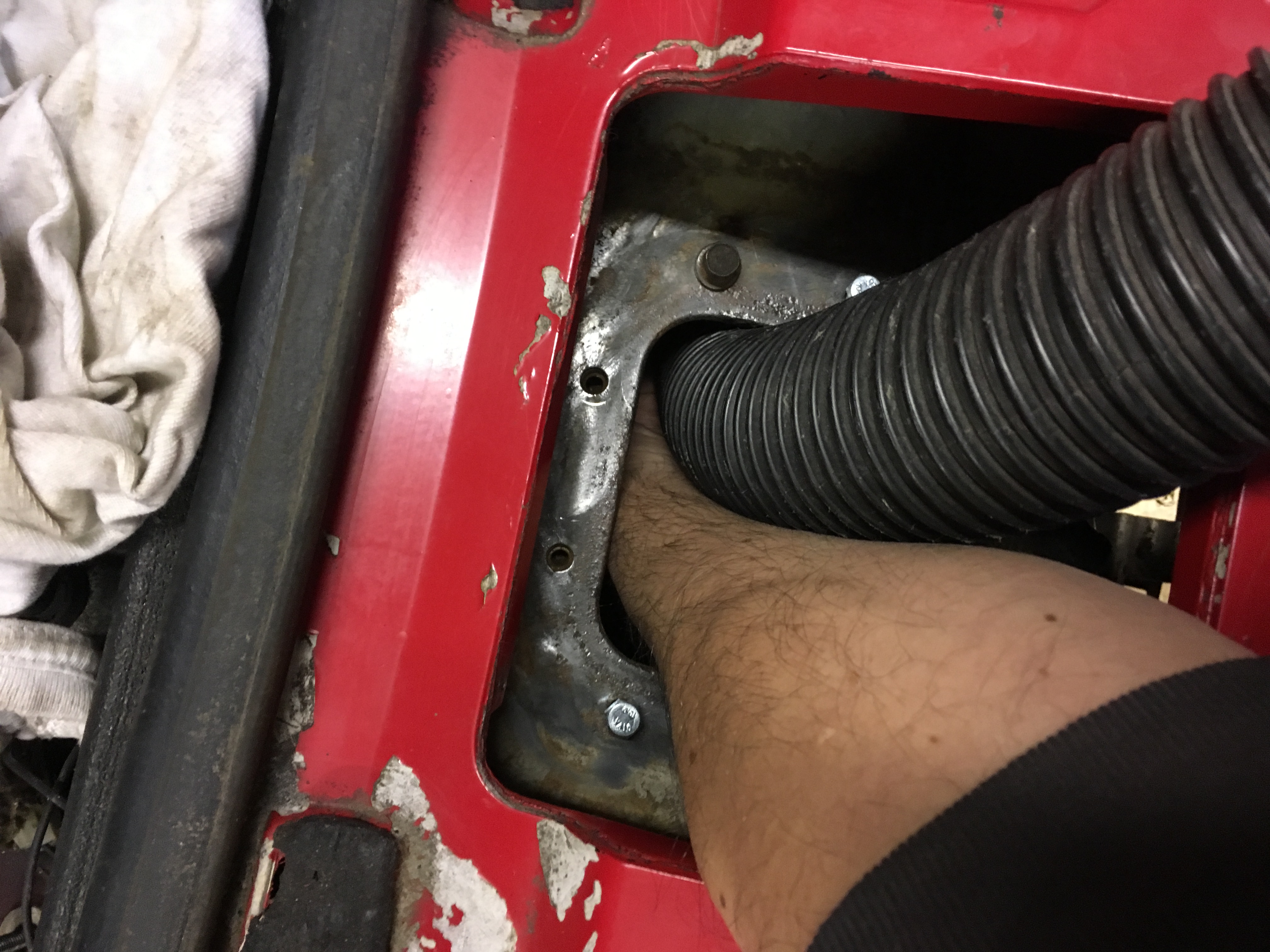

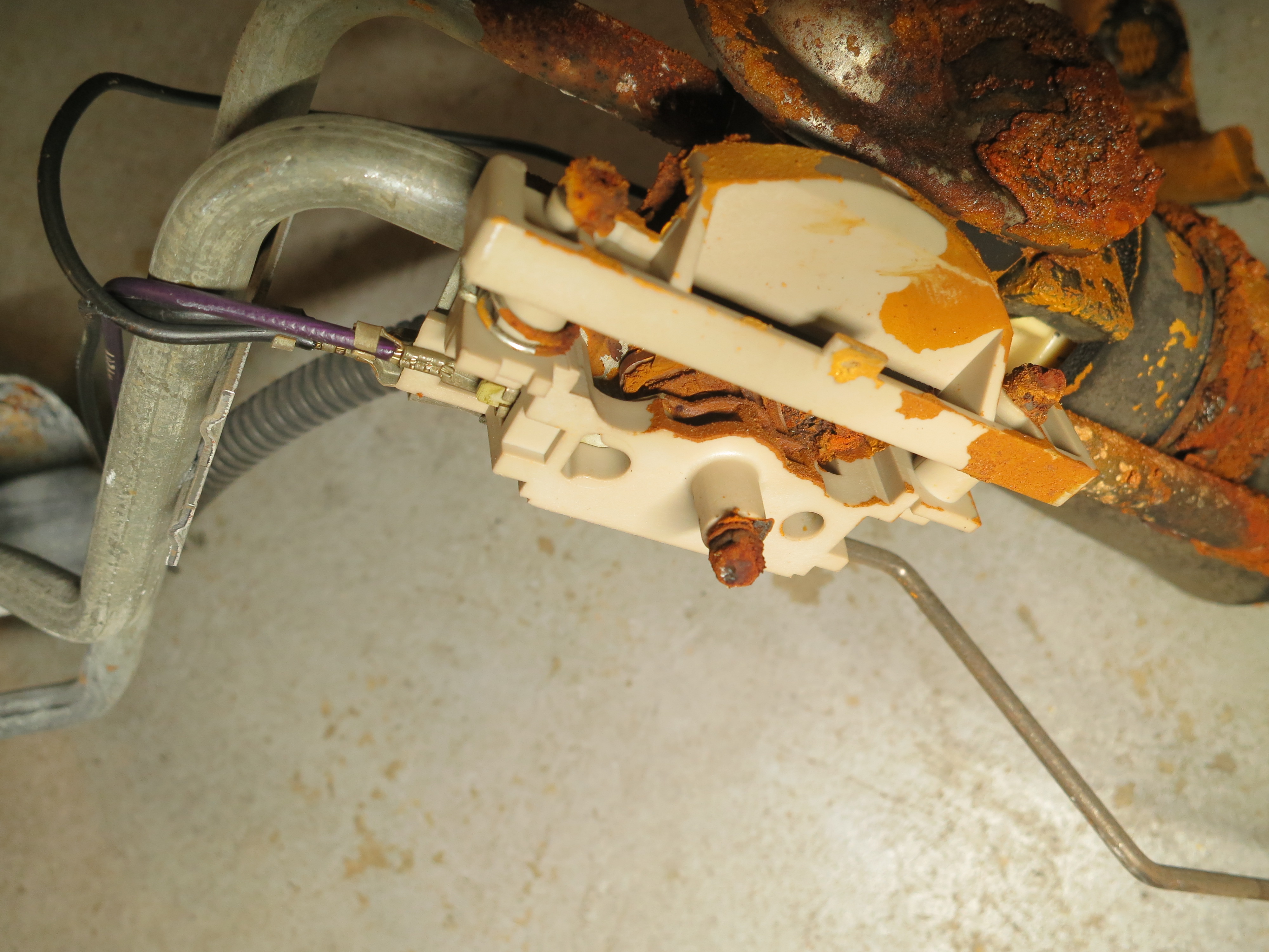

Yes you can clean the tank through the hole in the top after removing the fuel pump assembly. Once it dried out I got a shop vac hose in there to clean up the heavy stuff and the rest I did with paper towels and Windex
You may be able to clean up the connections on the fuel measure sensor. If you decide to buy a replacement assembly, please hang on to the old one I would like a spare.

I was wondering if it would be possible to get the sensor operating again. I think that may be all it needs. Have you ever attempted it?

As far as the sensor, yes I was able to get one of them working again. It had a break in the wire but it was near the end and I just put a small washer in the to bridge the gap to the open wire. It's just a glorified rheostat, so it has some bad or dirty connection somewhere. Best part is you can connect it outside the tank, and operate the float arm to see if it actually works. Mine would measure changes slowly (so it won't change when the gas is sloshing), so you'll have to be patient when testing it. Worst case if you break it you can get the whole unit.

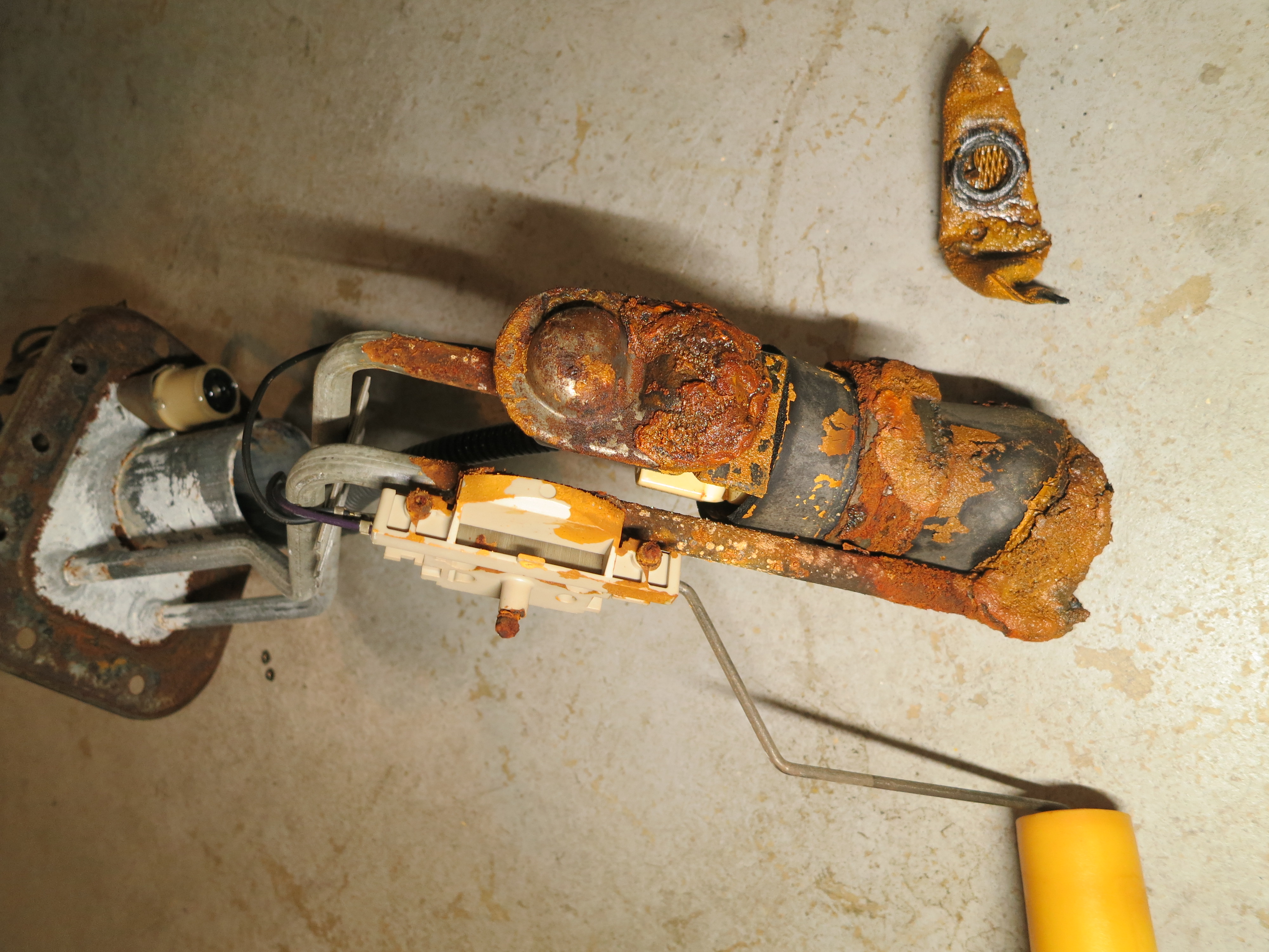

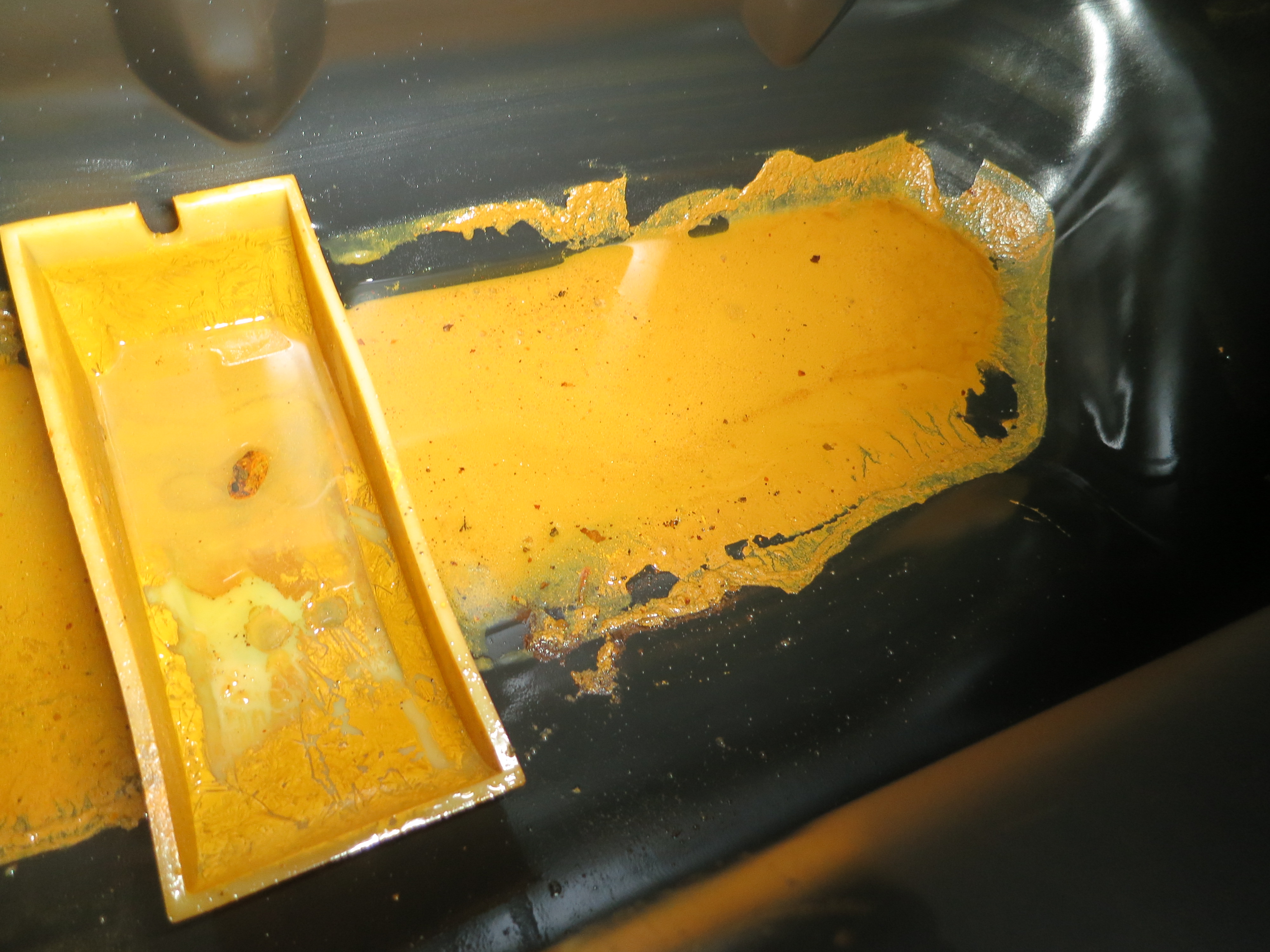

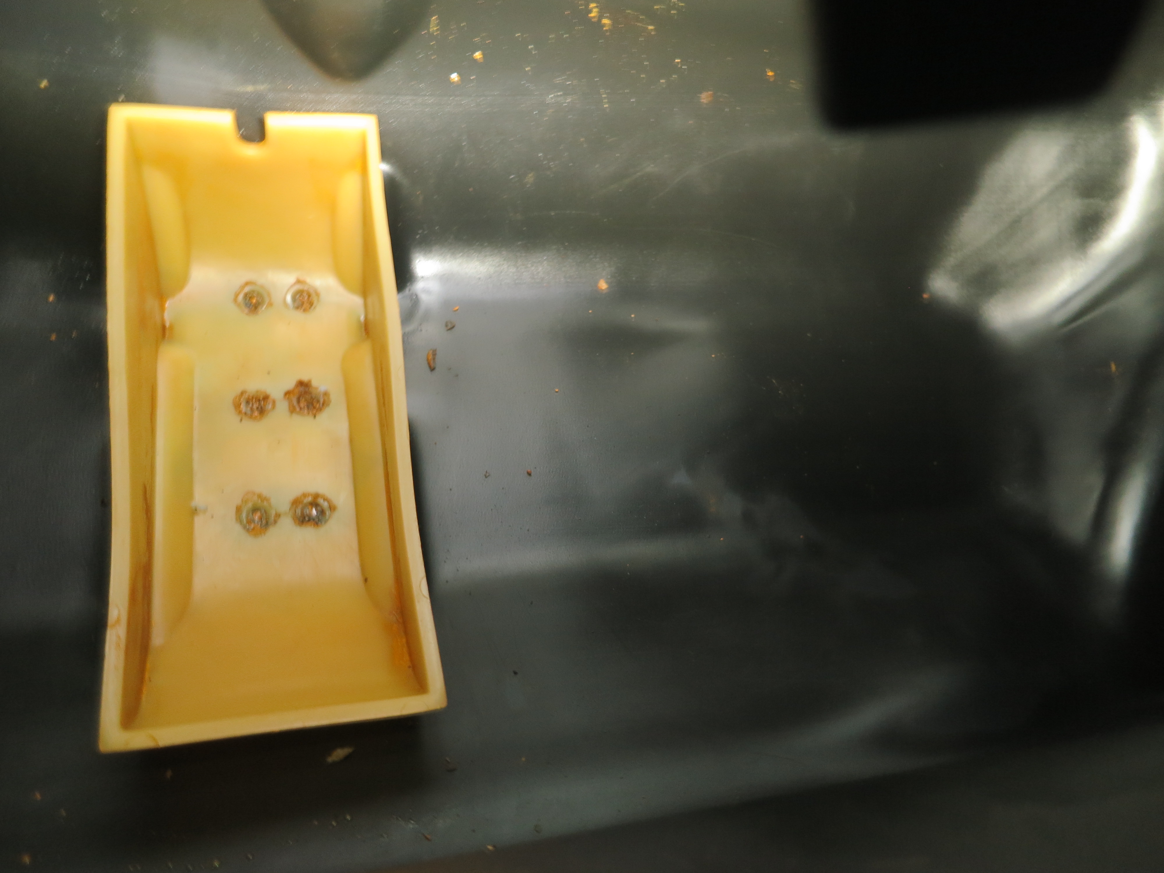

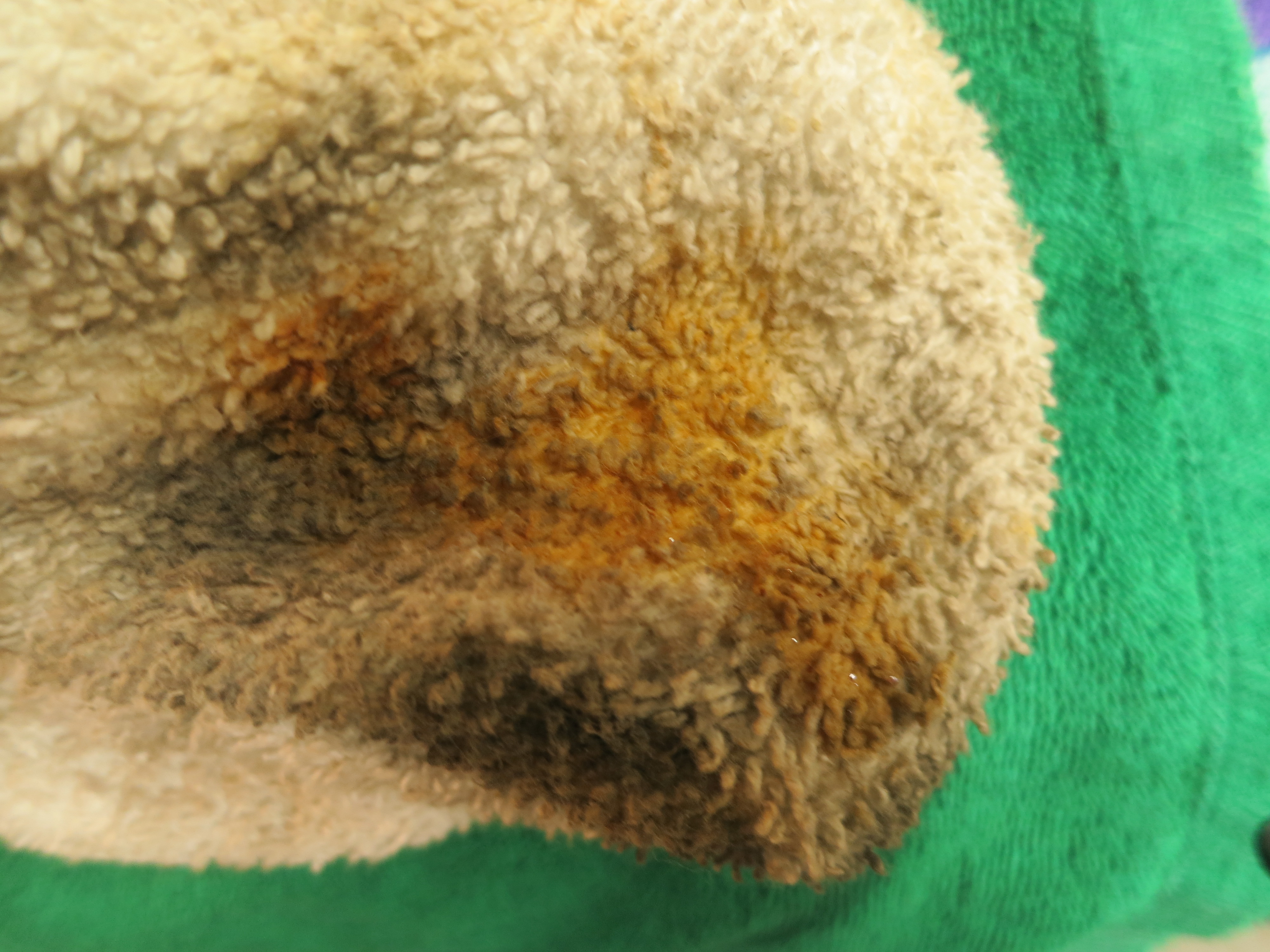

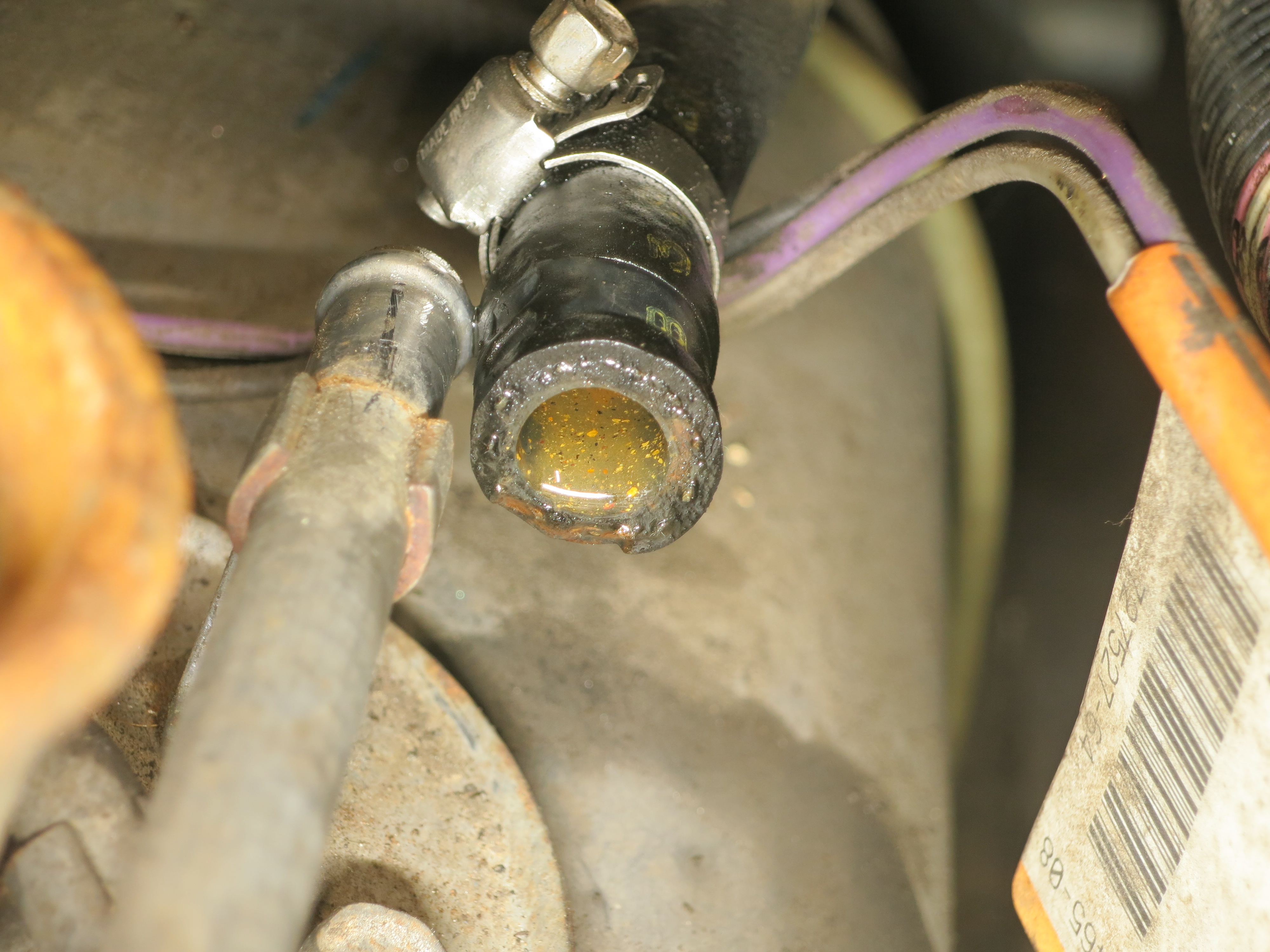

I opened up the Vette's gas tank this afternoon. It was not a pretty sight. I siphoned out about 3.5 gallons of gas, water, and rusty sludge.
The fuel pump hanger assembly was a rusty sludge covered mess. Now I understand why the gas gauge didn't work. I put a rag under the Schrader valve on the fuel rail and rusty liquid came out. At the tank, the end of one of the lines looks like this: This is the bottom of the tank once all the water and gas were removed. I used rags to clean out the tank and it looks quite good now. I is obvious to me that these components haven't seen the light of day since the assembly line.
At this point I would welcome direction from Mostmint who has done this before. I need a good solid plan.
