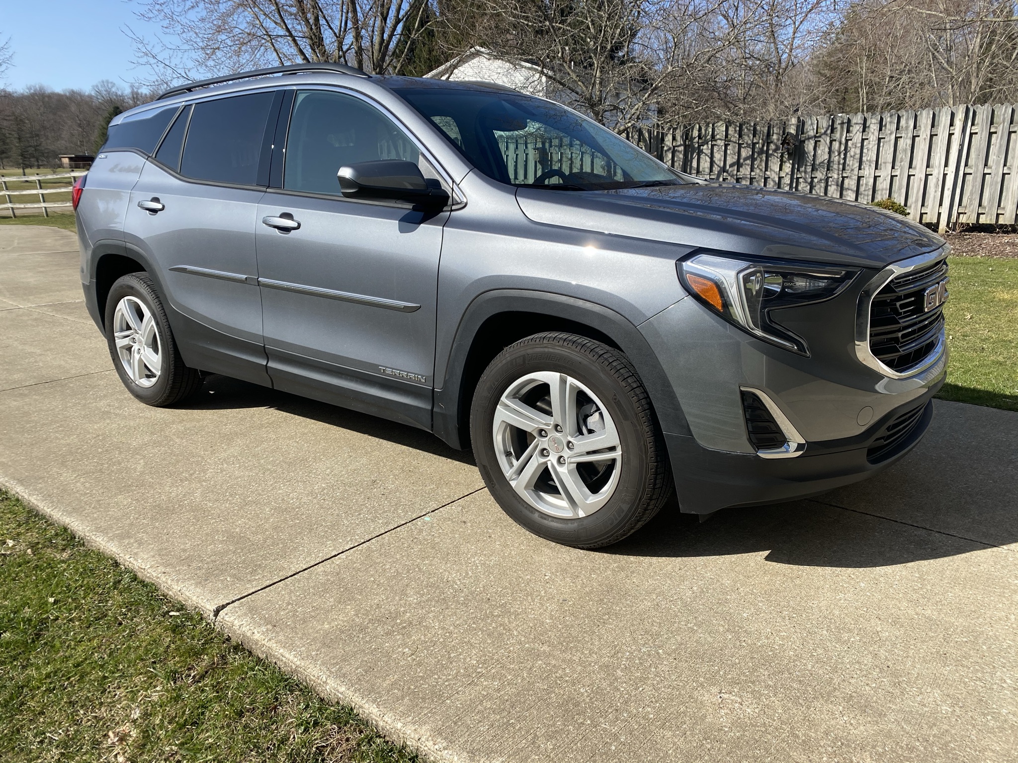

4820 MIles.... A couple of weeks ago, I started “browsing” Facebook Marketplace for “GMC Terrain”.
Careful when you play around on the internet. I stumbled on a set of 19” factory take-off wheels... for
$200 including TPMS sensors). I had to buy them, because I want to run snow tires in the winter. A day later,
I found a set of 235/50/19 tires that were 99% tread... mounted and balanced for $345. This gets me a tires
& wheels that I like more than the 18’s for $545. Pretty cheap. Today I put them on the vehicle. After a test
drive, I can tell you that the shorter sidewall makes the car handle way better, and I like the look way better.
The plan worked.
Before....
Before....
After....
After....

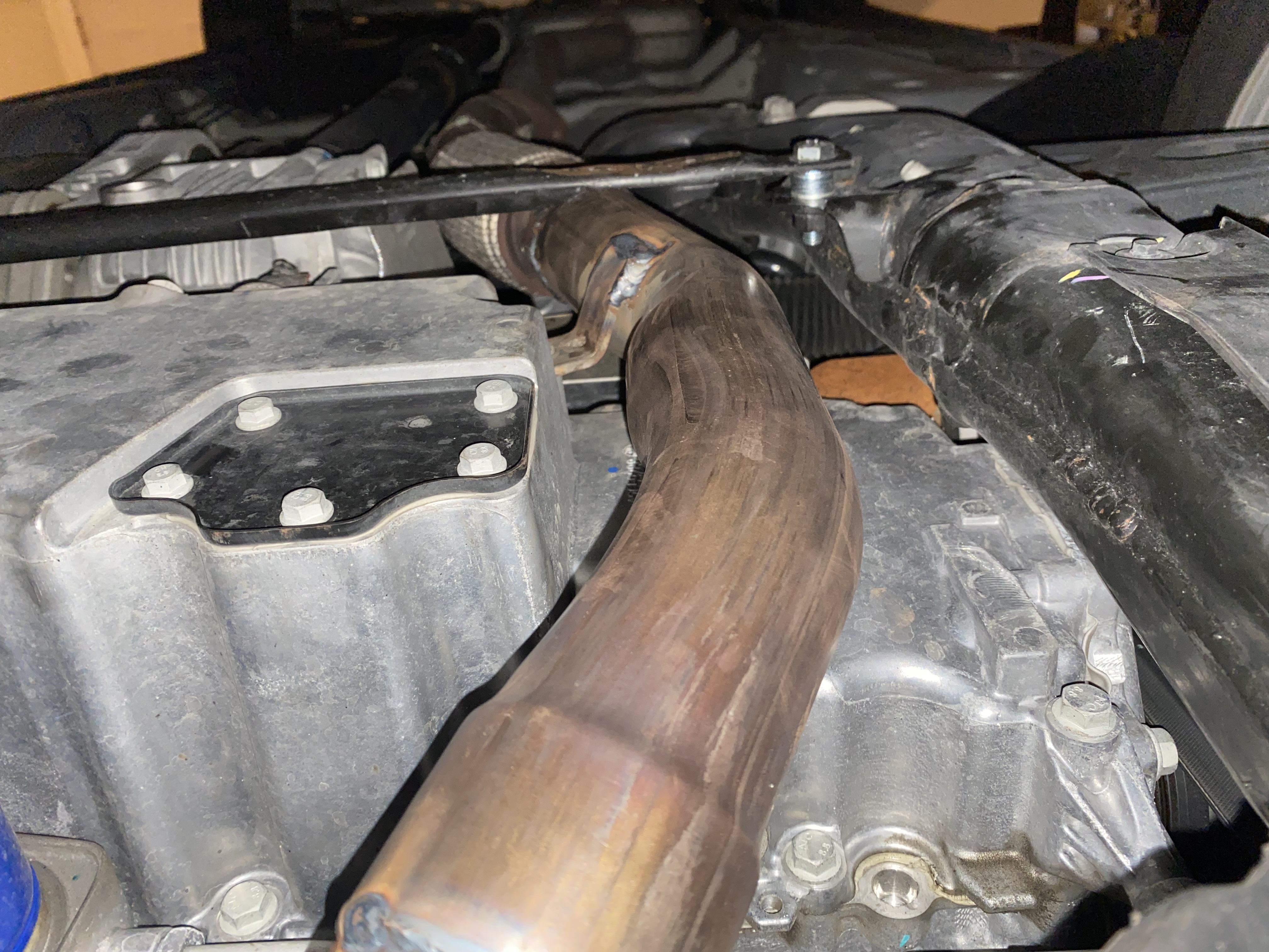

New pipe installed
New pipe installed
15,650 …. So, I haven’t posted about the Terrain for a bit, but I’ve been working on it to see what
performance mods ( if any ) can be made to the vehicle. Basically, the only thing that I’ve found
was a computer program that boasts a 40 HP gain. It’s a bit pricey at $400, but not out of the question.
I did take it upon myself to do some mods that were a bit more old school. First, I put in a K&N air filter
and modified the air box to remove a minor restriction on the inlet side. These were pretty easy to do.
I also had a restrictive portion of the exhaust pipe replaced with 2.5” round pipe. Basically, the old pipe
went from 2.5” to 1.75” to go under the oil pan, then to 2.5” the rest of the way out. My pipe is now
2.5” the whole way back. There is a resonator that may be removed depending on what gains I get
at the track. Here are some pics of my work. I’m the only guy on the planet making a Terrain go faster!

My 2.5” downpipe & K&N filter experiment seems to be netting some unexpected rewards. My fuel
economy has jumped a bit. Typical fuel mileage per tank is usually around 29 - 29.5. My last two tanks were
over 30, the second tank at 31.9. The second tank, I put 89 octane in and economy was better, so this tank I filled
with 93 octane. Of course, my mind keeps thinking that everything I do makes it faster, but I need the track to
verify this.
