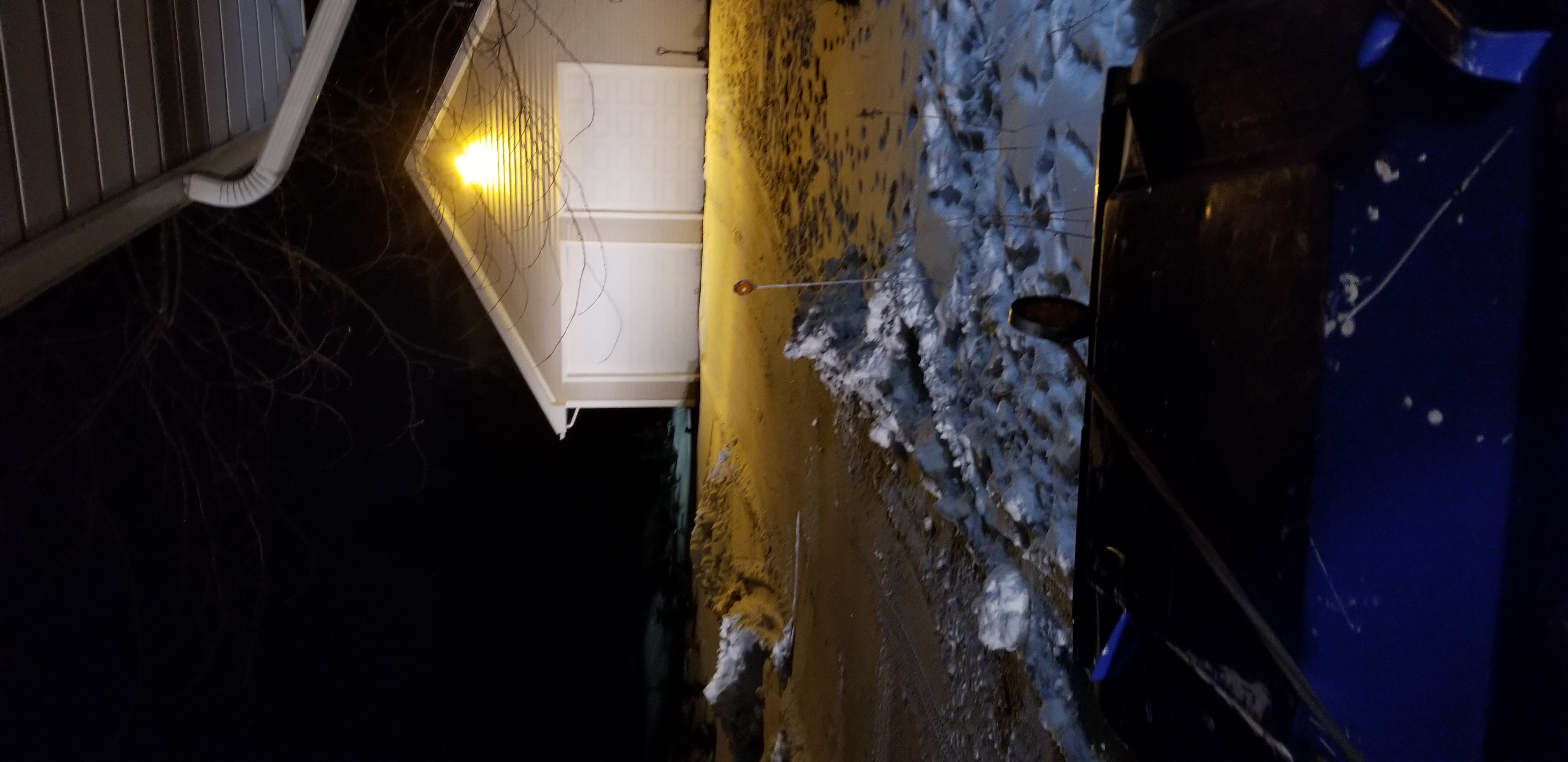

Just like any other drama filled car show, the drama started before a wrench was turned. I have to shuffle all the cars in the garage to get the Chevelle into the lift bay, currently occupied by the 90Vette. yOu wOnT bElIeVe wHaT hApPeNs nExT!!
A corvette stuck in snow-- the joker in charge of this show clearly not off to a good start. After an assist from Gwen and my sister Karen (who had the unfortunate luck of showing up at the wrong time), we managed to get the Vette back in the garage. I called my cousin Troy and he was able to come out that night and plow out the back area by the garage.
