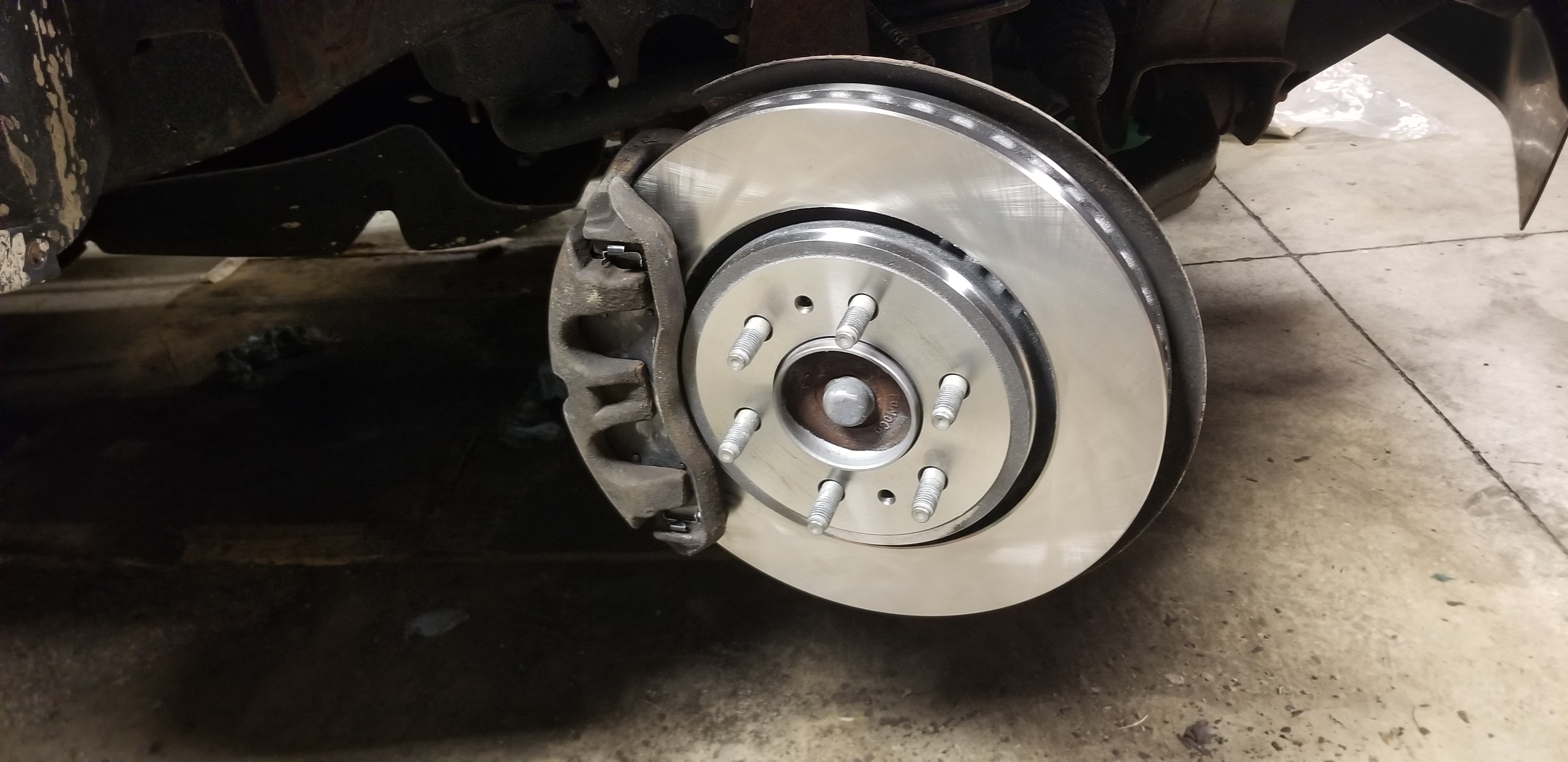

70,915 Oil change + filter, Mobil1 5W-30 and STP gold filter. New NAPA front SilentGuard pads/rotors, Cooper Discoverer AT3 S4 tires.
A couple months back, my left front tire was showing excessive wear on the outside edge. I took it to Don's CARS here in Chesterland and Don said the alignment was indeed off a bit, and corrected it. The old tires were getting thin, LF had worn outside edge, and they were absolutely terrible in the wet. Spent some time on tirerack.com and saw what was well rated. I decided to head up to Mr. Tire just to see what they had. He said he had a deal on Cooper Discoverer AT3 S4 All-Terrain tires, which I had seen well reviewed, and a better price than TireRack. Sold. They told me my brakes were almost down to the metal on the front. Rears also need done, but I don't remember if they were as bad. They offered to fix them for and additional $700, but I figured I could take care of it myself.
This weekend, I pulled the official Tiresmoke Support Truck inside for a set of fresh front brakes. Tore it apart last night. Indeed, the inside pads were almost toast. I made a run this morning to Streetsboro (!!) NAPA to get a set of rotors. I've been happy with Napa brakes stuff lately, more so than Autozone, so I made the trip. It's amazing that front brake rotors for a friggin F-150 could be hard to get. Chester didnt have them, neither did Chardon. They said Twinsburg had some, but not open on Saturday. Streetsboro was my closest option. The guy at Napa said he used to get 3 pallets of brake rotors every week and half. Now he's getting a half-pallet every 2 weeks. Good grief..
I had seen the oil life indicator was down in the 30-something percent range, so I figured I would change the oil while I had it in the air. I hadn't checked my records, and it only had about 3k miles and was changed in April. 38% oil life seems kinda low for that usage, although there was the Corvette tow to/from Mid Ohio, and bringing the Maliboost home. Interestingly enough, in the oil life reset area, you can reset to it 70,80,90,100%. I've never seen that in a vehicle before.
