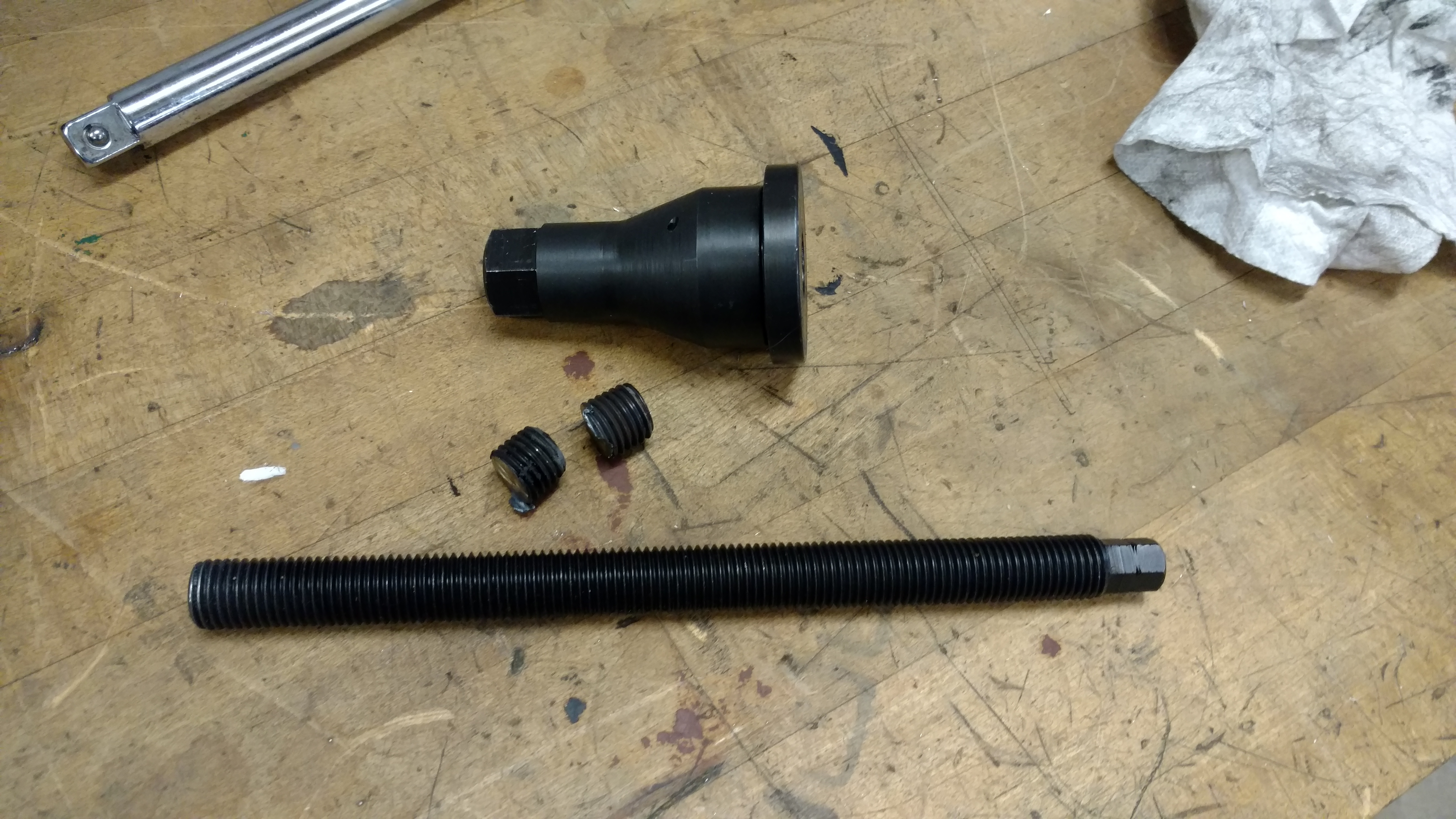

Since there's not too many people changing LS1 harmonic balancers in S10s, I could only gain prior information about Corvette swaps and hope for the best. With that in mind I bought a harmonic balancer puller and install tool for that job.
The first problem was getting the extremely tight (240 ft lbs) off without being able to keep the motor from spinning. After impact guns, strap wrenches and long breaker bars with bars on them, it was the old hammer and offset wrench that solved the problem. About 10 quick whacks with a small sledge and it came loose.
Next up was the puller. That went pretty smooth, but I did have to put the longer rod in midway to get the balancer off completely.
Next came the installation. I was immediately set back as the installation too was too long to get lined up in the center hole of the crank and hit the bottom of the radiator. Not wanting to cut too much, I ended up cutting it twice before it would line up, then I was worried the shaft would be too short. But it turned out perfect.
Once I got the pulley basically bottomed out and the crank starting to turn again, I had to figure out how to get the bolt to that lofty 240 ft lbs mark again. With a strap wrench and the torque wrench, I was able to make the wrench click at 150 lbs, and was able to get the bolt to turn just a little more on the way to 180, but couldn't get it to click. So I was close. So to finish the tightening sequence, I went back to my wrench and hammer for a true precision measurement, and whacked it four times solidly and called it a day.
I went for a drive and it seemed all good, so I'm going with it. Hopefully that's all the maintenance it needs this year.

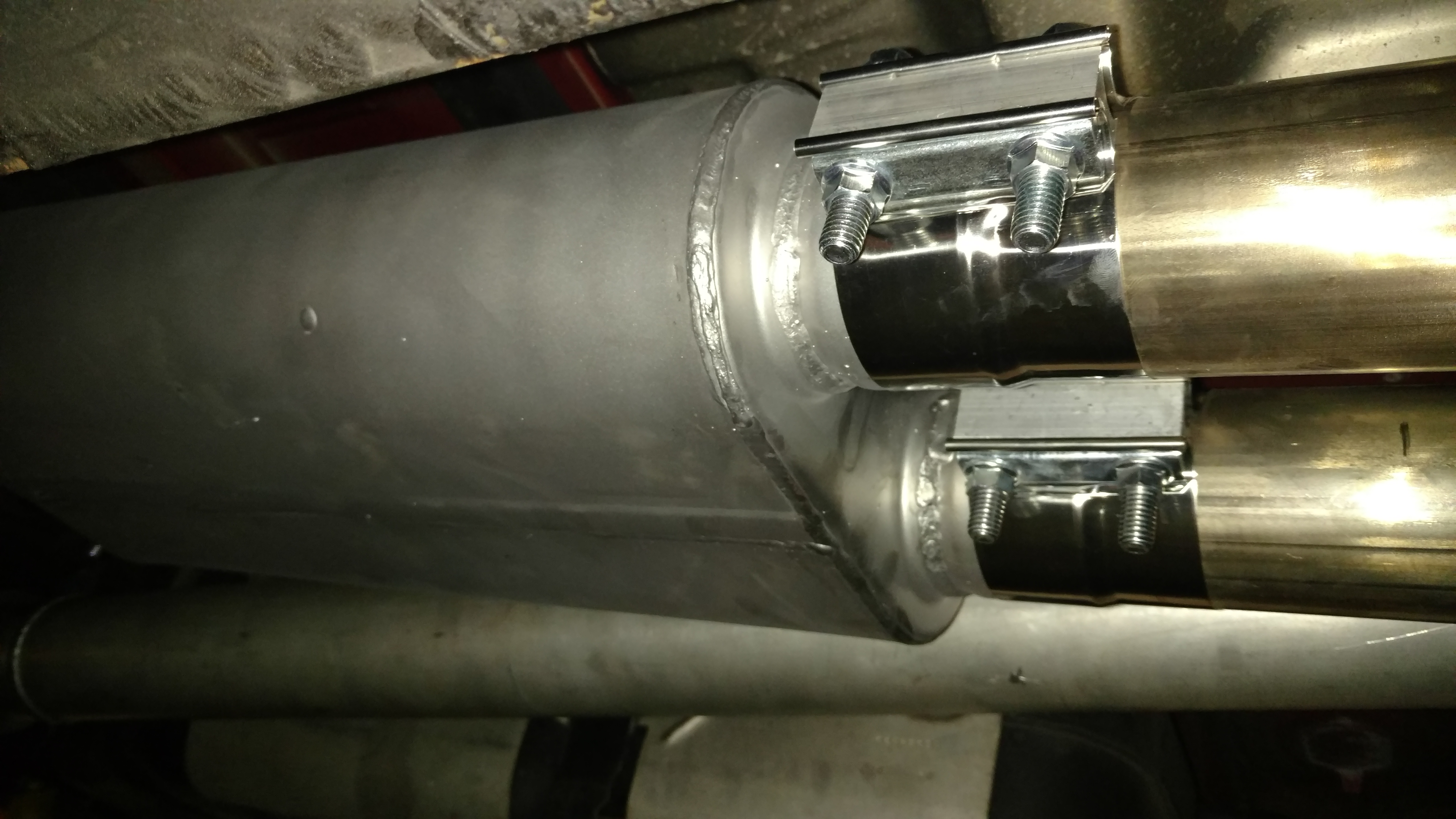

The muffler started rattling real bad at the track last night. It's a lifetime warranty Dynomax dual 3" in and dual 3" out with a built in X pipe. The top of it has four spot welds on it and two of them are now holes.
I removed it tonight and already have a new one waiting for me at Summit. I'll probably pick it up tomorrow after lunch.

Yesterday afternoon was a trip to Summit with dad for free muffler replacement and some new bandclamps to make replacement later much easier. Last night it got installed. It's a little quieter and doesn't rattle, but quiet is still a relative term here.
