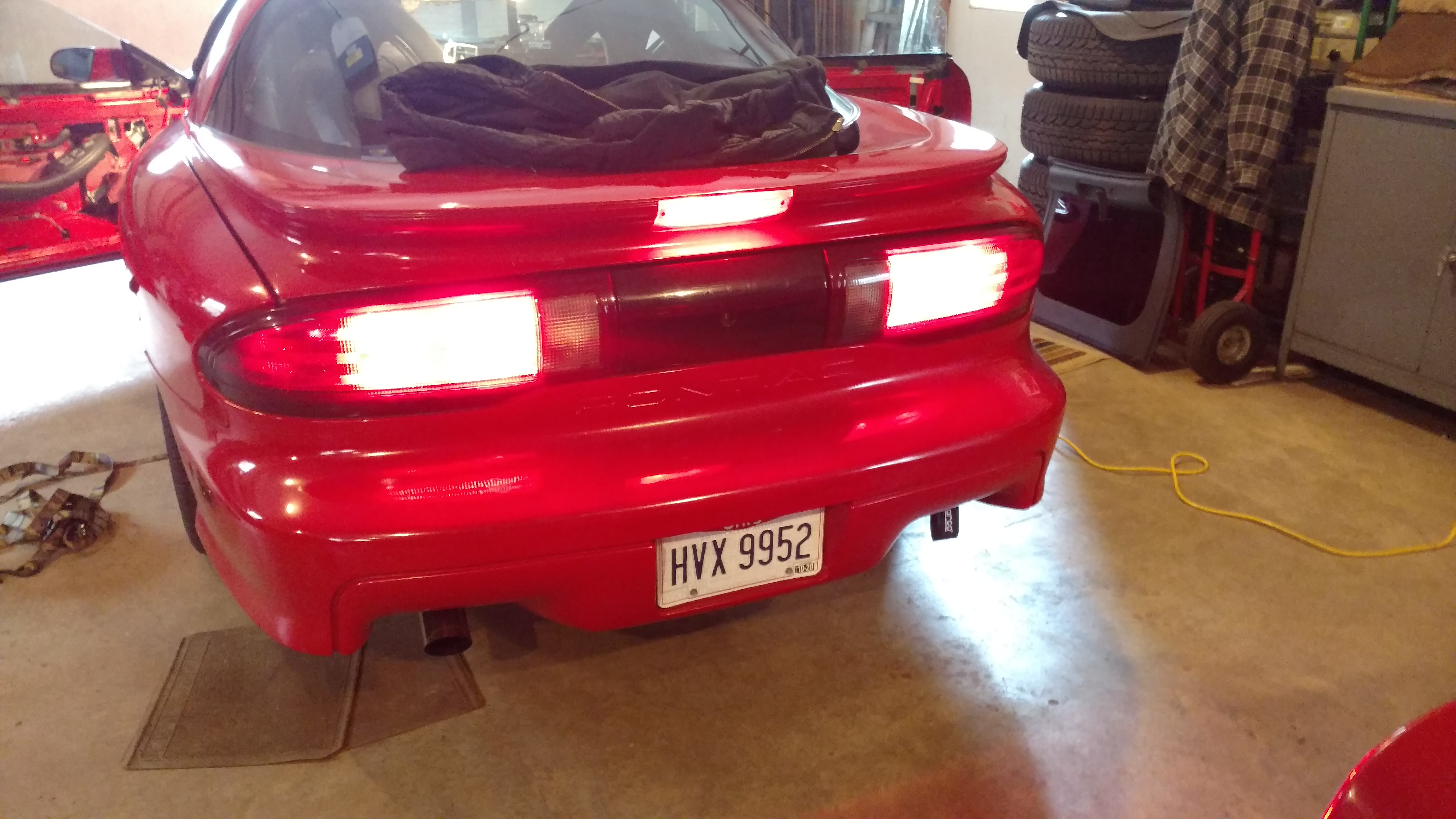

After some online searching, I only found one guy posting what I thought was a definitive solution to our brake light situation.
https://youtu.be/wgTsvdVAS20
According to him, the multi-function switch is the culprit. I priced one at AutoZone for $29. I figured, if that wasn't it, it was going to die eventually and it would eliminate it as a problem. And after maybe an hour + of screwing around, it was installed and damn if it didn't fix our problem!

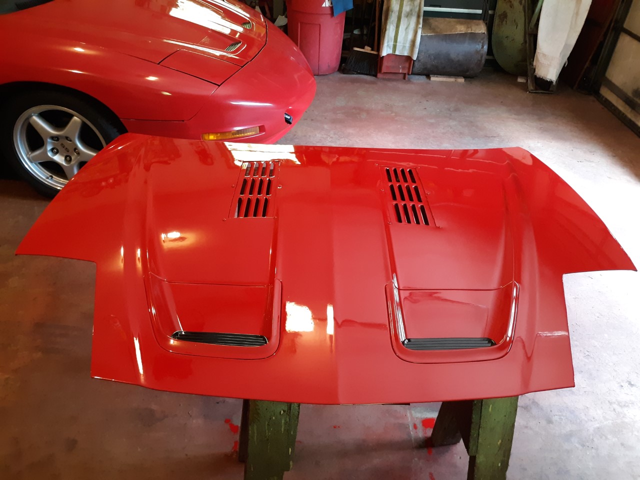

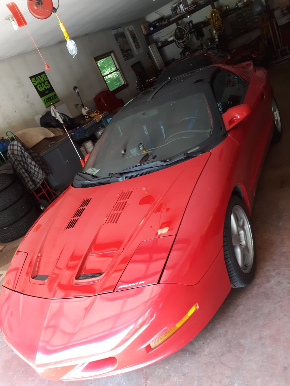

The louvered hood has been ready to be painted for awhile.
Well today was the day! During the week it will be reassembled, this louvered hood will be on the TrackBird for Track Day.
Re: 1997 Pontiac Firebird

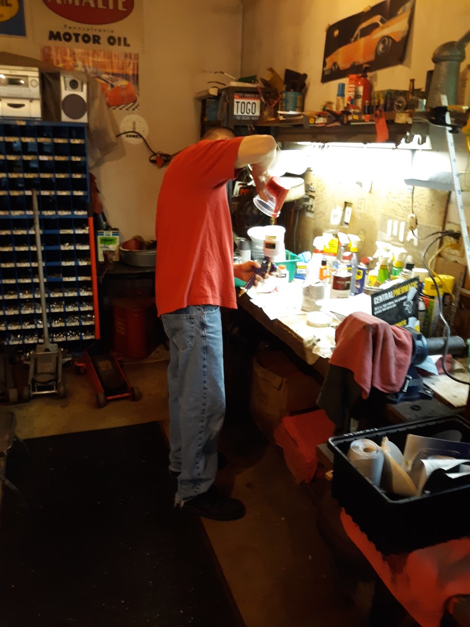

The false inserts were painted black. The hood is completely reassembled.
Ready to be put on the TrackBird.Fred32v

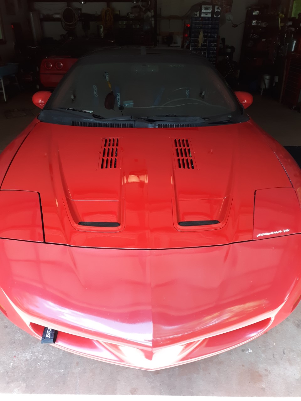

BP and I installed the freshly painted louvered hood onto the TrackBird.
it just adds to the fun!
Then it was time for me to test drive the new hood, it just adds to the fun!
