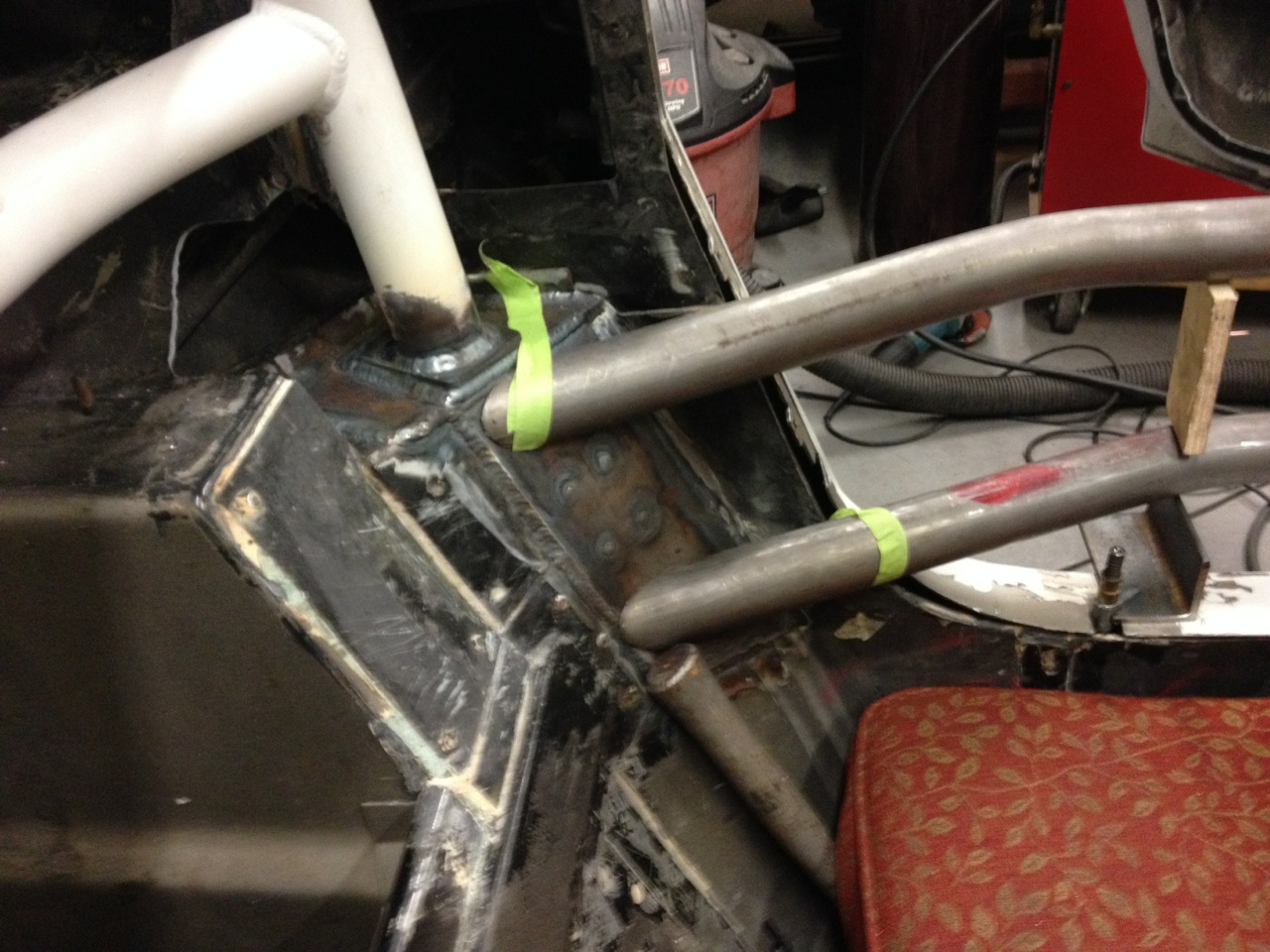

<pic 1> picture of the Vette silhouette

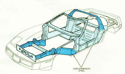

<pic 2> picture of the Vette blueprint structure

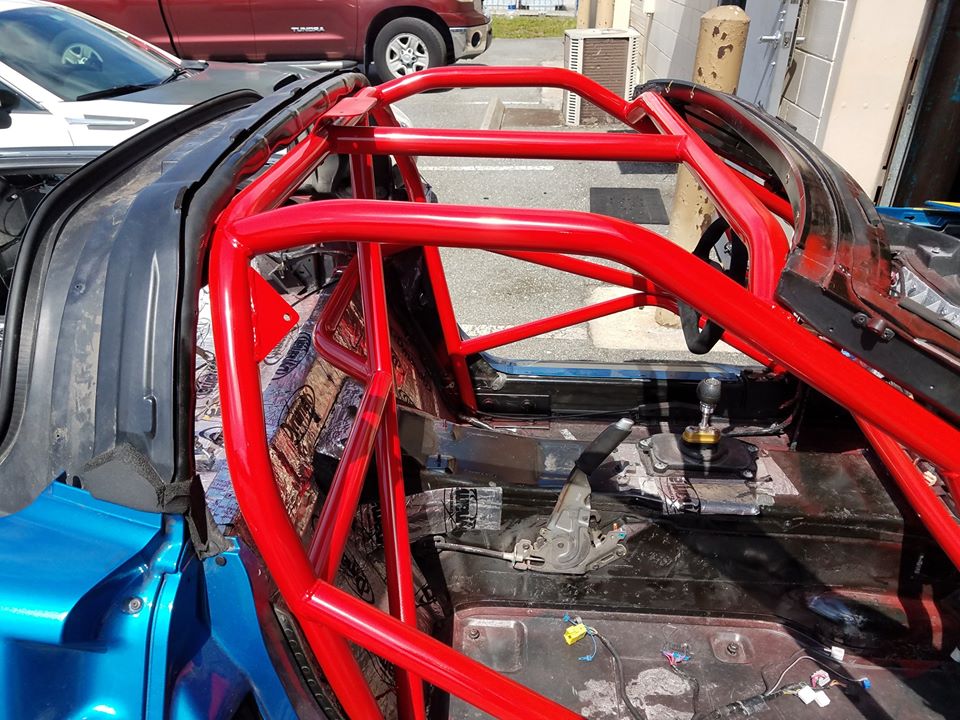

Plan A:
Put the hoop under the factory rollover protection – keep it within 1/4” along the top and attach the sides with gusset plates.
Cut through the fiberglass to get to the subframe and weld mounting plate to that
<pic 3> Vorshlag main hoop to roof bar

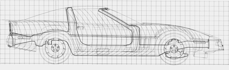

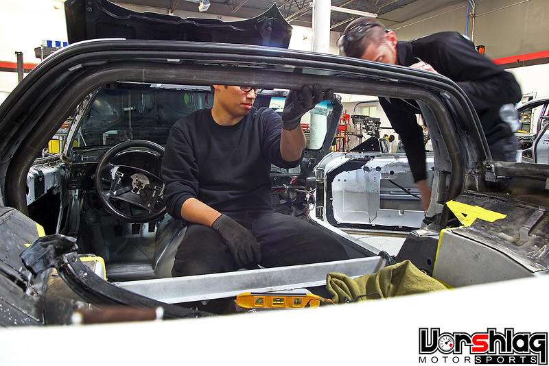

Plan A:
Front legs of the cage will run outside the A pillar up to the halo hoop. Halo hoop will also be mounted out
Attach front legs to A pillar with gusset plates
Front legs to mount to subframe at top of rocker panel/kick plate area. Will have to cut through the fiberglass to reach the subframe
The halo hoop will be located above the rear main hoop and the bars will have a small bend to come down and attach to the main hoop
<pic 4> Vorshlag front leg pic / overhead view
<pic 5> example of XP Motorsport C5 with bars going up and center bar

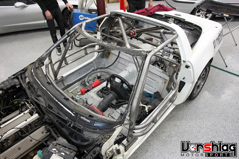

Plan A
Typical installations I have seen attach these bars behind the driver seat on the angled floor plane, instead of the main hoop. The issue here is that the floor is thin metal and may crush in a side impact.
Our proposal is to cut open the floor in this area and attach to the subframe, which is much sturdier and should do a better job support the door bars in event of a side impact.
<pic 6> inadequate side door guard design *
