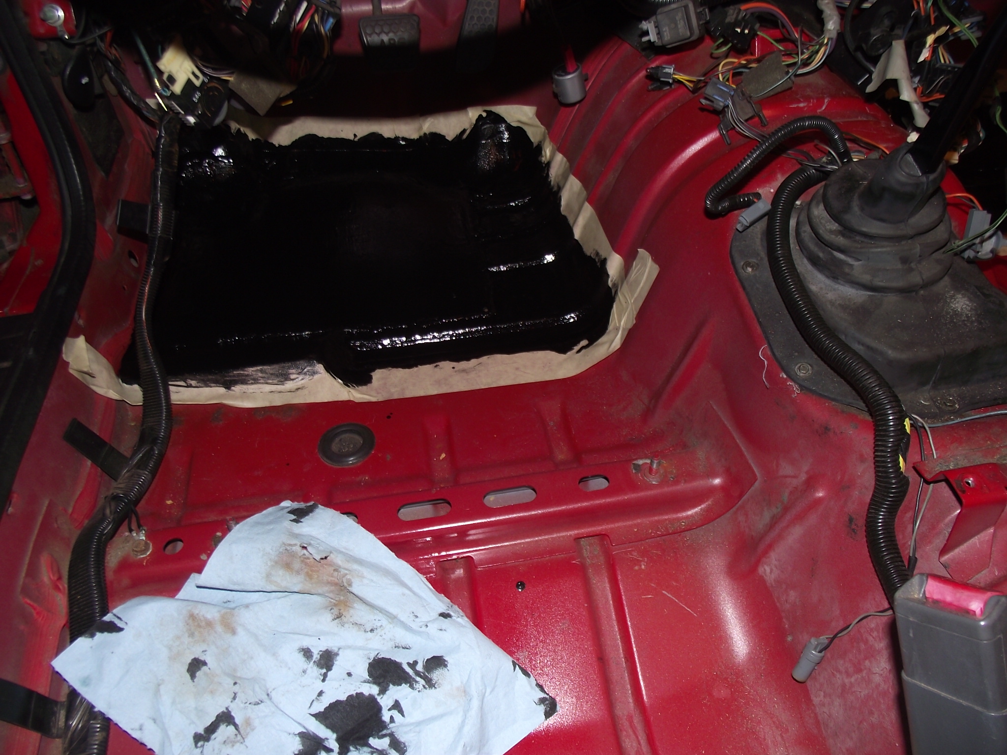

When I left the the 32V Garage Sunday in the late afternoon,
I had just applied a third coat of Bed Liner on the floor repairs.
This morning was the first time I've check and the floors are final dry to the touch.

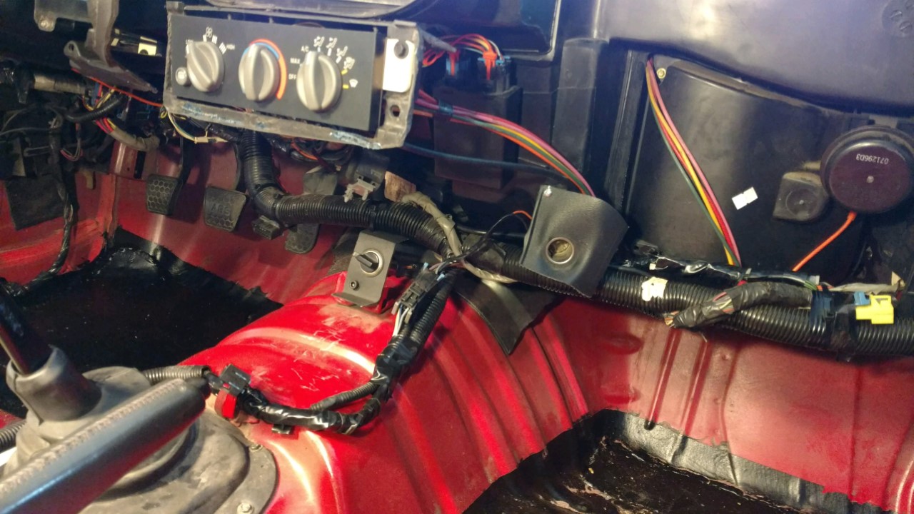

Today we cleaned up almost all the wiring except what's between the seats. That will get done once the seats are in and should only take 5 minutes. With the need for 12V power for GPS and anything else, we robbed more parts from the old dash and now have two 12V outlets with easy access.
Then it was on to the passenger's side seat bracket. This went really well (no pics today) as we were able to use the front two factory seat studs just by cutting one bracket off the Mustang seat frame and drilling only one hole. Then on the rear of the frame, there were two brackets attached the the Mustang frame that we cut off, repositioned, and rewelded on in a more advantageous position. This all went really well and took us a lot less time than the driver's side. 32V will do a little paint work, and by next Saturday, we should have the interior done.
