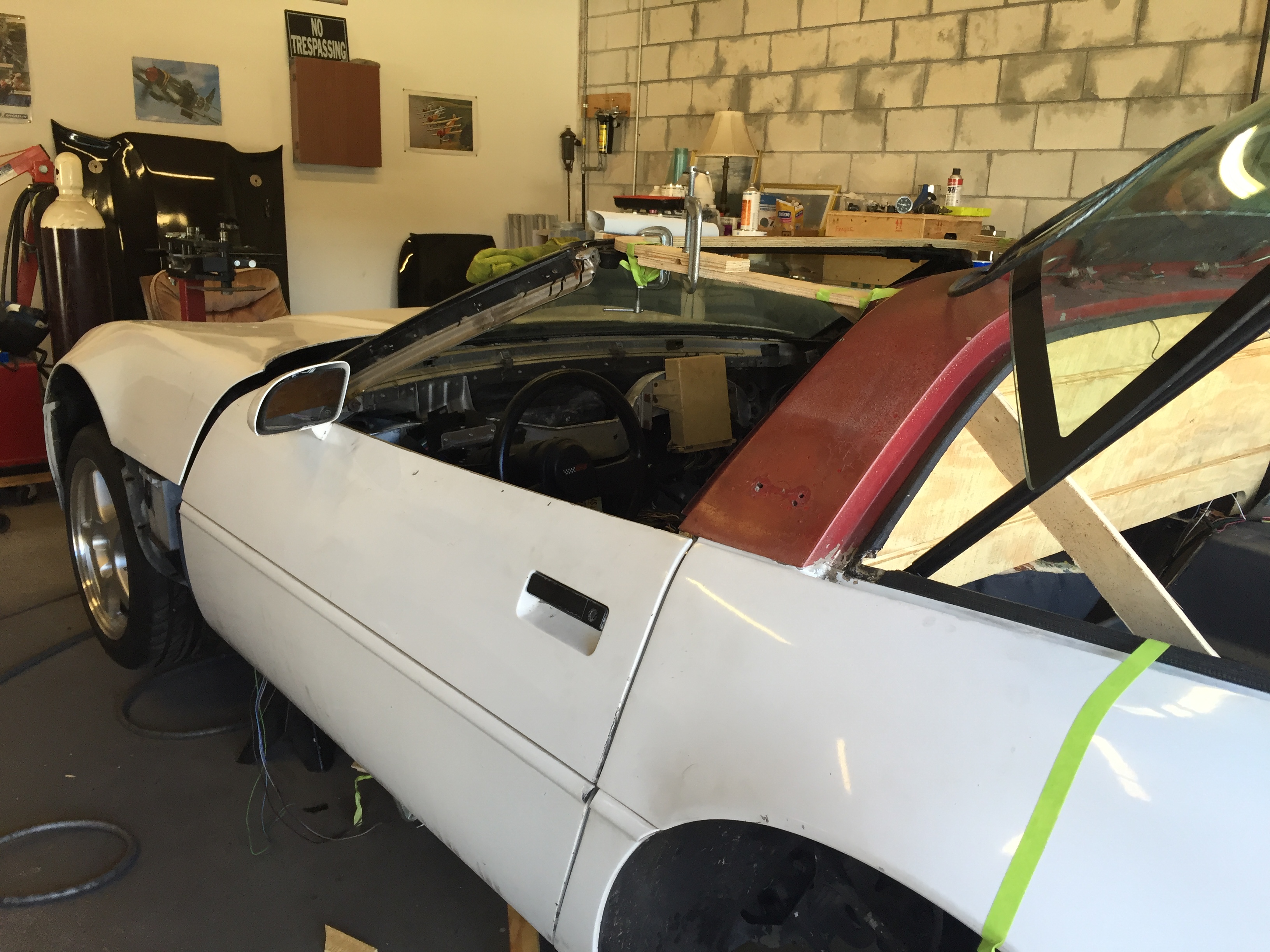

C4 Cage Research and Design Proposal
I will start another thread for this but for now I'm posting it here so I can edit it at any time as thoughts come to me
Post #1:
Overview:
Based on ChampCar rules and interest of safety, Mostmint Racing proposes a roll cage design for a C4 Corvette.
Contents:
Problem Statement
General Design Proposal
Main Hoop Proposal
Halo Hoop and Front Legs Proposal
Door Bars Proposal
Seat Configuration Proposal
Remaining Details Proposal
Reference Material
Timeline/Status
Post #2:

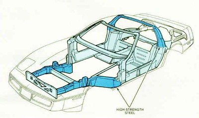

Problem Statement
The Vette cage is not going to fit the typical cage configuration described in ChampCar rules, and typical cage designs (approved by various sanctioning bodies) do not provide adequate structural integrity
1. The floor comes up directly behind the rear seat, meaning the main hoop cannot practically be full length
2. With a shorter main hoop, the door bars cannot be attached to the main hoop
3. With a flat seat slider (about 1”) and an aluminum seat my helmet clears the roof by less than 3/4”
4. My helmet is above the highest point attainable for the main hoop in the rear
5. The design of the car has the passenger compartment getting more narrow as it gets closer to the roof, which means my helmet is very close to the targa top frame on the left side of the helmet – putting the halo hoop will be in the same or closer proximity
6. The factory chassis uses a premium grade material in the rollover protection between and connecting the B pillars
7. The high point in the interior is directly behind the top of the windshield and the entire roof line slopes down from there
8. Typical designs attach door bars to the floor behind the driver seat which does not provide adequate side impact protection. Pre-fab kits attempt to fit the traditional main hoop on the flat floor surface behind the driver
<pic 1> picture of the Vette silhouette *
<pic 2> picture of the Vette blueprint structure *
1. The halo hoop is going to be above the main hoop
2. The factory rollover protection will not be cut to put the main hoop above the driver's head. It is considered an extension of the main hoop, and the main hoop will be within 1/4” of the rollover protection on the roofline. Top of drive helmet to be 7/8” below the top of the factory rollover protection
3. The halo hoop and top portion of the front legs are going to be outside of the original designed structure of the car
4. Where the door bars typically connect to the main hoop, they will instead attach to flat plates secured to subframe of the car
5. There will be one additional bar between the front center of the halo hoop and the center of the rear main hoop

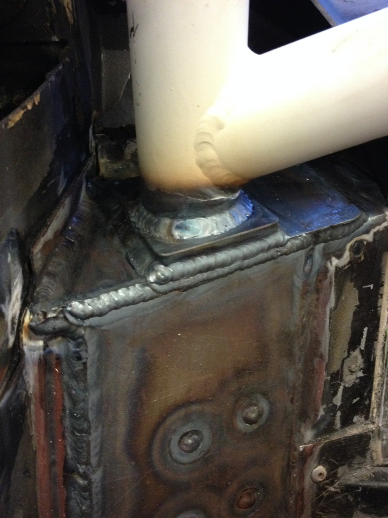

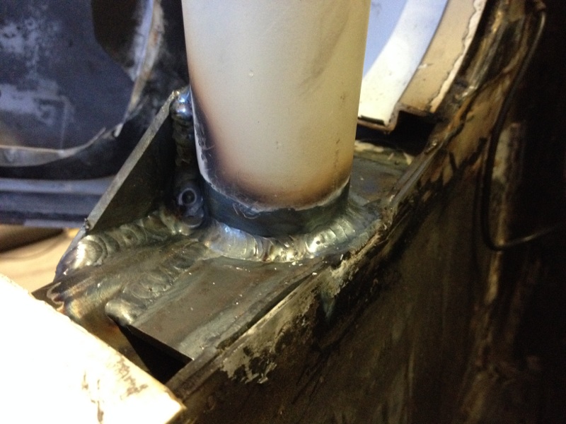

Main Hoop Proposal
Plan A:
Put the hoop under the factory rollover protection – keep it within 1/4” along the top and attach the sides with gusset plates.
Cut through the fiberglass to get to the subframe and weld mounting plate to that
<pic 3> Vorshlag main hoop to roof bar

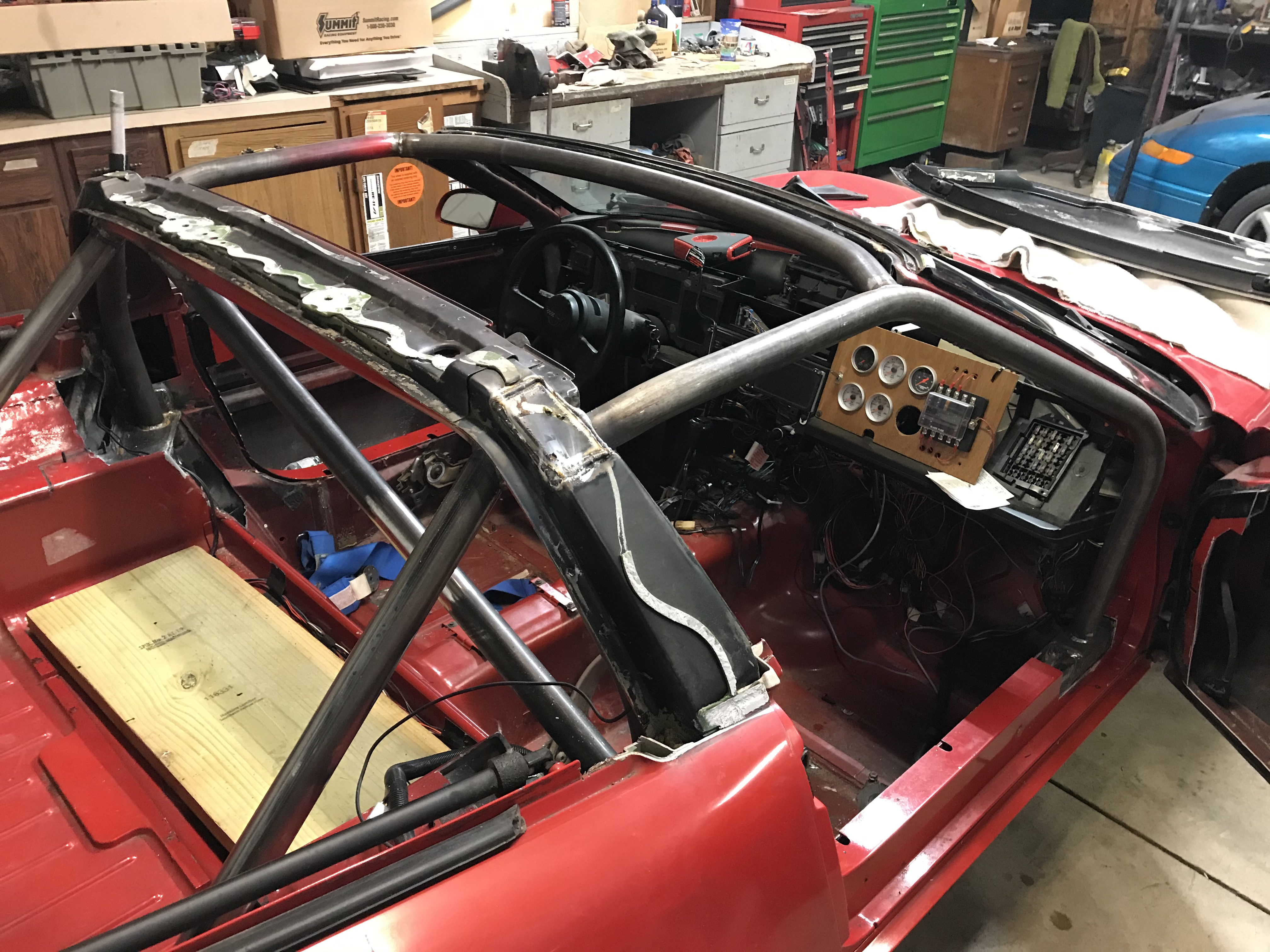

Eliminate the targa top mounting brace for helmet clearance on the left, and possibly for main hoop clearance
Mount the fiberglass top to the cage
Install an extra bar along the roofline in the center of the car from the halo hoop to the main hoop
Plan A:
Front legs of the cage will run outside the A pillar up to the halo hoop. Halo hoop will also be mounted out
Attach front legs to A pillar with gusset plates
Front legs to mount to subframe at top of rocker panel/kick plate area. Will have to cut through the fiberglass to reach the subframe
The halo hoop will be located above the rear main hoop and the bars will have a small bend to come down and attach to the main hoop
<pic 4> Vorshlag front leg pic *
<pic 5> possible example of XP Motorsport C5 with bars going up and center bar *
Plan B:
We can move the seat over enough to the right to get adequate clearance and the halo hoop will run in the same location as the targa top frame. Note: With a 7" Kirkey style seat there is not enough room to move the seat to the right without hitting the tunnel or extensive modifications to make the seat smaller so we are NOT going this route
Note: could be alternatives here depending on the final decision of the main hoop.

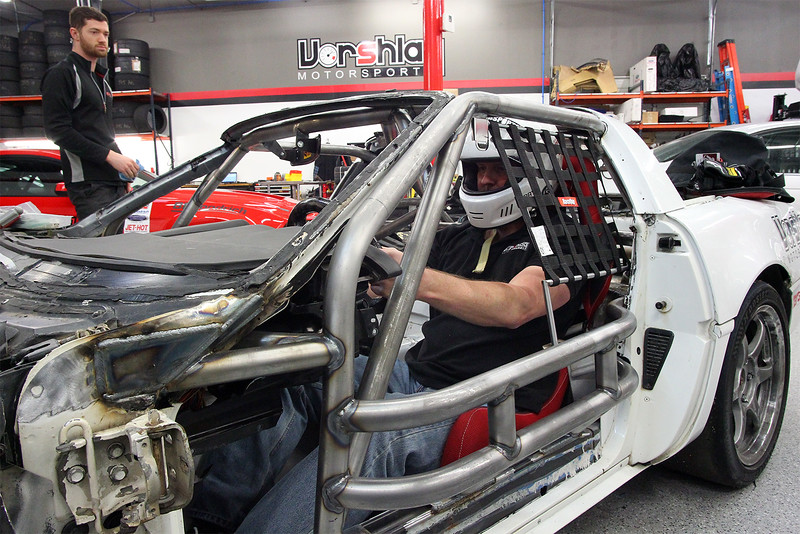

Door Bars Proposal
Plan A
Typical installations I have seen attach these bars behind the driver seat on the angled floor plane, instead of the main hoop. The issue here is that the floor is thin metal and may crush in a side impact.
Our proposal is to cut open the floor in this area and attach to the subframe, which is much sturdier and should do a better job support the door bars in event of a side impact.
<pic 6> inadequate side door guard design *
<pic 7> pic of where the plates/side bars will attach to subframe (still need to cut floor and take this pic)
Plan B
If we can get adequate leg room we can put the seat further forward, use typical rear hoop and just attach to the rear hoop
My tallest drivers are 39” tall with helmet in the seated position
We have large height variations we need to accommodate 5' 4” to 6' 3” so we will be using an adjustable seat
Current plan is to use an aluminum Kirkey 17” or similar and have drivers use inserts for adequate height, length, side support or comfort
We will fabricate adequate brackets to hold the seat in place and connect to the sliders
Current adapter slider configuration is just under 1.25” tall and fits on stock moorings. We plan to use stock mounting locations.
Post #7:
1) The fifth belt mount will need to be fabricated as it appears the location where it would attach is fiberglass
2) The floor is fiberglass below from under the pedals to the front edge of the seat. I would think metal would provide better/extra protection

Vorshlag Motorsports – amazing detail writeup on a NASA legal Corvette build

Some roll cage pics
From a Vette racing in ChampCar:
From a Vette that ran SCCA ITE - Nonnemaker
From Vorshlag Vette built to run NASA
"blueprint-ish" diagrams

Progress has been slow on this car due to countless other car projects - scrapping teal #2, acquiring Vette #2 and getting it running and into storage, and prepping the green Saturn.
However I did cut open the floor to identify places to mount the cage, made cardboard templates, took pics and completed my proposal. I also acquired the metal and had Kurt cut the pieces from flat stock
The proposal was submitted to ChampCar last week and it was approved today.

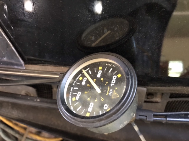

A tale of two gauges.
The electrical gauge was way off and eventually quit giving me a pressure reading so I went to mechanical and Obtained a replacement sending unit for the electrical.
So today I started it cold and got a reading on the mechanical. 30 minutes later the electrical was installed and I took a reading with it.
Which one is right? Ugh

Lots of progress since last update. Biggest is roll cage which is at least 2/3 done. Still need door bars, dash bar, should belt bars. Also going to have one bar inside front to back at center of the targa top.
Re: 89 Corvette Mostmint #39
• Roll cage:
o Roll cage about 2/3 done: Base plates are fabricated and welded in. Main hoop, main hoop cross brace, front legs running from near A pillar base up to main hoop, halo hoop, back supports for main hoop are fabricated and welded in
o Fabricated the car to fit the cage also about 2/3 done: Removed rear hatch, fabricated new attaching hardware to allow install with main hoop in place. Temporarily removed fiberglass panel covering the B pillars and top of factory main hoop – trim this panel to accommodate roll cage bars. Cut access holes in the main hoop to allow proper weld of roll cage bars, and subsequently welded them back into place
o Other details: Painted the bars in the sections that will be hard to access once installed. Much time spent cleaning metal to prep for welding, and cleaning up metal from cutting and grinding. Remove trim from targa top and A pillar
o To do: Door bars, dash bar, seat belt bar, extra top bar need fabricated and installed. Fabricate method to attach targa top to the roll cage since stock brackets removed to fit roll cage. Fabricate covers to close up the holes in the fiberglass where roll cage is now attached to the frame
