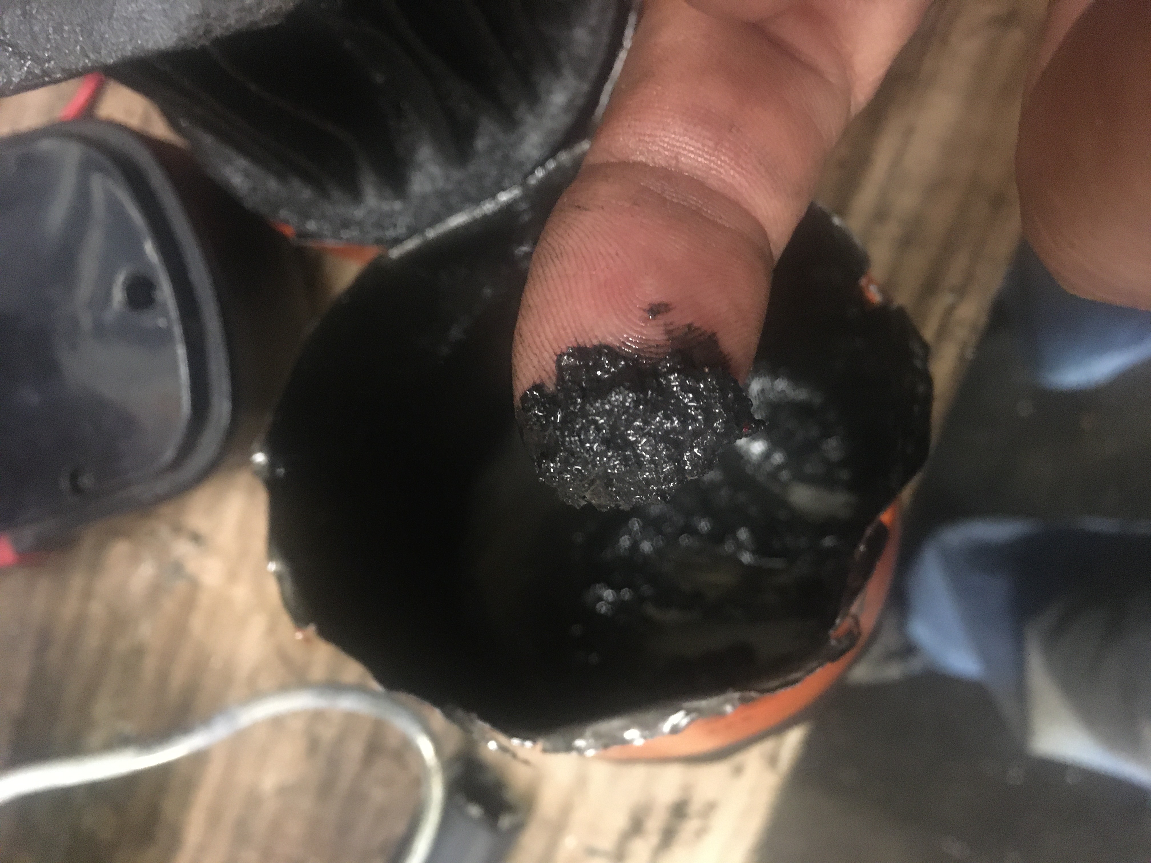

* cut open the oil filter - no metal shavings at all but yikes there was a bunch of carbon in there

Please tell me that oil filter was left over from when you acquired the car. That can't be a fresh one after the engine work you did? Any thoughts on how all that carbon happened to be there?
Posts: 2737
Re: 89 Corvette Mostmint #39
wxo wrote:Please tell me that oil filter was left over from when you acquired the car. That can't be a fresh one after the engine work you did? Any thoughts on how all that carbon happened to be there?
That filter was brand new. Thing is this is the backup engine that I threw together so the car would run. Truck heads and cam, replaced the valve seals and the crank bearings, and fixed one of the valve seats. None of this engine was tanked I just cleaned the gasket surfaces and reassembled it. I underestimated or forgot how "unclean" it was on the inside. I may have aggravated the situation by scraping off some of the carbon buildup then doing an inadequate job cleaning it up, not to mention detergents in the fresh oil and all that extra heat loosening things up.
The current oil filter will be on there for maybe 100 miles then I will change it again, and repeat until it stays clean.

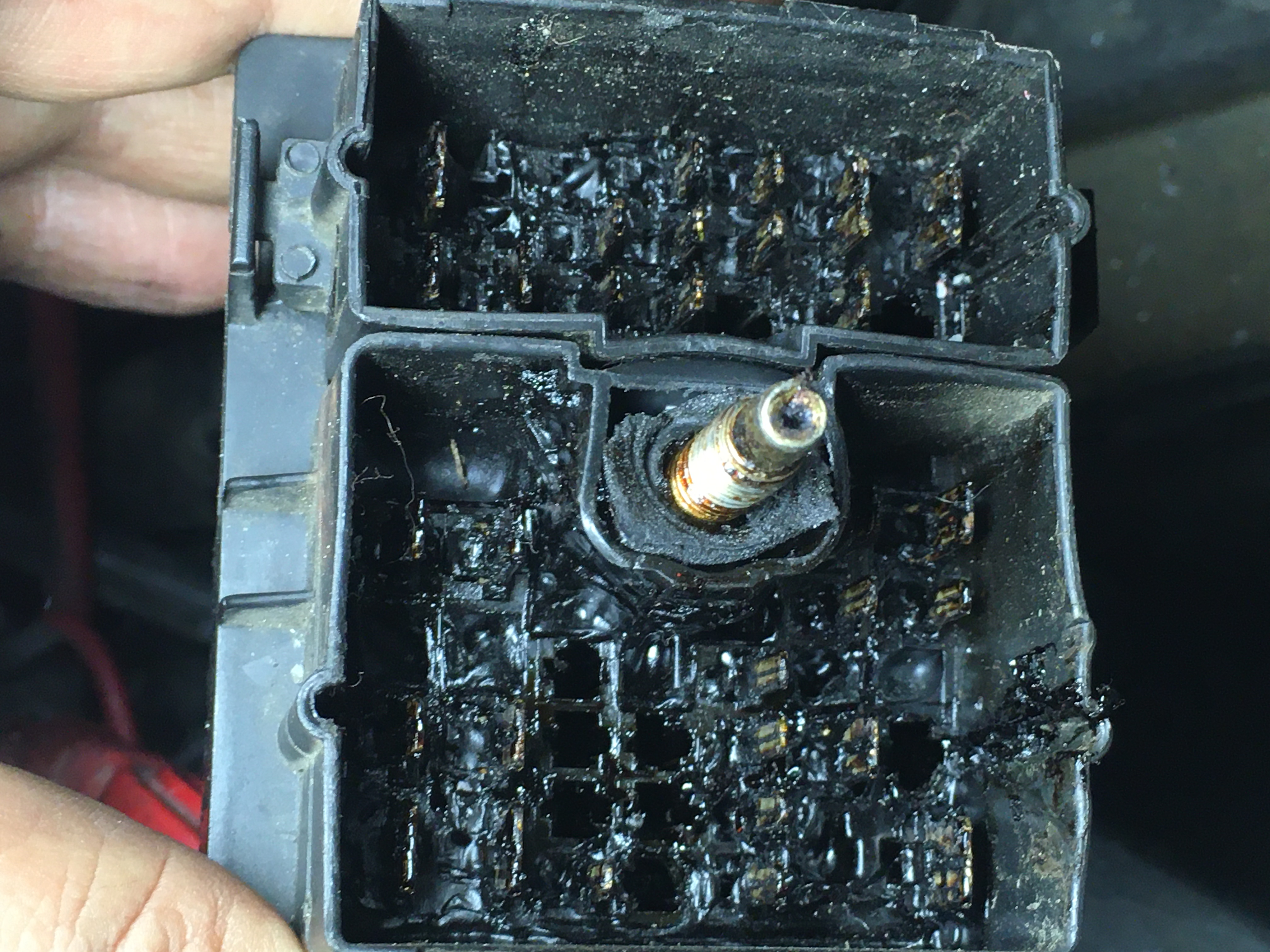

4) Fixed the windshield wipers - spent a bit of time reading wiring diagrams. Step #1 was check the fuse. Fuse was missing. Installed fuse and fixed the problem

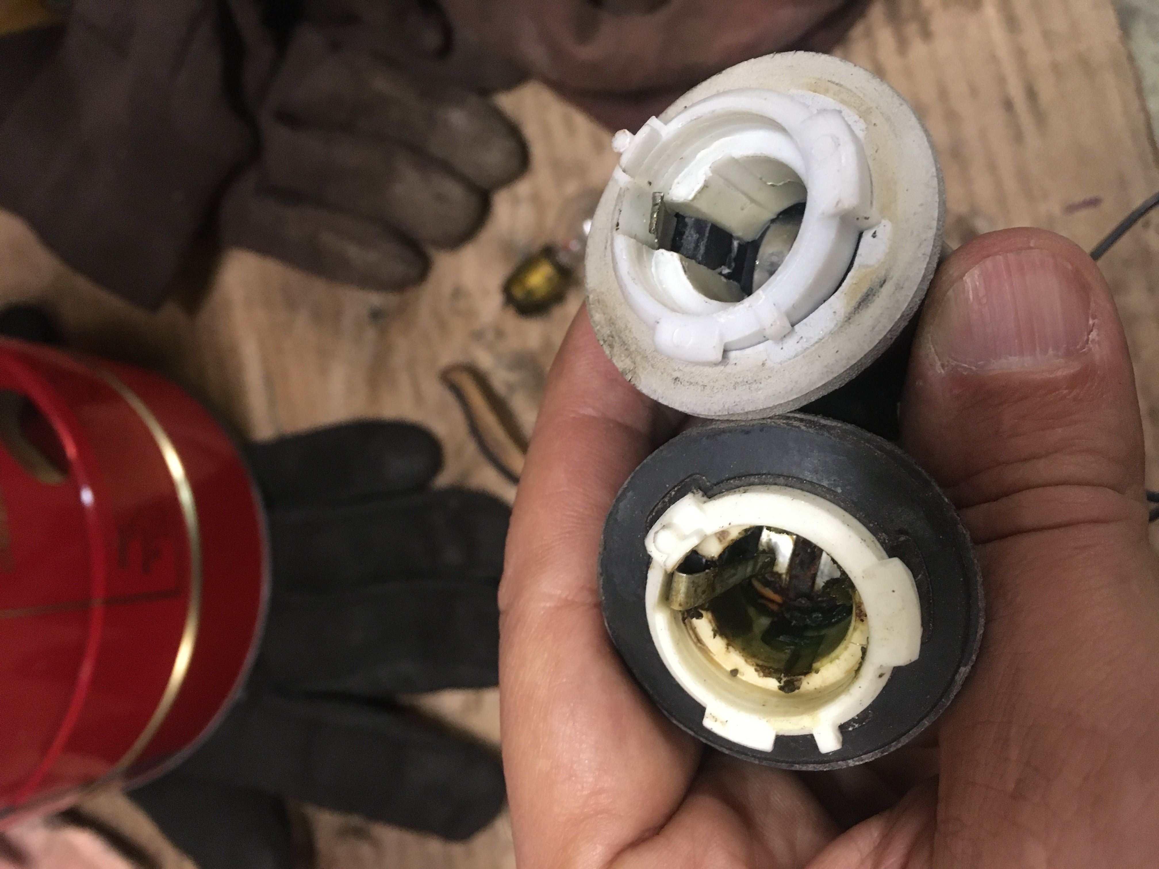

6) left front marker light out. Took some debugging to figure out the ground connection in the socket was bad. Replaced the socket with a spare from Saturn inventory - even the wires were the same color! I am still trying to figure out how the prior owner managed to break that little tab? His legacy is leaving the car one item at a time.

doh!  fuse missing
doh! fuse missing

socket bulb ground tab broken

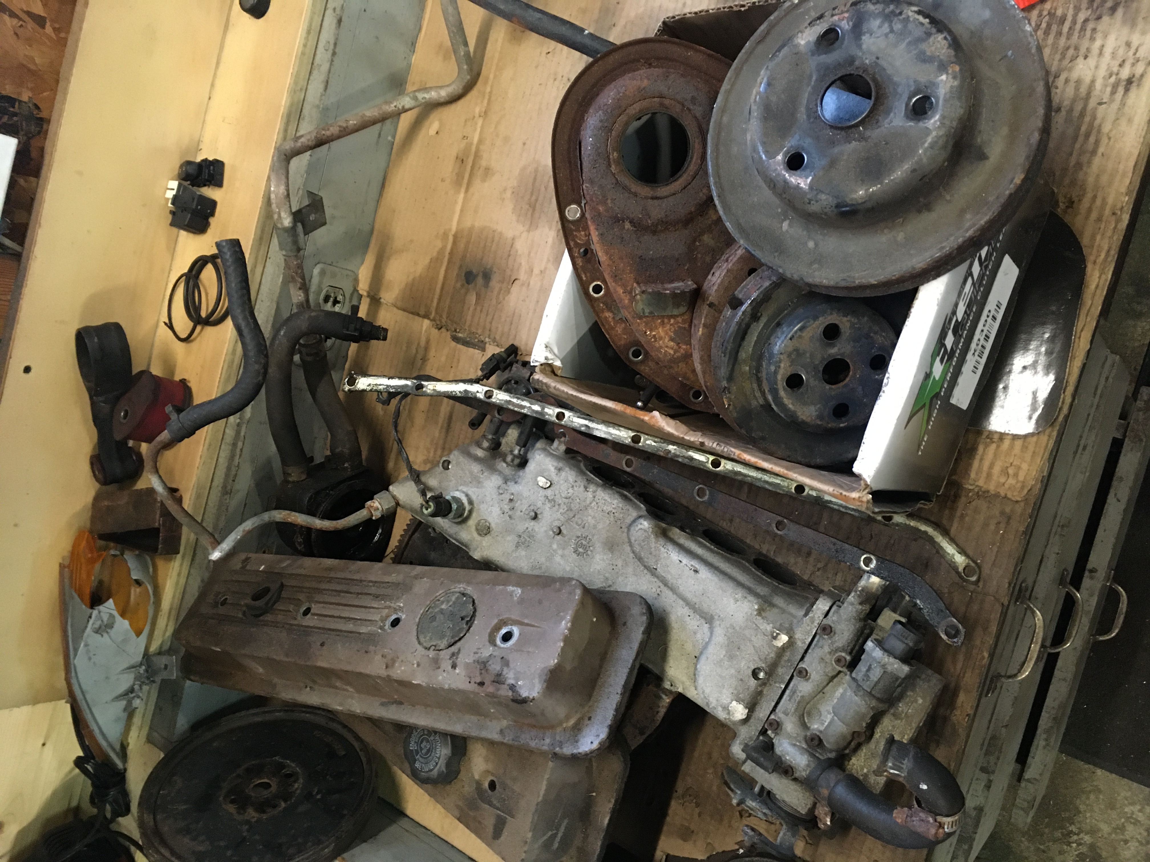

* Acquired the rest of the engine where the heads/distributor came from. It was a flood car which seems to have wrecked the pistons but inside the crankcase was clean which means we have the roller cam, lifters, pushrods and other supporting hardware, oil pan, factory oil cooler, flex plate.
