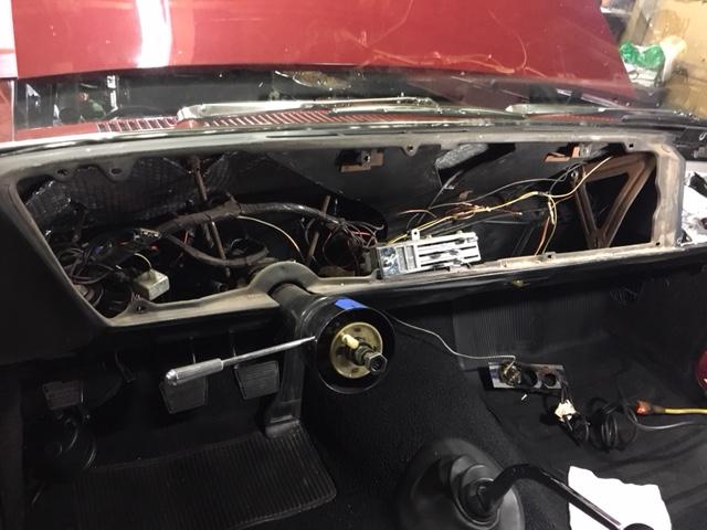

With a mild temperature start to the day, I went to the barn and started the
dashboard project. It started in the trunk, removing the speakers in the rear
deck. The previous owner had speakers put in the back, but didn't cut the deck
behind the seat. ( The speakers were UNDER the cardboard deck )Removing the
speakers didn't change the way the car looks, other than there are some ugly wires
removed from in the trunk. I took the back seat all the way out, which made it easy
to work in the trunk from the inside of the car. All of the wiring to the back speakers
has been removed from the car. ( I only want one speaker in the dash on this car -- that's
how it's supposed to be. ) I then went to the front of the interior and started removing
the front speakers. It became very obvious that the seats were in the way, so I invested
the 5 minutes per side to remove the seats. After the speakers were out, I removed the
radio. The install on this radio was far from clean, so I spent some time removing wires
and labeling wires that were important -- accessory power, main power, ground, etc...
I'm working on getting all of the original wires to power what they should, so there's a bit
of figuring out to do as I lay on my back. I did figure out the glovebox light, so that will work
when I reassemble the dash. Also, the many wires that are a mess under the dash won't be
when I'm done, the installer didn't run the wires the correct way under the dash, but I will.
I also removed my aftermarket gauges from the dash. The water gauge is still hooked
up to the block, since it will require me draining coolant out of the motor to reposition
it, I'll wait until the dash is back in the car, then mount the gauges under the dash in an
aftermarket three gauge bracket. Based on what I'm seeing as I look under the dash, I'll
want the room where they should be to put my face in to see behind the dash. So far,
so good... It took me about three hours to do what I've explained. Right now, I have a
big mess on my hands, but this is just step one in the project. I talked to the dash guy, he
expects to send out my parts mid-week this week. It's going to be cold here for a week or
so, so I'm in no rush. More to come.

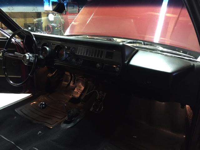

I talked to my dash guy ( his name is Ron Roth, out of Michigan ) and he told me he'd have my dash to me
before I went on vacation. True to his word, the dash showed up at work yesterday. With warmer weather
guaranteed today for us, Fred and I took to the barn around 10 am. It took us about 6 hours to do the
complete dash swap. This included cleaning knobs and switches that were removed from the old dash and
reinstalled into the new refurbed one and cleaning the steel dash framing the dash bolts to. I also installed
the factory stock AM radio and spent a bunch of time routing wiring the way it was supposed to be. ( No pics
of that, but it looks WONDERFUL under my dash!! ) I didn't completely finish the job, as I need to mount the
aftermarket gauges and bolt in the seats yet, but we made a HUGE dent in the project. I'm really excited
about this awesome upgrade ( and the fact that everything worked when I got done)!

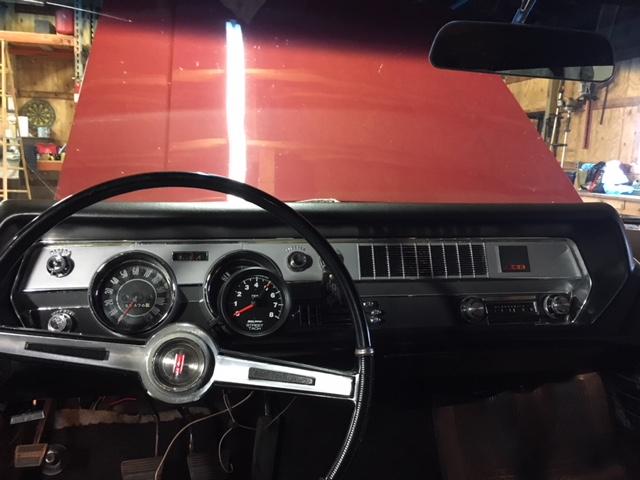

Today I got my aftermarket gauges mounted up under the dash. I mounted them centered under the
ashtray. They look as good as they can. It would look much cleaner in the car if they weren't there,
but idiot lights aren't the correct protection for the car, so I'll live with them. I also got the Redi-Rad
wired up. It works sweet! Put your AM radio on 1000 AM and turn your Ipod on. Instant tunes broadcast
on an old school AM radio. Pretty cool. I still have to find a way to run the AUX cord so it's neat, but
I'll figure that out. I got 4 hours in today and I'm pretty close to being done under the dash. There's
an interior light by the driver's feet that has a loose connection and it needs to be addressed before
I can call under the dash done. I also have a set of 1966 radio knobs and a glove box light lens coming.

in the front seats. They were "scotch-locked" into the wiring harness and the connection needed to
be repaired as they would flash if you bumped the wiring. I went about splicing them together in a
more permanent fashion. I figured that I'd wire them a bit differently than the previous guy did to
make for a neater look. That plan backfired when I realized that the way I had them wired would
have them on all of the time and not when the door opened. I decided to go back the other way and
was unable to make the lights work after mocking it up. Fortunately, AK showed up just as I was
waving the white flag for the day on the project. He and I figured out the issue of why they wouldn't
work, but something better came out of this. In our conversation, I said that I was surprised that I
couldn't find the original connector anywhere in the harness. He then said, "Maybe they are an add-on"
and not factory. He's right! I'm going to remove that option next time under the dash. Slowly but
surely it gets better and better.

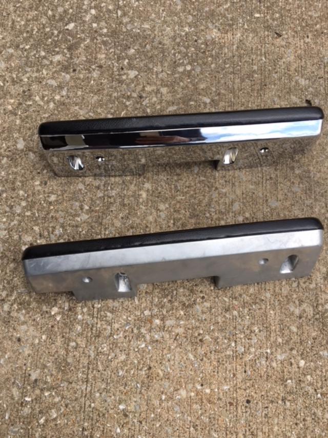

I bought the arm rest chrome pieces from a company online. The chrome is way nicer than the
previously painted arm rests. This was a very simple install and the parts bolted in perfectly.
